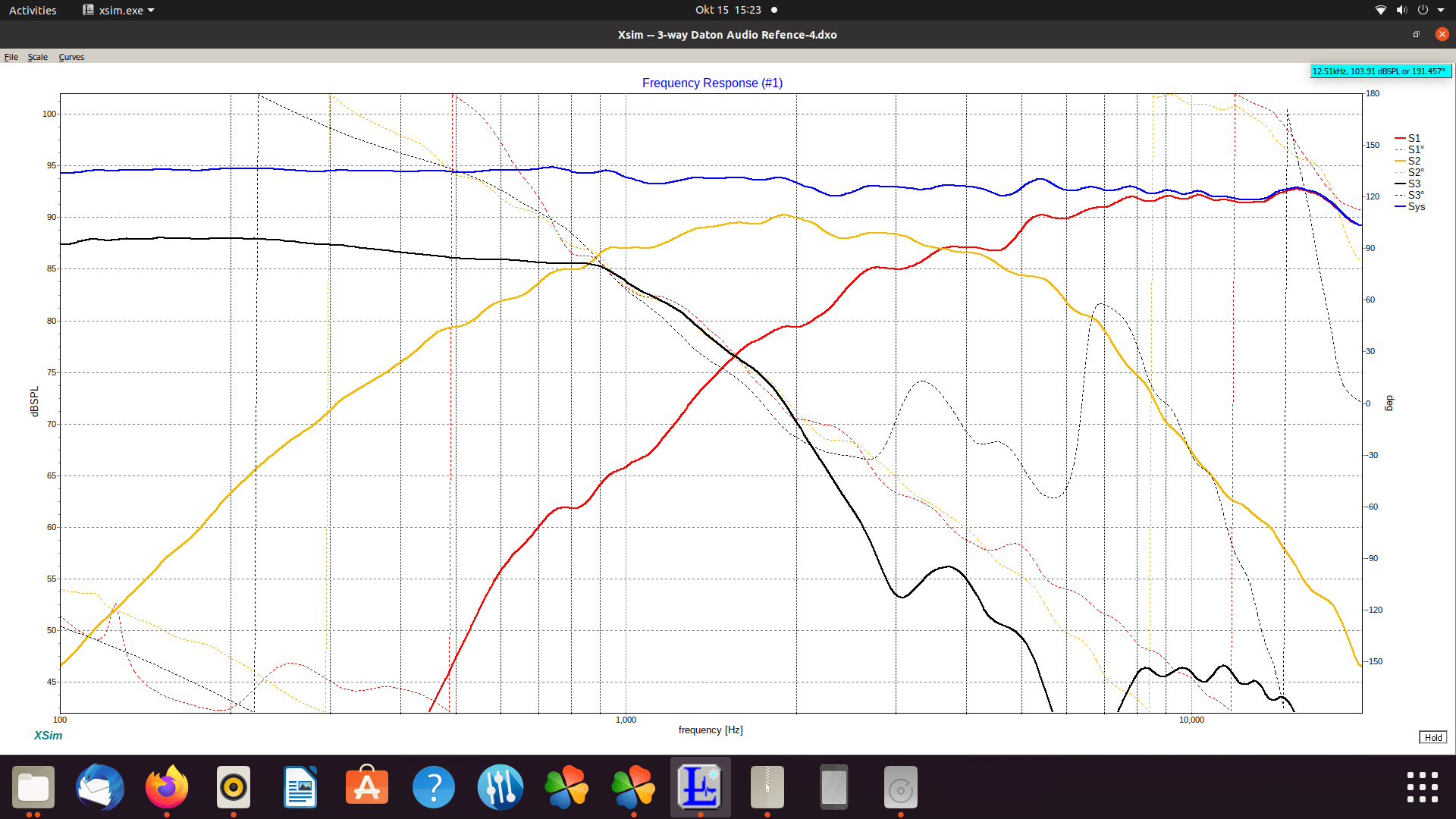

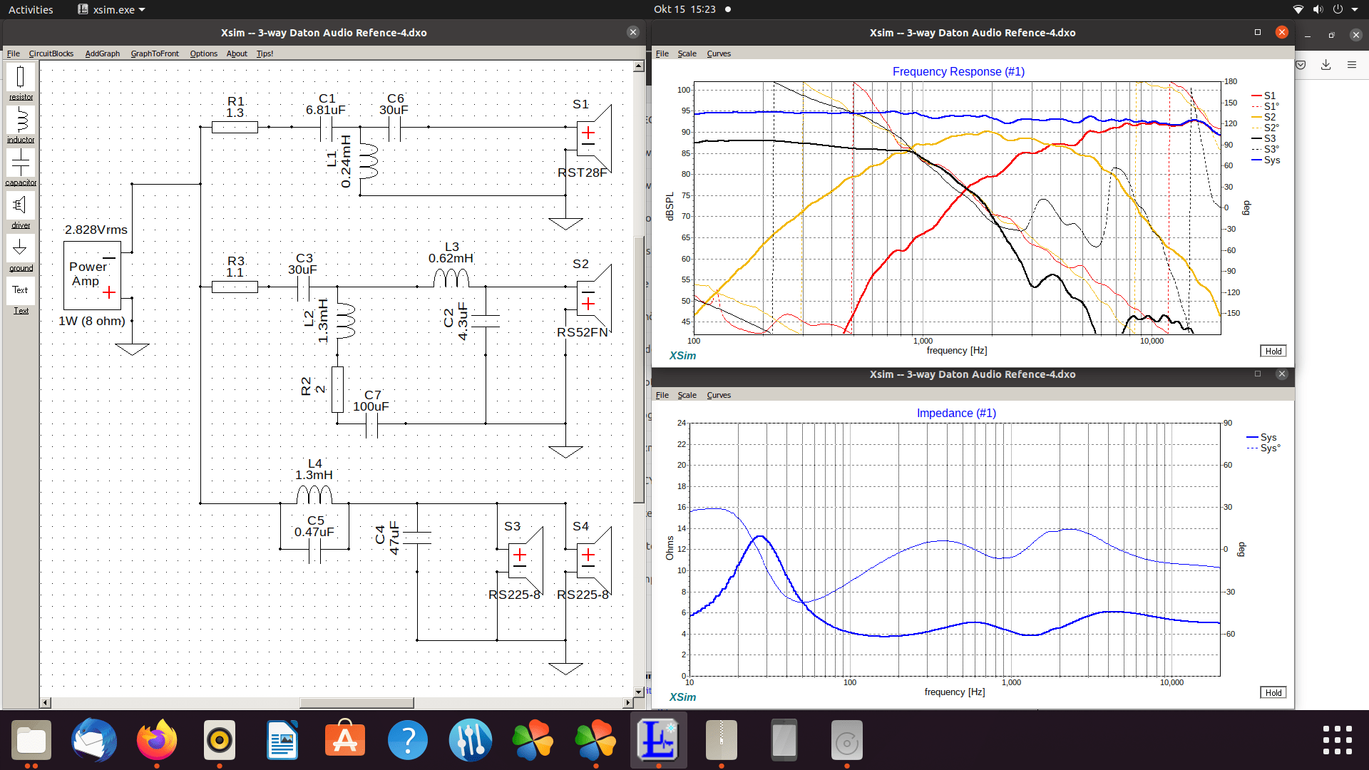

So I've been further playing with my idea of Dayton Audio reference speaker crossover and this is pretty much the best compromise i could put together to get the highest possible efficiency and impedance not dropping much below 4 Ohms
This is just a theoretical model since I don't have the drivers neither have started building the cabinets. Will probably start next year after we renovate the living room and will see how much funds will be left for this.
If anyone has any further ideas about this crossover design I'm open for criticism.
I would do this in Vituixcad but unfortunately can't get it to work on my linux PC so if anyone is interested in further developing this design I'll provide the room dimensions, speaker posittion in the room and rough baffle design.
