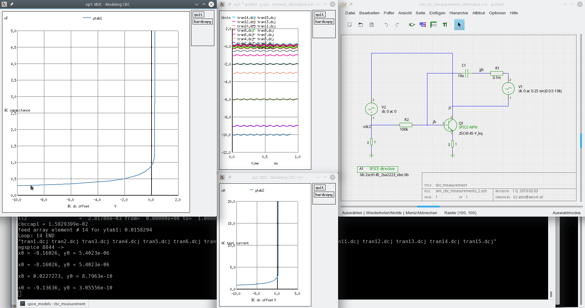

Using my smart tweezer to measure Cbc capacitance I have used this schematic. Verified with simulation of the above circuit.
The results at -9V vBC (via a 100k resistor) for
My smart-tweezer ST5 uses a 10k frequency and 0.25Vrms test signal
BR, Toni
- 2SC6145AY: 325pF
- 2SA2223AY: 540pF
BR, Toni

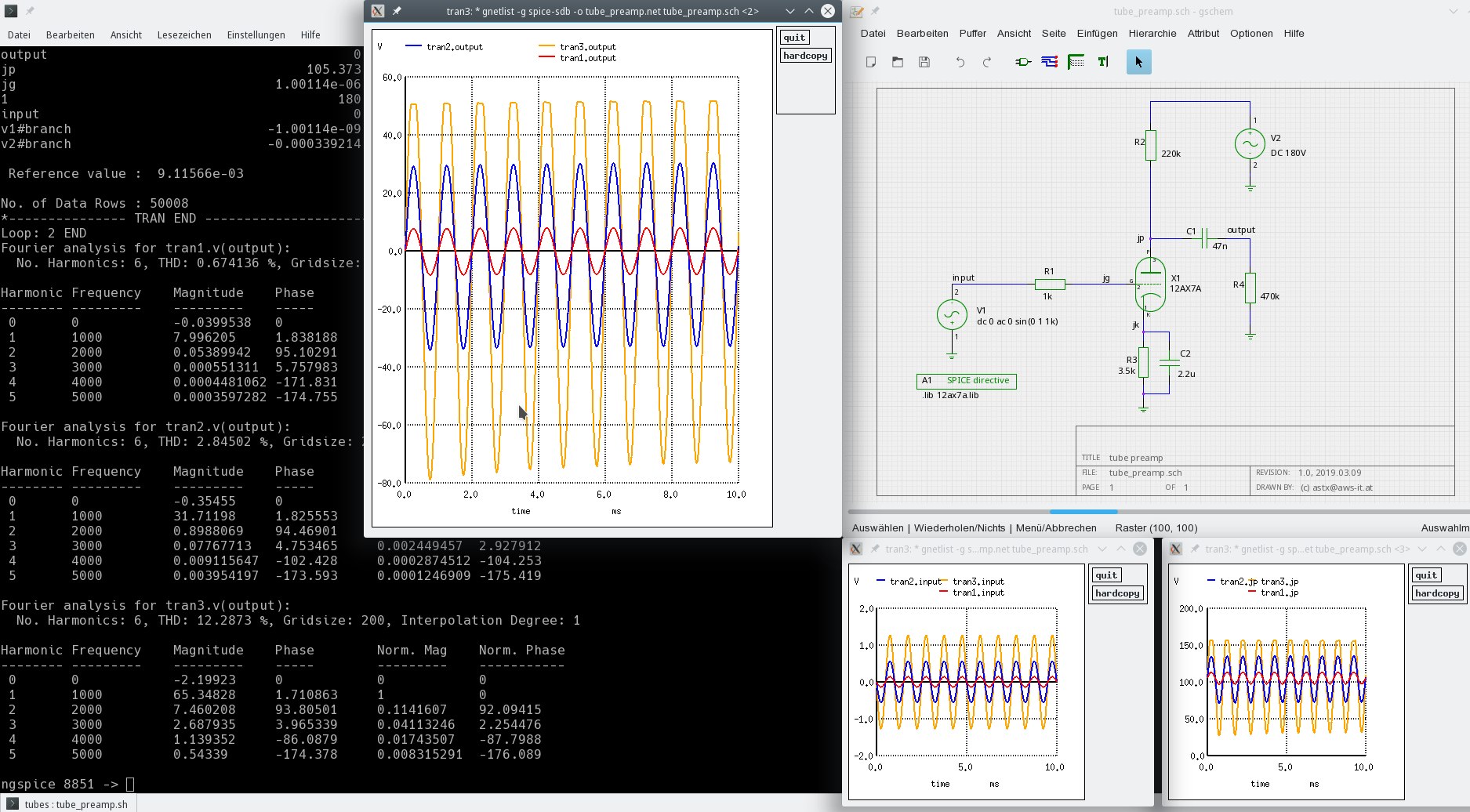

TUBE simulation example
Thx! Based on the above pdf I have created this simulation. Tubes are no problem here ...
I have created a triode symbol for gschem - it takes just a few minutes to understand, where to place the correct pin numbers to get the subcircuits working. To design a pentode or whatever symbol should be even no problem. I have seen some subckt's with integrated heater simulation too...
BR, Toni
BR, Toni
