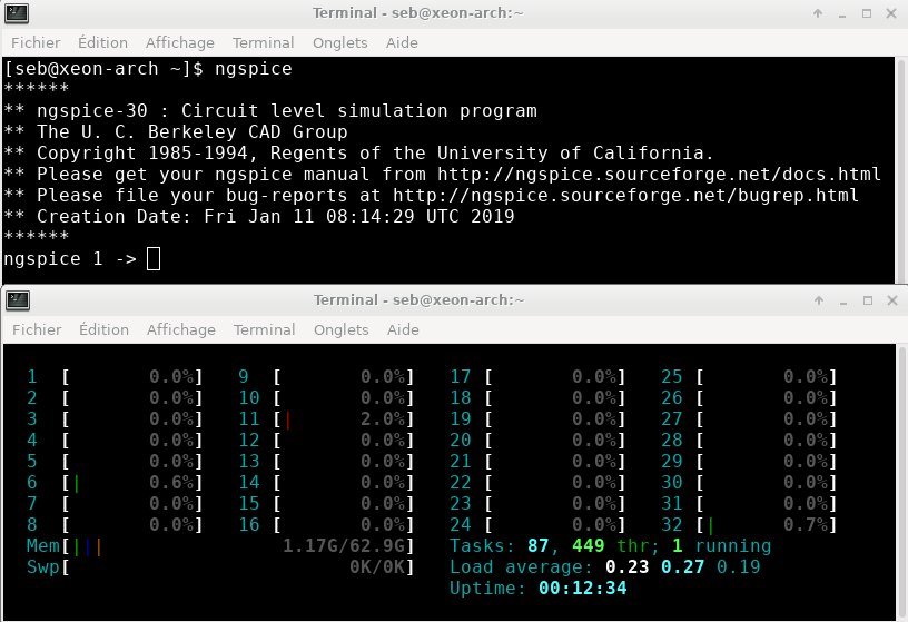

I have 32 thread xeon , do you have more information for this scripting ?

I just restart my archlinux and updated, I'll try this weekend
do you have more information for parallel simulation with ng ?
thanks
