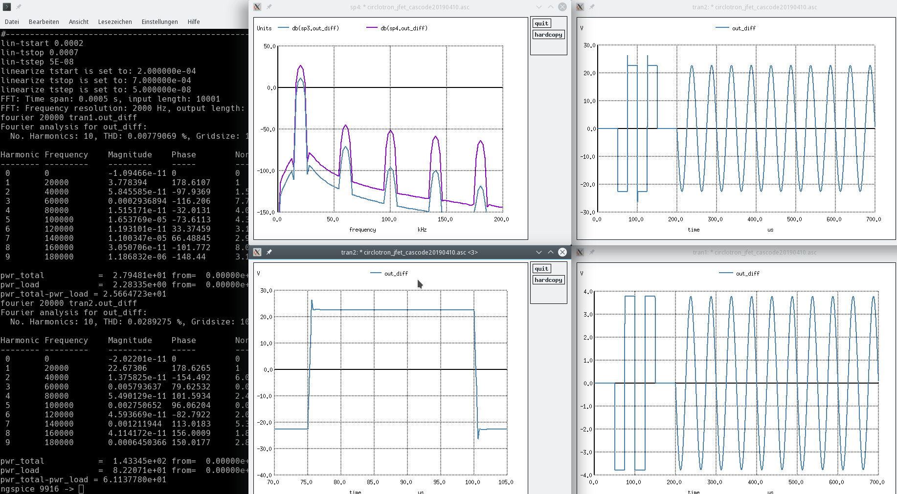

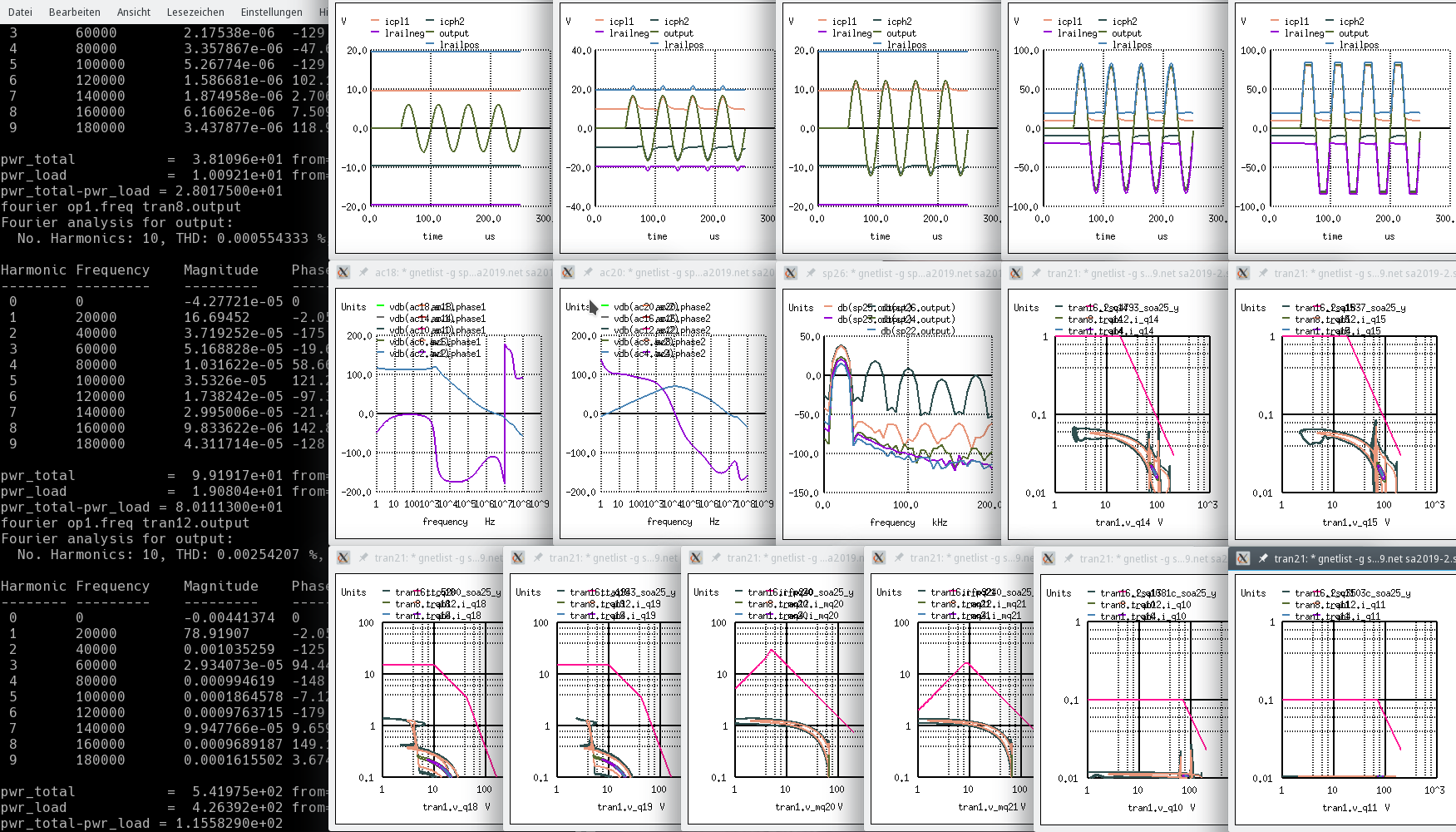

... maybe the learning curve is high, but the results of one sim run makes really fun and speeds up the development exponentially (as one of many benefits it helps to avoid a carpal tunnel syndrome). Attached a screenshot of a high power class G amplifier in development using 8 pairs TTC5200/TTA1943 and 8 pairs IRFP240/9240.
Includes SOA of VAS, drivers, output drivers of all 5 power steps
tian probe results of feedback loop and vas feedback loop
fft, harmonic distortions, output power etc ...
Thanks to David Zan supporting me with outstanding good ideas for going green!
Have fun, Toni

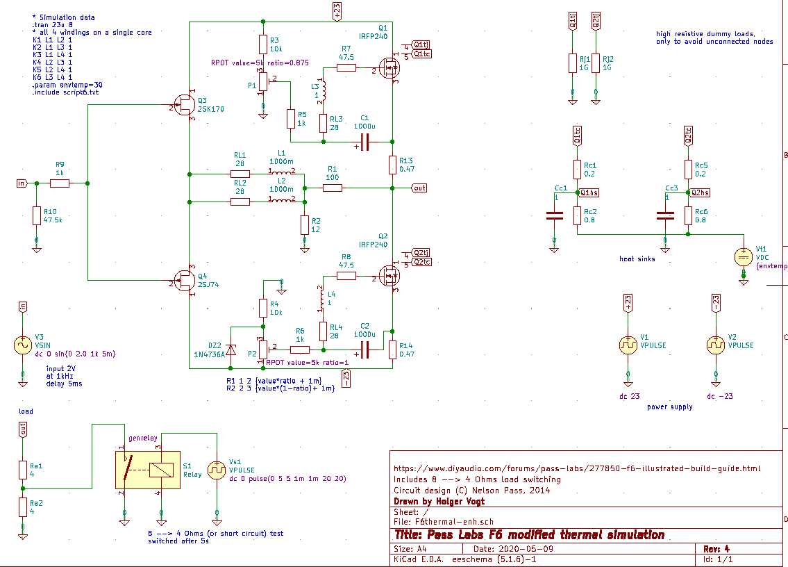

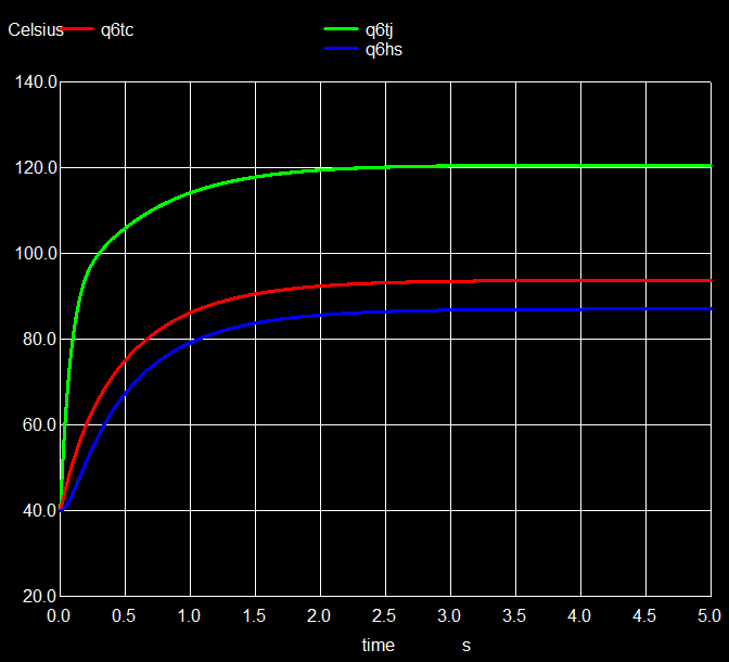

PassLabs F5 Turbo V2 simulation with self-heating
The KiCAD/Eeschema/ngspice example of the PassLabs F5 Turbo version 2 is set up to run with recent ngspice-32.
The power transistors symbols and their VDMOS model now have five terminals: The electrical nodes drain, gate, source, and two thermal nodes junction temperature and case temperature. We simulate the electric circuit as usual, but have a thermal circuit in parallel. Three model parameters are dedicated to self-heating: RTHJC, the junction to case thermal resistance (from the data sheet), CTHJ, the thermal capacitance of the packaged chip, (to be estimated, e.g. by taking the thermal capacity of 1g of Cu), and RTHCA, the thermal resistance if no heat sink is provided (typically around 100 K/W). The choice of the power transistors IRFP9240 and IRFP240 is probably not the optimum selection, it is simply due to transistor parameter availability.
The transient simulation settings in this example are made for thermal evaluation (which requires a simulation time of few seconds, until thermal stability is achieved). For a detailed circuit analysis one probably would use the final device temperatures as estimated and then choose a smaller step size resolution, e.g.
.tran 10u 100m
The CPU time for 5s of simulated time is approx. 1 to 2s.
The thermistors TH1 and TH2 have got their own device model (a subcircuit) and now have three terminals: two electric nodes and one thermal node. The thermal node is coupled to the thermal node of the heat sink.
The heat sink comprises of a thermal resistor between device and sink (glueing of the package to the heat sink surface), the heat sink thermal resistance and its thermal capacitance.
Still missing is a self heating model of the power diodes to simulate their heat sink requirements.
In addition to the KiCAD/Eeschema files there is also a ngspice netlist available for direct use in standard ngspice.
The previous Eeschma files (without self-heating, only transistor selfheating withot thermistors, are available as well.
The picture shows the temperature rise of transistor Q6.

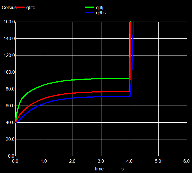

PassLabs F5 Turbo V2 simulation with short circuit
This is an enhacement of the previously shown KiCAD/Eeschema example of the PassLabs F5 Turbo version 2.
The transient simulation runs up to 6 s. At time=4 a short circuit is generated at the output by switching a relay with low (19m Ohms) resistance parallel to the output, leading to an immediate (<100ms) thermal runaway and destruction of the output transistors.
The 10 mOhm resistor may be replaced by a 8 Ohm resitor just to show what happens when the load switches from 8 to 4 Ohms. If you have KiCAD/Eeschema running, you may change the RON value by clicking onto the RON=10m text near the relay and change 10m to 8.
The three trim pots P1 to P3 may be changed similarily, to allow balancing of the amplifier by changing the 'ratio' which detemines the pot's wiper position.
The power supply is ramping up after a short delay to allow ngspice to settle at the surrounding temperature (here set to 40 °C).
The input voltage is set by the second entry in sin(0 2 1k 5m), frequency by the third entry. A short delay of 5m before ac in starts (fourth entry) may be used to look at the quit output, useful for trimmimg the output dc offset.
The Eeschema text box '*simulation data' determines the transient simulation step size and duration. In addition another script is included (loaded) from a file to allow simulation and plotting with external ngspic from the Eeschema Tools->Generate Netlist->RunSimulator command sequence. Several plots are generated, like output and input voltages, thermistor resistance, output current, and power supply currents.

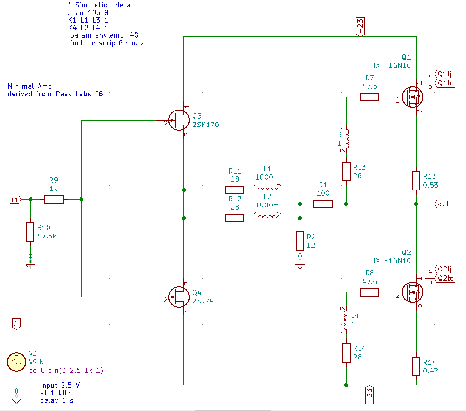

Pass Labs F6 KiCAD/ngspice simulation
Two versions of the F6 amplifier are simulated:
F6thermal-enh.sch is close to the design found at F6 Illustrated Build Guide. Two Enhancement NMOS power transistors IRFP240 are used. Two types of feedback are employed, via the source resistors R13 and R14 and via the voltage divider R1/R2. Networks with trimpots P1 and P2 set the bias for each transistor.
F6thermal-minimal.sch is a minimal version of this class A amplifier: 8 resistors, 2 JFETs, 2 Depletion mode NMOS power transistors (IXYS IXTH16N10), and the transformer. No capacitors (of course except for ther power supply that is not modelled here), no bias networks. The ngspice thermal VDMOS model parameters are only coarsely estimated from the data sheet, there is currently no model available from IXYS. A device mismatch is assumed, threshold voltages are set to -3.7 and -3.2 V. The symmtetry of the amp is achieved by setting resistor R13 appropriately, until the mean output voltage (aka the dc offset) is close to 0. Of course we do not have a 10 A trimpot, but one may use several resistors in parallel, and add them step by step until the correct value is found. Again feedback is by the source resistors R13 and R14 and via the voltage divider R1/R2.
More information on setting up the simulation is found in file readmeF6.txt from the attached zip file.
To state it clearly: these are simulations. I did not build anything. The models are coarse. So the minimal amp may work, but it also may happen that the transistors burn away immediately. It is an idea shown here, that may need further investigations.
