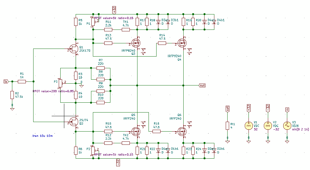

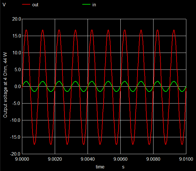

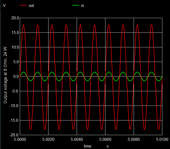

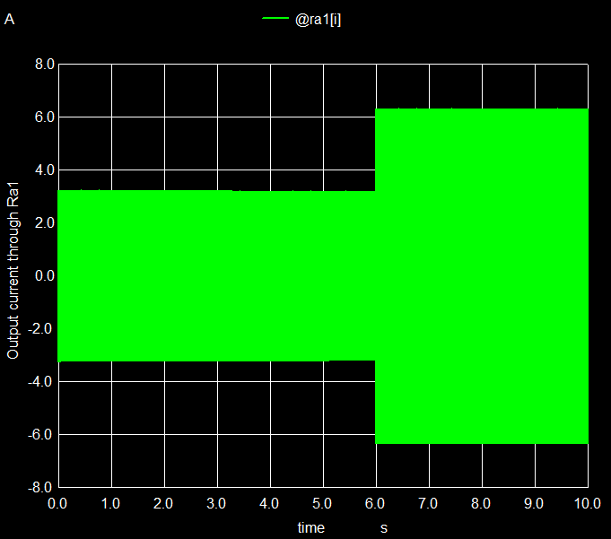

F6 minimal, simulation results
mean output voltage (dc offset)
mean: -0.00348107
output power 1 kHz load 8 Ohm
21.5 W
output power 1 kHz load 4 Ohm
27.2 W
damping factor 4 at 8 Ohm
mean: -0.00348107
21.5 W
27.2 W

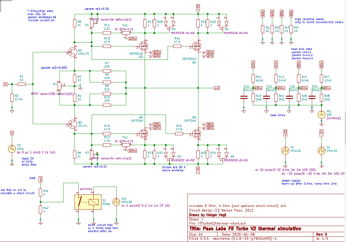

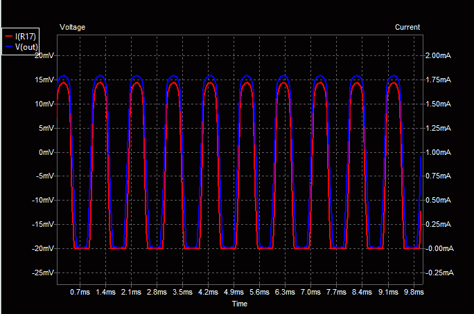

Help to get simulating using KiCad in windows
I tried to simulate the attached circuit (F5 v2) but it only shows a very small output voltage and only a few mA of drain currents in the IRFP240.
Since this was my first time trying to run ngspice via KiCad I am stuck. I tried updating to the latest KiCad v5.1.6 (64 bit for Windows) but still the same. I found R8 and R9 shorting P3 but changing that didn't help, and I found Q2 has a different pin connection order (SGD) to Q1 (DGS) so flipped Q2 but still no output voltage (circuit mods below).
These are error messages
I was hoping to run the thermal simulations in the following posts but the same circuit changes to Q2 and R8/9 appear to be needed.
The F6 version has a 'readmeF6.txt' file that says
Any help would be much appreciated for a Win 10 user.

ngspice-32 required for VDMOS electro-thermal simulation
The error message tells it: the thermal model parameters are not recognized and the 5 VDMOS nodes are not available: With KiCAD 5.1.6 you will get ngspice-31. But ngspce-32 is required. In addition: the Eeschema/ngspice interface is rather limited. So for many advanced simulations plain ngspice has an advantage. What to do:
Upgrade ngspice within KiCAD/Eeschema (Windows 10) by downloading ngspice-32_dll_64.zip from ngspice - Browse /ng-spice-rework/32 at SourceForge.net. Open the zip file, go to ngspice-32_dll_64.zip\Spice64_dll\dll-mingw\ and extract msys-ngspice-0.dll into your KiCAD installation directory (I use C:\Program Files\KiCad\bin\, which requires admin rights for extracting). Then go into C:\Program Files\KiCad\bin\, rename libngspice-0.dll (the ngspice-31 dll) to libngspice-0-orig.dll, then rename msys-ngspice-0.dll (the ngspice-32 dll) to libngspice-0.dll. Put the file spice.rc into your HOME directory (mine is C:\Users\holger). Re-start KiCAD/Eeschema.
Then you may run the simulator from Eeschema in the usual way: File->Open->my.sch->Tools->Simulator->Run
Standard ngspice offers many more simulation types. To install it, download ngspice-32_64.zip from ngspice - Browse /ng-spice-rework/32 at SourceForge.net and extract it to C:\ on your computer. You then will have ngspice.exe in C:\Spice64\bin.
From within Eeschema plain ngspice may be started by: File->Open->my.sch->Tools->Generate Netlist File...->Spice->Check 'Default format'->Enter C:\Spice64\bin\ngspice.exe into 'Simulator command:' text box->Run Simulator. Ngspice will now execute the simulations as prescribe in the script file
I have attached a new project zip file PassLabF5-4.zip to this message. It has a README file F5readme.txt and it includes spice.rc. The projct files are F5TurboV2thermal-short.sch and F5TurboV2thermal-ac.sch.

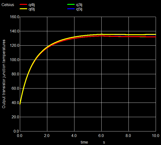

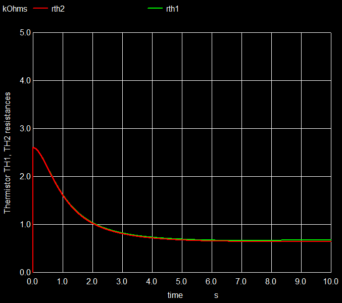

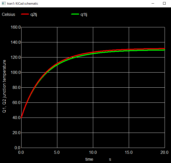

Some thoughts on electro-Thermal simulation are gathered at ngspice tutorial for electro-thermal simulation (not yet complete).

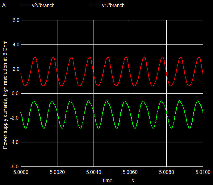

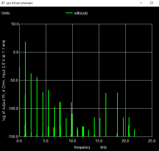

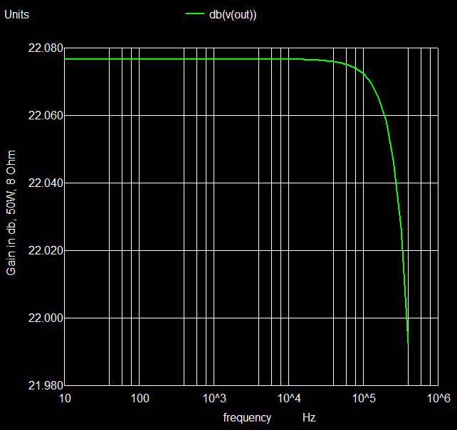

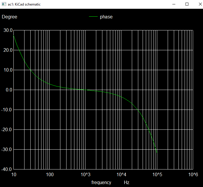

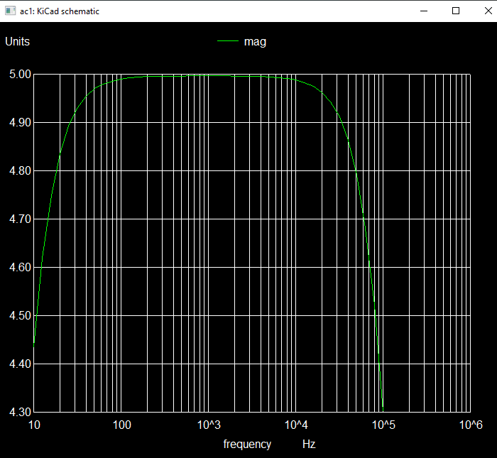

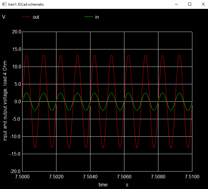

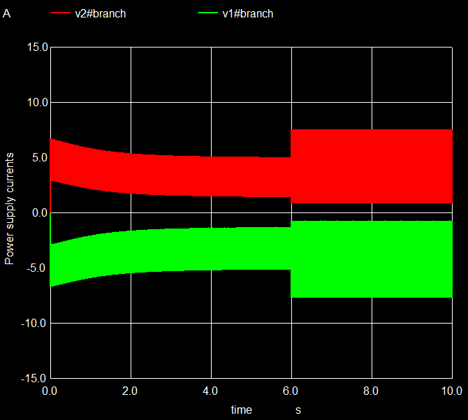

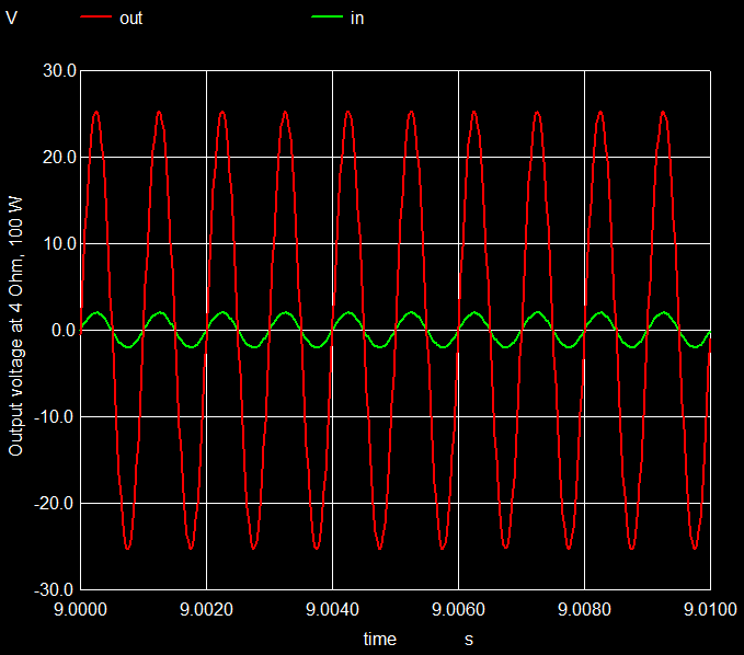

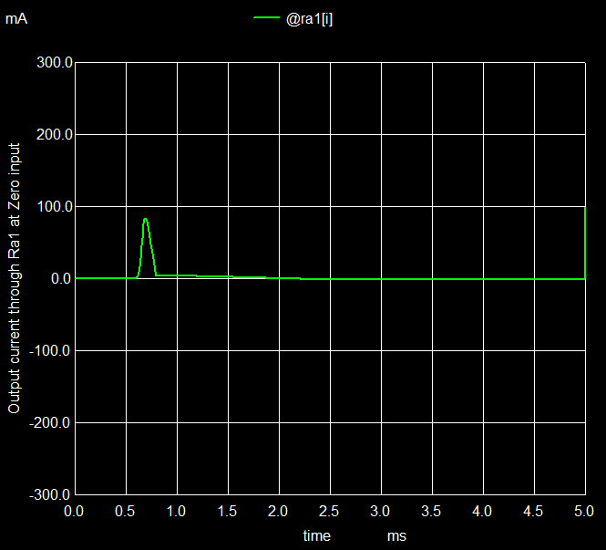

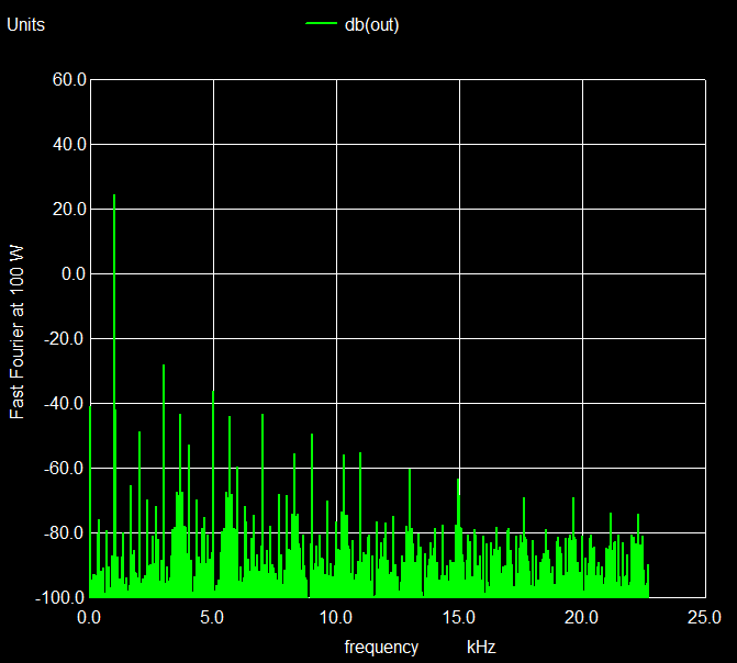

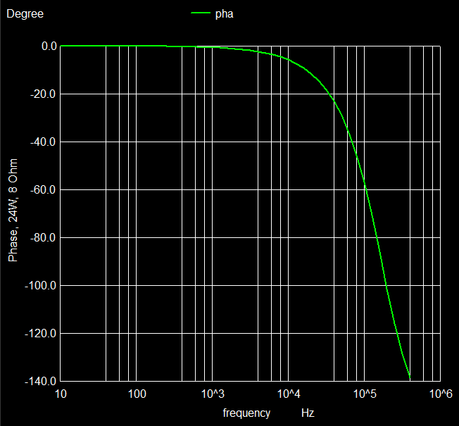

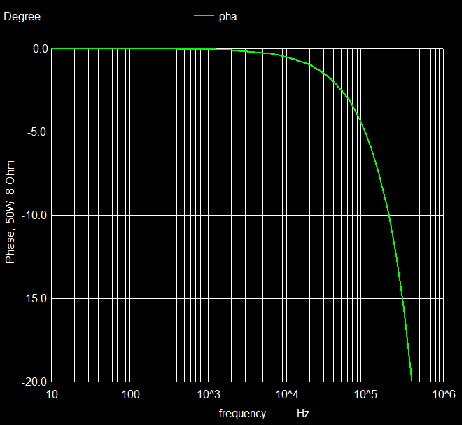

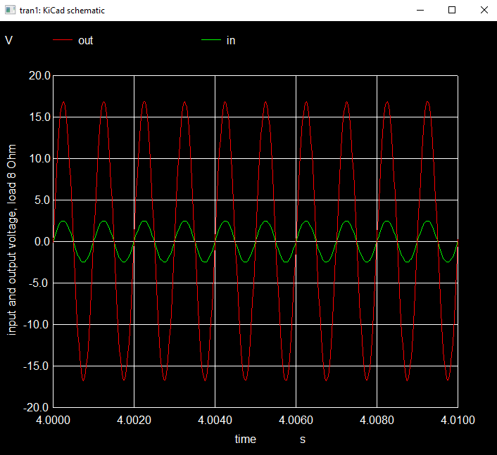

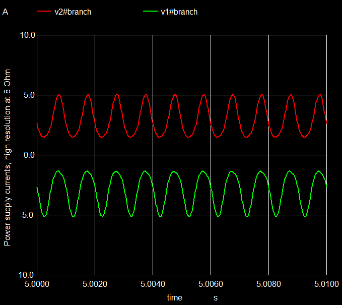

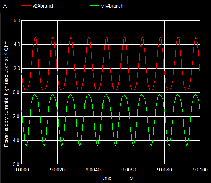

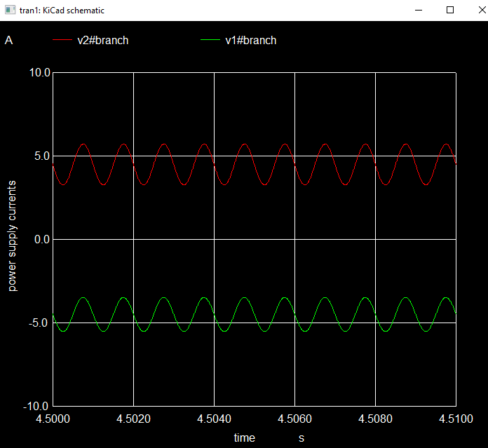

F5 Turbo V2 simulation results
Some simulation results (for setup see #205):
The simulation of this amplifier yields excellent results: 50 W into 8 Ohm, 98 W into 4 Ohm, damping factor 58, voltage gain 22 dB (a factor of 12), all simulated at 2 V peak (1.41 V rms) and 1 kHz input.
Hi Holger,... But ngspce-32 is required. In addition: the Eeschema/ngspice interface is rather limited. So for many advanced simulations plain ngspice has an advantage. What to do: Upgrade ngspice within KiCAD/Eeschema (Windows 10) by downloading ngspice-32_dll_64.zip ...
I now have the 'F5 thermal' working now including running the script. Thanks so much!

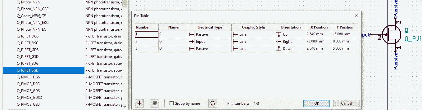

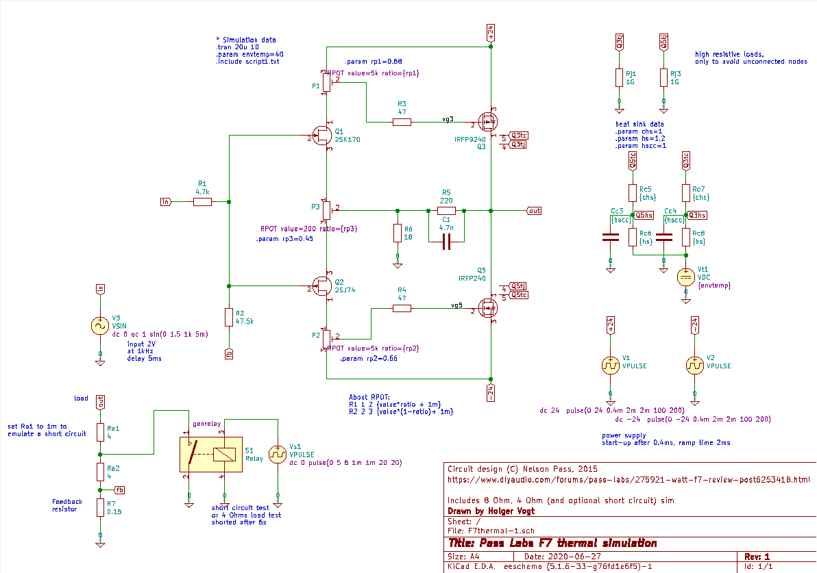

Re: Q2 pin assignment.
It appears from this that ngspice interprets all FETs pins 1,2,3 as D,G,S respectively. That's irrespective of the pin assignment in KiCad Library Symbol editor (below) - is this intentional?
Also, your circuits have R8 and R9 shorted. I think trimpot P3 needs this open to work properly.
R8 and R9 shorted
Yes, that's wrong. Opening the short will require a different trimpot setting for P1 and P2. The influence of P3 seems to be overly strong. I will upload another corrected schematic later.
Concerning pin numbering
KiCAD is a layout tool, taking care of vendor supplied pin configurations and pin numberings, typically linked to footprints.
ngspice has a fixed D G S sequence for MOS devices, and also fixed pin sequences for all other devices.
You need to have some translation between the two. This is served during the Spice model setup by defining the 'Alternate node sequence' in Eeschema. I have made a description how to handle this in KiCad Eeschema as GUI for ngspice, tutorial for setting up the simulation, not for MOS only, but for all devices. Especially this is a nuisance for diodes, where Eeschema nearly always has the inverted pin numbering compared to ngspice, and you definitely have to define the 'Alternate node sequence' 2 1.

F7 simulation with KiCad/Eeschema/ngspice
This is a first attempt to simulate the Pass Labs F7 amplifier by Nelson Pass.
The circuit diagram is taken from First Watt F7 review.
Resistor values have been estimated, a small Capacotor C1 has been added for frequency compensation. This simulation does not use the lateral power MOS devices, but the venerable complementary pair IRFP9240/IRFP240.
Some pictures and the simulation setup are attached. More info is available in F7readme.txt.

Example: Starting the F7 simulation
Install KiCad/ngspice as described above.
Download https://www.diyaudio.com/forums/att...e-opensource-simulator-passlabf7-diyaudio-zip and expand it to a directory of your choice, e.g. to D:\kicad-examples.
Start Eeschema by double click on C:\Program Files\KiCad\bin\Eeschema.exe.
File->Open->D:\kicad-examples\PassLabF7-diyaudio\F7thermal-1.sch -> Tools -> Simulator -> Run Simulation
Plotting after simulation has finished:
-> Add Signals -> V(Q5tj)
To run external ngspice with the embedded script (file script1.txt)
File->Open->D:\kicad-examples\PassLabF7-diyaudio\F7thermal-1.sch -> Tools -> Generate Netlist File...-> Spice -> Default format -> Simulator Command: C:\Spice64\bin\ngspice.exe -> Run simulator
