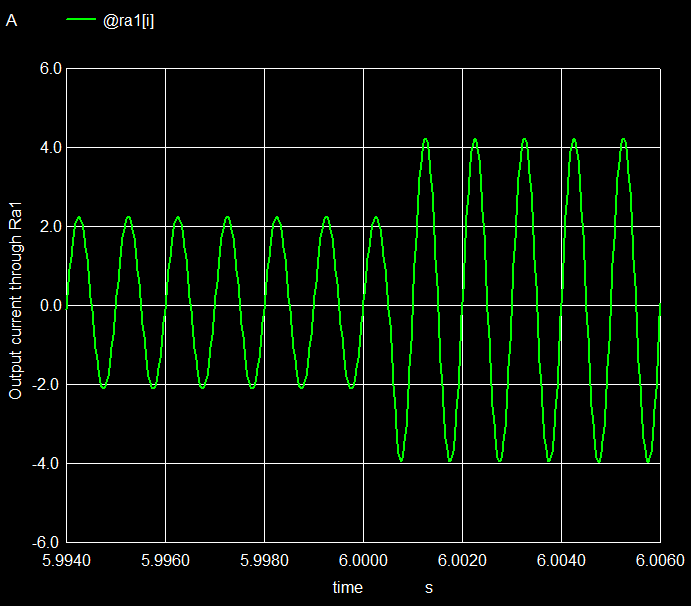

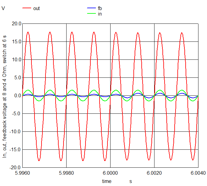

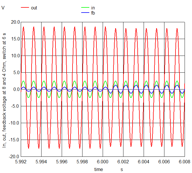

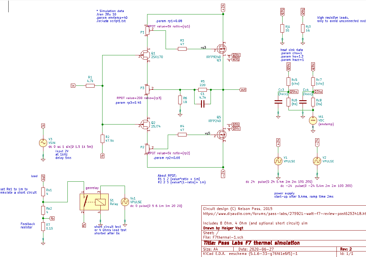

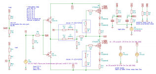

Update to F7 simulation
I have created a small bug in the previous setup: When switching from 8 to 4 Ohms output load, I have short-circuited the feedback resistor R7.
With the corrected schematic the output power at 8 Ohms is 24 W, at 4 Ohms it is 46.5 W.
The graph attached shows the input, output and feedback signals around the switching point at 6s. The change in output voltage amplitude is barely visible. This probably leeds to a very good damping factor.

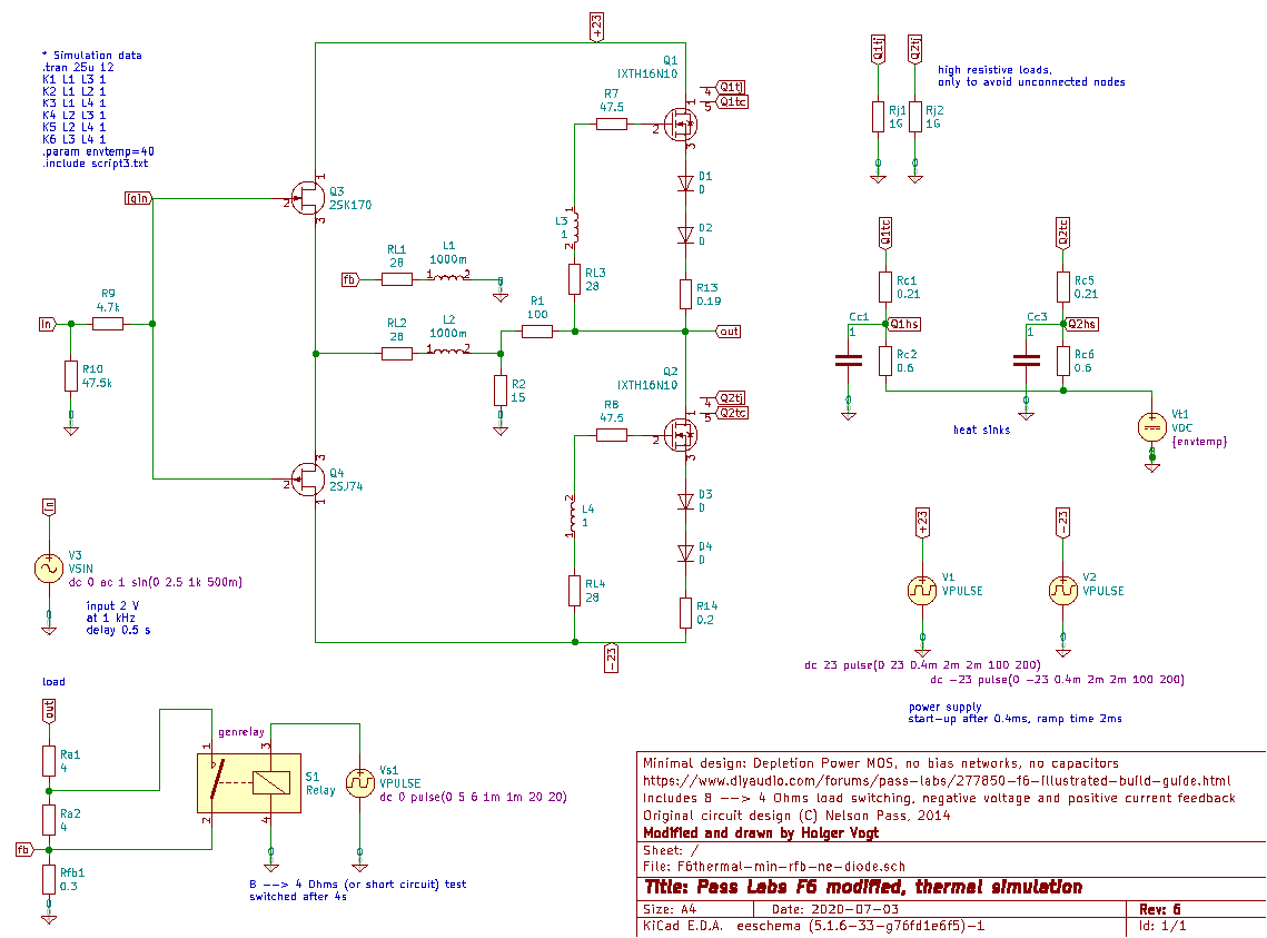

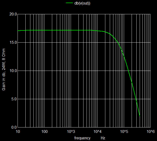

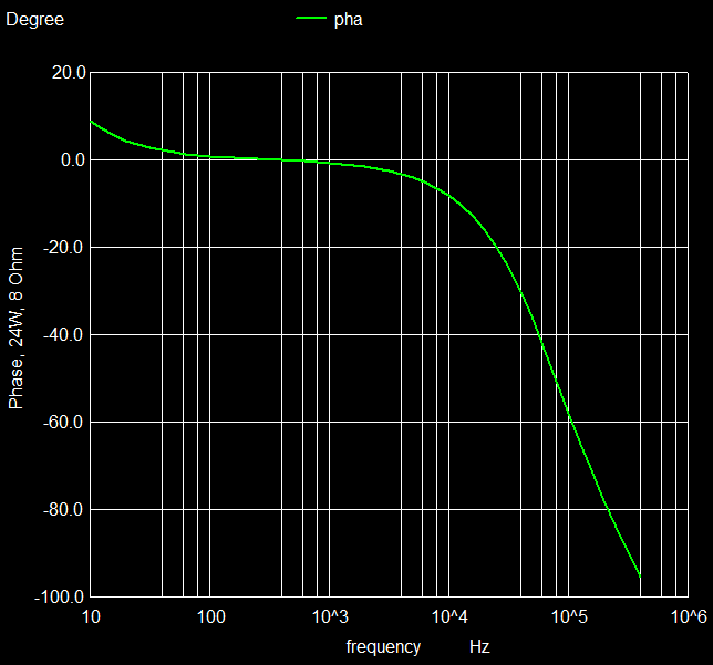

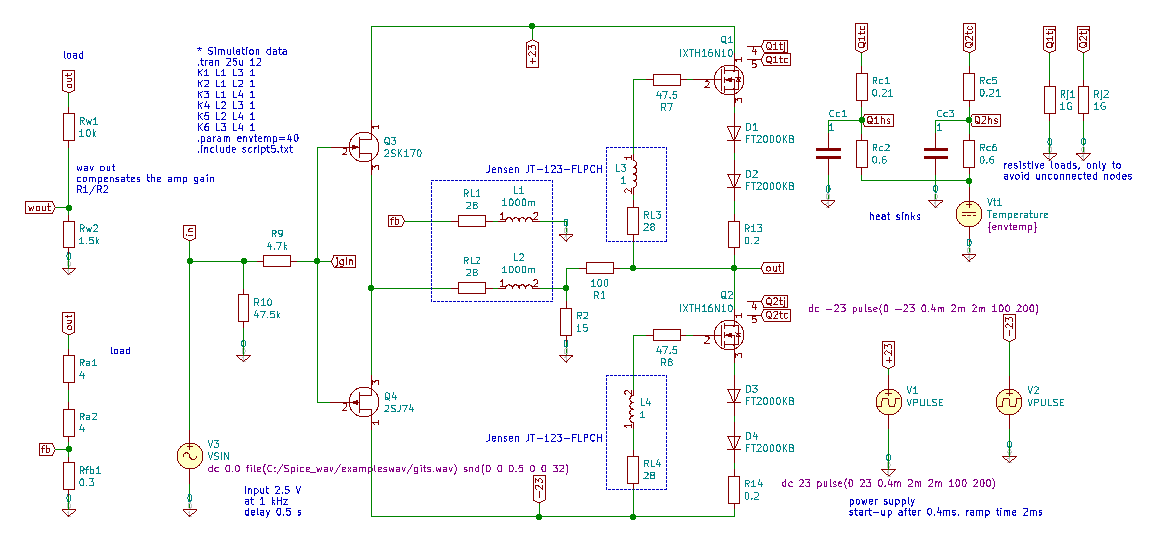

Pass Labs F6 modified simulation
This is a modification of the Pass Labs F6 amplifier.
The output transistors are IXYS depletion NMOS Power FETs.
The transistor bias is generated by a source resistor and two diodes in series.
A transformer with four windings is powered by the JFET driver on winding 2. Windings 3 and 4 are used to drive the Power MOS (as in F6). Positive feedback derived from the ouput current has been introduced in the F7. Here this feedback is applied via winding 1 of the transformer. The negative feedback is by the usual R1/R2 resistor divider. Thus both feedback loops may be tailored independently from each other and from the input.
This is still a simulation study only. Some results are shown in the pictures. The output power is 24 W (8 Ohm) and 45 W (4 Ohm) with 1% THD (mostly third harmonics). The damping factor is 46, the output resistance 0.17 Ohm.
The simulation setup is still not complete:
The IXTH16N10 VDMOS model parameters are crude.
The transformer model is ideal and thus overly simplified.
The smaller, more cost efficient IXTH6N50D2 transistors may be adequate.
The diodes are still generic. Diotec FT2000KB may be o.k.

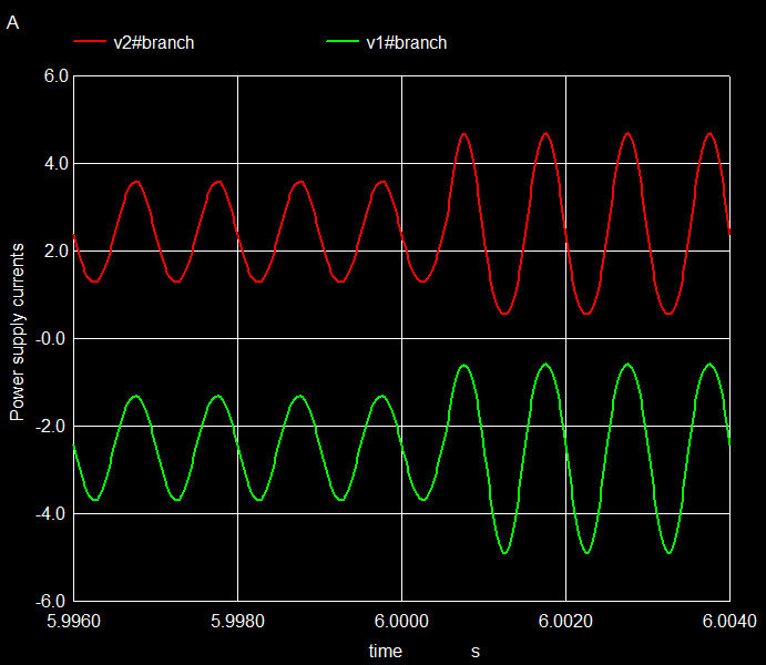

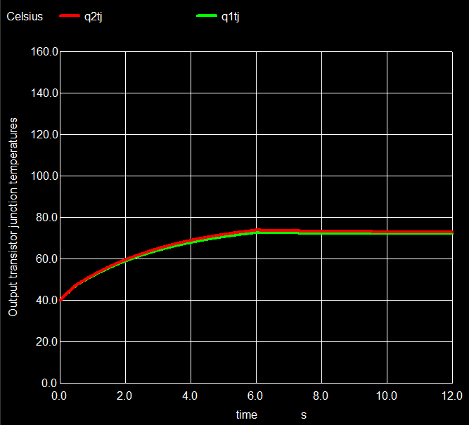

Update to Pass Labs F6 modified simulation
I have replaced the generic diode model by a vendor (Diotec AG) supplied model for the power diode FT2000KB.
The new simulation data for output load 8 Ohm are:
Power 24 W with THD 0.3%, mostly third harmonic, damping factor 69, output rsistance 0.12 Ohm .
The new simulation data for output load 4 Ohm are:
Power 45 W, THD 0.65%, mostly third harmonic

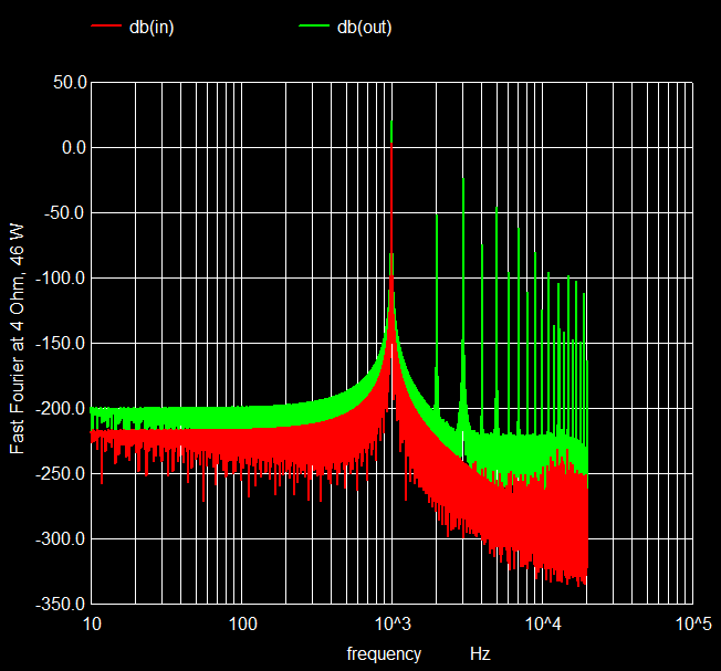

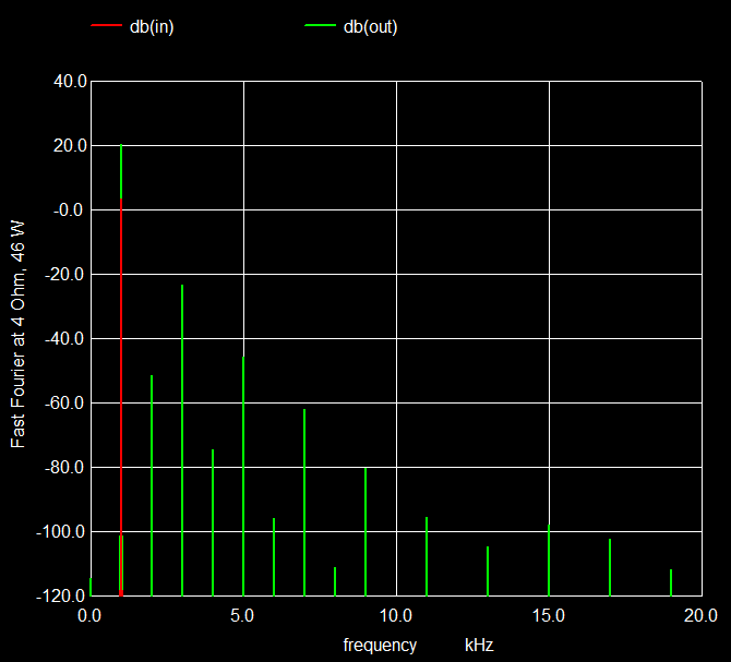

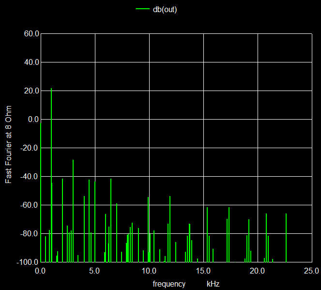

Improved fft measurements on the modified F6
There has been a recent thread about Fast Fourier Transform (fft) here in diyaudio (how to measure precisely distortion with LTspice?). What I have learned from this thread is that one has to be very careful when defining fft measurements on (amplifier) simulation data.
Therefore I have revised the fft simulations that were shown above for the modified F6 amplifier. Now we do an extra simulation run per output resistance (8 and 4 Ohm) dedicated to the fft and THD measurements only. The transient simulation time step has been aligned to the input voltage period. The background noise of the input voltage has been determined. The dc offset has been subtracted from the signal (detrending).
The resulting fft measurements are shown in the pictures. The background numerical noise is now 200 dB below the signal. The harmonics are clearly seen and are far above the noise level.
