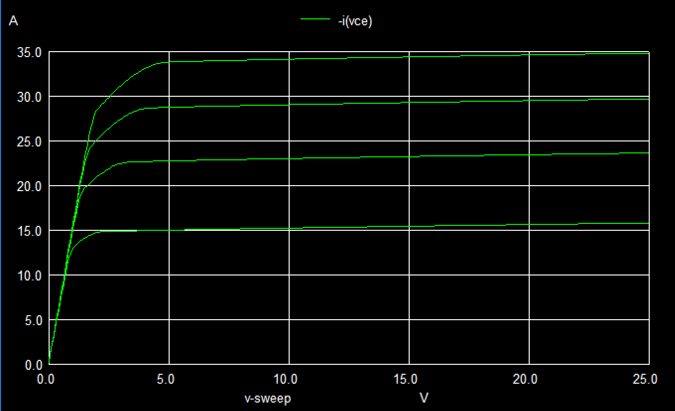

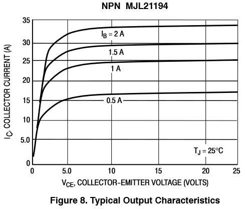

Because we are in ngspice thread - the following mjl21194 model I converted with the script and made some parameter tweaking for Q-S:
Only to show Q-S capability. It is to see that beta decrease is not correct and I am sure lots of others too.
BTW: HRCF and VO are redundant. Let HRCF on Default as above to see.

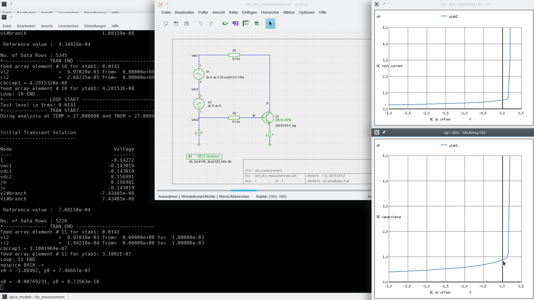

I fit Cbc at two datapoints, the 0V point you gave me and the 10V value in the datasheet.
Looks like I have done it correctly...
...many new things learned about parameter extraction.
Thx keantoken for pushing me to the right direction!
Actually I'm confused, I'm not sure exactly what's going on.
One suggestion I would make is to measure capacitive reactance using only the imaginary part of the collector current, this way you can exclude leakage resistance from the measurement. So it would be something like
Xc=Vbc/Ic -> Xc=Vbc/im(Ic)
This way you may get more meaningful data in the forward biased region where the junction becomes significantly resistive.
