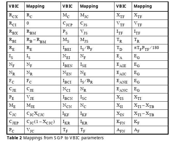

Attached the mapping table you hopefully mean. I have inserted the corrected calculation in the script - see this changes here:

        $r->{'xii'}     =       ($val->{'xti'} - $val->{'xtb'});
-       $r->{'xin'}     =       ($val->{'xti'} - $val->{'ne'} * $val->{'xtb'});
+       # $r->{'xin'}   =       ($val->{'xti'} - $val->{'ne'} * $val->{'xtb'});
+       $r->{'xin'}     =       ($val->{'xti'} - $val->{'xtb'});        # corrected according to the url: [URL]http://www.designers-guide.org/VBIC/documents/VbicText.pdf[/URL]

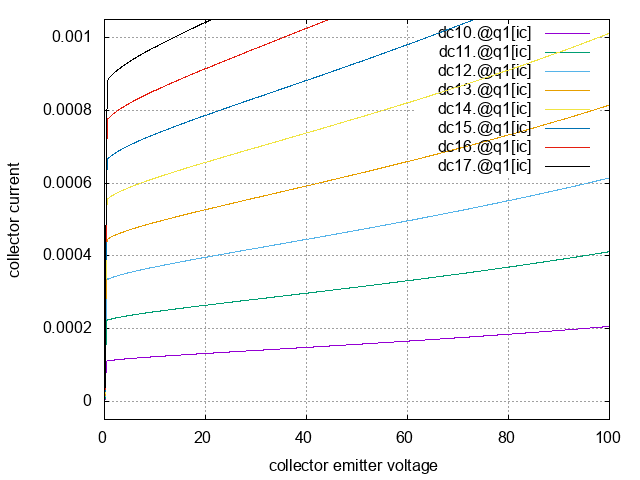

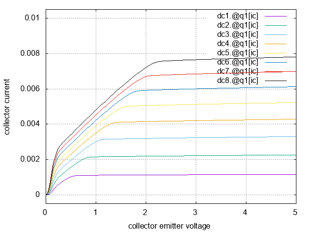

Dear keantoken,
have converted your kean9.lib.txt to VBIC models and tried to run a curve trace using all your npn/pnp devices included.
Attached the script to generate the files and results. To automatically generate the png files you need the ngspice gnuplot patch some posts before.
If you edit the resulting e.g. tmp_curve_trace.BC550C_C.inc file
Code:
.control
* --------- BJT specific values -------
        * ngspice-30 BUG: need a non numeric character and not +/- in front of the bjt name, otherwise the bjt name will be converted to a number
        set mybjt="_BC550C_C"
        set ibase1=( 2u 4u 6u 8u 10u 12u 14u 16u )
        set sweep1end=5
        set ibase2=( 0.2u 0.4u 0.6u 0.8u 1u 1.2u 1.4u 1.6u )
        set sweep2end=100
.endc
Q1 net1 net2 0 0 BC550C_C
Vce net1 0 DC=0 AC=0
I1 0 net2 1u
.end
and define the steps and limits which corresponds to the datasheet, you can generate a plot which can be easily compared to the datasheet.
E.g. run the resulting inc file on console:
Code:
ngspice -i tmp_curve_trace.BC550C_C.inc curve_tracer.ngspice
BR, Toni

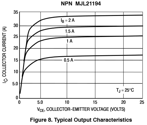

I think it is a waste of time to convert the models which we don't have Ic/Vce information for. I would only end up reworking them later when data became available. I will only bother converting the models that have good datasheets or curve tracer data.
Yes - this is what I meant before. The transformed model will not have more informations as the original sgp model.
The way can only be to identify (with the knowledge of this forum) the devices showing the effects which are covered by vbic like quasi-saturation, unsufficient accuracy in go or avalanching. Then using your script to generate a starting vbic model and manual fit the responsible parameters for this effect.
E.g. the attached heavy metal guy (and partly his pnp counterpart) show clear quasi-saturation. I am sure that is possible to tweak RCI, GAMM, VO, HRCF to get a more or less accurate mapping of this effect. Not to forget that some other parameter have to modified too.
BR
Dietmar
