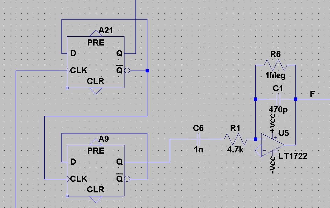

I have a small question, how can I get symetric output voltage from a Dflop getting from digital?, normally I do not need that but because I put a square into a triangle I get error except when use a cap, but then it takes forever before the stable voltages are reached, it starts nigative and slowly when cap charges get into normal plus and minus 1.5 volts triangle. Or is there a way in ltspice to get a stable point right away?.
Thanks.
For a capacitor you can add
ic=1.5
after the capacitance and this means the simulation will start with the capacitor having a 1.5V charge (the Initial Condition). So you can run a simulation until it stabilizes, record the capacitor charge and use that as the initial condition.

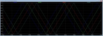

Here is the square to triangle, x 4 for multilevel class D inverter.

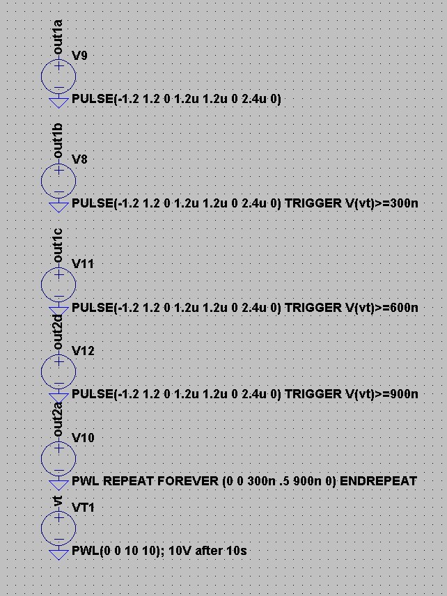

This did not work properly, better is four voltage sources who make the triangles.
However I get not excactly the proper 90 degree distances, somebody see maybe a mistake somewhere, I did 300n, 600n, 900n has to keep the triangles the same distance.

Try this. The simtime variable can be the same as the variable used for the .tran command. This is because setting the voltage to zero still causes integration errors at the triangle tips, unless the source is delayed out of the simulation timeframe, so to turn it off the delay is set to the simulation time.
Symmetry can be adjusted.
This is the most accurate and fast triangle generator I know of, because it uses hardcoded SPICE primitives. But the phase cannot be set below 90 degrees.
I updated it to be a bit more comprehensive with multiple input options. You can specify the shape using different combinations of risetime, frequency, symmetry and delay.

You just have to use multiple sources and add the correct amount of delay per wavelength.
Thanks I will try, see that quality of triangle is better also, I have sometimes strange top voltages.

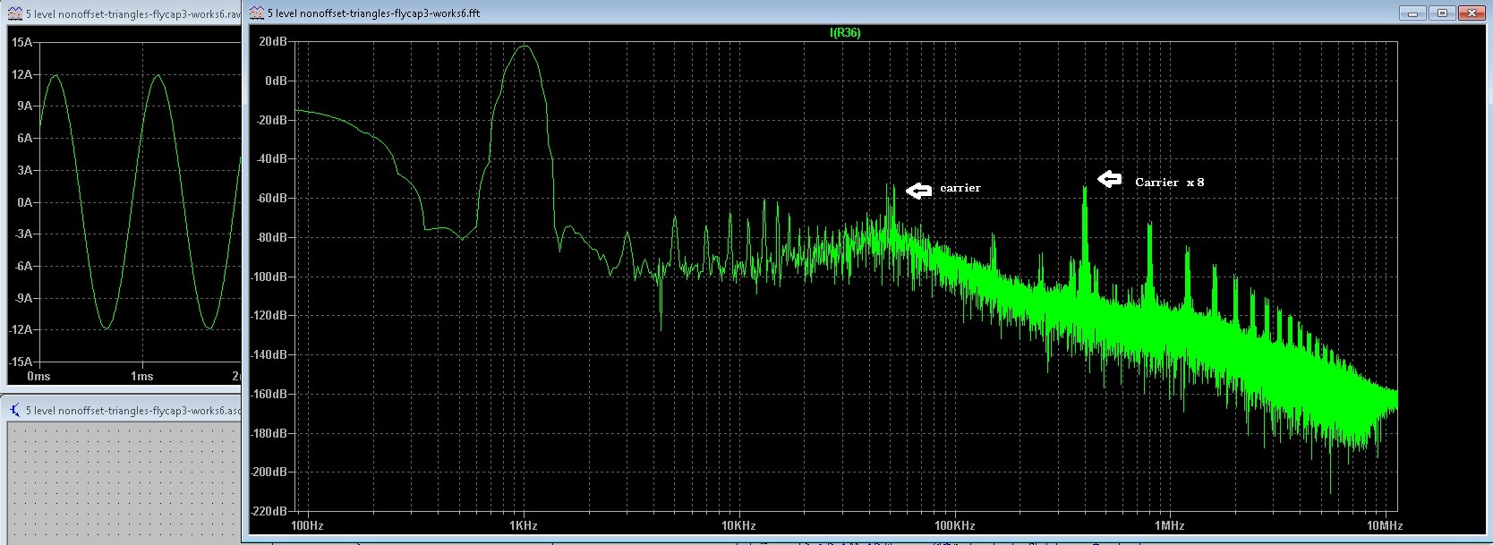

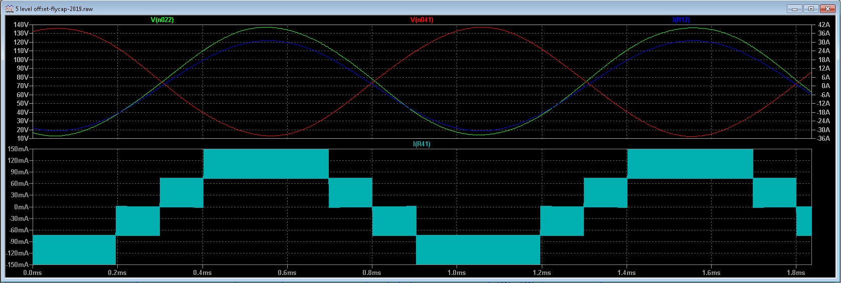

Here is the plot of the 5 level class d see 300 Khz become a lot higher, your triangels are much more precise as what I had.

Have change the degrees, and it works like a charm, was for the 8 level class D postfeedback test, did nicely multiply carrier by 8, running on 50 khz, simulation now is a lot faster...

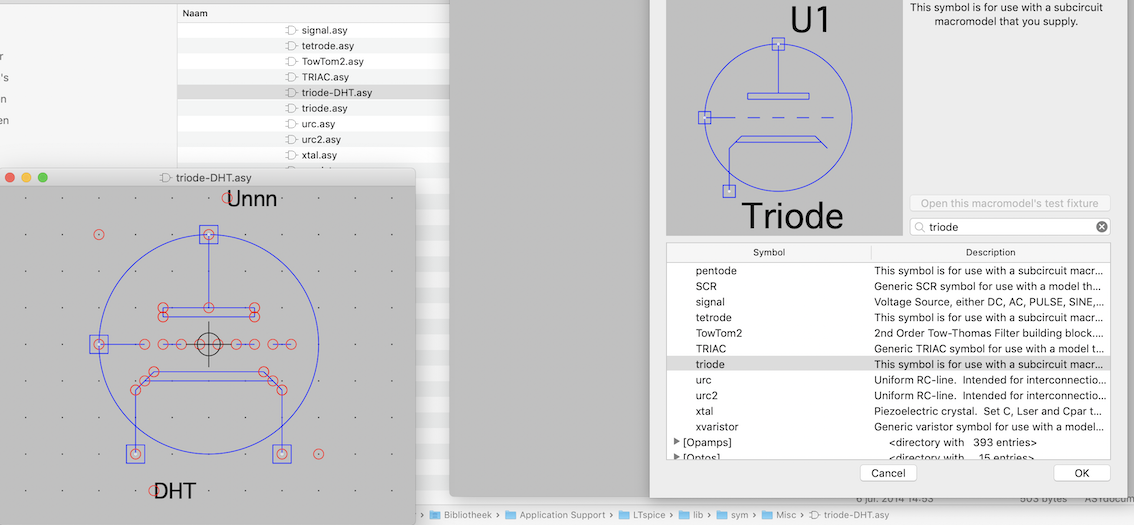

I am struggling to add a device symbol variant: I made a DHT.asy, placed it in the appropriate /misc folder, but it does not appear in my list. The path in the selection box is the same as where I placed it, but only the triode.asy shows up.
- Macos; LTSpice Build Nov 29 2018; I unhid the file in the appl folder and it is there
What am I doing wrong?
Oops I found out - have to restart LTSpice to clear the buffers. 😱

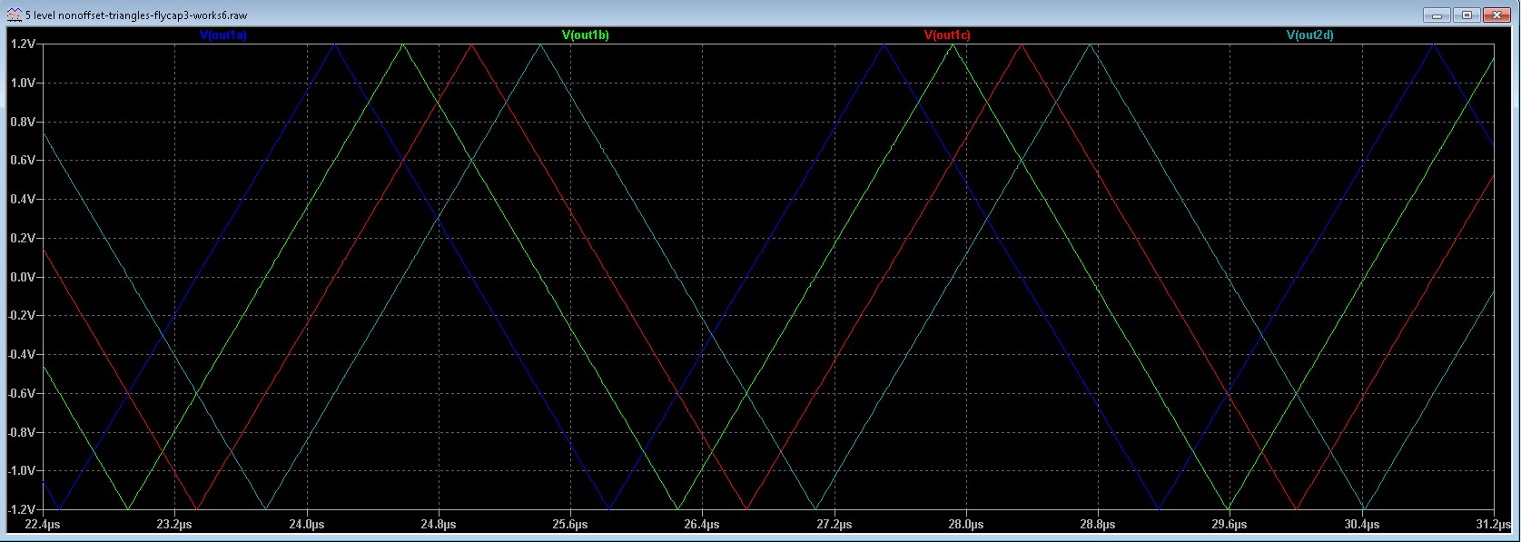

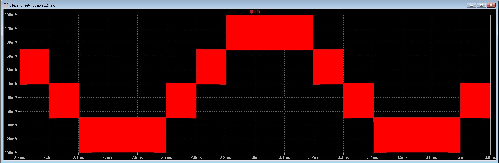

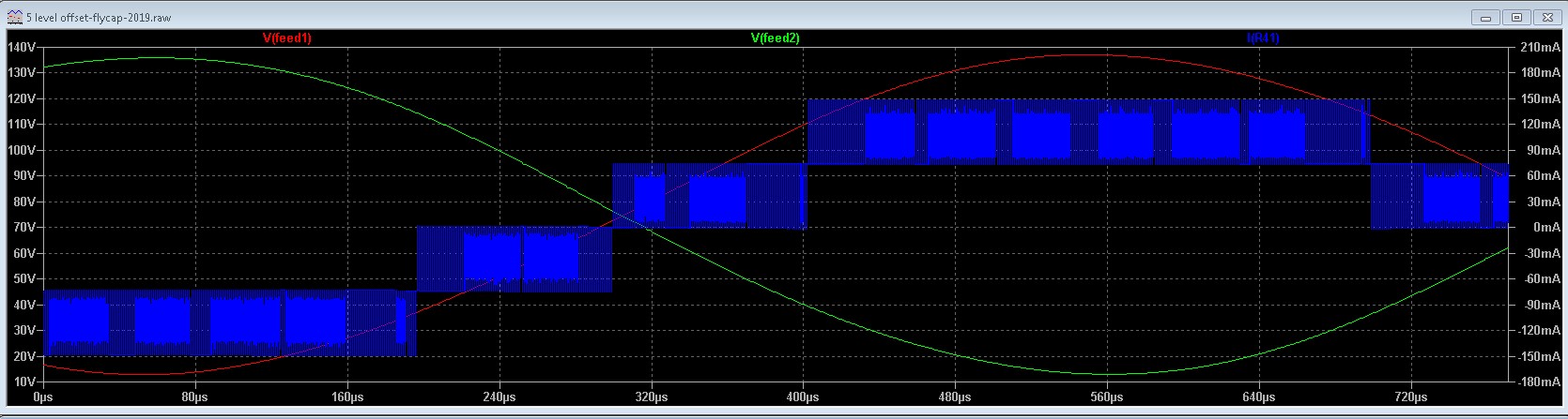

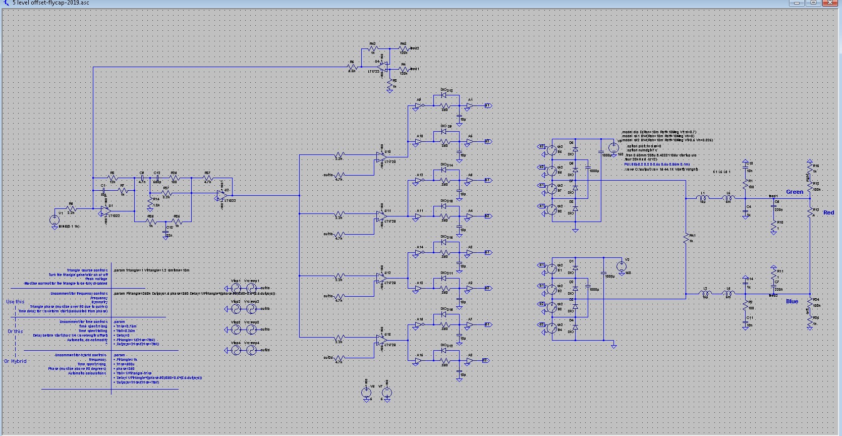

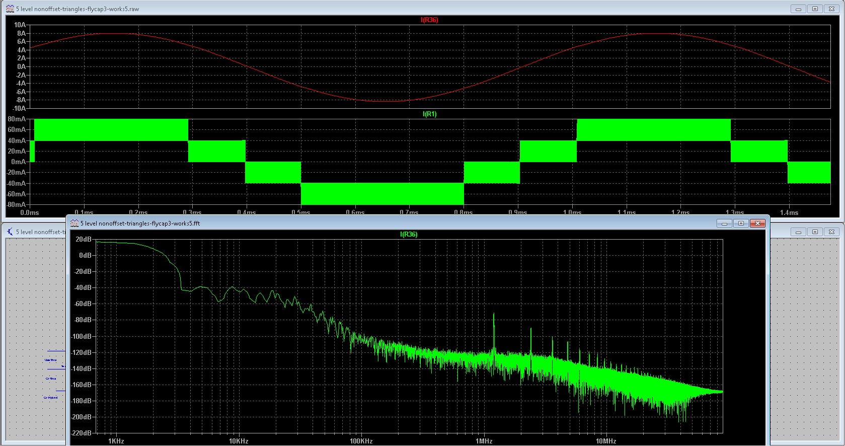

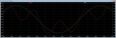

I get a very strange output voltage from a 5 level class d, de current is very nice sinus (green) but voltage itself on output is messy, (red) is this a common mode problem? the input triangels are 90 degree fase shifted. Can LTspice do sim these right?
never mind, I did find it, the first has a 180 degree shifted audio signal, now I have put that to a single imput signal and four 90 degree fase shifted triangles, did invert one side of the output stage and it works now., iy is quite tricky:boggled:

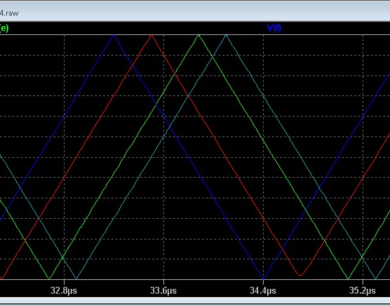

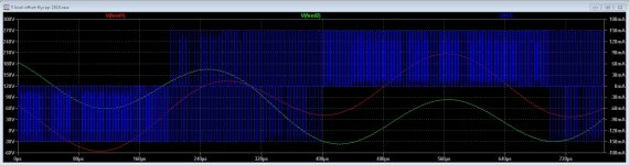

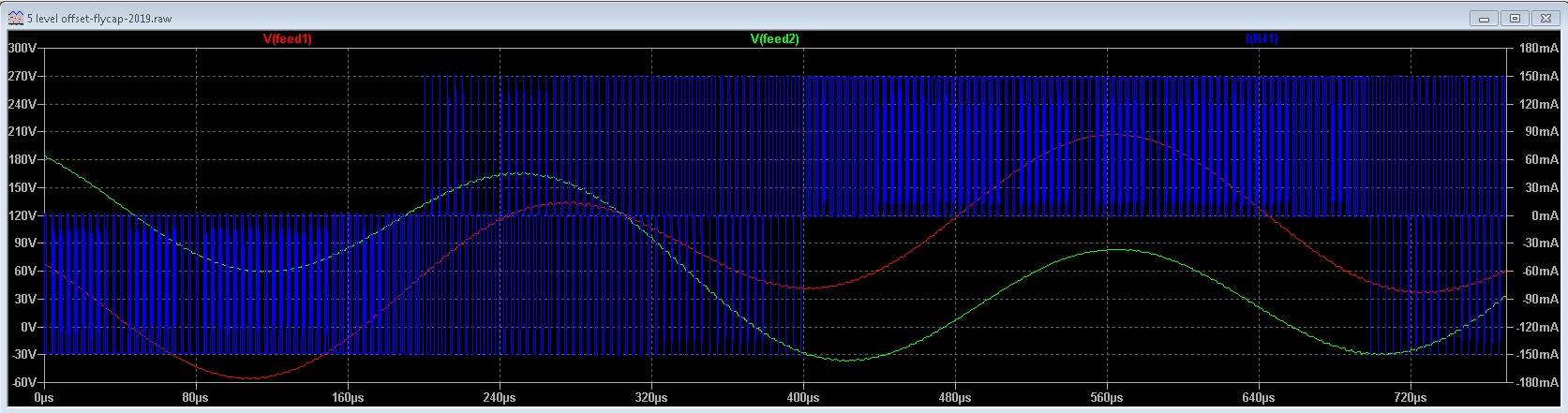

Wel it is late here but i did try to use a feedback.
Wat I now discover is that the problems arrive if I set startup uic on I get respons as in pic 1, when set startup uic off in pic 1 I get as in pic 2 that is the good respons.
Can someone explane that?. Maybe it is normal behavior but do I not now why, it is important the sims go wel otherwise it is time consuming until I dixcover it are the settings who are wrong.
thanks.

I made my triangle generator so that the initial operating point of the triangle source was always 0. Other triangle sources start at the upper or lower level which causes DC drift if for instance simulating an amplifier. If you want to try it without the operating point adjustment you can disable the Vtop sources.
Other than that, without seeing the simulation I would have no idea.
BTW, where do you get your info for simulating class D?
Is this maybe a reason that the simulation go wrong sometimes and then it does work, maybe because of the sources you mention?.
I have the info from google, I use the multilevel inverter info everywhere seen there, and a new version of postfeedback but need to calculate for used low pass.
What simulation you need to see, the schematic?
regards
