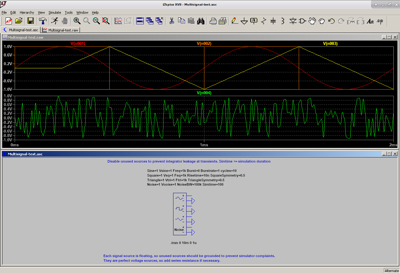

Here is a signal generator. The symbol and internal schematic are in the zip file, they must both be in the same folder as the schematic you want to use it on. I recommend opening Multisignal-test.asc and copying the generator there to your schematic.
Thanks. I've been posting my Ampsim rig for years and no one ever used it, so I figured I would try a different tactic. I wonder if anyone will use this? BTW, I've been tweaking these generators for years, there are subtle things that make the operation less buggy.
I could break it up into individual sources, but I would rarely use it that way. Maybe I should mimic the Microcap generator symbols?
With all the sources together like this, you can do stuff like put the sine and square in series to test for ringing at peaks.

Thanks a lot, keantoken.Here is a signal generator. The symbol and internal schematic are in the zip file, they must both be in the same folder as the schematic you want to use it on. I recommend opening Multisignal-test.asc and copying the generator there to your schematic.
I will use-it, for sure. Exists-it a way to add-it to the components Of LTSPice, to can use-it directly like the internal "Voltage" ?
I would think it would be very useful as it really is a very neat idea. I'm out of time for today but I'll hopefully have a go at trying it in a real sim tomorrow.

I was going to update it for that, but I wanted to wait until people had tested it in case I need to make some changes.

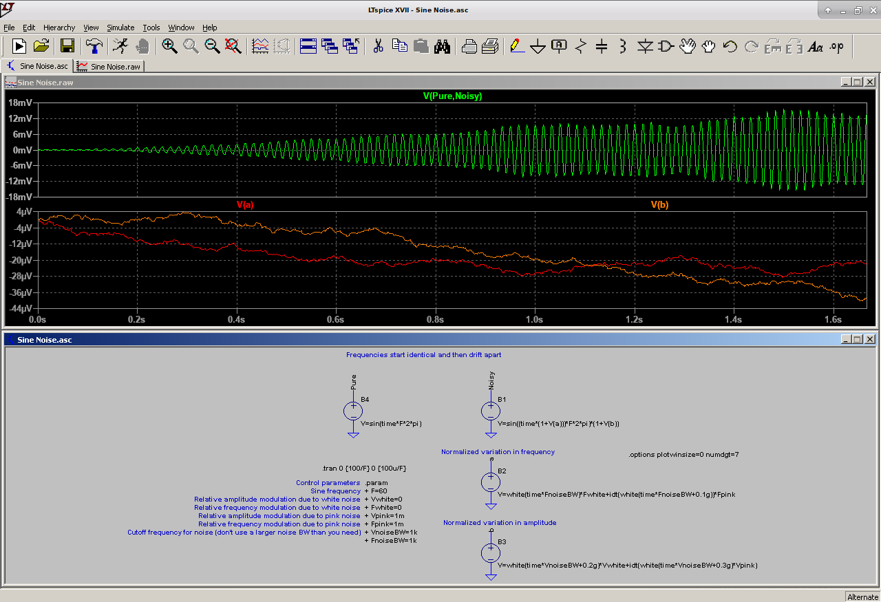

Hello all again. Is there any way to simulate random variations in time and or in frequency and or in amplitude from the voltage sources available in the LTS4?. I want to test a tube voltage regulator composed by a 6B10 cascoded and a 6FM7 as series pass element. Many thanks in advance.
You have to use expressions in b-sources. Here is an example.

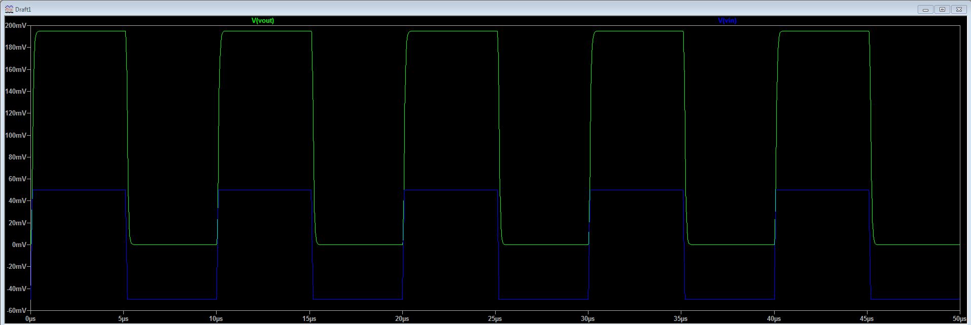

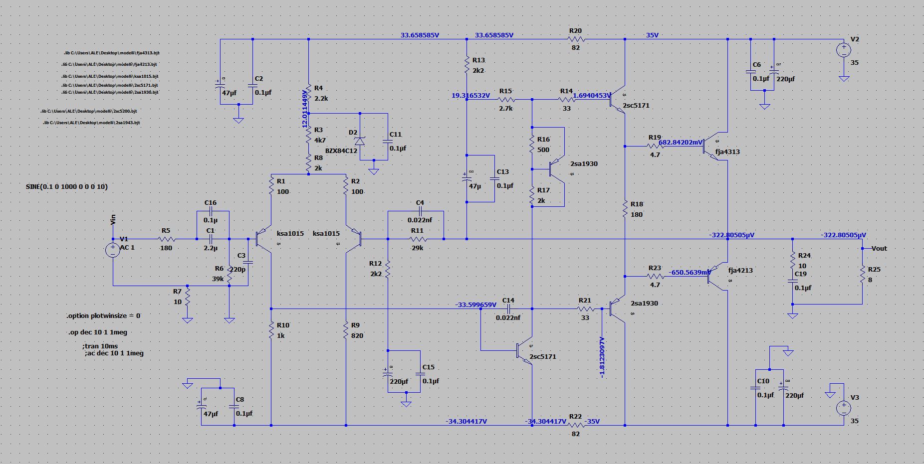

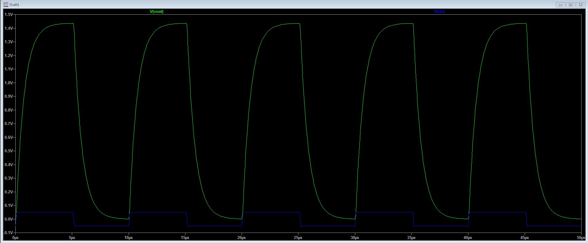

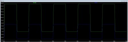

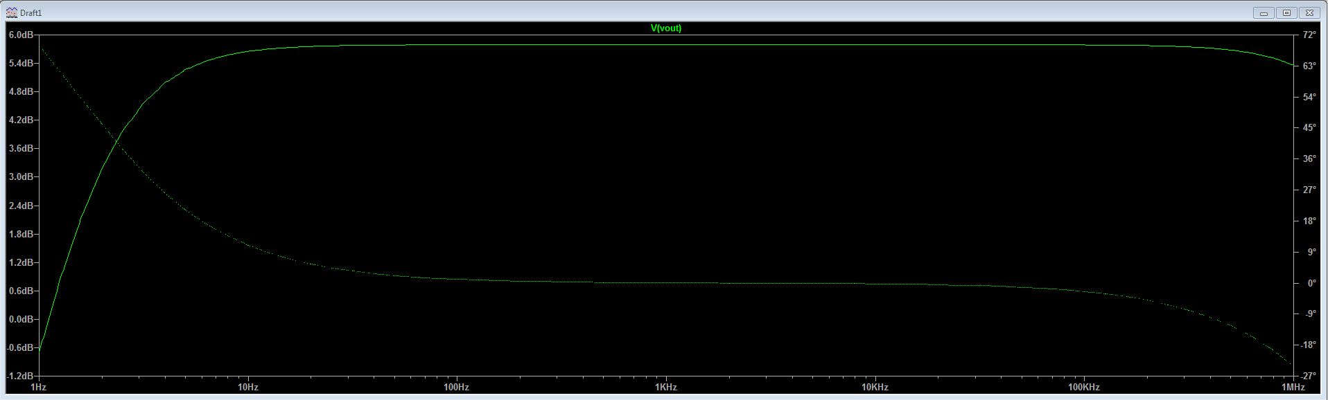

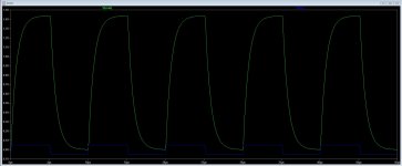

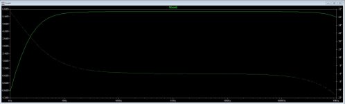

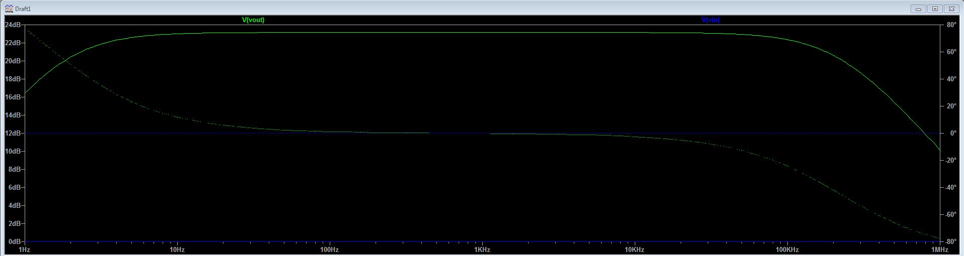

Hi, I'm am a beginner and I don't know if the right place to ask, but I try. I'm doing simulations of an amplifier found on the internet in which I have replaced the transistors with others similar already owned. By doing square wave simulations I got poor results. Only by modifying the gain resistance R11 to 2K does the square wave adjust itself, but obviously I lose amplification power. How can I do to solve the problem? I attach diagram and graphs.
Thank you
Thank you
