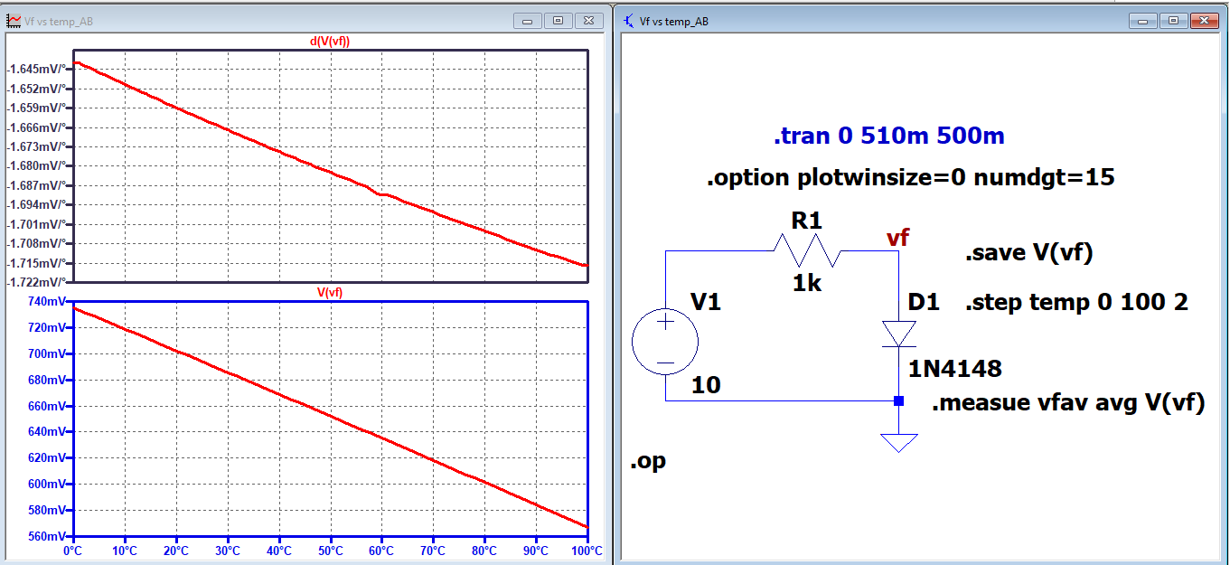

I plan to design a fan speed controller, but first I need a way to simulate/plot thermal response. With some help from an analog web page, I came up with this:
