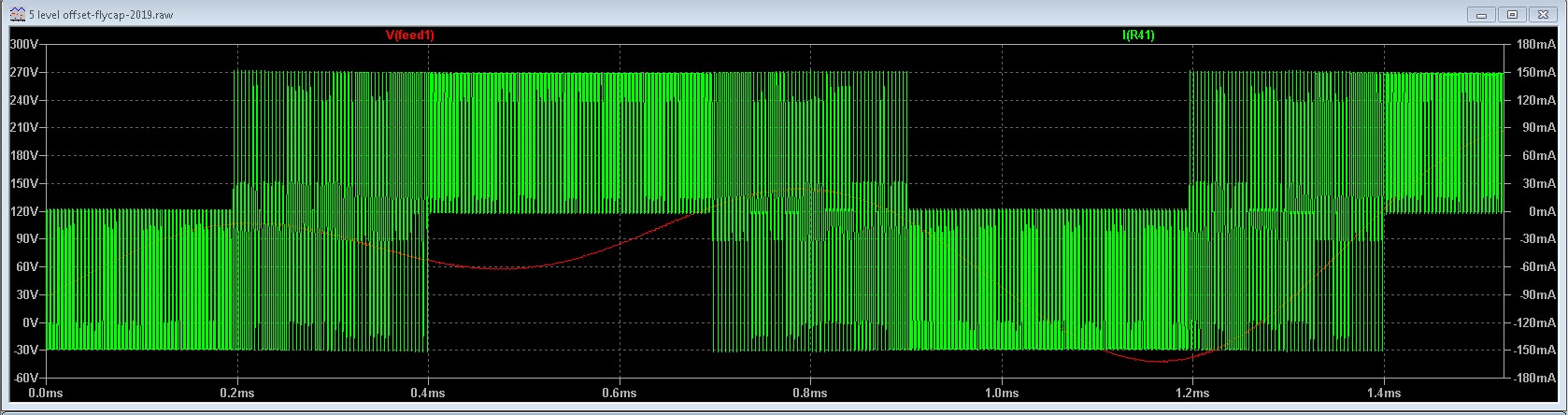

Is it possible your amp has a resonance and that the startup transient simply causes it to resonate? In this case you have to adjust feedback to reduce the resonance or wait for the resonance to decay.
I have see that when I let it sim for longer time it does decay. Maybe because of the flying capacitor not yet being balanced a kwown problem with flying cap outputs.

Try adding a 'huge' (like 10T or more) resistor in parallel to the flying capacitor.

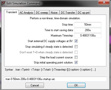

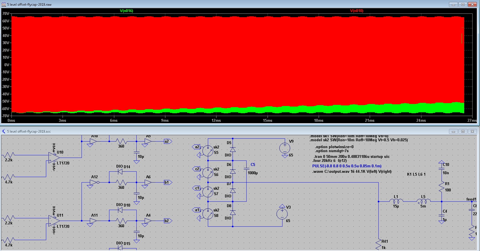

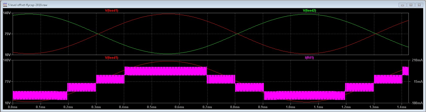

Here I have done something for resolve it.

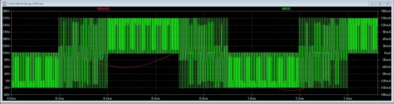

The first pic you see a strange switching patrone, in pic two you see how it is needed.
what I have done is untick the Start external DC supply voltages at 0 volts and skip initial operating point solution. Then the output is oke like in pc two,
as you see resonances on output or common mode voltage is gone..
I go try the resistor, I do also read that capacitor balance can be cured with a charger, a mosfet can be used who is on for very small time charging the capacitor.
However that is why I am here do not now why LTspice does this fault, or how it change so much in results.

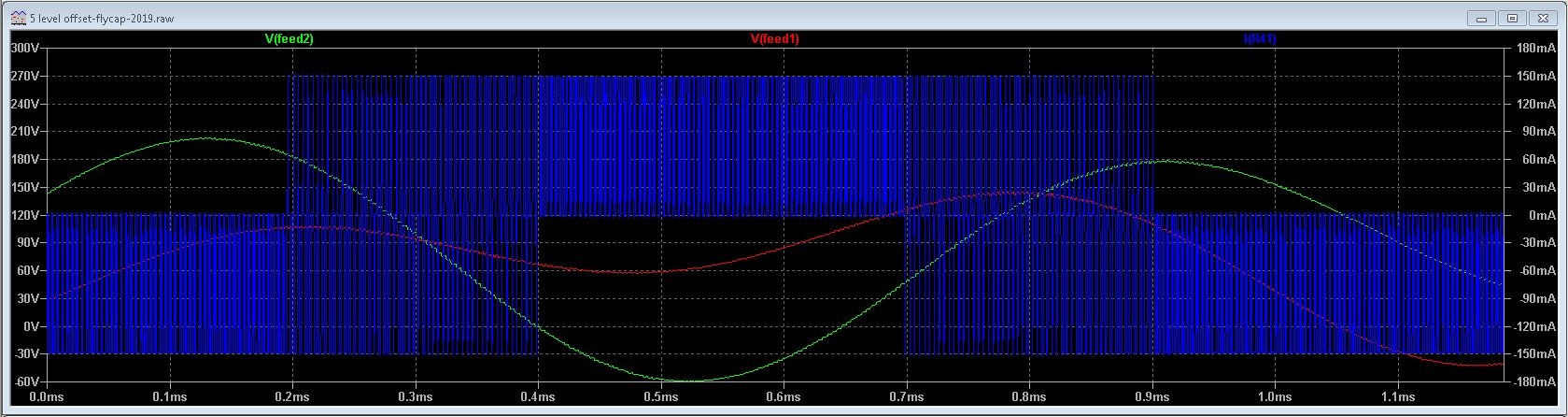

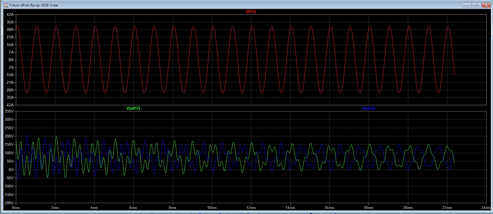

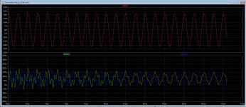

The resistor did not work, get the same, it has to do I think with capacitor unbalance, need a voltage source with a small 1 second on time driving a mosfet charging the cap first, then see. till later.

About the resistor, I think when 'floating' or 'flying' or otherwise capacitors that have no common in/out circuit (like servo's) then introducing a parallel resistor can/will/may solve problems. Just think about it.
The problem is that the capacitors that you are using (in spice) are ideal and have no leakage, some circuits may/will/can 🙂 behave unexpected with 'ideal' capacitors.

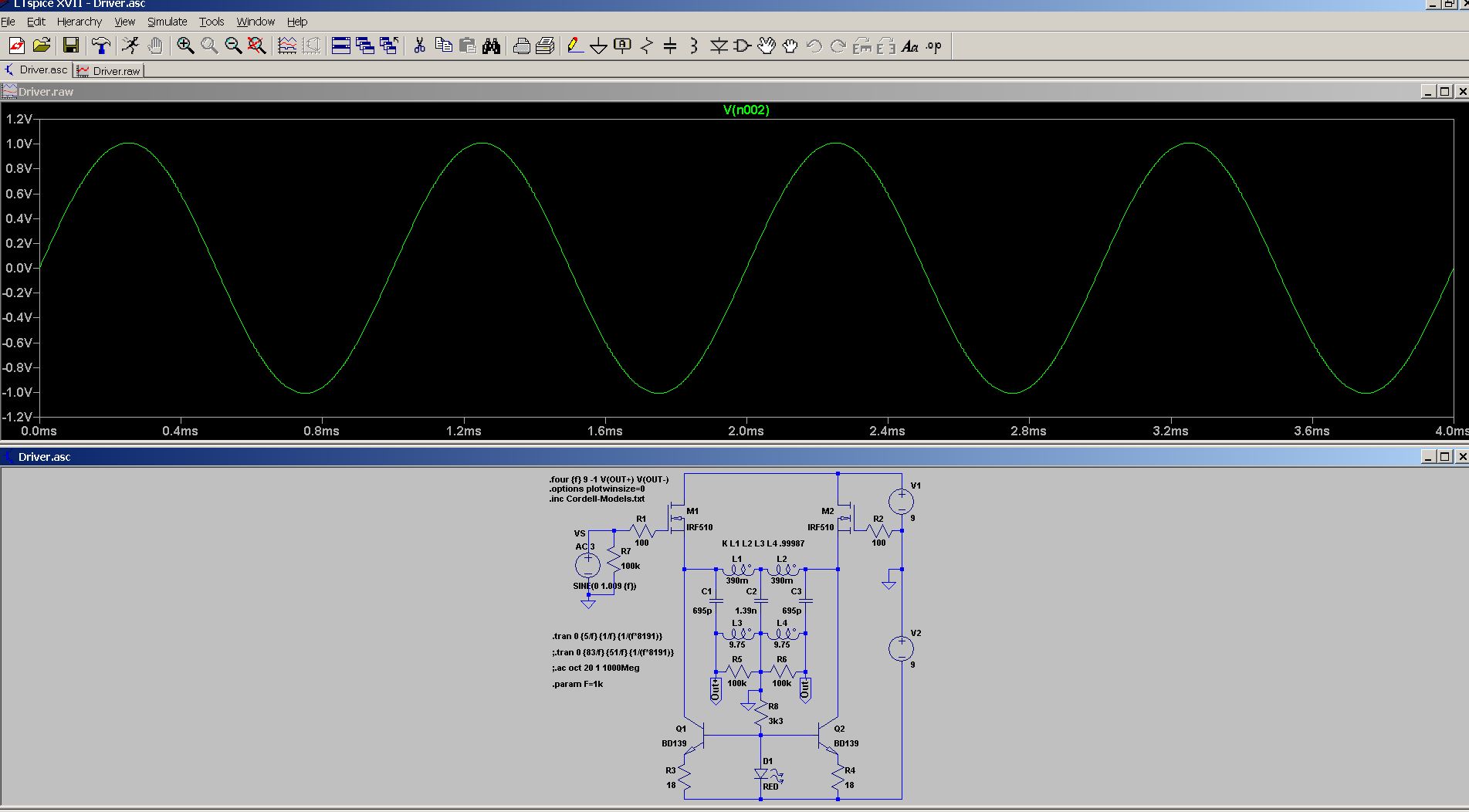

I have seen after simulation that indeed the flying capacitors do cause the problems, I can make a precharge circuit, with a voltage source who do set on for one second and then a other puls or inverter who do connect to voltage.
In real live afcause things go faster.
Did see something from internet.
The "AC" voltage applies to a frequency response sweep, but your simulation is running a transient analysis. If you intended to increase the source signal for a transient analysis, you need to change the "Amplitude(V)" parameter on the left side of the VS dialog box from 1.009 to 3 (or 3.027 if you want to increase it by a factor of 3).

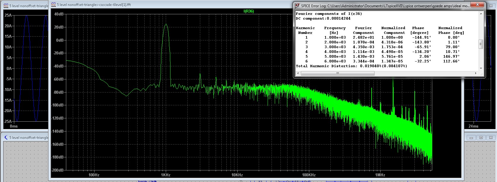

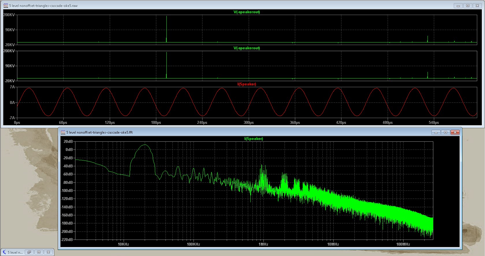

I get now good respons from LTspice, a 7 level with different way of setup the fase of the triangles can remove a lot of HD. here you can see how low it is in open loop. Interesting this on 25 amps output current.
The setup in LTspice is quite important, so I did have learn some here again. thanks for that.

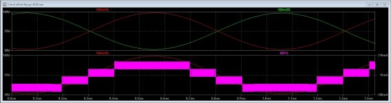

I did try to find the unity gain point for the 5 level pwm amp, normally the Nquist theorem is used, somebody has a tip how to find the unity gain?
