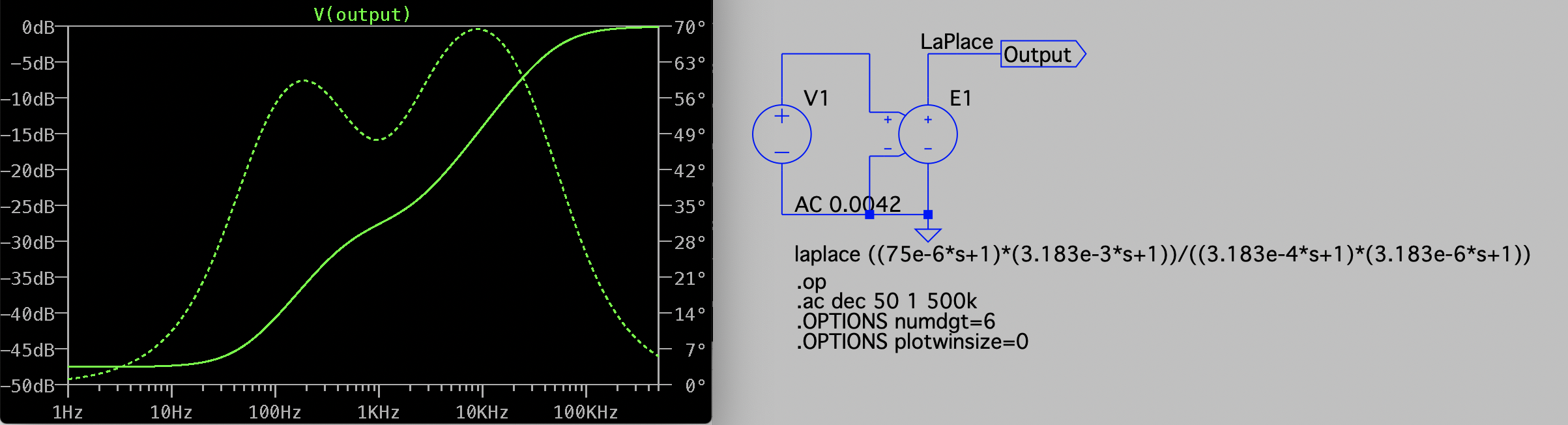

You don't want to get integration errors by shaping a sine sweep with a Laplace element or RC circuit in LTspice.
It would be better to generate the sweep directly with an equation. I was working out how to do this, but got stalled by what seems to be a bug.
I'm sure I saw RIAA filters in Audacity once. If you can find it you could generate a sine sweep and then apply an inverse RIAA filter to it.

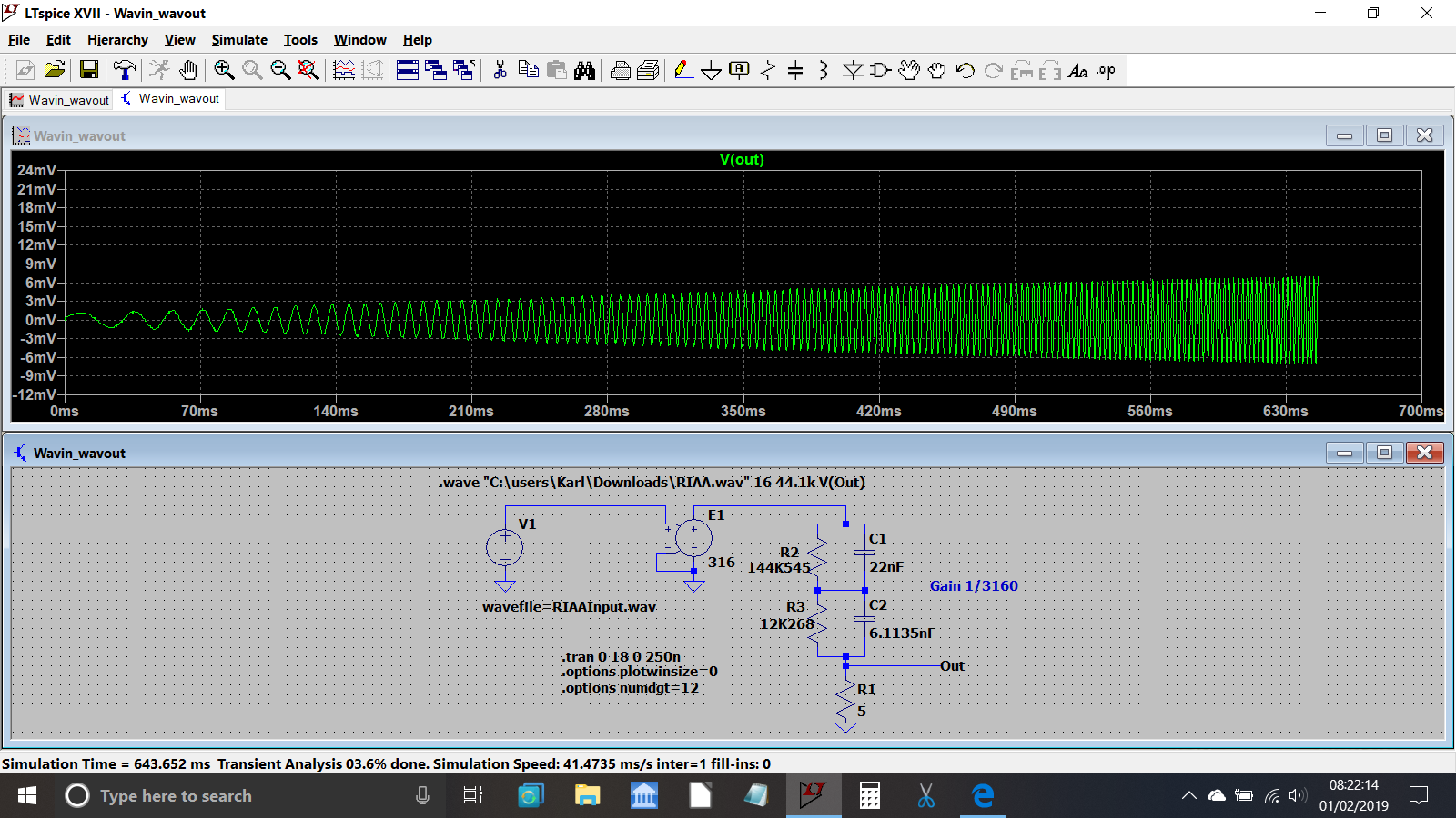

I have a very accurated anti riaa generated .wav freq sweep from 20 Hz to 20Khz in 18 sec. Sent me a pm with if you want it.If I remember correctly, somewhere in the manual I read that LTSpice can also generate a .WAV file of an output.
I want to generate an inverse RIAA WAV file so I can test my preamp with it.
Can anyone help?
albert
Also included is a .asc file where you can uses wav files as input, thereby generating an anti riaa file as output on your desktop in 24/192.
Hans
In the .asc file attached to the above posting, there is a short circuit between in&output at voltage source E1. This interconnection should not be there of course. E1 is there to give control over the amplitude of the output voltage.

Hi Mooly,I did a 30 sec input file and forgot to change the sim to run for 30s but otherwise all good. .wav file (44.1) exported OK. I'm guessing the double digit precision slows things down a lot, the sim took several minutes to run.

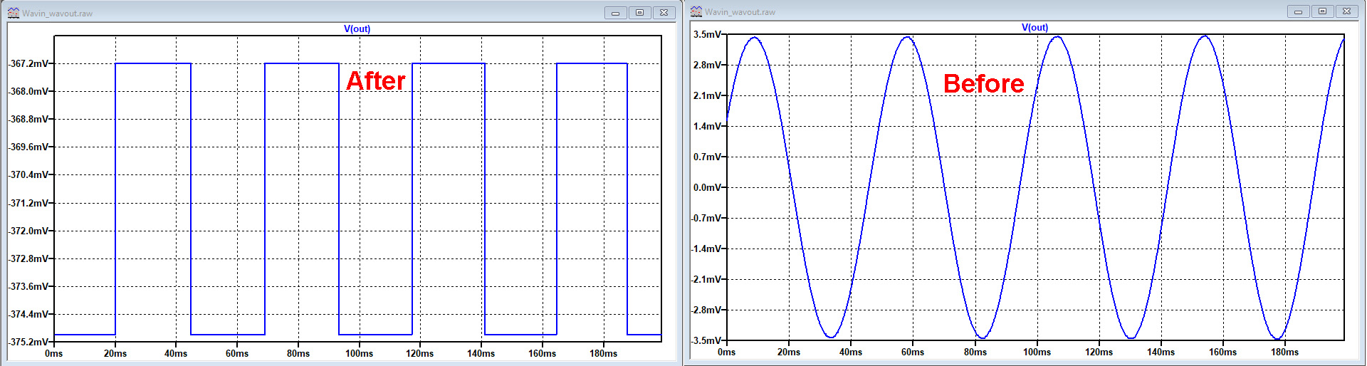

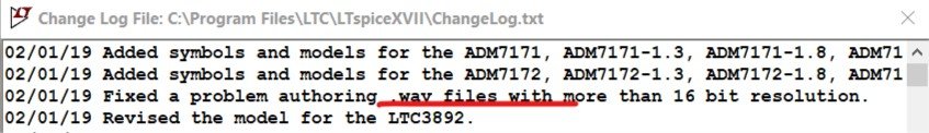

I tried all usual frequencies with LTspice XVII in between 44.1K and 384K.
As long as the word length is 16 bits, everything is fine.
But from 17 bits up to 24 bits, you will only get rubbish in the generated .wav file.
See image below, that is even relatively recognisable, but the outcome may be much worse.
Importing .wav files up to 24/384K no problem at all.
So we have a wave export bug in LTspice XVII.
And again, LTspice IV works without any problem importing and exporting with all word lengths and sample frequencies.
Hans

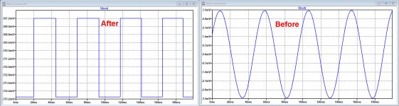

Hi Mooly,
Hans
Thanks Hans
Part of the problem for me is that I just don't use these features often enough to fully get to grips with them. Each time its an adventure to get it to work and this is one reason I make notes along the way... because I'll have forgotten next time.
I made the switch to LTXVII and now don't have LTIV installed at all.
Mike Engelhardt is pretty approachable over sorting bugs although I'm not sure how easy this one would be to fix.
