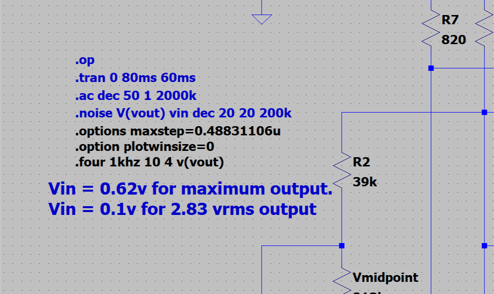

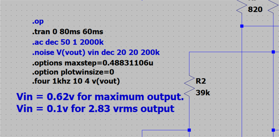

When you know the syntax of the various simulation settings (lol, I don't and have to use the normal 'Edit Simulation' method to derive them) you can enter them all as comments rather than as we did before.

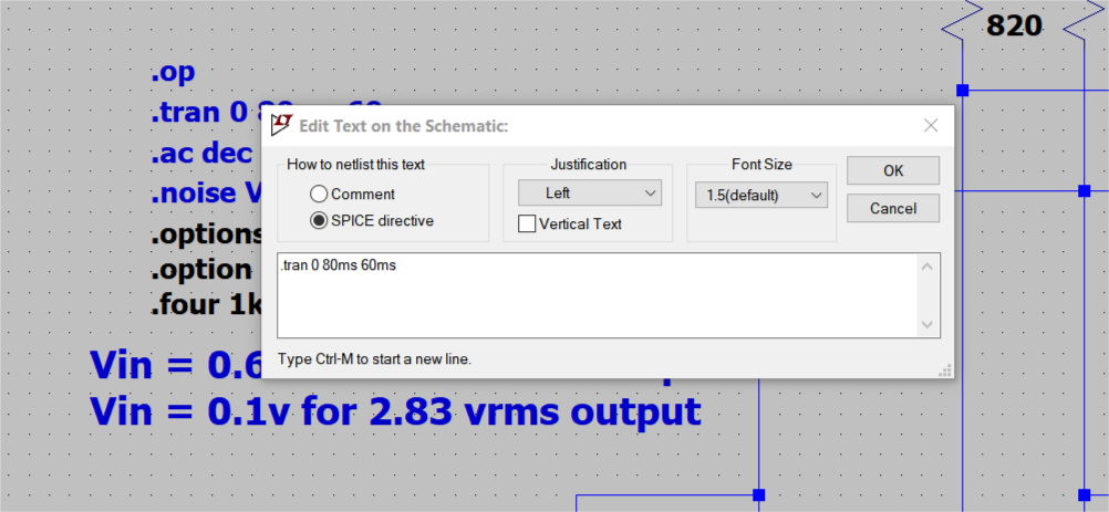

To run any of the options you hold CTRL and then right click the option you want on the workspace (such as .tran here) and change the directive from 'Comment' to 'SPICE directive'. That enables that function. To change from 'tran' to '.op' you do the same again, deselect .tran by making it a comment again and then enable .op in the same way.
All the options you want have to be set up as . (dot) xyz at the same time and not ; for inactive ones.
