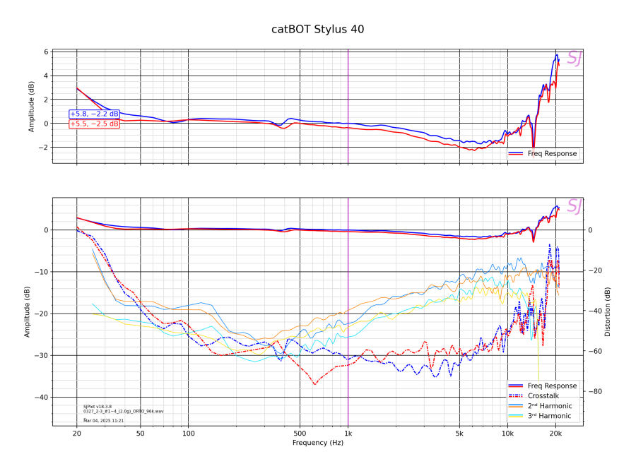

I check the channel separation with a test record, where a gliding tone is swept in only one channel at a time.
There is no what they call elliptical filter involved in this (test signal) recording. If it was - then the separation would appear only above ~150Hz.
Because on a TT I play with the main resonance is at 13Hz and it is not damped at all, it affects the tonearm behaviour at as hight frequencies as 30~40Hz.
So, I see huge bulge near 20Hz - in both channels simultaneously, at ~30~50Hz the crosstalk gets better. Along with this crosstalk curve - the THD curve also goes down.
On a properly damped tonearm there is no such ILF bulge of the frequency response and no huge crosstalk and THD either.
If I had QR2010 I could provide some measurements data - how bad is my first tonearm and how good is the second. According to the specs - the second one has its' ILF resonance so well damped that the ILF hump is only about 2dB (at 8Hz). I suspect my bad tonearm has a ~20dB peak at 13Hz.
This makes me believe, as I said earlier, in the resonance nature of the HF crosstalk/THD plots. And because it is not the needle+vinyl resonance, it must be the cantilever flexing one.

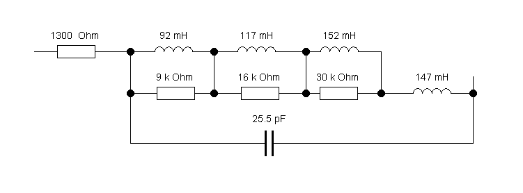

But back to modeling the driving transducer coil. Marcel vdG. has provided us with six support points. Let's use them too. Shure recommends up to 400pF || 47k up to 70kOhm, with no audible changes. We need an electrical replacement model with a very wide range of validity. It should be 100Hz to 200kHz.

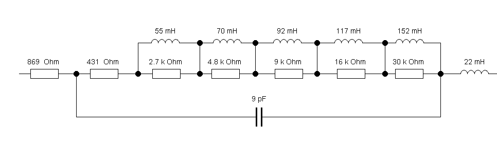

Attached is another network option.
HBt.
This certainly is a point that deserves some attention.
When flexing of the cantilever would be the cause of diminishing channel separation, I would expect this to be visible as a drop in the carts frequency response.
1) The measured FR of my Benz cart is that it has a flat response within +/- 1dB up to somewhere between 40kHz and 50kHz.
2) However the channel separtion is the same bathtub curve as most carts, rising sharply as from 5kHz upwards,
To me 1) and 2) do seem contradictory in case of seeing flexing of the cantilever as the cause of diminishing channel separation.
Hans

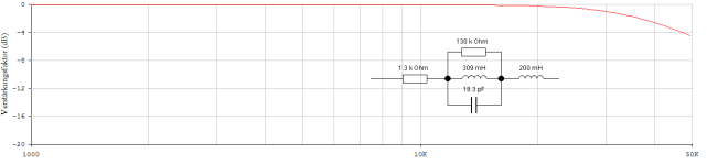

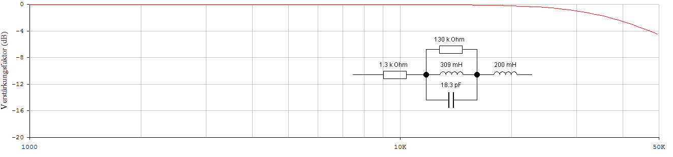

Are you quite sure that there is no series resonance in the range between 120kHz and 200kHz? If there is, then the following model is perfectly valid.
And the Shure V15 III is ideally suited for Rterm up to 150k, even Shure writes that even with a large Cterm and 70kOhm there are no audible negative effects.
In the picture 150k || 22p!
So all the fuss from the seafaring nation is nonsense. What remains is the mechanics, and you can't even grasp this with your means. Or can you? Then please explain it in detail - and above all credibly.

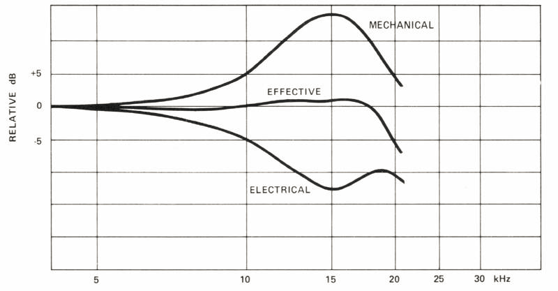

One of the artificially induced points of contention is the above (very well-known) picture from the mid-1970s. Perhaps it shows the infamous Shure, an Ortofon or a Philips MM system. It is important to know that the achievable upper cut-off frequency is a mechanical resonance. It is formed by the complete mass of the stylus (the tongue, cantilever) and the elasticity of the record groove. Of course, the stylus cut and the contact force must not be forgotten. In other words, the scanning capability above 6 or 10 kHz, for example.
With regard to THD in this frequency range, the observation and empirically supported assumption, which is now over 50 years old, can also be repeated endlessly: it is causally related to the “mechanical impedance” and the necessary sampling capability of the system at high signal modulation frequencies.
Finally, there is a mechanical-electrical converter.
Two sides of the coin:
mechanical and electrical!
