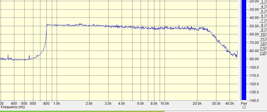

I think most of the cartridges in the Hans Polak document should work well with 150 kohm, by the way.
Even no documented @ Hans Polak budget cartridge work well, as in attach

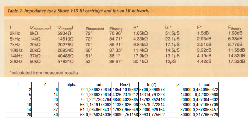

I can't remember a time in my childhood and youth when people talked about optimal termination capacitor.. However, I assume that the (total) capacity in question must have been in the order of 200pf to 400pf, as the DIN connection cables of the time were often quite long, plus plugs and sockets ...
Load capacitance 400 pF to 500 pF according to the user manual (...)
I do not know why DUAL did not specify a C_term, one can only make assumptions. They probably didn't want to confuse the customer unnecessarily. But one thing is clear: if SHURE specifies a capacitance of >220pF, then the frequency-dependent losses in relation to Re(Z) and Im(Z) are high. In other words, the pure inductance value of the MM system drops considerably, while the resistive component rises slowly. There can be no other explanation for such a large terminating capacitance. L_cart (of f) falls.

See post #17. The blue curve doesn't look high-Q to me. It looks more like a gradual roll-off to correct for a highish-Q mechanical resonance. The inductance as a function of frequency can be calculated from the impedance magnitude and phase data, if anyone should want to do so.
That would imply that the smaller the initial MM’s inductance the larger the needed inductance will have to be.
If you replace the second inductance word with the word terminating-capacitor, it becomes a shoe.
1/omega = sqrt(L*C)
Many Carts needing much smaller cap values are telling a different story.
The agreement was once: "terminate with 47kOhm."
47000 [V/A] = sqrt( L/C)
Instead of this being the “only” explanation, the mechanical part of this Sure V15 Cart may have an early roll off that has to be compensated by a higher Q of the electrical part by using a relatively high cap value.
Let's stay on the purely electrical side for a moment and ignore the mechanical part.
15000 [1/sec] = 1/ ( 2*PI * sqrt( L*C ) )
These are the first parameters: we know that L_cartridge decreases in value with increasing frequency f (or omega), which implies a different capacitance as termination from the starting point, if we take Z(fh) and fh itself as defined constants.
And only now do we turn to the mechanical influence (of the masses, the oscillator and the trafo, ...) on our desired frequency response.
The said Shure system (a sanctuary) should be sufficiently known and described after more than 50 years of pure existence. We no longer need to guess any riddles here.
HBt.

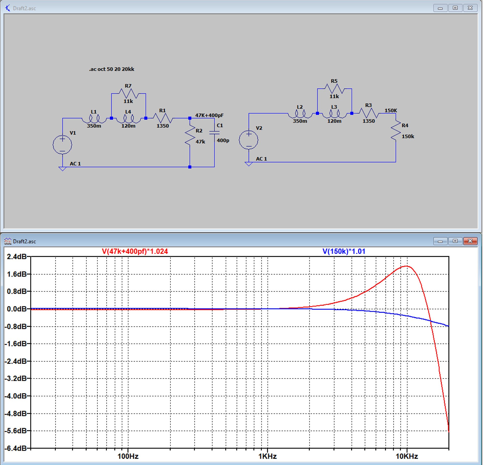

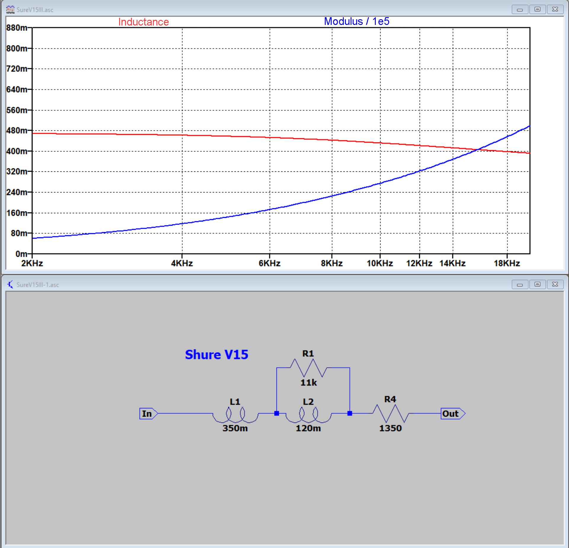

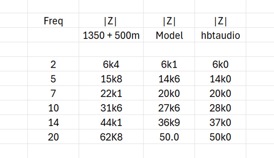

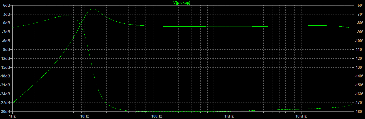

But using the measured |Z| values that hbtaudio presented, I made a coarse model having within a few percent the same impedance values, see first attachment.
Coarse because the presented measured data is not very accurate but rounded to 1000Ohm steps and because it only goes up to 20kHz, but anyhow good enough for a start to get more insight.

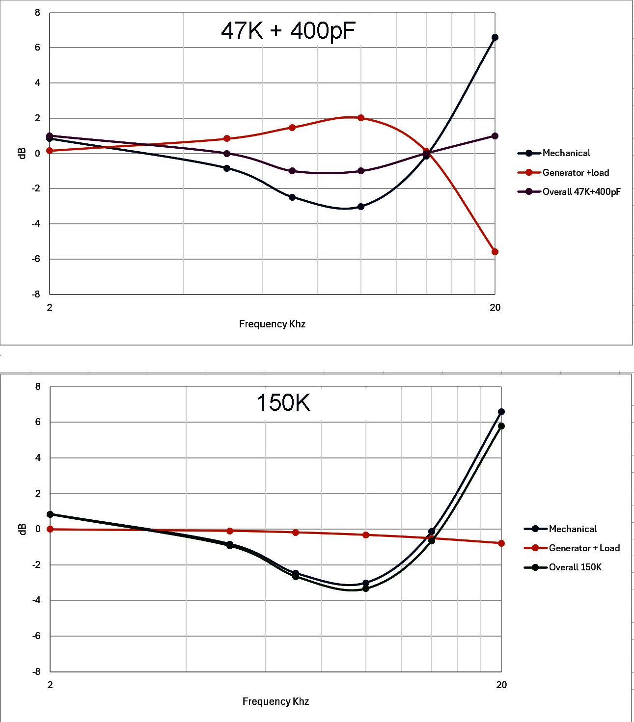

In a LTSpice model with 47K//400pF as well as a second version with 150K termination load the Generators response for both versions could be determined, see second attachment. The 11K resistance //120mH is caused by and represents the eddy current losses.
Now looking at the V15 III frequency response in #35, the overall FR can be found, from +1dB@2Khz to -1dB @10Khz and back to +1dB@20Khz.
Assuming the measured impedance values from hbtaudio to be relatively correct, the mechanical FR can now be determined by subtracting the generators response from the overall response.
See third attachment.
The upper part is for a 47K+400pF termination.
The mechanical FR must have a high Q to compensate for the generators roll off, both together resulting in the FR as in #35.
Now using a 150K termination it will have to deal with the same mechanical FR, that's why overall response becomes rather dreadful, varying from -3.5dB to almost +6dB.
As a conclusion from these simulations based on the above input data, this Shure cartridge does not seem a good candidate for a 150K termination.
Hans

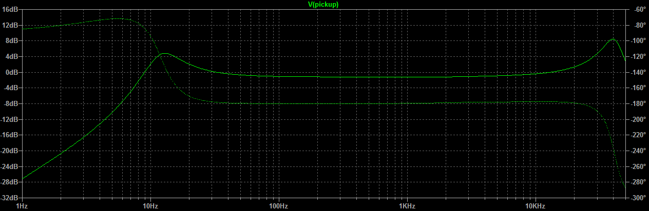

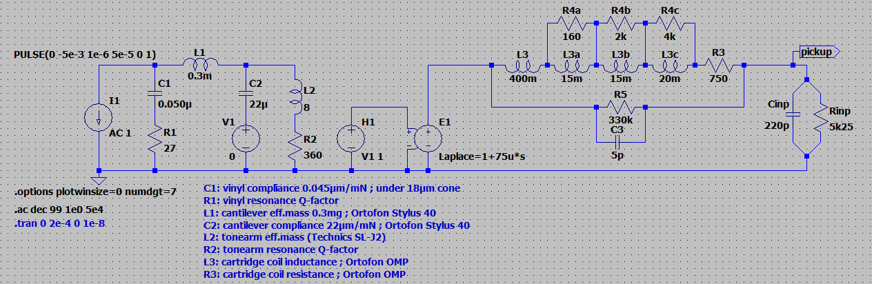

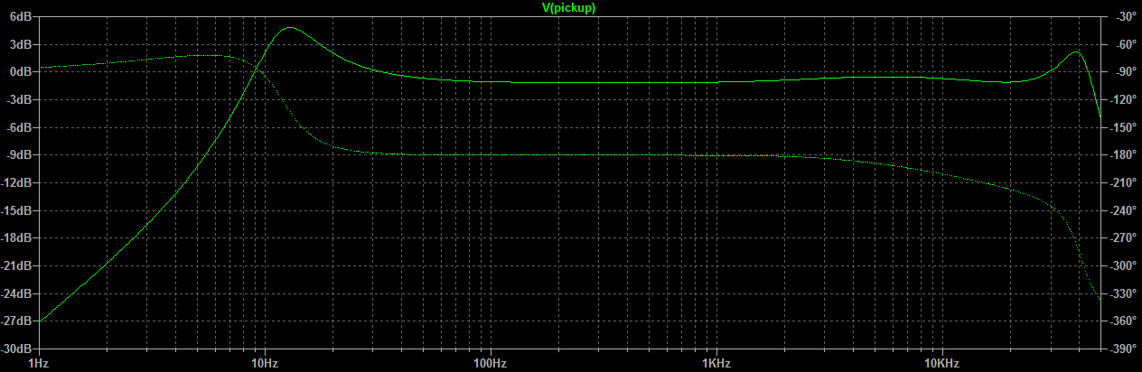

To evaluate the impending disappointment (regarding my expectations of LR75µs benefits) I created a fictitious cartridge model based on this Hans Polak's document. Factory specs for Ortofon OMP are 450 mH+750 Ohm.
With my realistic cable capacitance (and switching the needle+vinyl resonance off) the LCR behaviour is not so frightening:

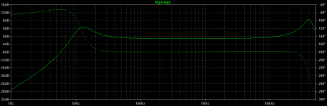

But the needle+vinyl resonance at ~38kHz changes the nice-looking picture drastically:
It may be somewhat tamed by Cinp == 1n5, but that is far from what I dreamed about:
