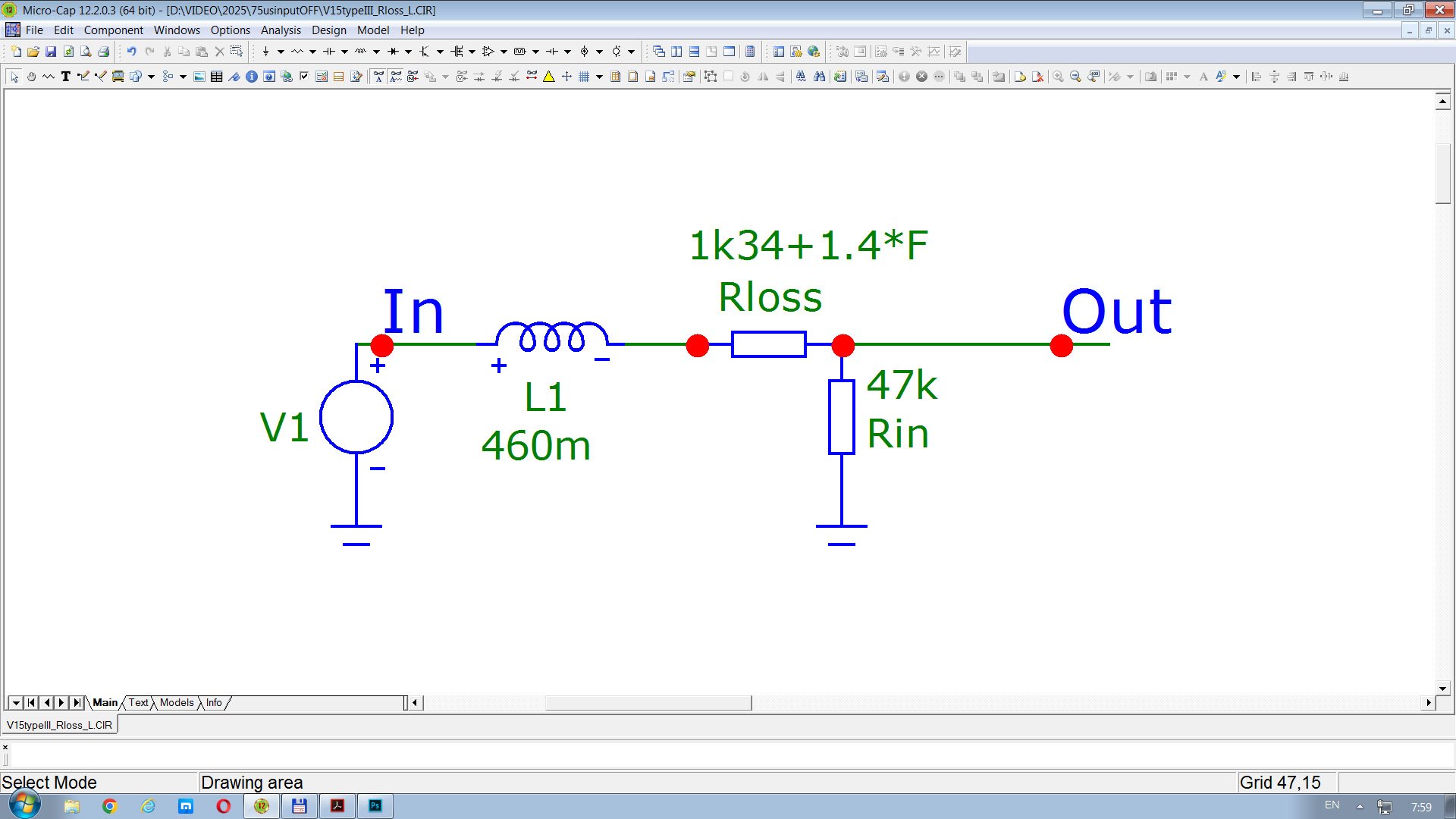

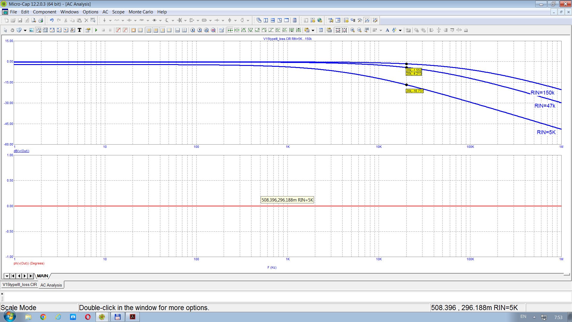

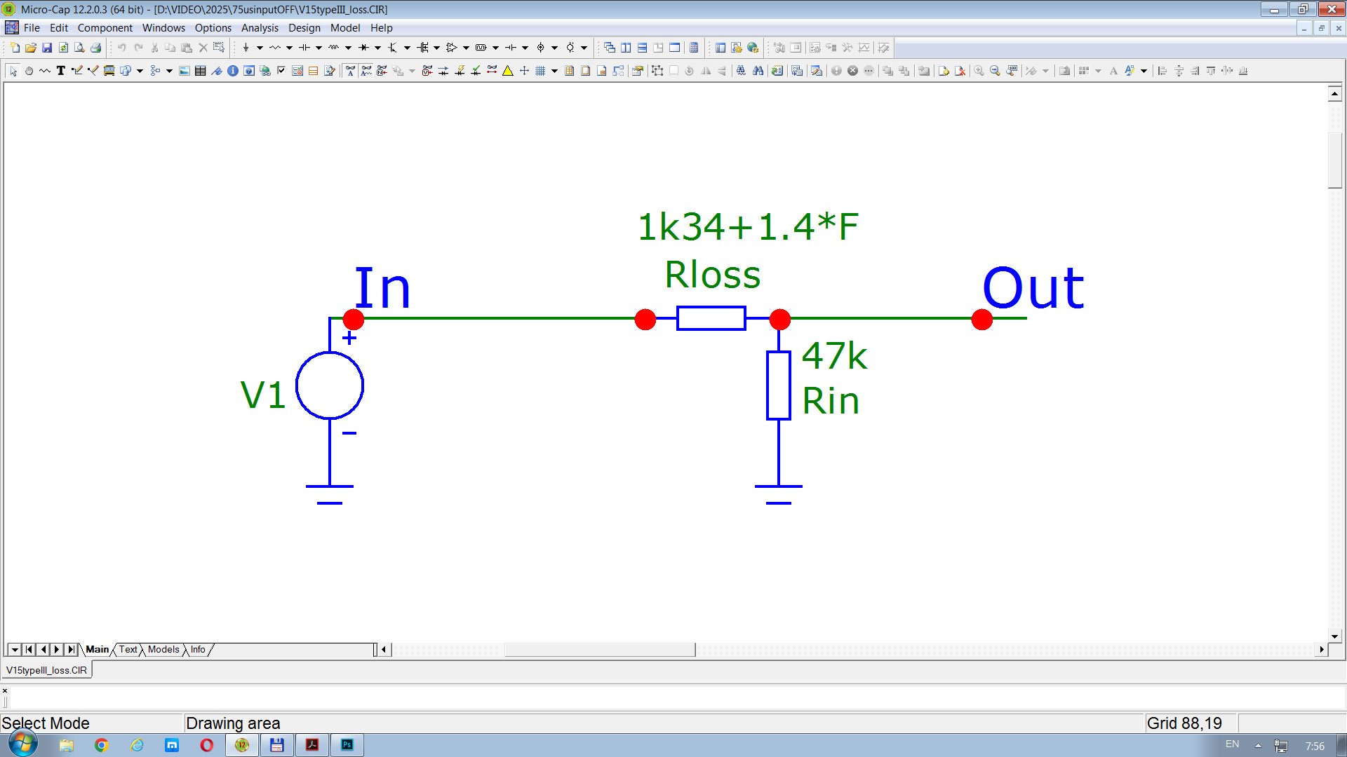

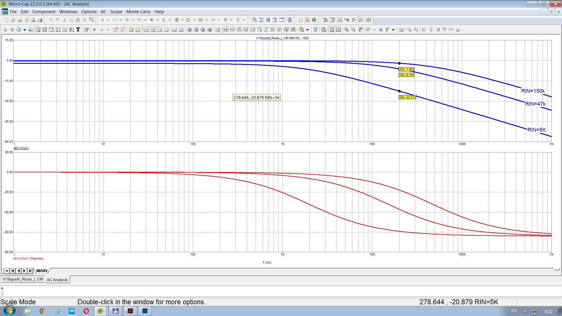

Yes I agree with that Shure V15-III is not suitable for any naked resistive load (150-47-5k) without extra correction (@ 47k also, - needed 450 pF for -12 dB @ 20kHz). IMHO the best way of such a -12 dB extra correction is (if needed for old heavy tip mass) corresponding painless and simple increase of the time constant of 75 µs in the feedback circuit. But may be you also agree with my conclusion that 75µs Damped Loading makes much more (as can be seen in #14) noise ? I am attaching several additional nuances on the frequency response taking into account the frequency dependence of the series resistance of the cartridge losses. According to the data from your table2 R* of V15 @ DC is 1.34k but @20k became 30.1k (I can quickly simulate it in Microcap as 1k34+1.4*F using <fexpr> attribute ), - which even without taking into account the cartridge inductance results in a 16.7 (!) dB frequency response roll-off at 20 kHz, which is much more than the roll-off due to the 1.34 Henry inductance (for naked damped 75 µs/5 kOhm). This rolloff not conditioned by damped input time constant Lcart/Rin but by exclusively resistive "iron loss", and few people even guess about it. But do you agree that it exists? :bigeyes:

The figure of post #17 and the spreadsheeh of post #25 take into account the frequency-dependent series resistance. You don't see a > 16.7 dB drop because for the 4794.5333... ohm load, I just calculated the difference between the response and the response of an ideal 75 us first-order low-pass.
