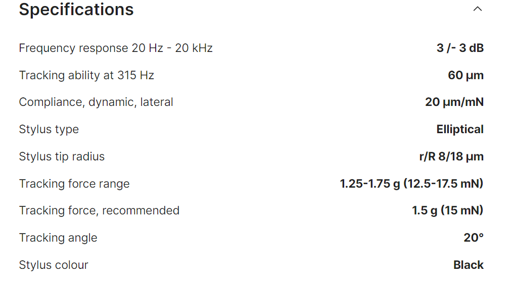

The picture in your post is really old, coming from the times when the ETM (effective tip mass) was more than 1mg....the achievable upper cut-off frequency is a mechanical resonance. It is formed by the complete mass of the stylus (the tongue, cantilever) and the elasticity of the record groove.
In my particular case I see that (needle+vinyl) resonance above 20kHz:
- with Stylus 10 (ETM == 0,5mg; needle == ellips) it sits at 24kHz
- with Stylus 40 (ETM == 0,3mg; needle == FG70) it sits at 38kHz
Can you give us honest information about your measurements?

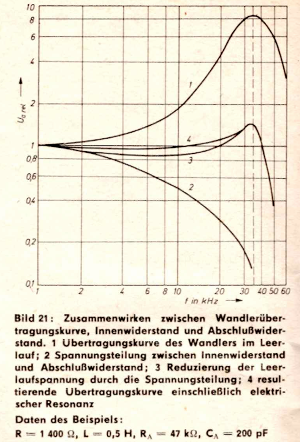

I wonder then, why does it resonate at 15kHz? An elliptical needle?
In this example of the V15III, the groove needle resonance is clearly above 30kHz. The modulus of elasticity will be less than 4 GPa and Q greater than 1 but less than sqrt(2).
I have broken down the known oscillation formula of a simple spring-mass oscillator into factors and the result is also the formula presented by Mr. Polak. However, one can also simply take it from the literature of the last century.
HBt.

Here it is now, the often freely mentioned 33kHz rosonance boost.
Yes,An elliptical needle?
VN 35 E-M black
result in always >28kHz with a mild boost. Back in the year of 1978; when Hans decided to take a short course in electrical engineering.
To complete the list:
The excitation (i.e. the information to be transformed) does not rush towards us at a constant speed (we are the virtual center point or vertical axis of the probe tip). The wavelength lambda changes.
This means that fc moves between two boundaries, approaching fo from the outside in.
As a guide, Q (in this case) is always greater than 2*sqrt(2). A neat, deep cut - this increases the negative slope (of the falling branch, the asymptote) of posting #109.

Hi Anton,The picture in your post is really old, coming from the times when the ETM (effective tip mass) was more than 1mg.
The same Ortofon OMP cartridge with the same termination, just the stylii are different.
I tried to find some details on this OMP Cart, or could it have been a OM Cart ?
You are right that the ETM alone is indeed not explaining this big difference between the two Styli since fres increases according to a sqrt law when mass decreases, in this case ca. 30%, a step in the direction but not enough to get 38kHz.
But there is more than just the Vinyl's spring function and that is the elastomer that in most cases both acts as a spring and as a damper.
This part is probably determining just as much of the mechanical behavior as the ETM or the cantilever.
A simple fact is that MC's that usually have a much larger BW also have a much stiffer suspension or a lower compliance thereby extending Fres.
So maybe the Stylus 40 you mention may also have a suspension with a much lower compliance..

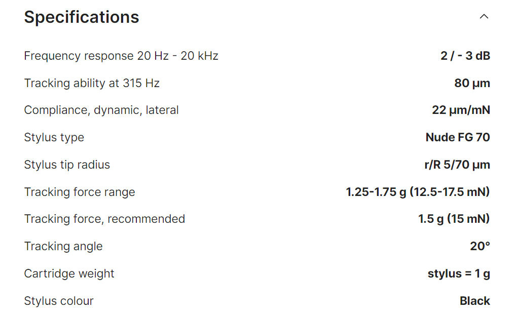

Goededag, Hans!I tried to find some details on this OMP Cart, or could it have been a OM Cart ?
The OMP is just a T4P (P-Mount) version of the Ortofon OM cartridge.
The Stylus 10 and Stylus 40 have almost equal elastomer compliance, this is barely detectable at the tonearm's main resonance frequency (~13Hz in my case).
The difference between the 24kHz and 38kHz is totally due to the different neddles' shapes: an elliptical with bigger pressure on the groove wall and the FG70 (Fritz Gyger 5×70nm) which has so much less pressure that the vinyl stays more rigid under the needle.
To have that (needle+vinyl) resonance at ~15kHz requires very massive elliptical needle on a very heavy cantilever (so I think).
If I had more time and money - I'd repeat a lab-research measuring the needle+vinyl resonance frequency with these stylii:
- Stylus 5S - as the spherical reference for which the pressure and vinyl rigidity are well known
- Stylus 20 - as the low-mass elliptical giving higher pressure for the same VTF
- Stylus 30 - as the lower-mass and larger contact area needle giving lesser pressure for the same VTF

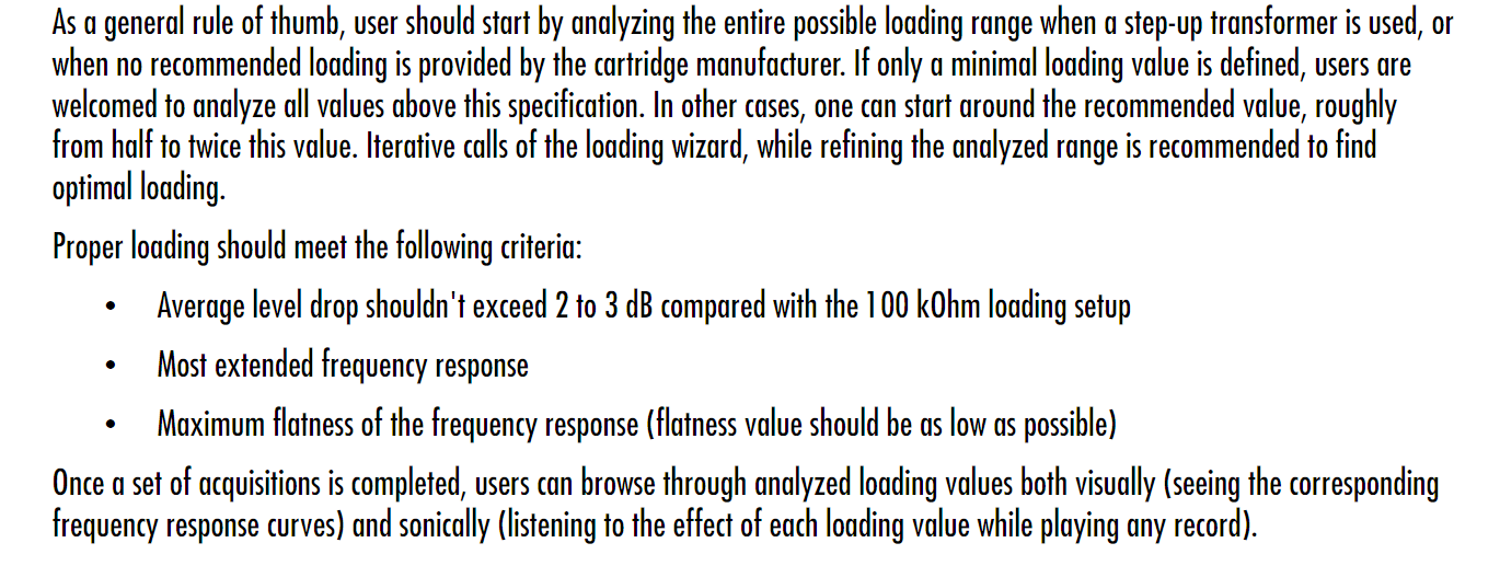

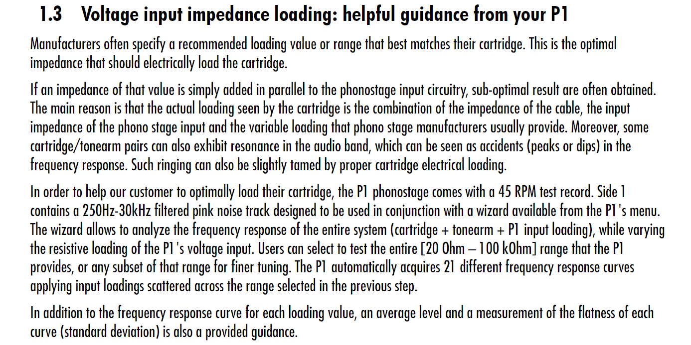

hbtaudio, I have given up trying to understand your 'input' to this thread. There seems no purpose to the many (probably good) bits of info you throw at us. Your underlying narrative appears designed to obfuscate the issue rather than clarify anything. Perhaps you should try harder to make your stuff easier to understand ..
Is there a list of MM cartridges which respond well to 150k loading and small C; perhaps with recommended C .. compared with the recommended 47k & C loading from the makers.
and I've looked through the 100+ posts of this thread and others trying to find the original article that proposes 150k & small C loading without success. May I beg a kind soul to post a link to the original article.
