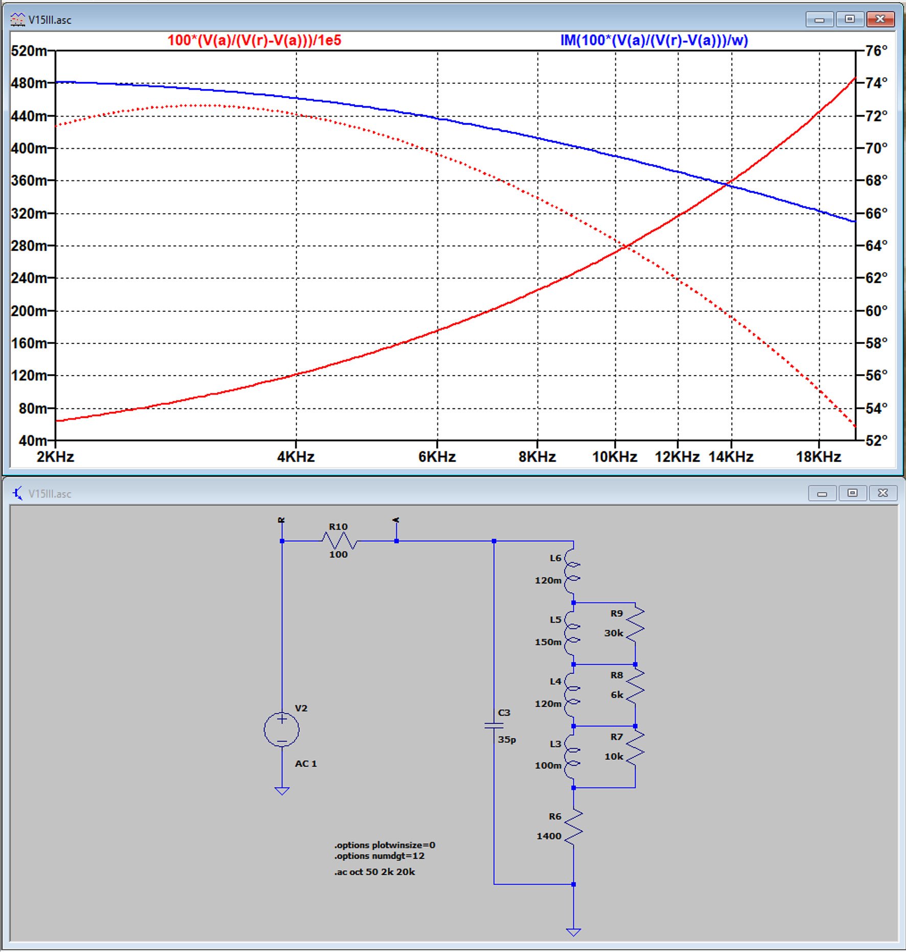

I made a more accurate model from the table that you and Richard Visee made, see first attachment, where in red the Impedance and it's phase are shown and in blue the inductance versus frequency from 2kHz to 20kHz.
Phase starts in rounded figures at 72 degrees and ends at 53 degrees while |Z| goes from 6K to 49K, almost identical to the given table measurements.
To make both curves visible in the same image, Impedance has been divided by 1e5.

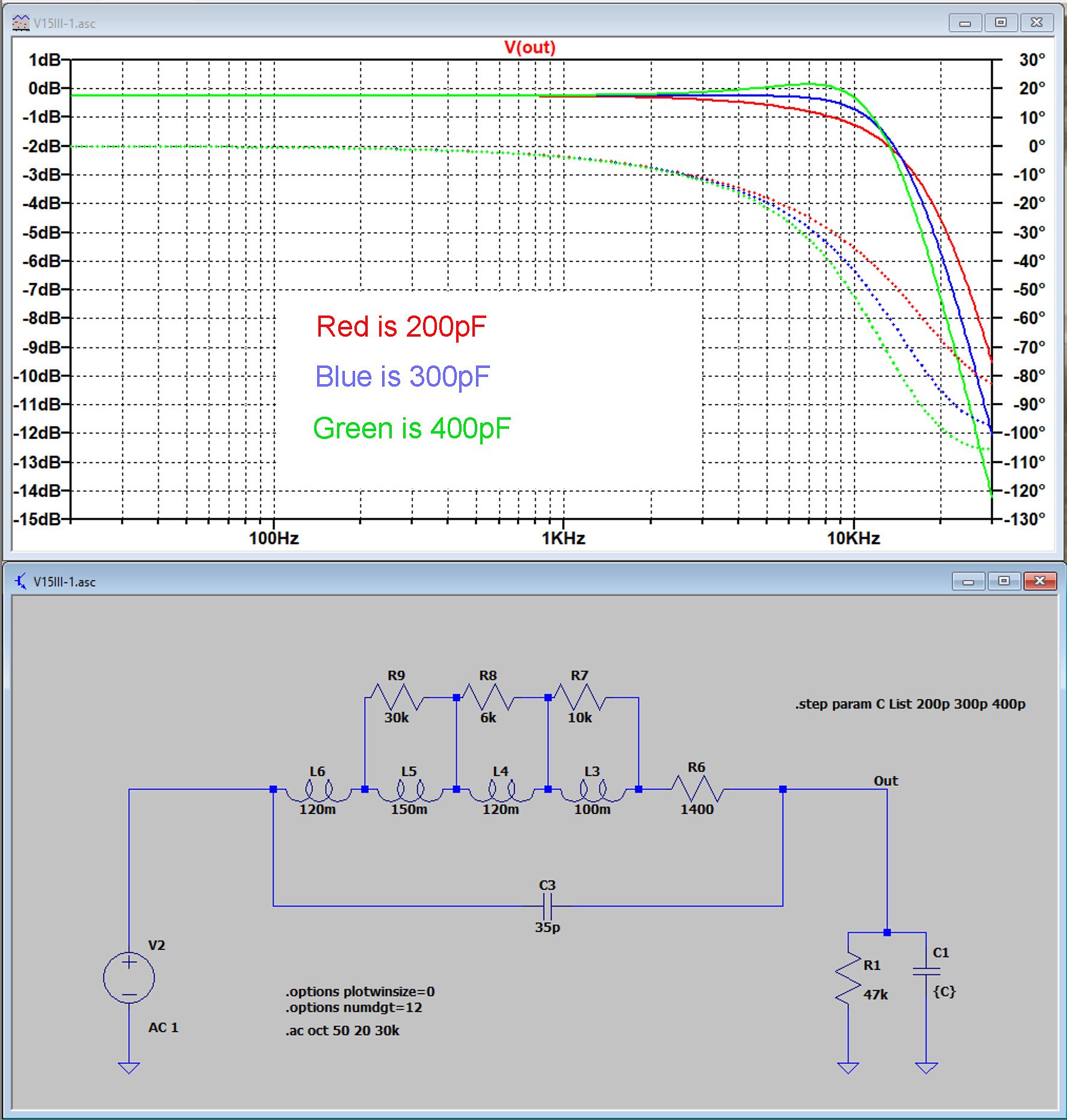

The second attachment shows the resulting frequency response with a termination of 47K // to resp. 200pF, 300pF and 400pF.
What still remains from earlier conclusions is that it's obvious that to get a flat overall response up to 20kHz that the mechanical part needs to produce the inverse of the electrical part, meaning a stark uplift at 20kHz, which will happen by it's supposed mechanical resonance at 38kHz.
Hans

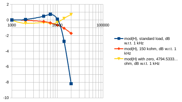

Hi Marcel,
I ran the model again with 450pF to make the termination load identical to yours in #17 and projected the result on your image in solid red.
There is indeed a large difference between your blue curve and my red curve.
What exactly did you do to get your curves.
As you can see in #124, I made a model replicating Impedance and Phase of your measurements,
That model was consequently used to measure the frequency response with 47K//450pF.
LTSpice does not make errors with models like this, so we must be doing things differently ?
Quite remarkable is that you blue curve has the same shape as the phase that is dotted in red, a coincidence ?

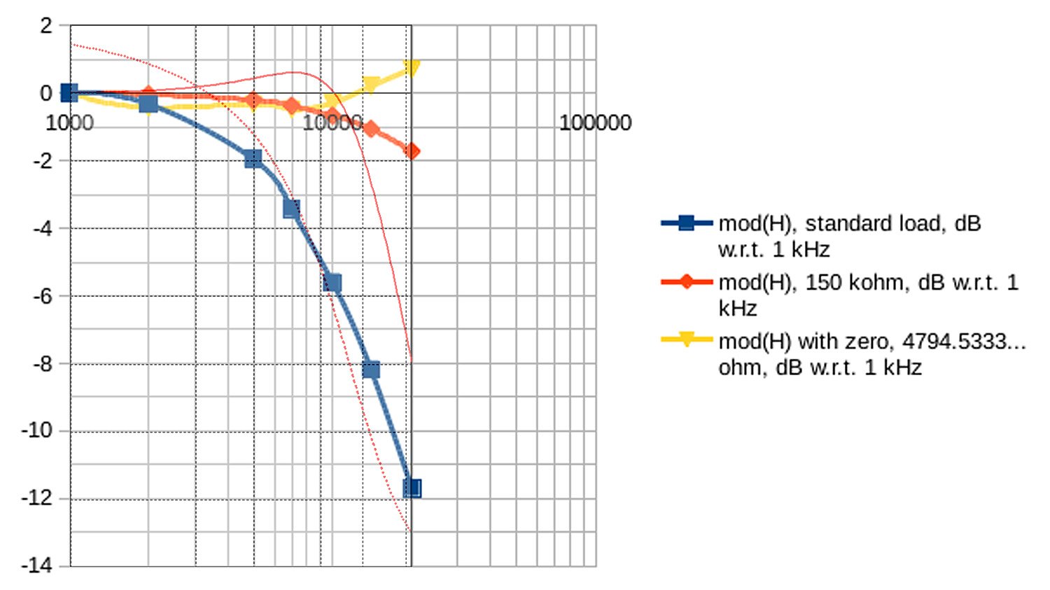

I just calculated the transfer using the equation for voltage division with admittances, but I forgot to take the opposite of the phase angle of the impedance when calculating the cartridge admittance, silly me... When I correct that, I get this:

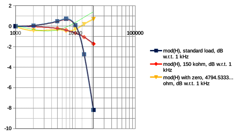

Marcel,
The simulation in LTSpice with the three different loads, 47K//450pF, 150K and 4794 ohm corrected with a 75usec zero, was again projected on your image.
The first two loads are now spot on, while the third in yellow was probably not yet corrected by you and still differs a bit with the LTSpice outcome in light green.
All in all, we can conclude that the model for the V15 III is most likely quite correct.
Hans

Marcel,
Whatever may be the cause of the 0.6 dB difference, that's not it. I corrected the phase at a place that is used for the calculations for all load impedances and besides, a wrong sign of the cartridge susceptance has no effect on the magnitude of the transfer when the load is purely resistive.
@Hans Polak A difference between the 4794.5333... ohm case and the other two cases is that below 10 kHz, the 4794.5333... ohm case is much more sensitive to the cartridge impedance than the other two. As you know, the magnitudes of the impedances in the table are rounded to multiples of 1 kohm. The reason is that Richard hadn't saved the raw data, so I had to read everything off from an A4 hardcopy with 15 kohm/division scale (using a ruler to read it off as accurately as I could). The resulting read-off errors have a relatively large impact at the lower frequencies, where the magnitude of the cartridge impedance is not very large yet; 1 kohm is 1/6 of 6 kohm and only 1/37 of 37 kohm.
