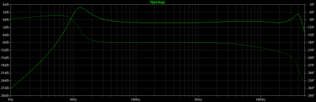

To evaluate the impending disappointment (regarding my expectations of LR75µs benefits) I created a fictitious cartridge model based on this Hans Polak's document. Factory specs for Ortofon OMP are 450 mH+750 Ohm.
With my realistic cable capacitance (and switching the needle+vinyl resonance off) the LCR behaviour is not so frightening:
But the needle+vinyl resonance at ~38kHz changes the nice-looking picture drastically:
It may be somewhat tamed by Cinp == 1n5, but that is far from what I dreamed about:
