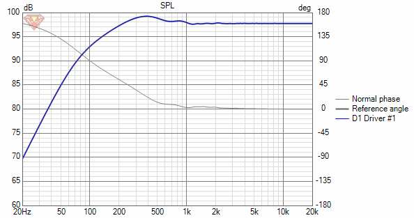

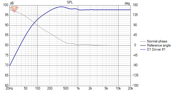

You may have misunderstood one thing however ... the added 45 beveled edge sides would be added to an EXISTING speaker. So there would be zero ability to change anything in the xover. I'd just be adding an extra 19mm layer of plywood to the sides, but with the 45 degree bevels.
Could you give the width of the loudspeaker in question ( Asathor?)?
As pointed by Fluid with a loudspeaker of this size the bsc should be in the vicinity of schroeder frequency and thus the room will start to dominate the behavior, so lowering this frequency ( by adding the sides) should not change a lot in fine.
That said if you have the drawing of cabinet you can simul under 'the edge' to have an idea. It won't tell you exactly what will happen but'll give you a trend.
Ok so the regular width ask for something around 348hz.
With your side added it should be around 304hz.
If your musician it is a drop from an E to a D.
It shouldn't change many things but i thought the cabinet was wider.
I'll see if i can find the edge on one of my old pc and simulate it.
I'll save you the trouble
Difference between a 440mm baffle with no edge radius and a 478mm baffle with a 19mm edge radius, so little that I had to double check I did it right as I could hardly tell without the gif 🙂
