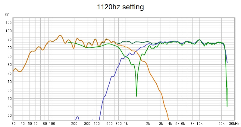

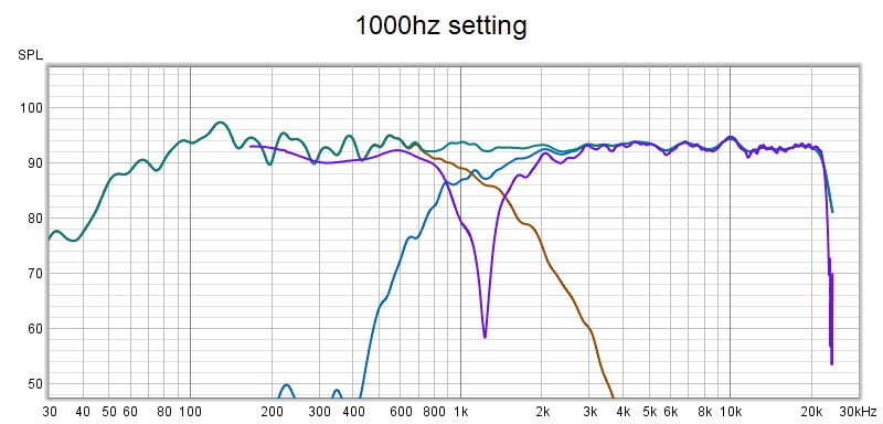

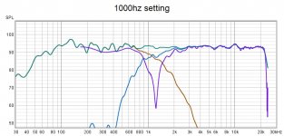

Those are with a LR 4th order ... 2nd order looks the same BTW.
Used (2)peq's on the heil ... (1) to kill that 7.6khz peak (-5db) and another to bring up a dip around 13khz (+4db) and added a 12db (+2db) high shelf starting at 11khz to even up the top end a bit.

Actually those measurements look too good, my comment pointed to your own phrase, but it seems that you have managed to overcome it.

Where would the lobes come from without the dips 😉
Loobing is any tiny deviation from uniform - this is marriner grave deep suckouts 🙂
Frequency graphs with 120dB vertical scale? 40-60 dB scale would be more suitable to judge loudspeaker performance.

So, I did surprise you. 🙂Actually those measurements look too good, ... snip
Noted ... I will adjust in the future.Frequency graphs with 120dB vertical scale? 40-60 dB scale would be more suitable to judge loudspeaker performance.

Perhaps the graphs needed more explanation than I thought. Lobing is almost never a tiny deviation. The lobes form from destructive interference. The deep dips are caused by the path length differences and change depending on off axis angle. Within 15 degrees or so there is even response and if the off axis response was absorbed in room I can imagine it being no real problem other than a narrow sweet spot.Loobing is any tiny deviation from uniform - this is marriner grave deep suckouts 🙂
The scale of the DB / SPL graph, good point, and I would like to see a graph of the crossover network, more precisely the overlap in the middle zone .....

(post 489) if not, tell us which one, because you cannot evaluate a graph without knowing which transducers you used.
The AMT is the original? If so, has the original diaphragm been replaced with new ones that are of different material and response? What is your FR and SPL?
