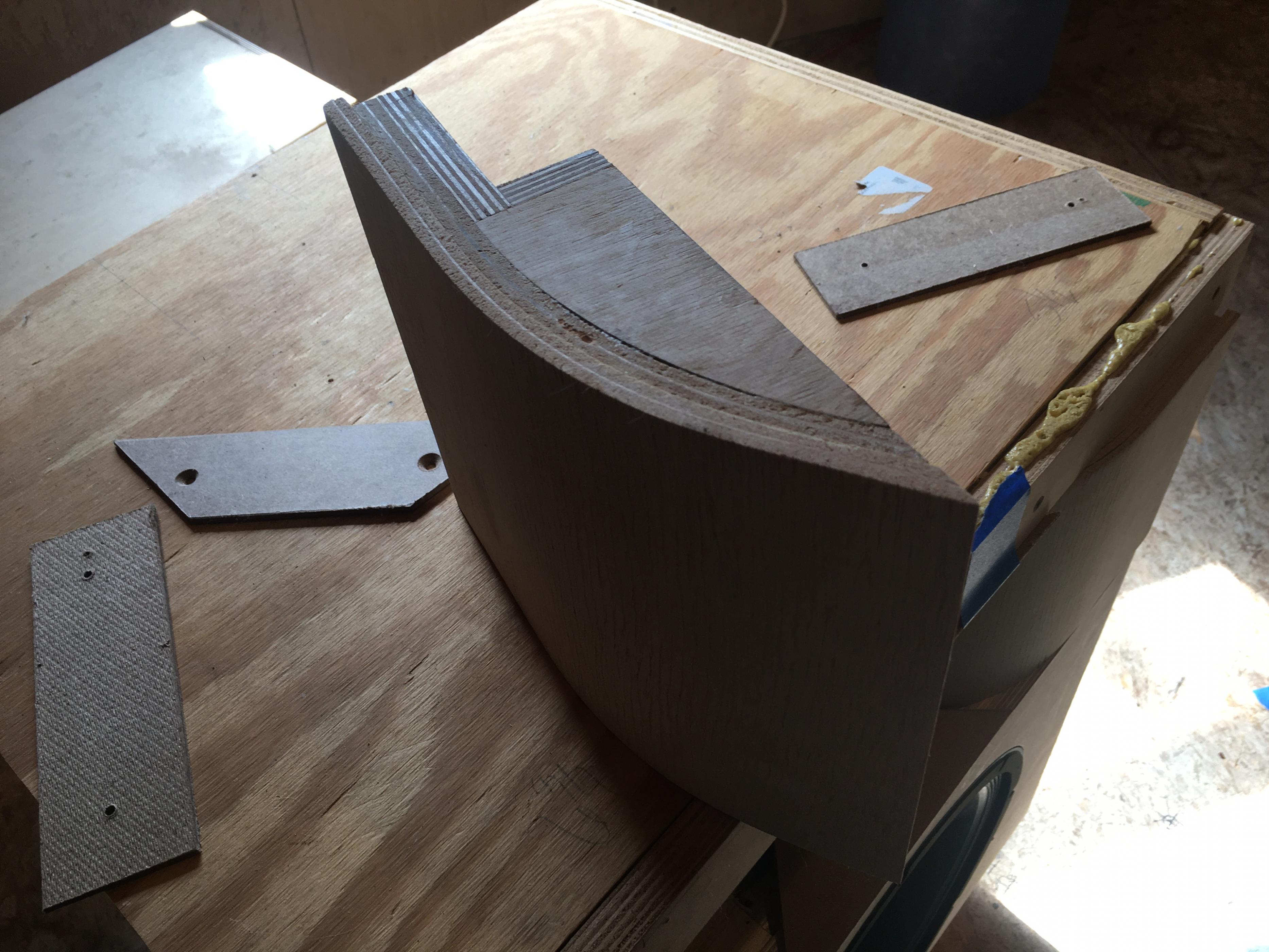

I've got a pair of the older Heils enclosed in a box mounted in a enclosure with a 15" driver. I fabricated a waveguide for it. The sides are flared using around a 8" radius form wrapped with 2 layers of 3/8" bending plywood.
The side flares really work to smooth the frequency response. The resulting "mouth" matches up to the 15" well enough. The thing I've noticed with the large Heil is that while it can be pushed down to 900hz LR4 it does sound a bit thin there .. in spots ... like on some voices. Now at 1khz LR4 it's pretty solid. I'm flipping between the 1khz setting and another at 1120hz. The higher setting uses more of the 15" driver but if you pick a good one it will have pretty good voicing here still. Even so, with either setting, the acoustic xo ends up in the 1.2-1.3khz range. The on axis response is really flat.
My 2cents, with a larger (15") AMT 2way, is that some try to push the xo too low. Pick a really good 15" woofer, one that can work up to 4khz or so and don't worry too much about the dispersion angle. A 12" might be a better match at the xo region but you lose some low end extension with it. Mine are sealed as this is what I prefer, ported may change that some with the 12" ... or add in some subs. At any rate, trying to shoehorn a 15" with the heil while trying to respect the "ideal" xo region will handcuff you. Don't get scared off of pushing the 15" a bit higher in this combination.

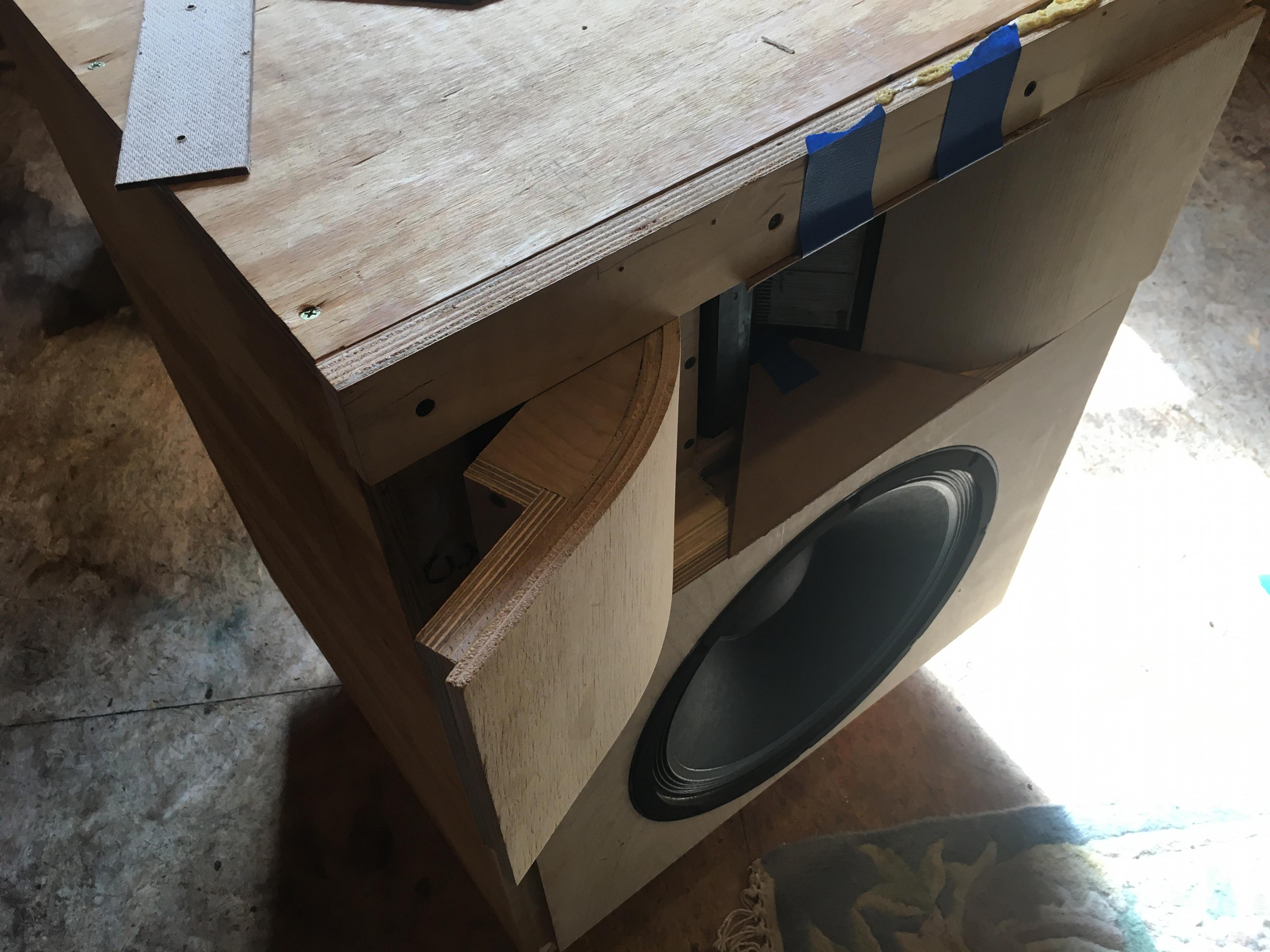

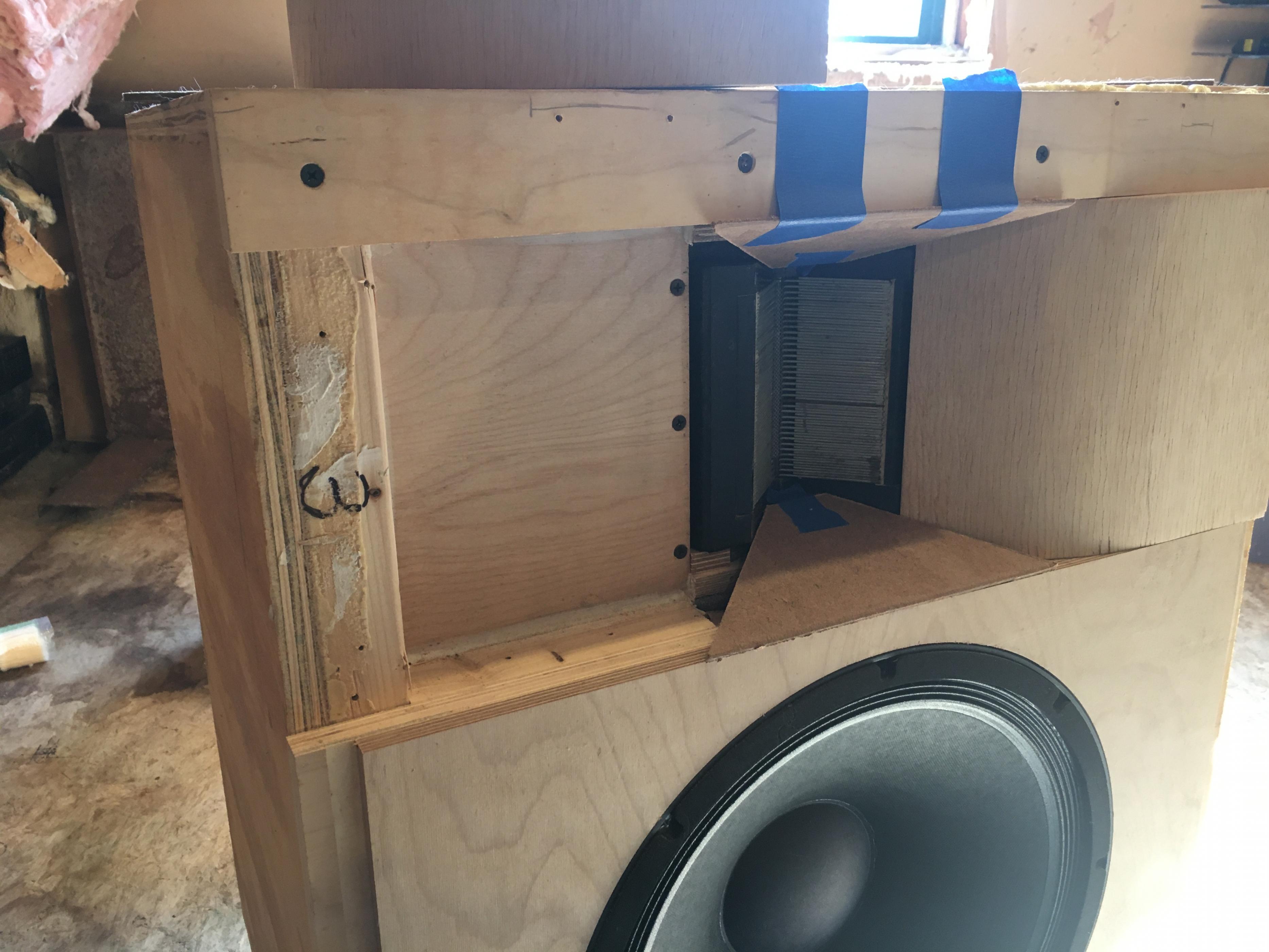

So the back of the dipole Heil is opened to the inside of the enclosure with the 15" woofer? That sounds strange.

Just where anyone reading this knows ... As the OP, a couple of my listening rooms require the speakers closer to the side walls than optimal. Anything like a dipole is too much for these rooms.

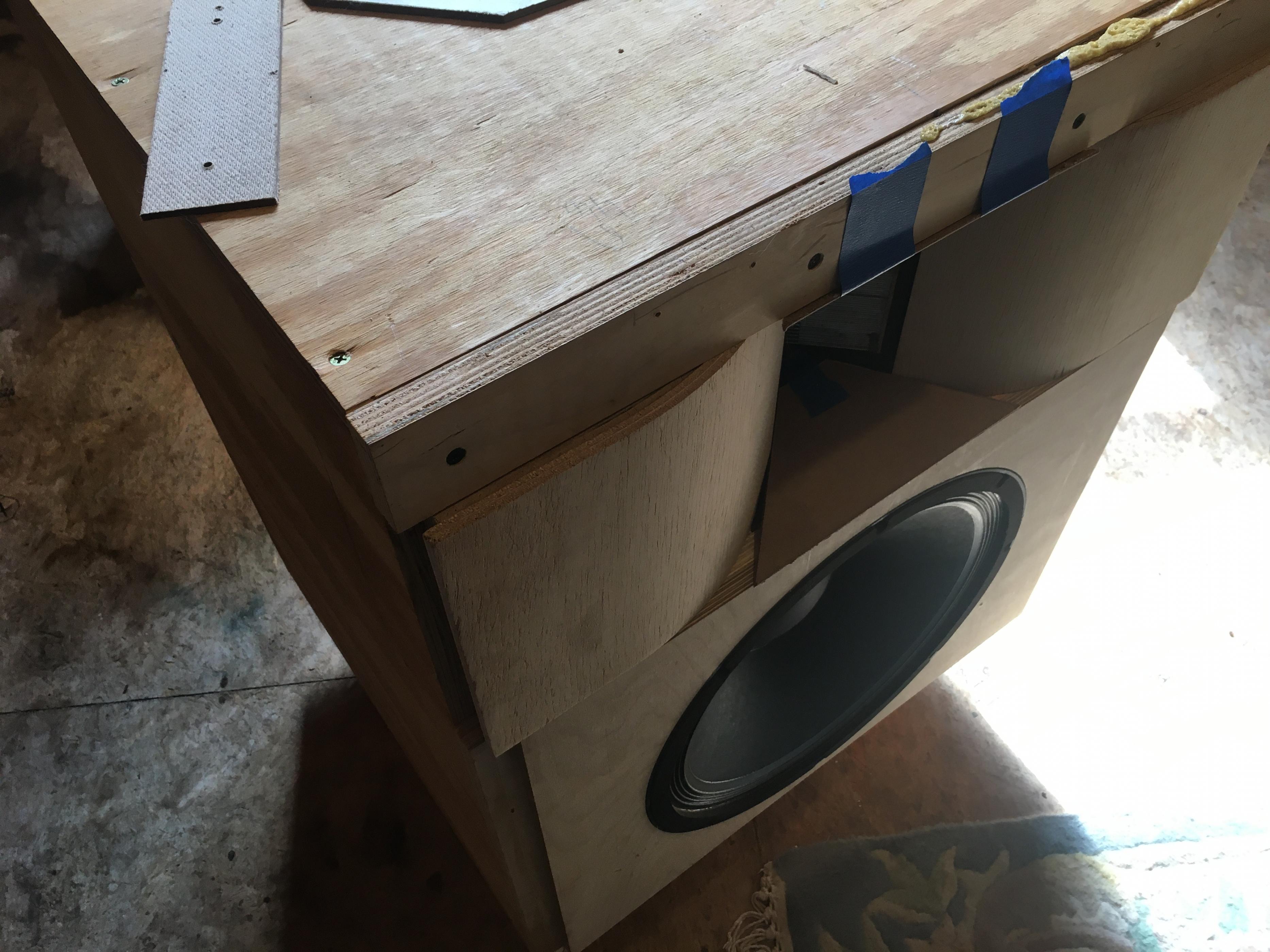

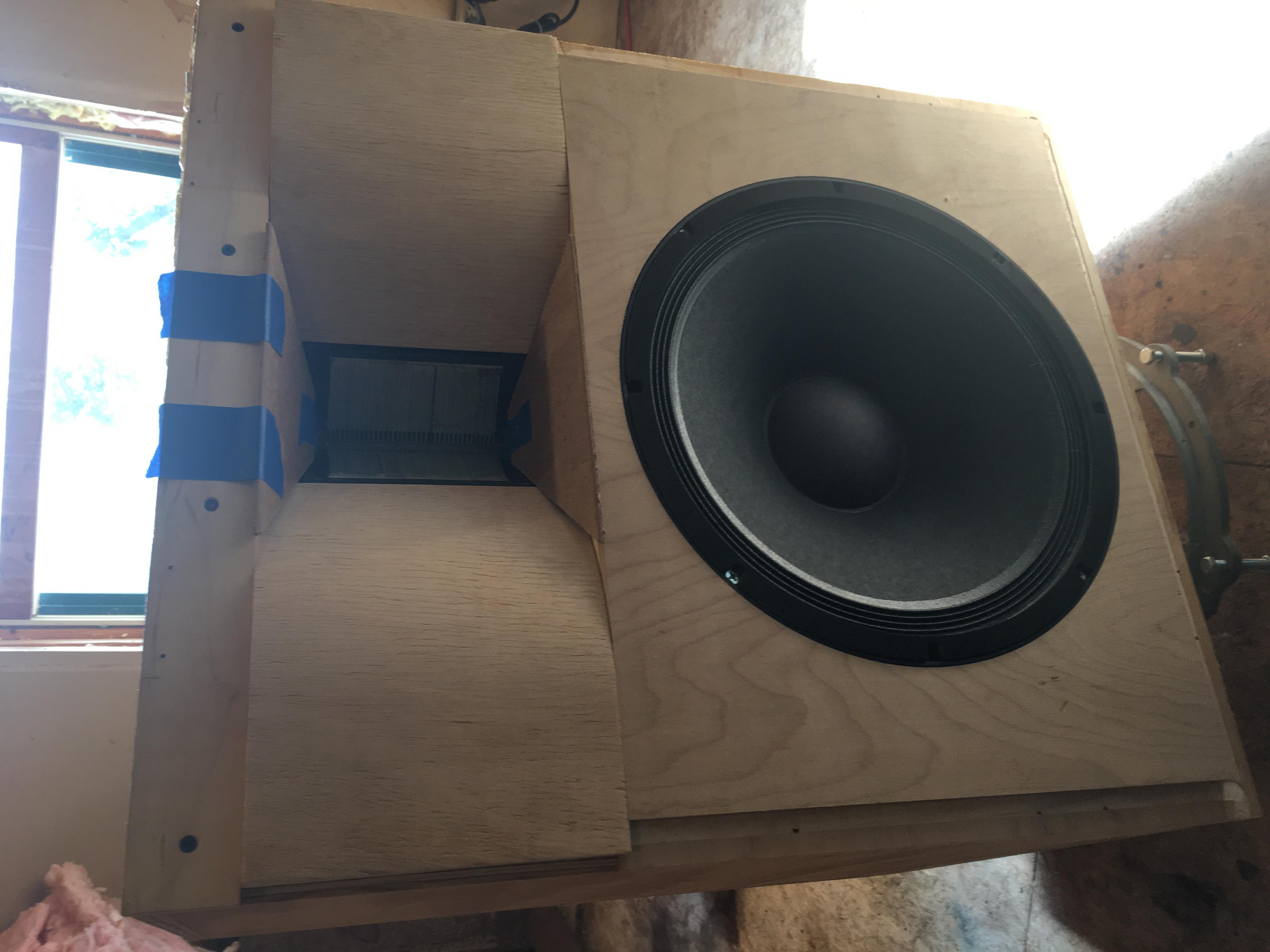

No Flaxxer ... the heil is in it's own box which is mounted inside the 15" bass enclosure. The back side of the heil's box is closed off.
I think the crossover with large Heil AMT is a compromise, as so many things with speakers. I also notice that top high stays fresher with a higher crossover. On the other hand, the AMT is so fast and clean that you want it to cover a large range. And having one driver doing all sound above say 1.2k helps stereo placement as well...

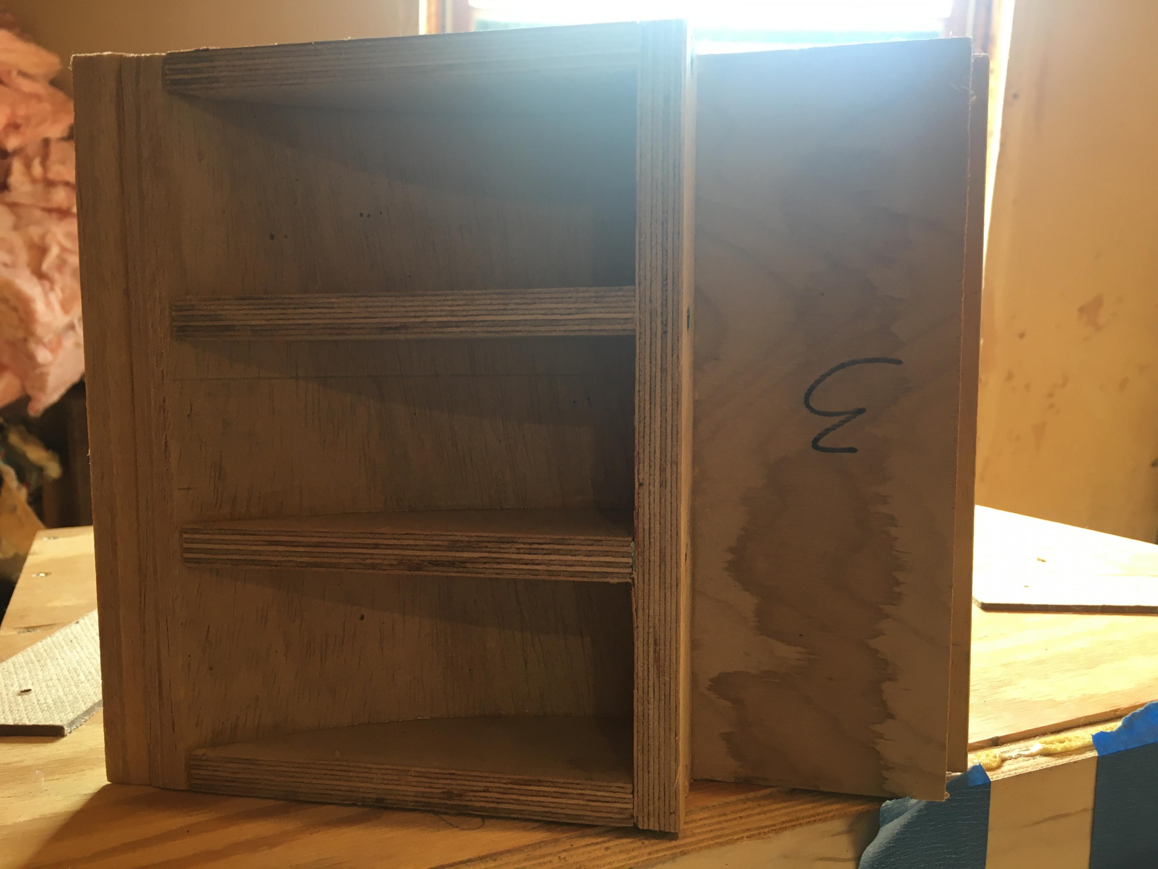

I used what's commonly referred to as a ruler 🙂I see. How did you go about figuring what size box to place the Heil in?
Seriously though, The box inside width is the heils width plus a hair and the height I made an inch taller than the heil, so around 7" inside. Depth was the same as the heil. Since it has the 90 degree built in "horn" I figured that area was enough space to infill with damping. Box is 1/2" BB. The back cover is removable.
The height worked out to fit the waveguide section at the baffle face which is 8" tall ... same OD height of the heil box. It's recessed into the bass enclosure to sort of time align the drivers and make up for the radius of the waveguide so it, the waveguide, comes flush with the baffle face.
I did things this way so if I decided to go with a CD/horn later on I could without too much grief. The bass enclosure is similar to Yuichi's Loudspeaker Enclosure
Now imagine the enclosure flipped over and an 8" section cutout across the width ( right at the ports, which I don't use). All the heil stuff happens in that 8" high space, full width of the enclosure. The 8" height also allows for about 1-5/6" top and bottom to transition to the baffle ... I'm still working that part out as to whether that needs to be a radius too or just a chamfer from the baffle face to the top/bottom of the heil. The heil vertical is tight, as you know, and an additional radius here might not make all that much difference. It measures fine as it is. The waveguide mouth height will still be 8" either way.
Ruler? Never heard of it. 😉
Looks like an interesting project.
Hope to get it completed one of these days ... 🙂 Always something else comes up. Too many projects for a guy my age.

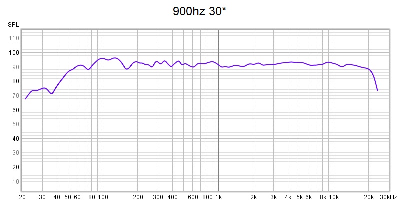

FR / spl charts please, I bet there's a deep valley in the middle.
I've heard a lot of Heil's originals on AMT 1 and its other variants. Invariably the mid zone lacked realism on drums, the vocals were soft, yes. But a Heil tweeter can't go so low that it gets close to the midrange of a 15 " twoofer in my opinion.
And losing the back wave of the AMT I think makes things worse.

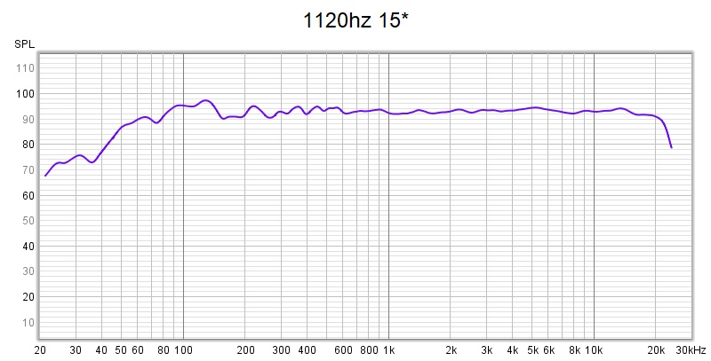

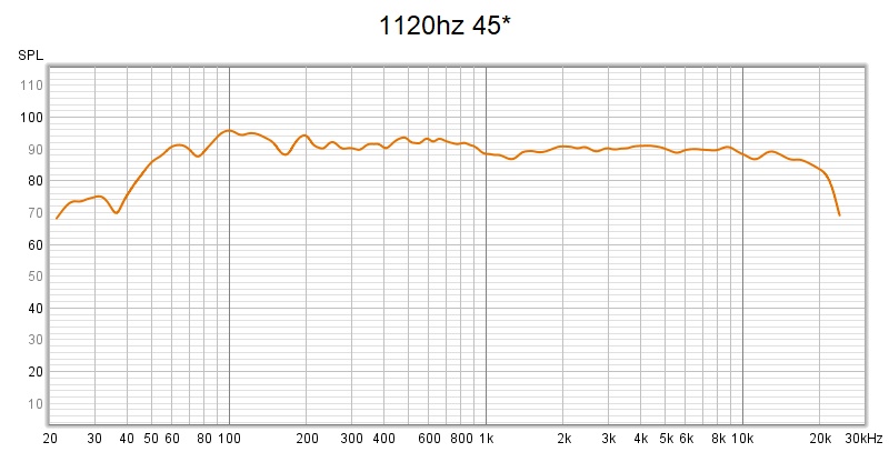

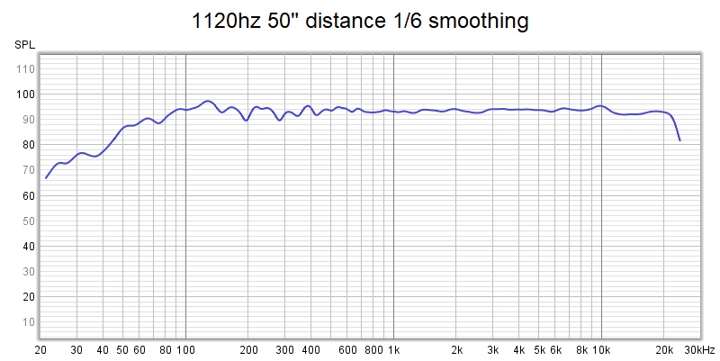

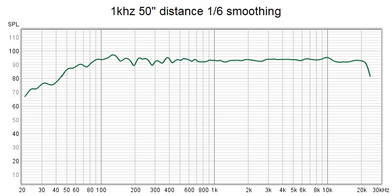

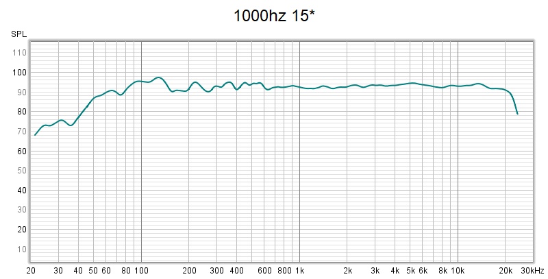

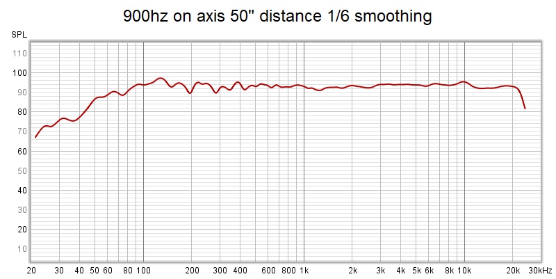

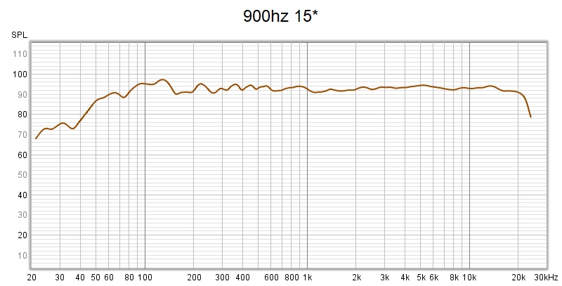

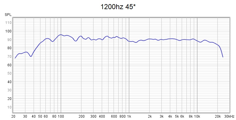

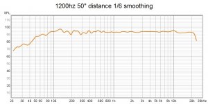

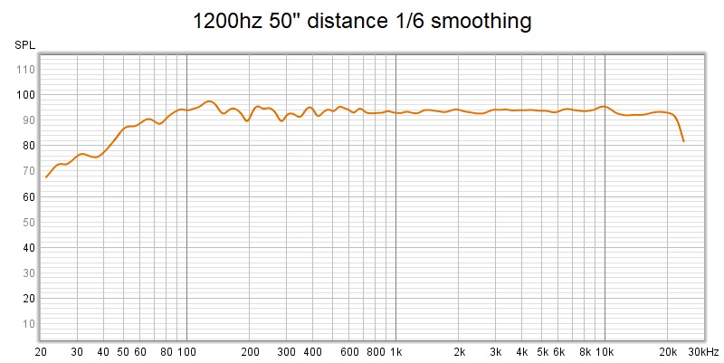

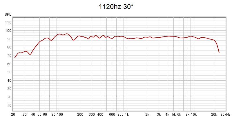

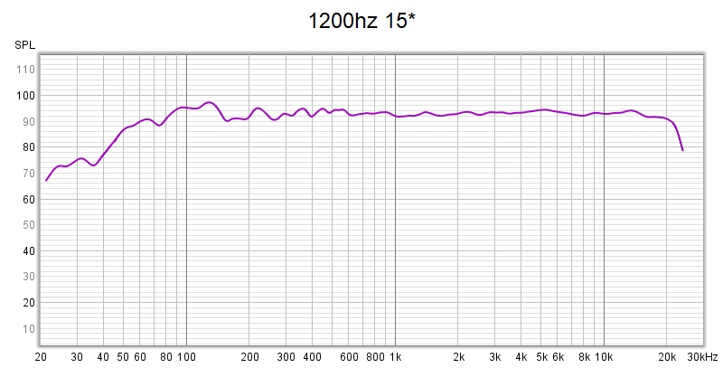

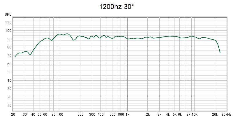

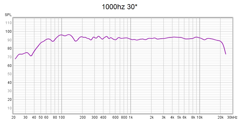

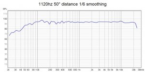

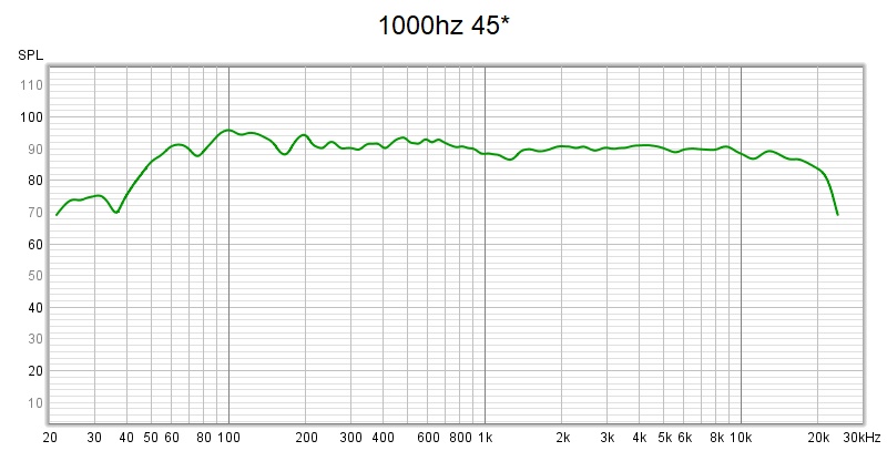

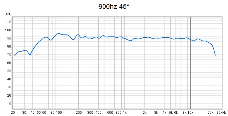

I'll try to get something posted today. You might be surprised though.puppet :
30* and 45* off
All in room, quick and dirty 🙂
