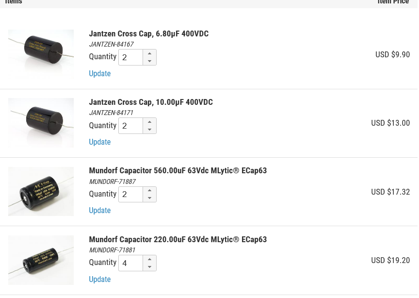

The biggest issue was the photo of the xover components in the shopping cart at ONE location only was in Duetch speak. Soooo that made it more difficult.
I'm going back in ... wish me luck. BTW, 560uf Electrolytic caps cost some dough.

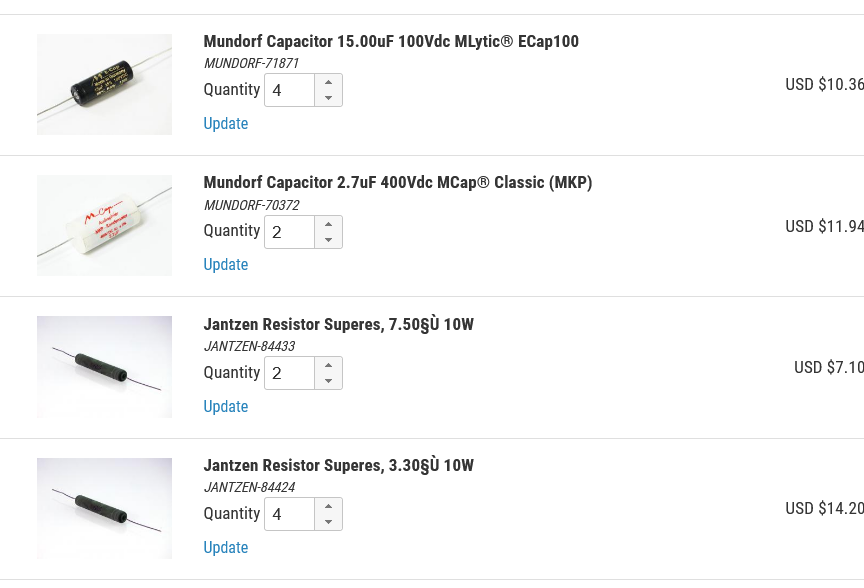

Can someone please check and see if these are correct before I purchase?
Except I just changed the two 15uf capacitors to non electrolytic

My part's list was a LOT more expensive. 😀
I think the electrolytic Mundorf cap in series for the woofer (560 uf) is a good point of departure to save money vs the poly caps.

I went with your suggestions, outside of the $120 pair of E caps from Mouser.
I already found the exact air coils used in the original, and they specd like the ones you suggested... with the exception of the 2.20mh , 1.40 ohm. That seems to be a Jantzen ...
UPDATE ... I just ordered the above Jantzen mentioned.

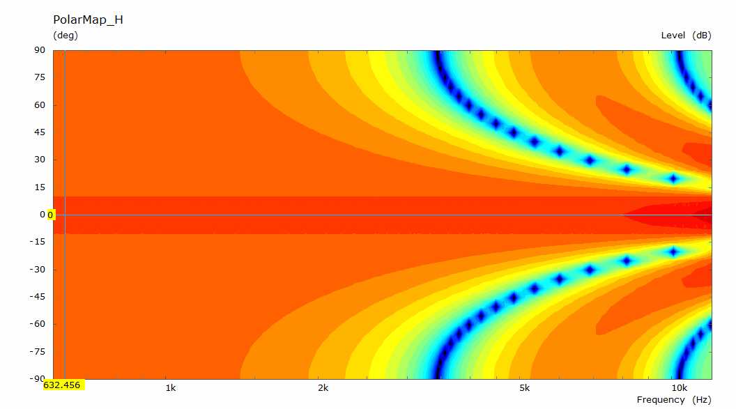

Doesn't a line array also have lobes, as would be the ribbon in the vertical dimension in the far-field?
Yes perhaps the images were not explained well enough
The vertical has lobes due to the length but the horizontal of a single ribbon doesn't
When you add two side by side you then get lobes in both the horizontal and vertical

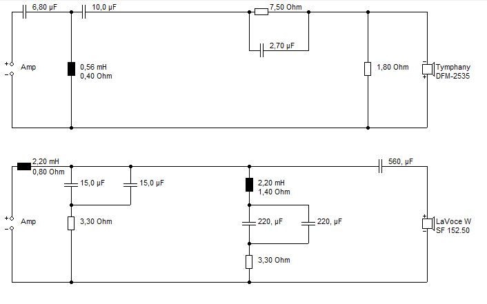

What are the crossover frequencies?? 220uF and 560uf values seem high. I can see 56uf and parallel caps for 44uf values.
Rob🙂
Rob🙂
The two 220uF in parallel is a part of the impedance flattening circuit and the 560uF is to protect the woofer against overexcursion or to obtain a desired box Q, I guess.
What you are saying makes sense. I was thinking along the same lines. I just have never seen values that high?
