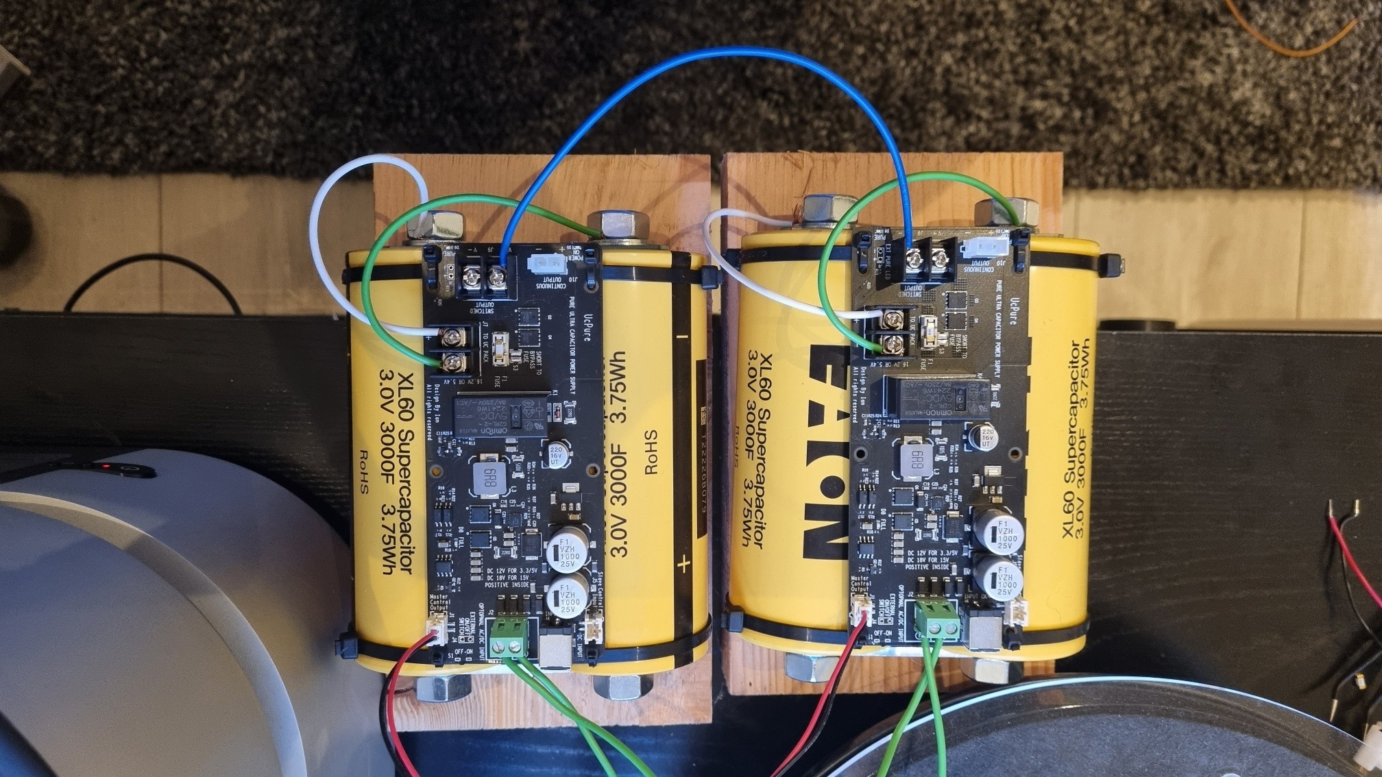

Hello Ian,
I have tested a standard lineair +-5v on the IV stage and everything is working. Then I move back to the UcPure and changed the input supply to a new transformer with a dual 12V AC . First fully charged the UcPure and swithing on the UcPure. Everything is working again. But if the UcPure change from charging to conditioning mode the fuse of the -5v blows out when the IV stage is connected. If I change the -5 UcPure to +5V and vice versa, the other UcPure is blown out. (Still the -5v)
The fuse is also blown out of the -5v when I switch the whole system on at ones and the UcPure switch is also on and not fully charged. I will test what happens when there is no load on them of the IV stage but still connected to each other with the common GND.
2) When LifePO4 Mini's are fully charged the conditioners are working normal. In general it is working and I don't have problems with them, they only behave unexpected.
Please advice because the LittleFuses are not cheap ;-)
Greetings, Berry

Hello Ian,
Even without load the fuse of the powersupply which should deliver -5V is blown out if it is connected with the other UcPure for the common GND and switch to pure mode.
Hello Ian,
I think I have solved the problem. Because I received one the UcPures with a broken physical switch, I have used the cable to switch on the UcPure with broken switch with the first UcPure. But I have connected both outputs together. (see picture) I have changed it and now it seems to function normal!! At powering the whole system on and the UcPures are switching to pure mode, the fuse do not blow out. I am very happy for now, now it is time for some serious listening.

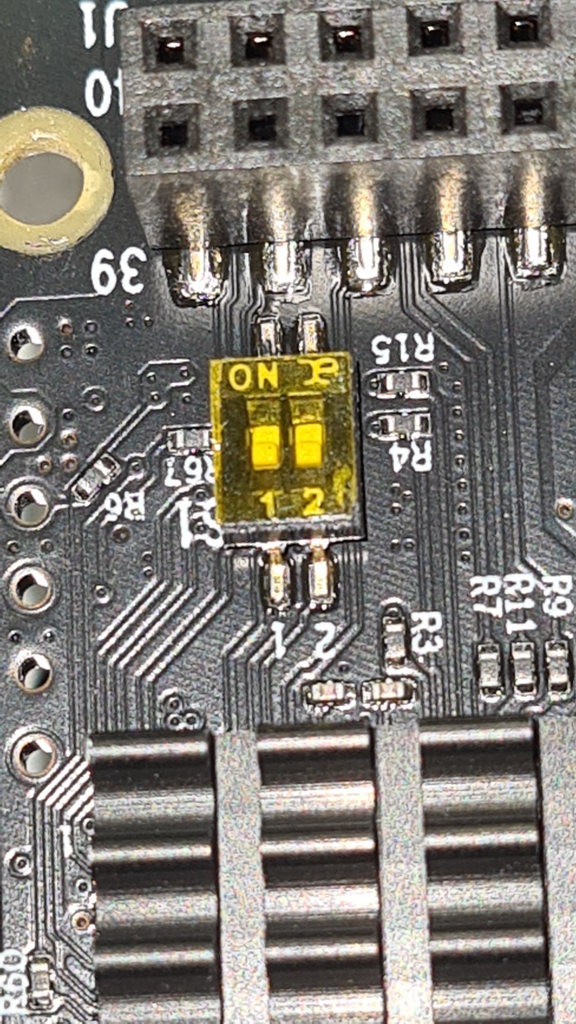

Hi Ian,
Today happy listening to the pro setup.
I also checked everything why i cannot change the Fifoq7 settings with the monitorpi. Checked S1 at the bottom of the Q7. It is still default off as it should be.
What else could it be? i ran out of options to check😊

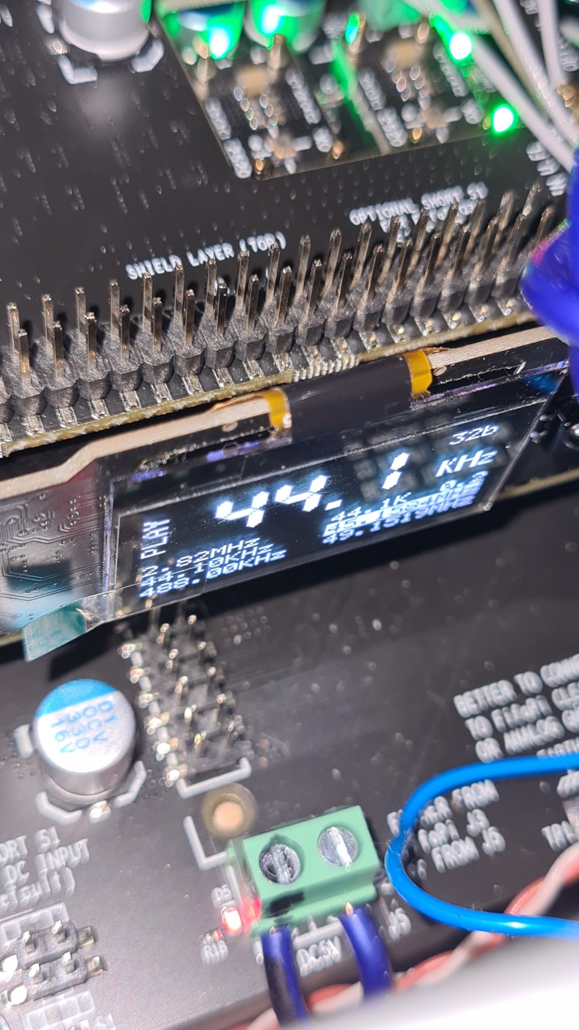

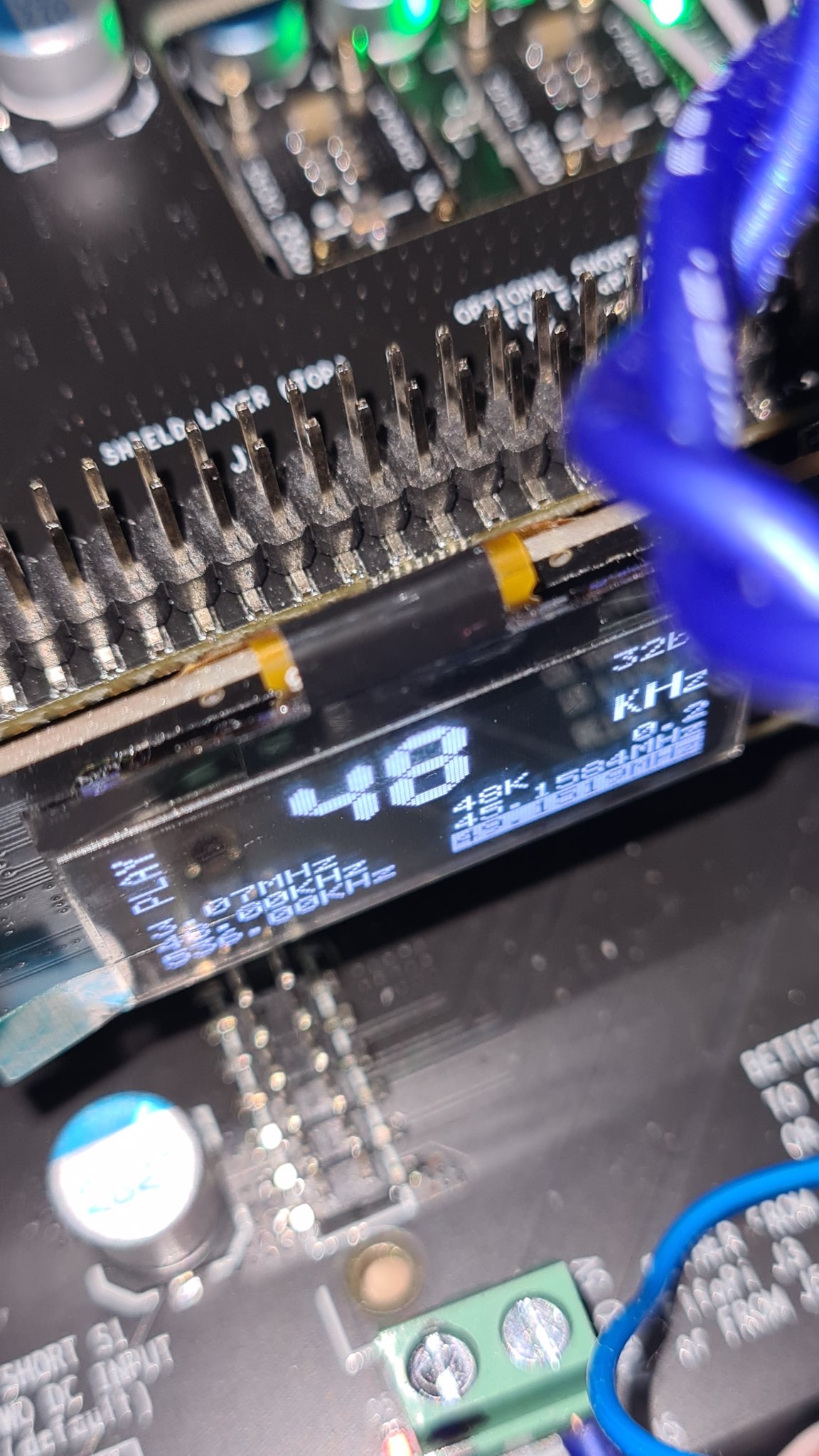

A bit difficult to take a picture but frequencies are visible.
I only can choose dimm options. Run through the manual several times.

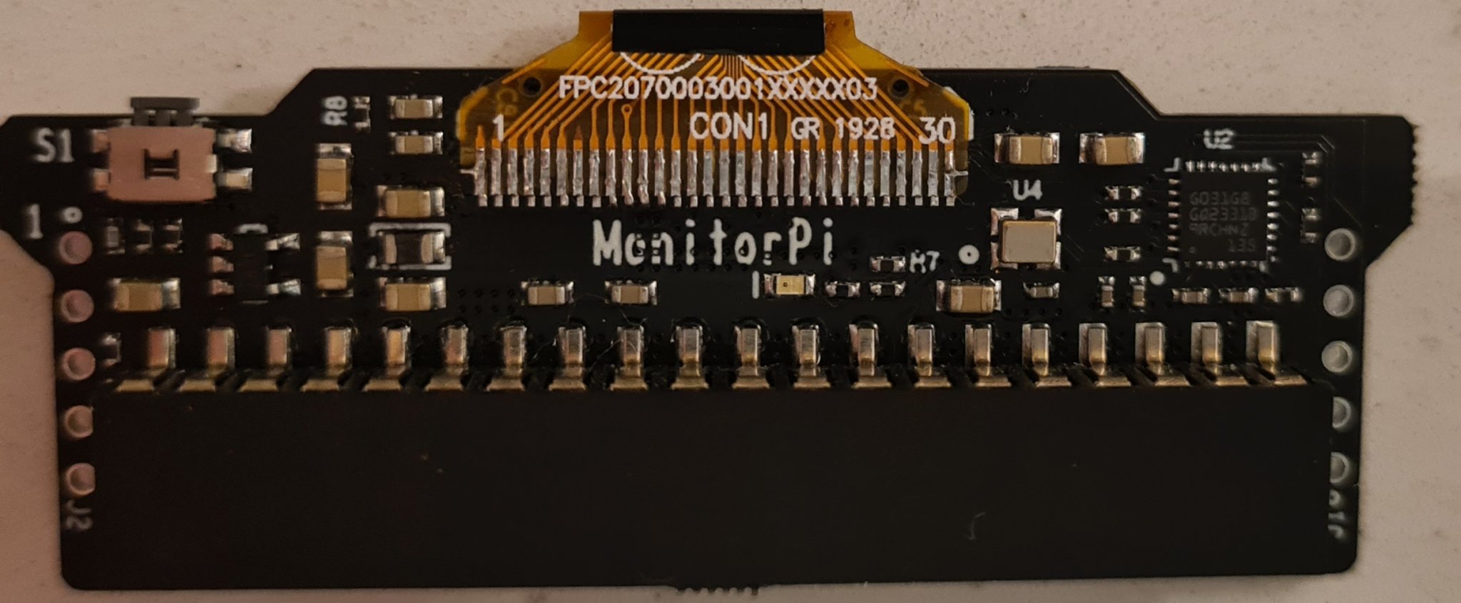

On top of the q7 a reclockpi
