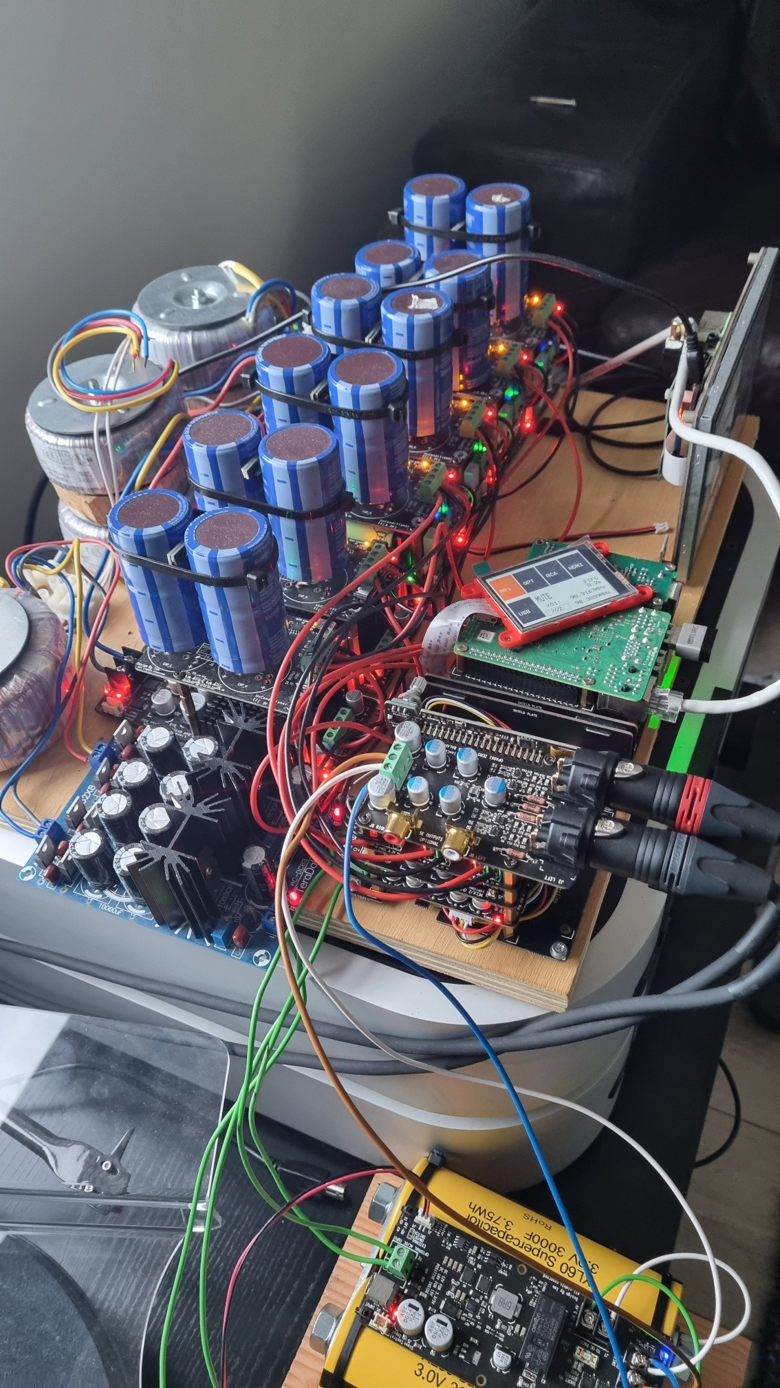

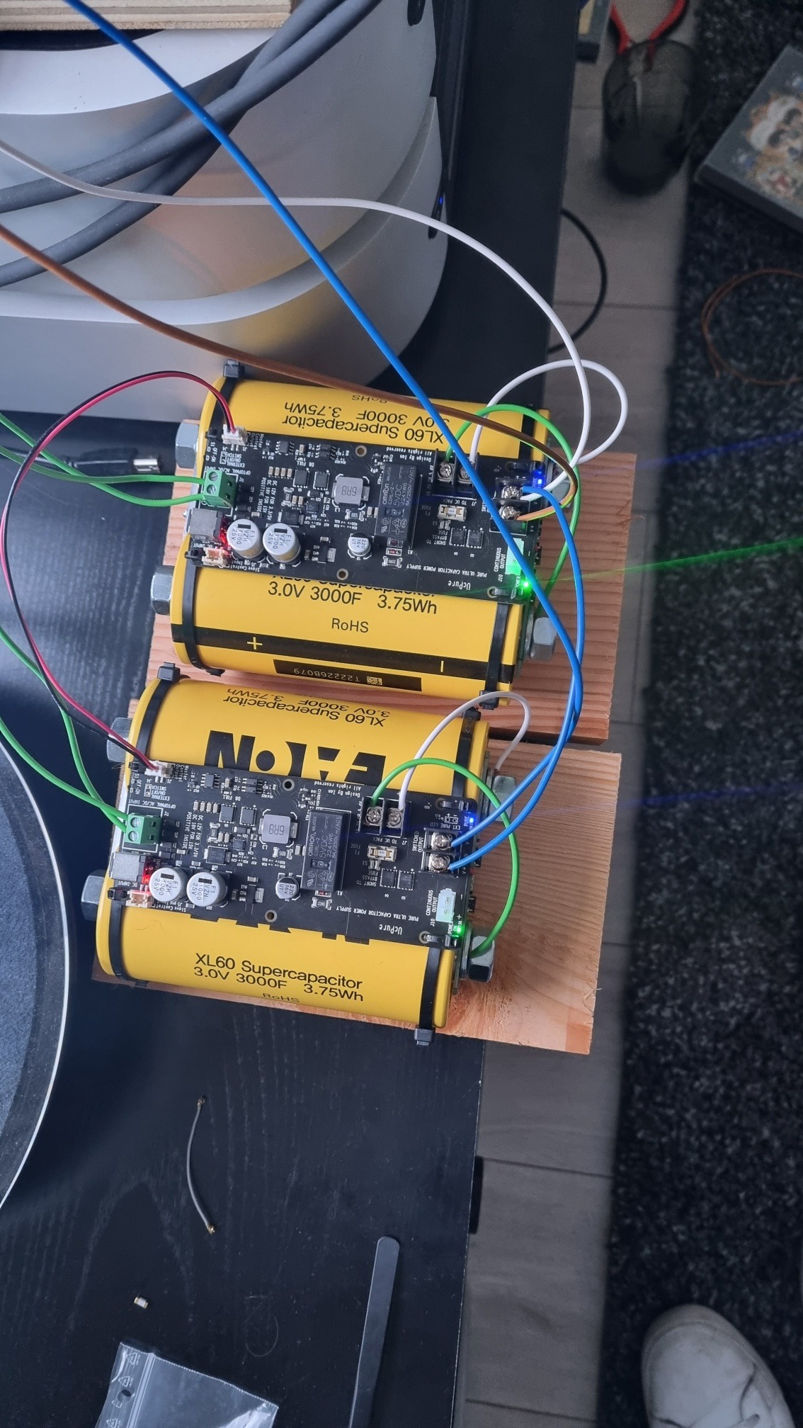

Dear Ian,
I have newly installed de fifopi q7, reclocker, dual dac and IV-stage zero feedback version.
Power supplys for the fifopi q7 and dac are 4 times LifePO4Mini3.3v.
Yesterday I stalled for the IV-stage zero feedback 2 UcPure 5v power supplies with Eaton power capacitors.
When power supplies are charged and in pure mode everything is working fine in my test setup and it sounds wonderful.
Only when de UCpower supplies are not in Pure mode and one of them is coming in pure mode, the fuse is of -5v power supply is blown.
I have changed in the meantime 4 times the fuse but every time de UcPure is switching to the pure state the fuse of the -5v is blown. If have switch the UcPures but only the -5v version blows the fuse out.
What is going on? And what can I do to prevent this? I don’t want use the power supplies without fuses.
And the UC-conditioners on the LifePO4mini 3.3v don’t come always in in condition state even when the LifePO4mini is in pure mode. Is this normal?
Looking forward hearing from you.
Berry.

Hi Berry,
Please no worries, I'm here to help.
1. Please confirm the UcPure is working fine without connected to any load.
2. All UcPure and LifePO4 Mini have to use independent power input, all inputs have to be isolated and you can not share them.
Before you turn go ahead, please post a picture of your system, as well as the drawing of you power supply connections just to make sure they are correct.
Ian

Thank you for your reply.
1) The 2 UcPures are working fine without connected any load. If I charge the capacitors first by switching on the system untill they are full and after that I put the switch of the UcPure to on, the system is working fine for a few hours. If I switch on the system directly on with also the UcPure switches on, the system is also working but after about 1 or 2 minutes if one of the UcPure goes into Pure mode the fuse of the -5V to the IV stage is blown out. Because I don't know what is happening I don't want to bypass the fuse because of the risk of damaging the IV with zero feedback stage.
2) See attachment of my system. All the LifePO4 are feed with an independent power input. Is it working fine but the behavoiur of the Uc-Conditioners is strange. After recharching the batteries and the LifoPI is still in pure mode but after a while the conditioners stop conditioning. This is not a big problem for me, they system still works, I am just wondering if there is a cause for this behaviour. It looks like the voltage of the LifePO4mini is dropping a lower Voltage level than what the conditioner require. After recharching the batteries and coming back into pure mode everthing is ok again.
My biggest problem are the UcPures, I don't want to change the fuse after every loading cycle of the capacitors. ;-)
Greetings, Berry

Hi Bschoeman,
Thanks for the pictures and the drawing.
1. You drawing looks correctly. Blowing fuse means there is a short circuit. It could be caused by a wrong connection. I've noticed that in your picture, you use a white wire for the UcPure 0V and use a brown/green wire for the +5V. Please make sure that is correct.
Another thing is that it seems that 15V AC could a bit higher, Can you use 12V AC for the UcPures?
Or, use a standard linear +-5V for now just for the function test. Move to UcPures when everything is confirmed.
2. The UcConditioner only leaves the pure mode when the input voltage is lower than 3.1V. Please fully charge your LifePO4 Mini batteries and trying it again.
Please let me know if you have an update.
Ian
