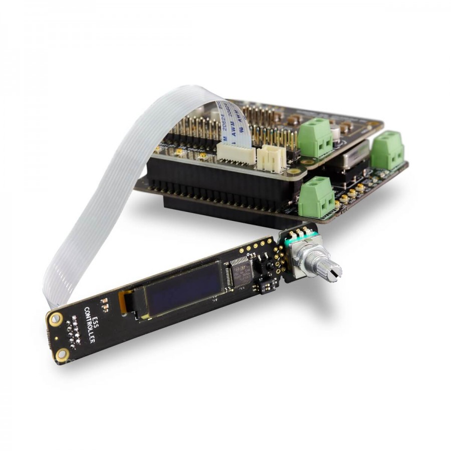

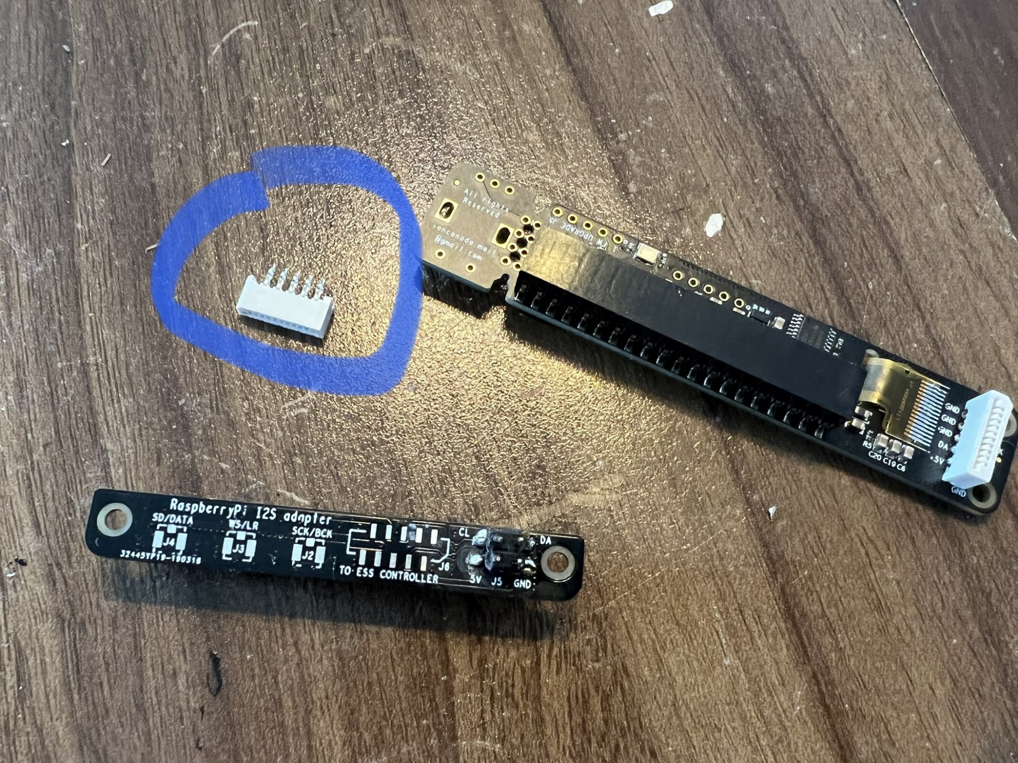

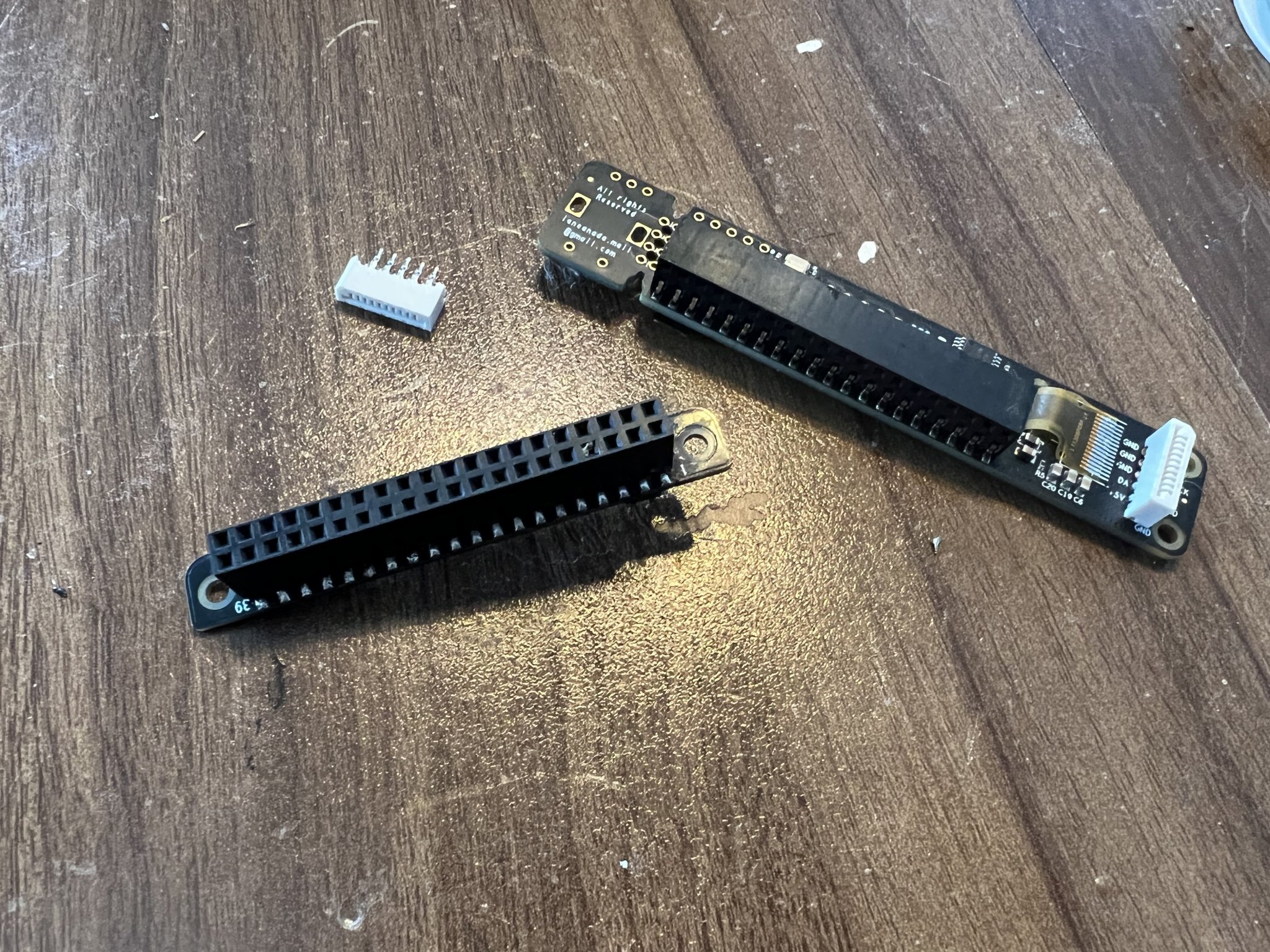

where should i solder this small plug, the pins are straight, should i bend them 45 degrees?
on a picture i see the plug soldered on a board

It should be a FFC/FPC connector in SMT, the one in the picture could be wrong.where should i solder this small plug, the pins are straight, should i bend them 45 degrees?
unfortunately there were two of the same plug in the ESSC Kit, what can i do now ?It should be a FFC/FPC connector in SMT, the one in the picture could be wrong.
@Aiello
Please send an email to me with full shipping address and phone number. I'll send you one for free.

yes no problem at all, this can happen@ Aiello
You are welcome. Please ask them before place an order just in case it was originally packaged wrong on my end.

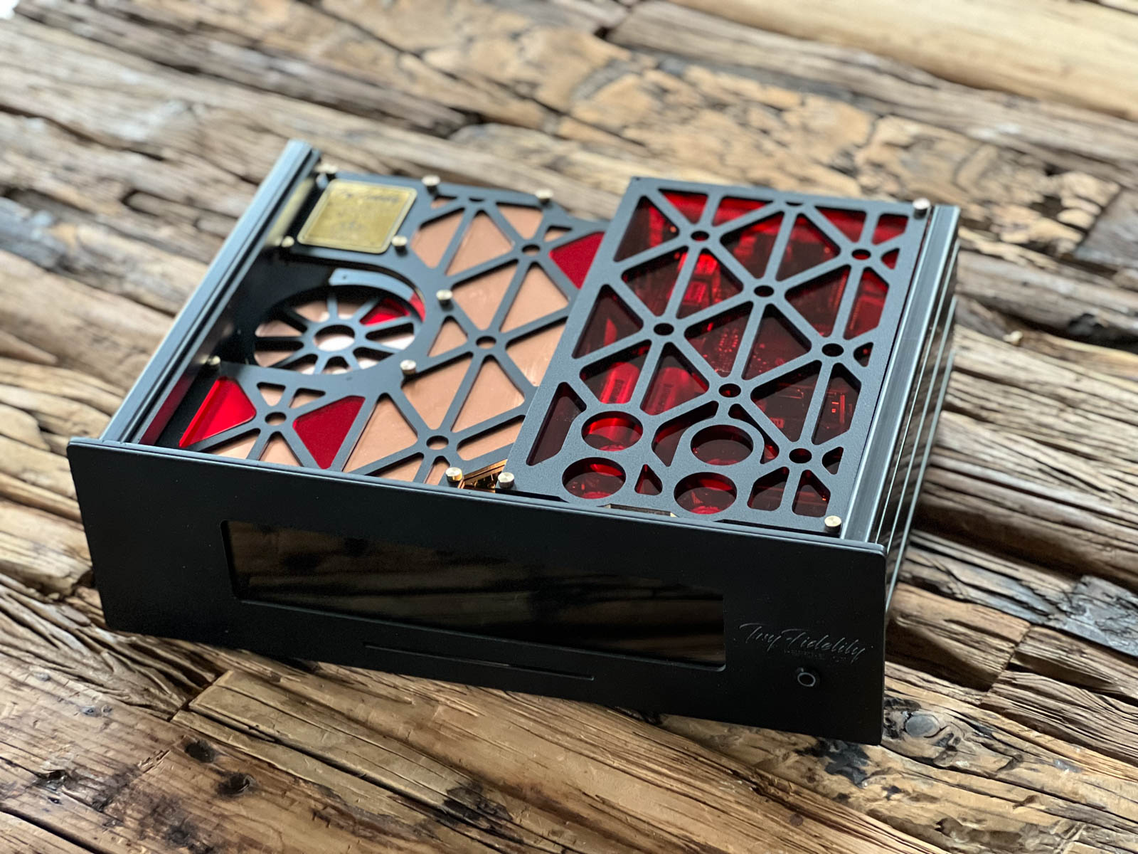

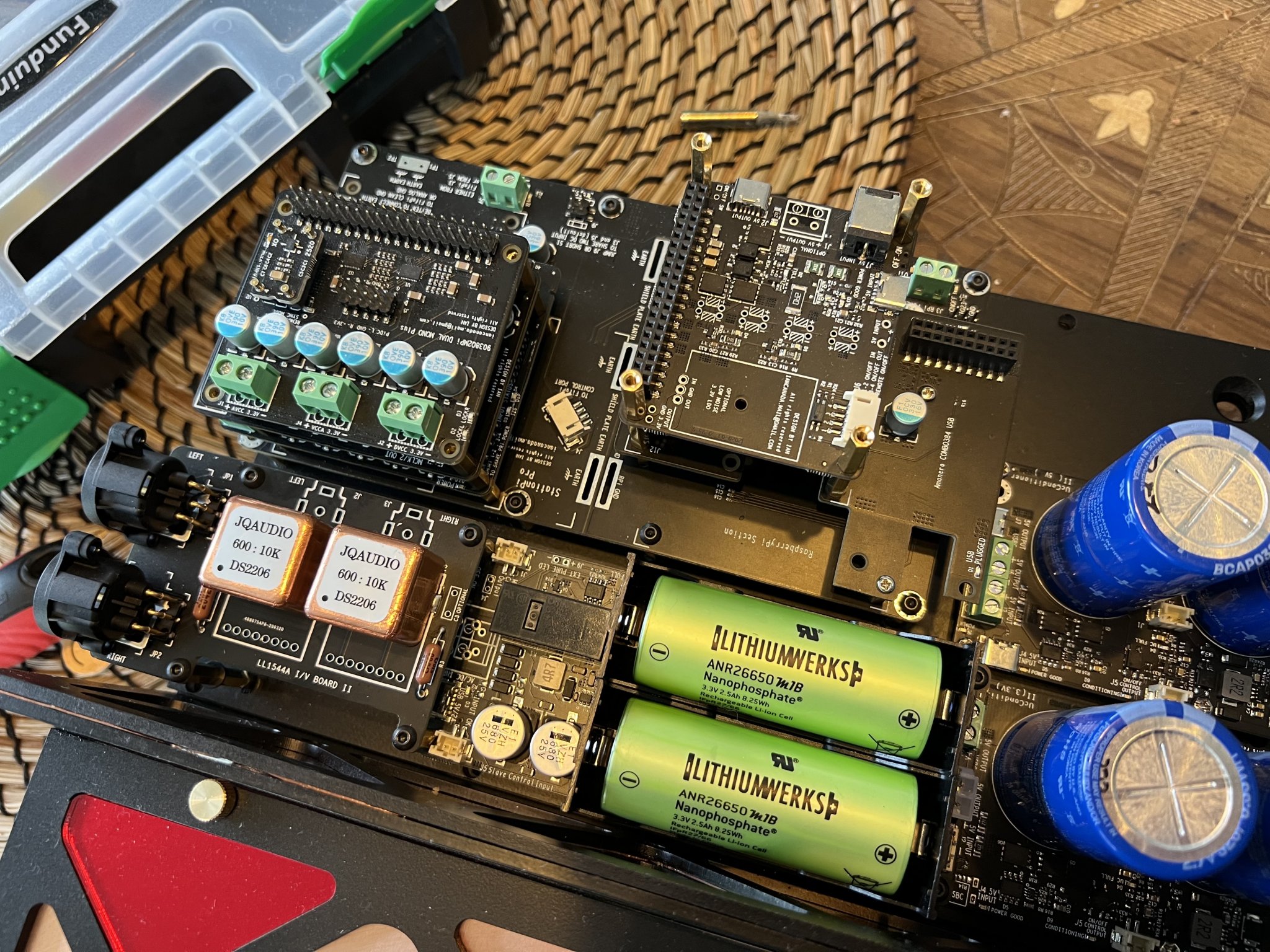

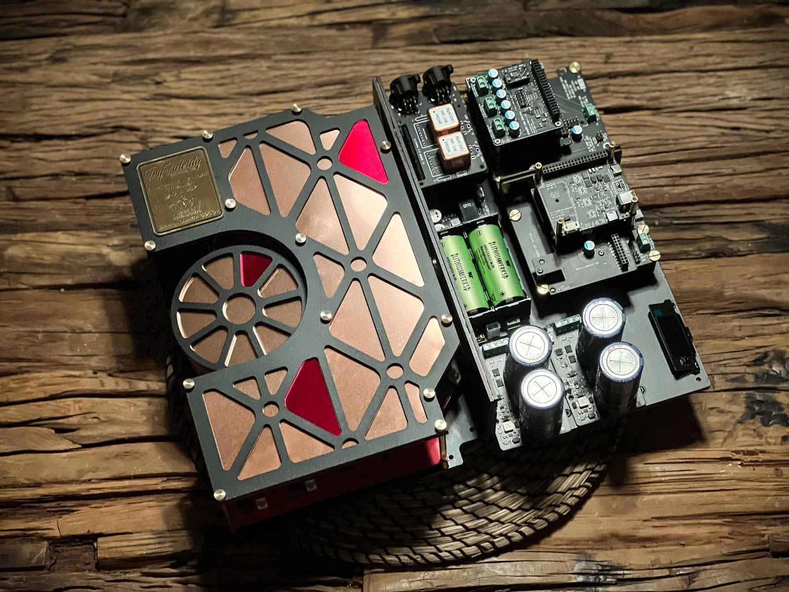

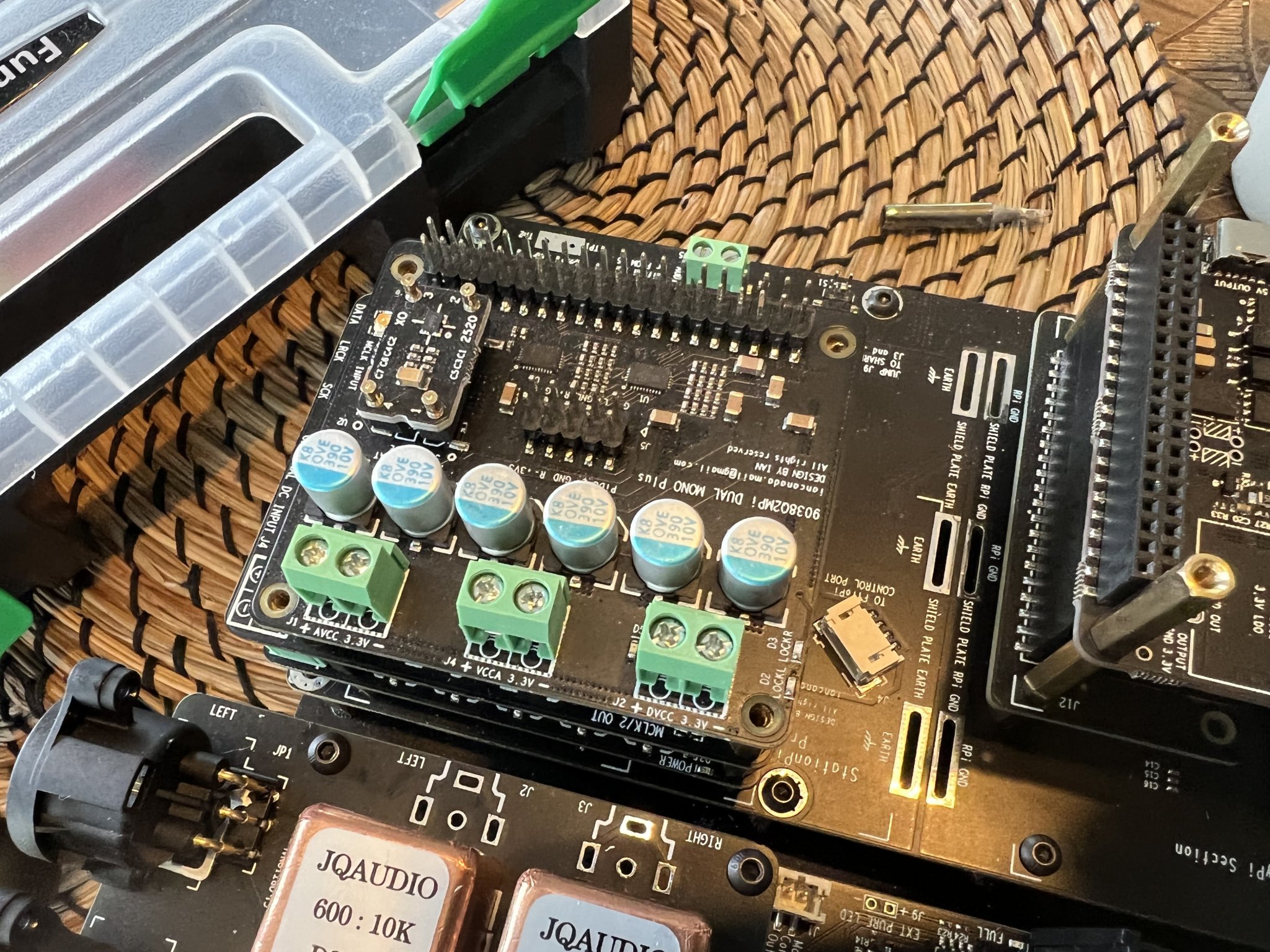

got a little further with my project, the inner covers are finished, and the super capacitors have a view window, the 4 circles and have a view of all your parts and will design another new enclosure
