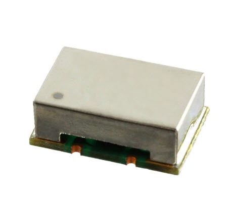

I went with the accusilicon cheapy version on aliexpress.
A definite improvement on the stock.
I have a pretty basic set up compared with others and just wanted to see if I could tell the difference.
I could. I am not able to give decent comparisons. Like I say,, I am a bit of a noob.
However, I took a punt on the aliexpress ones. He said they were genuine (who knows).
They were a good price and I feel the upgrade def worth what i paid.

I believe Accusilicon is 4 pin plug in. Just plug and play. Crystek used to sell through the hole as well. Iancanada sells a little pcb that converts a variety of sized smd to thru the hole.
NDK SDA were always through the hole and very small. I have used them and they are a tiny thing that requires good tweezers, a magnifying glass and a steady hand. They are soldered to little pcb that Ian sells. If you have the equipment they are inexpensive and sound good.

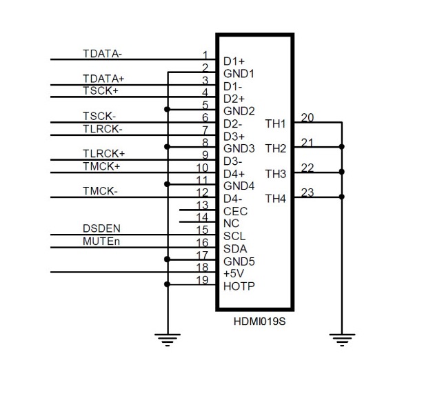

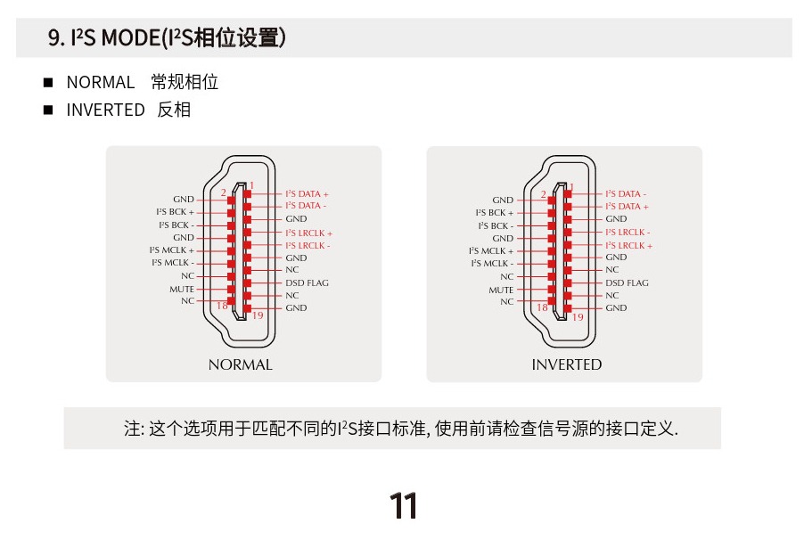

Also I have look in the manual for my DAC (SMSL VMV D2) and the TransportPiDigi and trying to understand if they will work. I am not super techie so I have a hard time to say for sure it will work. Attaching the I2S layout for both. Would really appreciate help. Sorry for a maybe stupid question but I2S is very new to me.
https://www.audiophonics.fr/en/dac-...r-digital-audio-interface-module-p-16714.html
Have anyone experience of the TransportPiDigi? And maybe compared it to Allo Digione?
IIRC, HDMI dac interfaces use LVDS signals. OTOH the TransportPiDigi you linked to appears to have RPi GPIO bus type connectors, which would tend to imply LVCMOS signals. There are chips to convert LVCMOS to LVDS, if you want to design your own interface. Other than that IIRC Ian also makes some kind of HDMI interface add-on board(s) that can be used with his FIFO board products.
Yes, TransportPiDigi with Raspberry Pi will work with your DAC using I2S. TPiDigi has LVDS I2s output by HDMI connector. In the Dac set Hdmi as inverted.I have an Allo DigiOne today and thinking about upgrading to Ian Canadas TransportPiDigi and upgrade the clocks to Crystek.

No. TransportPidigi i2s output is LVDS. GPIO is only for RPi.IIRC, HDMI dac interfaces use LVDS signals. OTOH the TransportPiDigi you linked to appears to have RPi GPIO bus type connectors, which would tend to imply LVCMOS signals. There are chips to convert LVCMOS to LVDS, if you want to design your own interface. Other than that IIRC Ian also makes some kind of HDMI interface add-on board(s) that can be used with his FIFO board products.

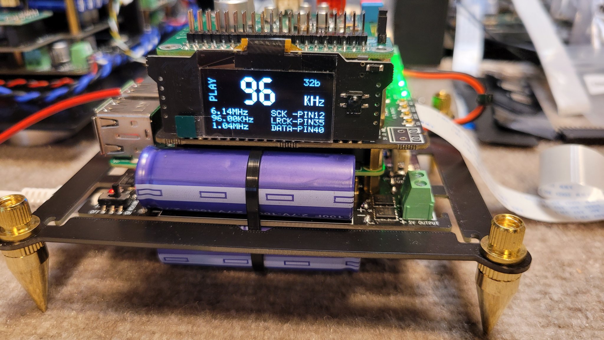

I'm sitting here working at my bench listening to my favorite roon playlist. I recently picked up Ian's PurePi LifePO4 and Super Cap boards. Even with an older (Mamboberry) DAC hat that had long been retired, I've been very impressed with the sound using the PurePi to power the stack. To me, I hear a much broader body to the dynamics of the music. Nuances of the sound are well defined, with very punchy dynamics. I can now hear the difference batteries make on the sound. Clean, clear and quiet. No fatigue. I need to put this little rig in my listening room and really burn it in. Color me impressed! Not exactly sure how I will package (case) the stack, but I want to do something different, creative and expand my design/building skills. Below are some hints to where I'm going with one of my current projects.
Just thought I'd share my listening experience using the PurePi. We all get caught up in the technical, and forget it's all about the music.

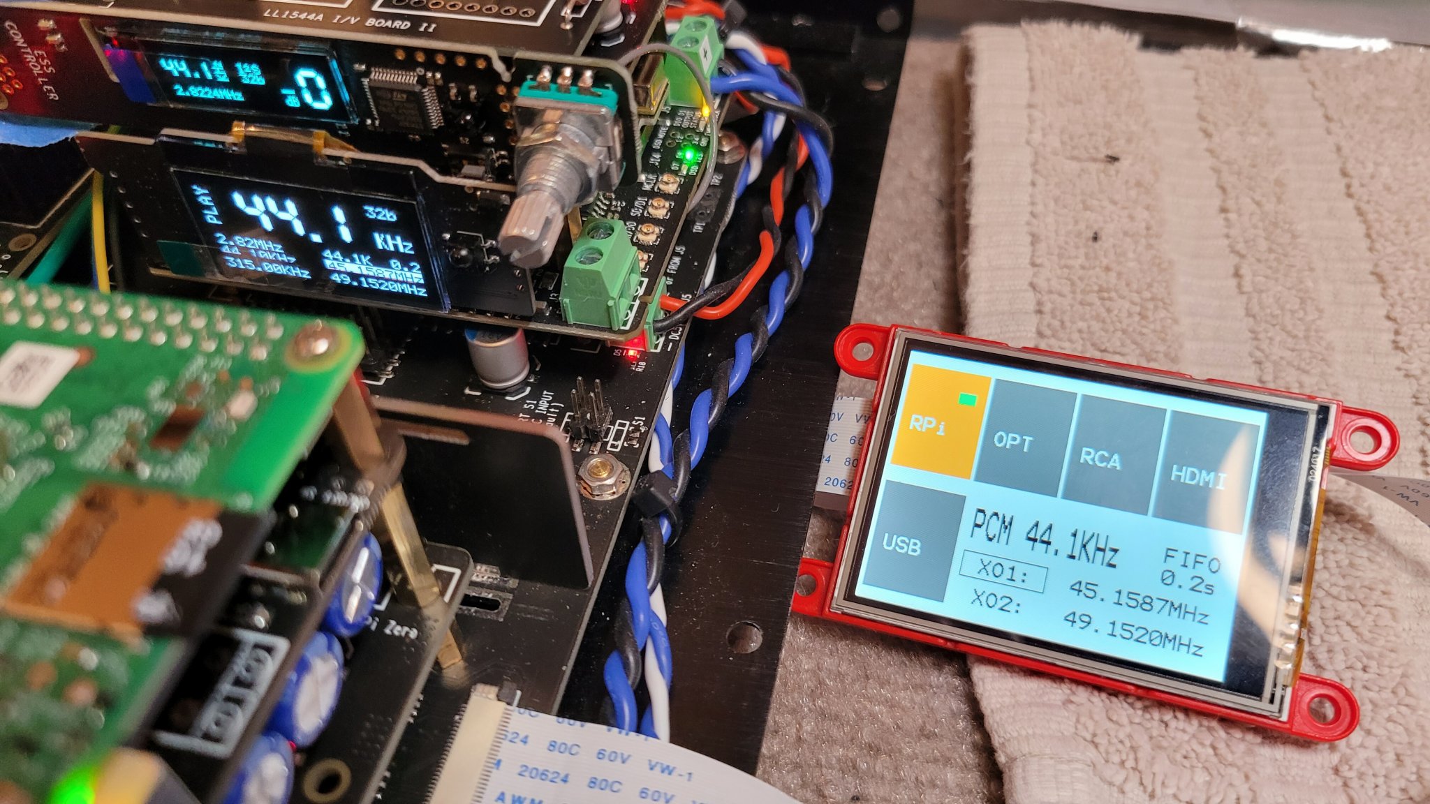

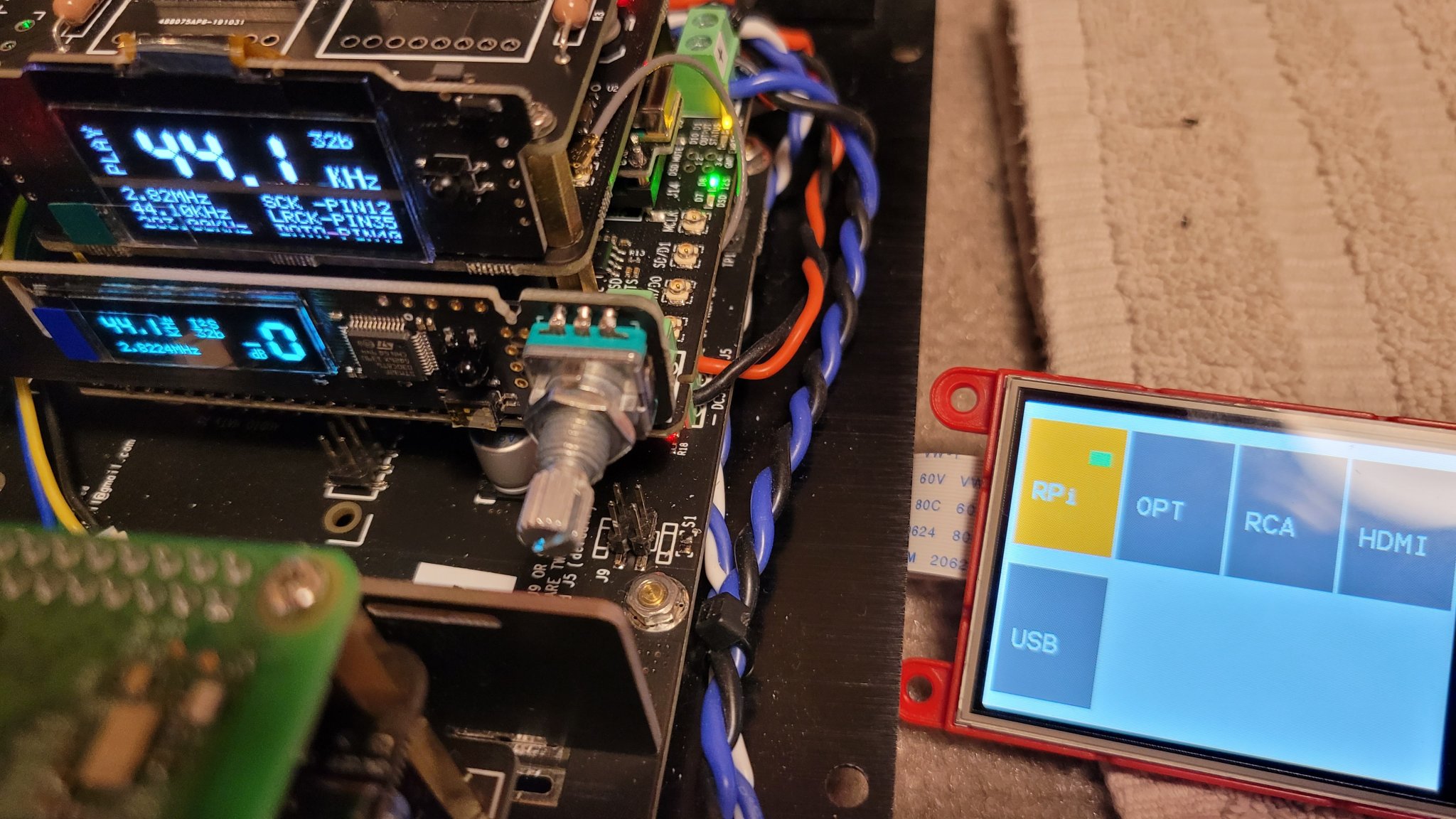

I'm finally getting some of my DAC projects ready to leave my bench but still have some lingering questions... My primary goal is to get all 3 displays working together properly. Those would be the ESS Controller, MonitorPi and the 4D Systems LCD panel. My core audio stack includes the following Ian RPi HATs;
StationPi Pro > FifoPi Q7 > Dual Mono DAC > Transformer Output to RCA, and ancillary displays as mentioned above.
I will admit upfront that some of the issues may be unwittingly user introduced. My apologizes if this information may have been covered elsewhere in the forum/thread.
With all of my testing and retesting, the only way to get music - with displays attached - is with configuration #2 as noted below;
The selection LCD is optional, and when attached as shown, it does display the FiFo data in the lower right-hand of the screen.
#1 config (no music)
o Original ESS controller attached to the non-isolated GPIO header on the Q7.
o MonitorPi attached to DAC isolated GPIO header.
o 2.4" LCD display attached to the StationPi Pro connector.
#2 config (music!)
If I swap the ESS controller display with the MPi all seems to be well;
o Original ESS controller attached to the isolated DAC GPIO header.
o MonitorPi attached to Q7 non-isolated GPIO header.
The only conclusion I can draw is that the ESS controller must be attached to the DAC isolated GPIO header for all 3 displays to work correctly and output music. In configuration #2 both seem to be controlling the DAC though. Not sure that's a problem. Is this the way it was intended?
It was my understanding, that the MonitorPi is (should be) capable of playing music without the ESS controller attached as well? But that doesn't seem to be the case. The MPi displays information as if it was playing a track, but I get no sound. The optional 4D LCD also displays the bitrate and the crystal frequency being used.
With both displays needing to be attached there is a lot of unnecessary redundancy in the information displayed. Maybe this interaction of the 2 displays will be improved upon with the next generation of hardware/software. In addition, I know of no way to turn off the ESS display to help with burn-out with long term usage.
Has anyone else - using similar setup with Ian's great products - have a better understanding of my findings and if 'that's just the way it works'. Or, is there something I've overlooked that would make my working configuration #2 less redundant. Otherwise, I love the modularity of Ian's products, and well... the music speaks itself!
One other thing... Is the Apple remote suppose to control the MonitorPi? I get nothing when used with it.
Config #1 - Music, but no LCD display.
Config #2 - Music and all displays work.

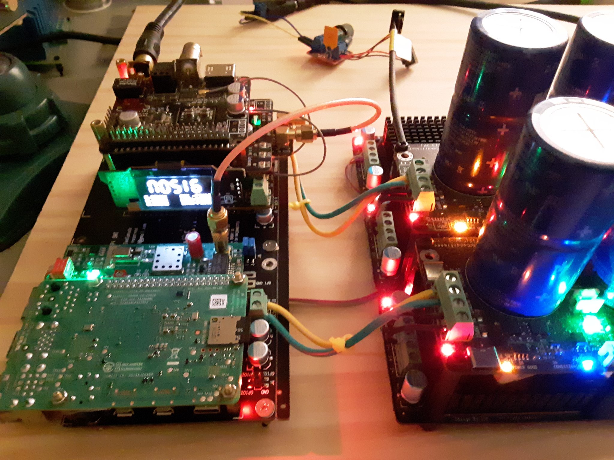

How are you powering the Neutrino clocks? Separate power supplies or LifePO? If LifePO how did you configure it?In my rig, I'm using a Neutrino 2 clock (XO2) and a Crystek (XO1) as the local clock in my SinePi, and I have to say that the Neutrino 2 is a nice upgrade to the Crystek. In fact, I'll be getting another Neutrino 2 to replace the Crystek.
