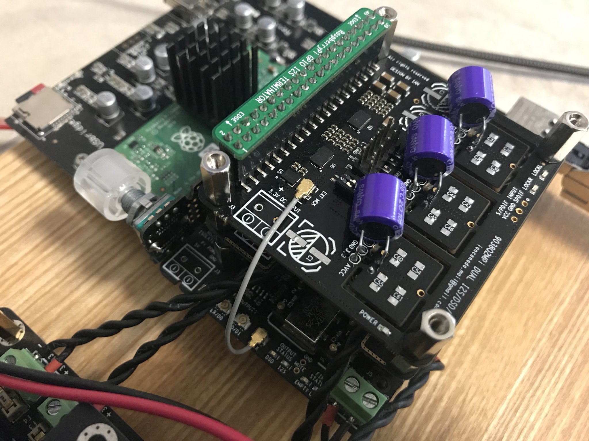

I recently made an experiment and want to share my impression.
I removed three polymer capacitors and ceramic ones from the VCCA, DVCC, AVCC power pads from the DAC board.
I installed 3 x Sanyo OS-CON 820uF. The result was found positive for sound quality. The power wires come from the bottom of each pad.
Along with the advantages, one drawback appeared. When the LiFePo4 PSU shuts down on a timer after 5 hours, I hear a loud bang and a humming decay sound. This feature appeared after the replacement of capacitors. I'm scared to burn my speakers’ tweets.
What did I do wrong and how can I fix it?
