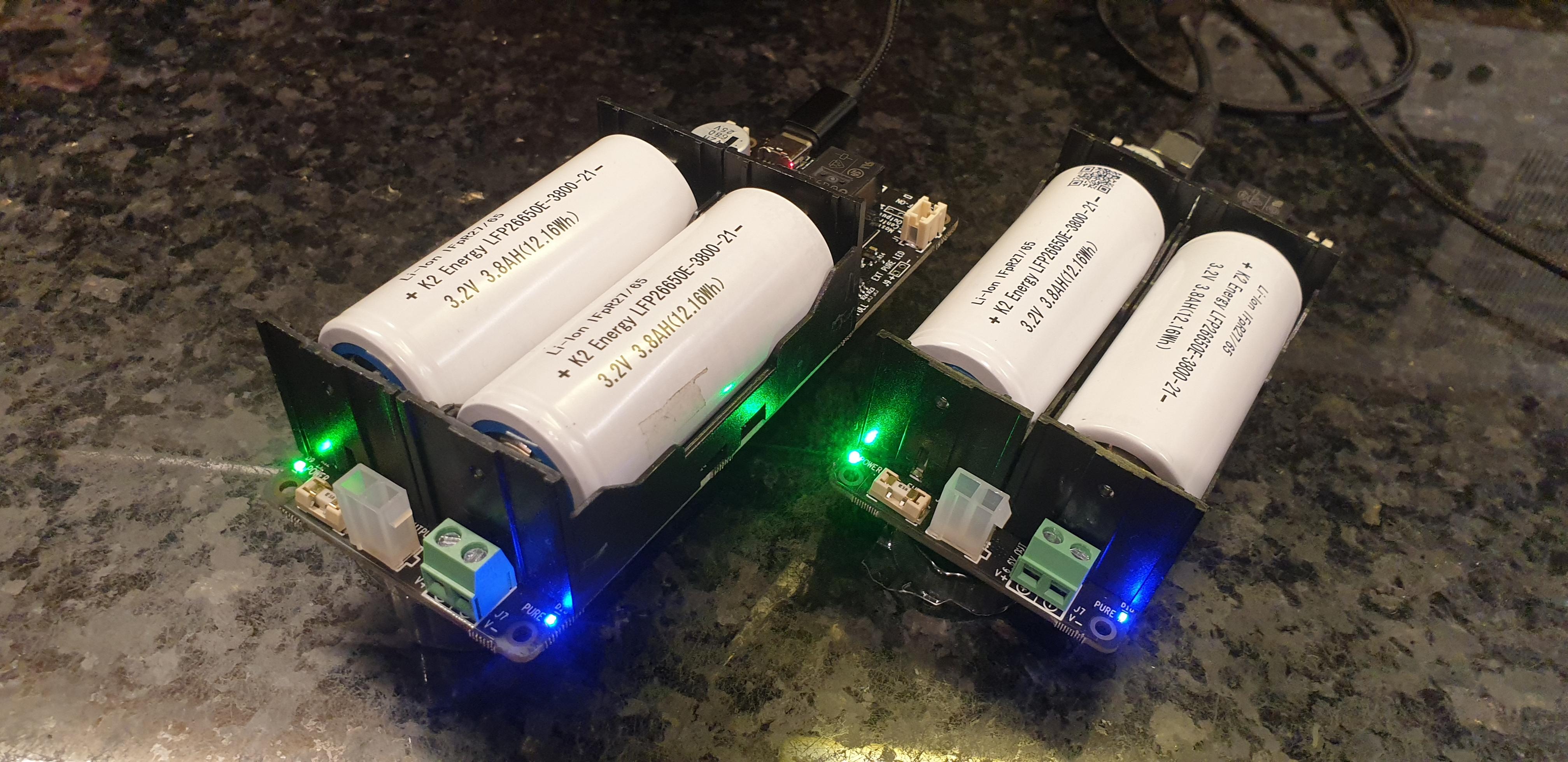

Next task is my lifepo4.
I got it second hand and it was fine for months then gradually started shutting down earlier and earlier until it wouldn’t stay on.
I realised the biggest cap was bulging so swapped that.
It worked great for months after that, then started doing it again.
So it was suggested that I change the other caps. So I did.
It sits powered but in off mode happily indefinitely.
Stating charging. Gets as high as 1.95v then sits there.
When I switch it on with nothing attached, it shuts down again showing ‘short protection’ after ten seconds.
Ian said it will do that if there is not 3V after one second.
I have checked the fuses and briefly looked over the board.
When it is powered on but in OFF state, all but one battery shows 3.35V to 3.65V.
The last one only shows 1.94V.
(It currently only has 8 cells)
When I switch it on, before it shuts down the output shows:
J3 10.68V
j4 10.45V
j2 1.97
j1 3.69
j8 5V
That is the likely cause isn’t it?
The low battery and that needs replacing.

On Ian's LiFePO4 board, not much more to add. A low cell in that position will cause exactly the issue you are seeing.

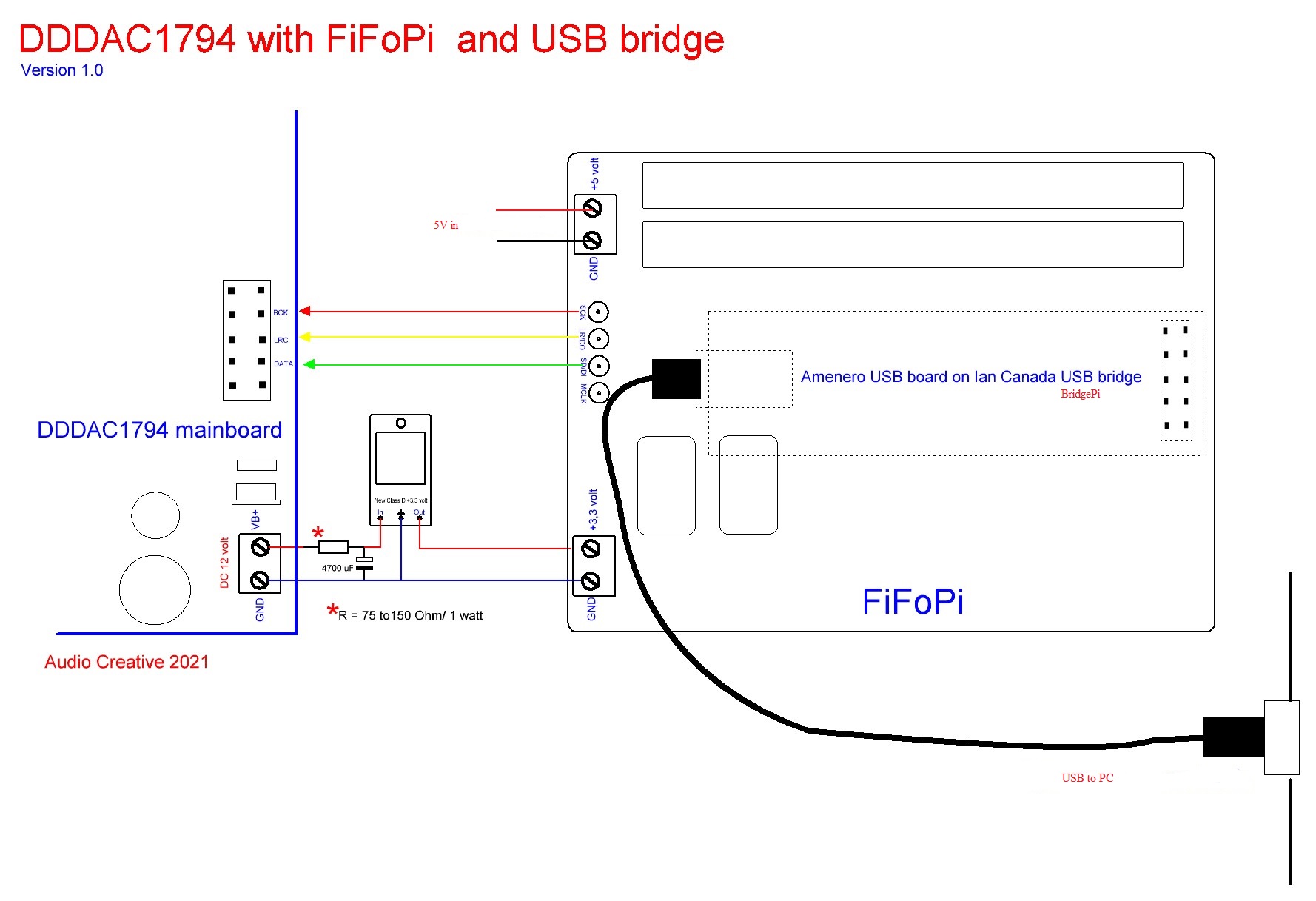

I will ask here aswel.
I have Amanero USB interface, BridgePi and FifoPi Q3 Ultimate. I power it up with 5V to J3 and 3.3V to J5.
FifoPi powers up and Power LED is ON (green led) and EMPTY led is ON (red). Nothing else.
My PC recognizes the Amanero interface.
Does Amanero needs to be in Slave mode? Maybe connect uFL MCLK from FifoPi to BridgePi?
Can't figure it out, for now.
Thanks in advance
Thanks in advance

Not sure how you have this all hooked up. Can you explain and also post pix?
Greg in Mississippi
Greg in Mississippi

Everything is connected as per diagram in the attachment.
But, I've sorted it out. Now it works and music is playing.
BridgePi was full of cold/bad joints. I've resoldered everything and now it works.
Thanks for your help

Got my 2 battery psu rigged up and working. Both putting out perfect voltages. Nice things these. Will be powering Fifo clean with the 3v3 and my Andrea Mori entry level clock with the 6v6. Should be good.
