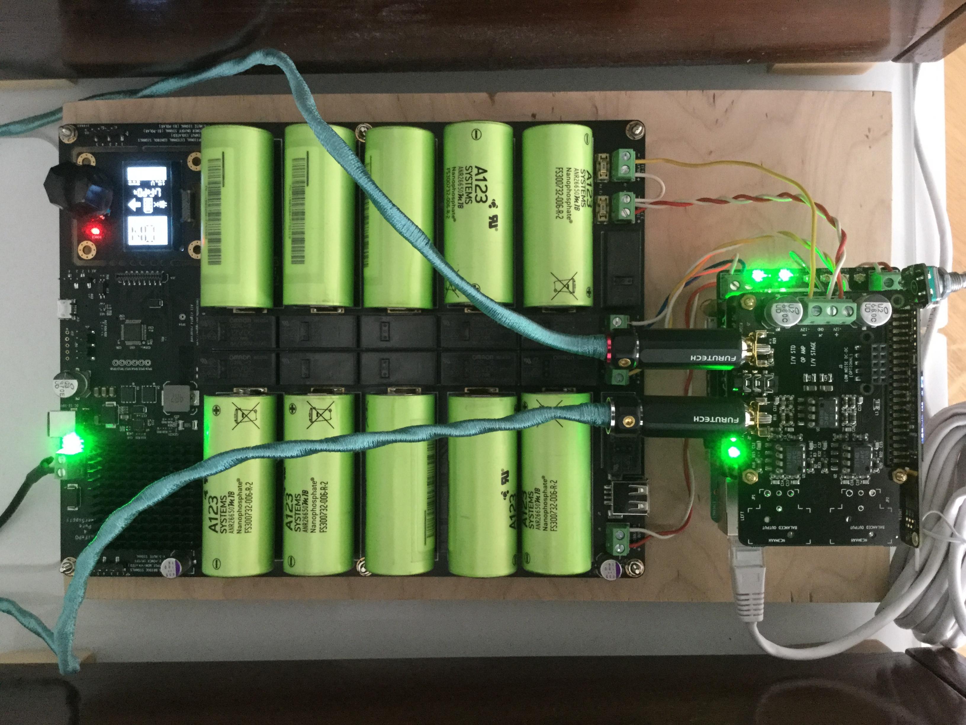

I just assembled one battery supply and have a question: the supply only works when connected to the mains. Is it not possible to use it off the mains as a portable battery supply?
You need external power to run the microcontroller, display, relays, monitoring etc. I think it's kind of missing the point if it was possible to use one of your hard won clean battery rails to do that. However I don't initially see any reason why you couldn't connect an external 12V battery to J5. The current draw needs to be considered though.

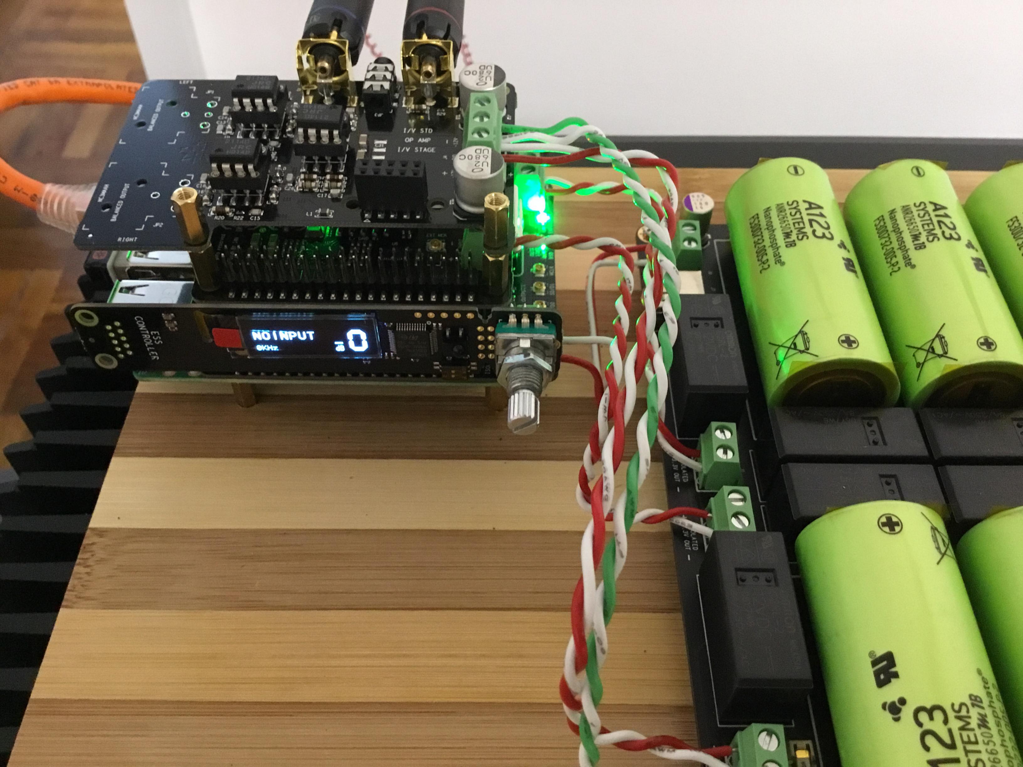

I just assembled the setup. Need some advice on setting up the dac hat in dietpi.
I installed dietpt, roon-bridge, and raspotify. The roon device is visible and can be selected:

However when I play a song via roon there is no sound output. Roon shows the song actively playing and there is no error reported. Perhaps I need to configure the DAC hat somehow?
Any pointers are most appreciated!
All battery rails are isolated and independent from any other circuit. If using battery to power the board itself, the isolation will be broken thus degrade the low noise performance. That's why I can not design it in that way.
It's an audio power supply, not a portable power supply

You need to go to dietpi-config and in the audio section pick to install the drivers for one of other i2s DAC hats. Then restart and the aplyer output should show another card that is what you need to use Roon with.

I used dietpi-config to configure the sound device to hifiberry dac-plus. It seems to detect the DAC correctly:
root@DietPi:~# aplay -l
**** List of PLAYBACK Hardware Devices ****
card 0: sndrpihifiberry [snd_rpi_hifiberry_dacplus], device 0: HiFiBerry DAC+ HiFi pcm512x-hifi-0 []
Subdevices: 1/1
Subdevice #0: subdevice #0
Now when I play via roon the fifopi lock light lights up. However the ESS Controller displays "No Input" and there is still no sound.
Any ideas?
This is displayed when playing audio via Roon or Spotify:
Ess controller displays the real measured signal status. Your OLED shows no signal it means that your RPi did output any audio signal into GPIO. Please confirm your player software is working for the first.

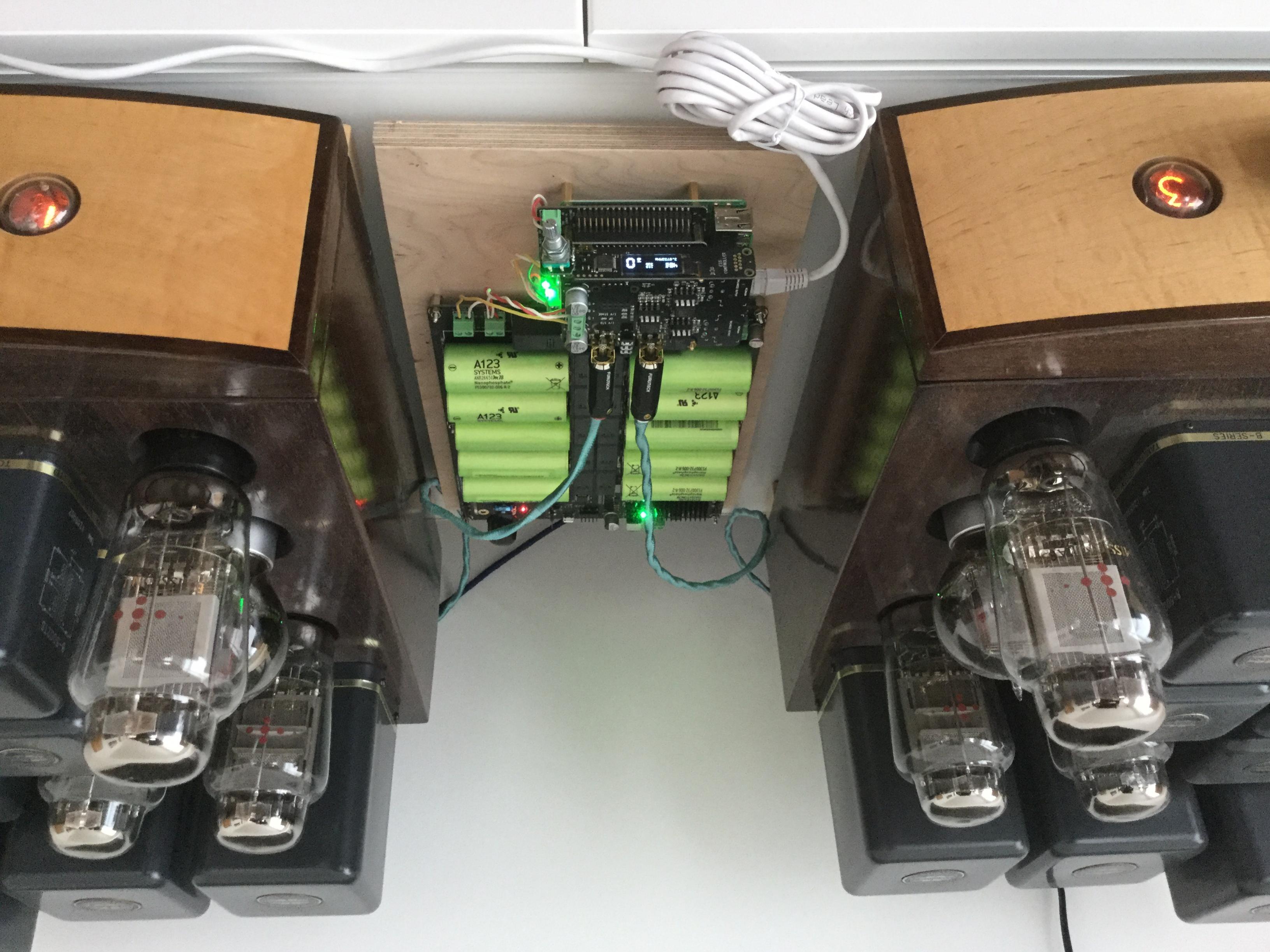

That makes sense. Besides a fixed streamer I also want to build a portable headphone streamer, I will use a simple lifepo charge pcb from China for this.
The dac is build and playing!
BTW, you did good job assembling the LifePO4 battery cells!

Before I play anything the fifo shows empty and no lock. However once I started playing the fifo locks on (green light). How do I verify if the player is working? There is no error reported and roon seems to play normally, just no sound.
