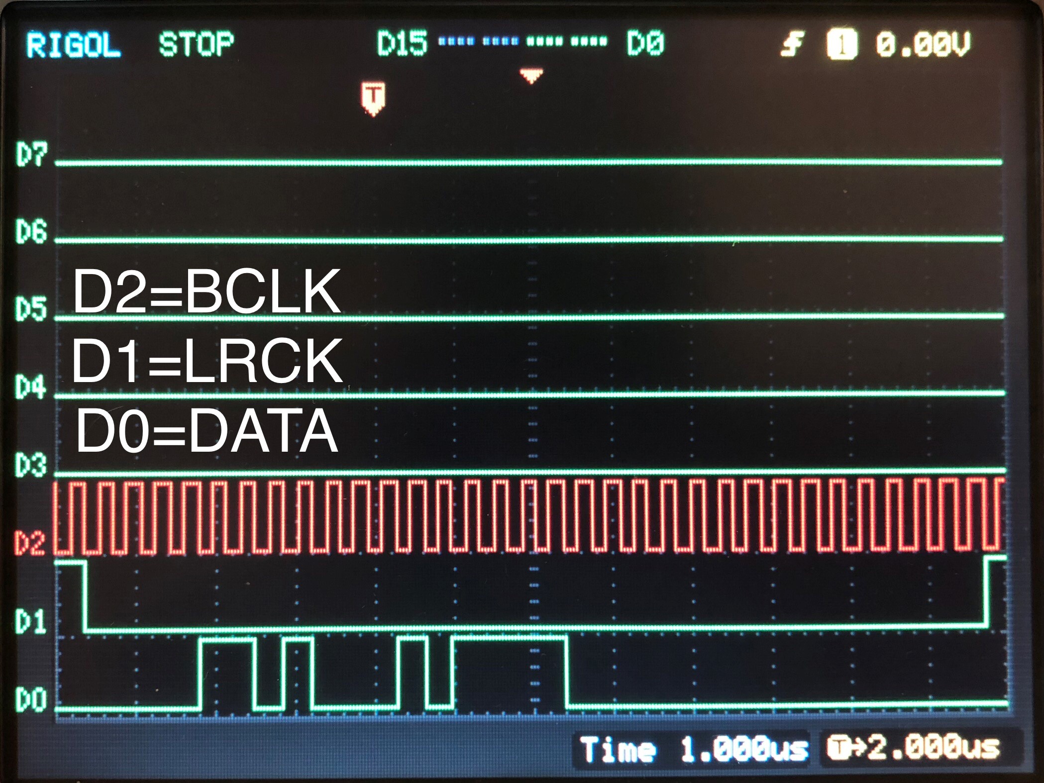

Hi Ian,
I'm using only one 11.2896 MHz clock in FiFoPi and I was hoping to see 16 bit output from the FiFoPi when playing red book 44.1 kHz / 16 bit files, but it seems to be outputting 32 bit with 16 bits of data. Is there any way to force the output to 16 bit which I believe would mean a 1.41 MHz bitclock? (now it is 2.82MHz).
I'm working with an older type of DAC and it don't seem to like the 32bit data... The player I'm using is Roon and Ropieee sw in RPi.
Ian,
I have set Ropieee to use I2S generic driver and in Roon the output set to give 16bit/48kHz max. Still the DATA output from FiFoPi is in 32bit frame and BCLK is 2.81MHz, please see the attached picture. Maybe the problem is with Roon...?
