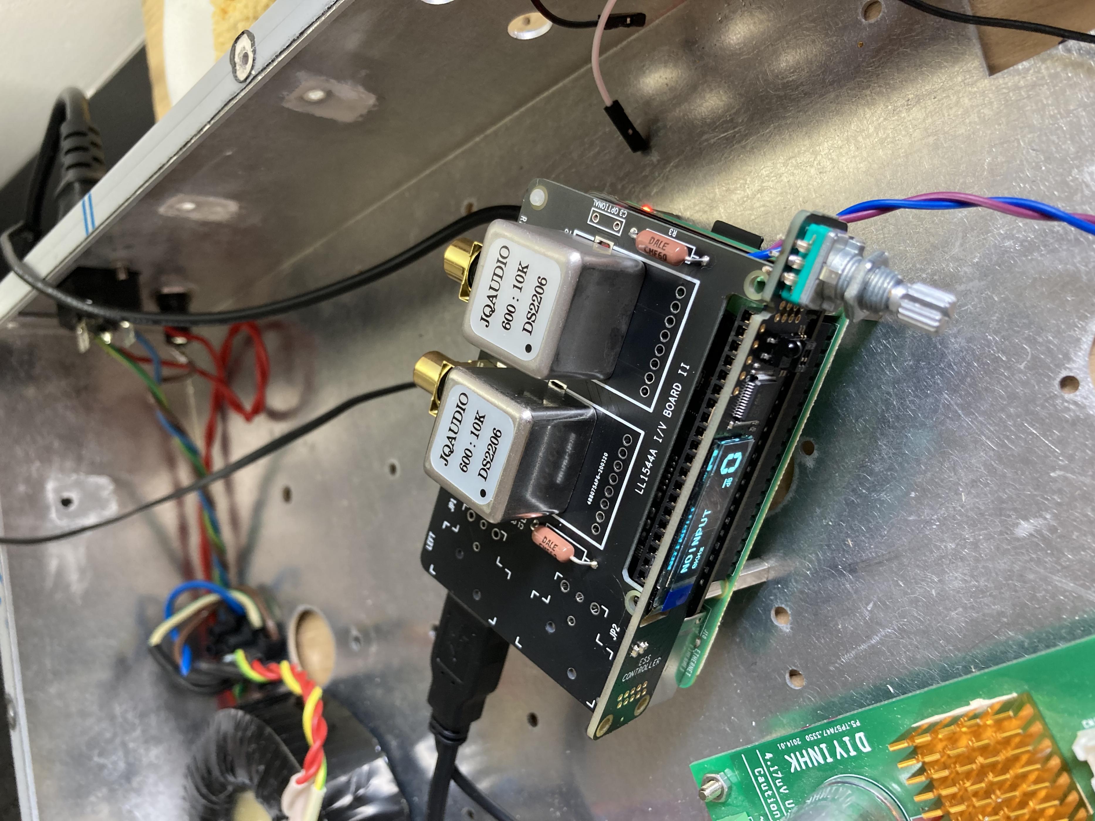

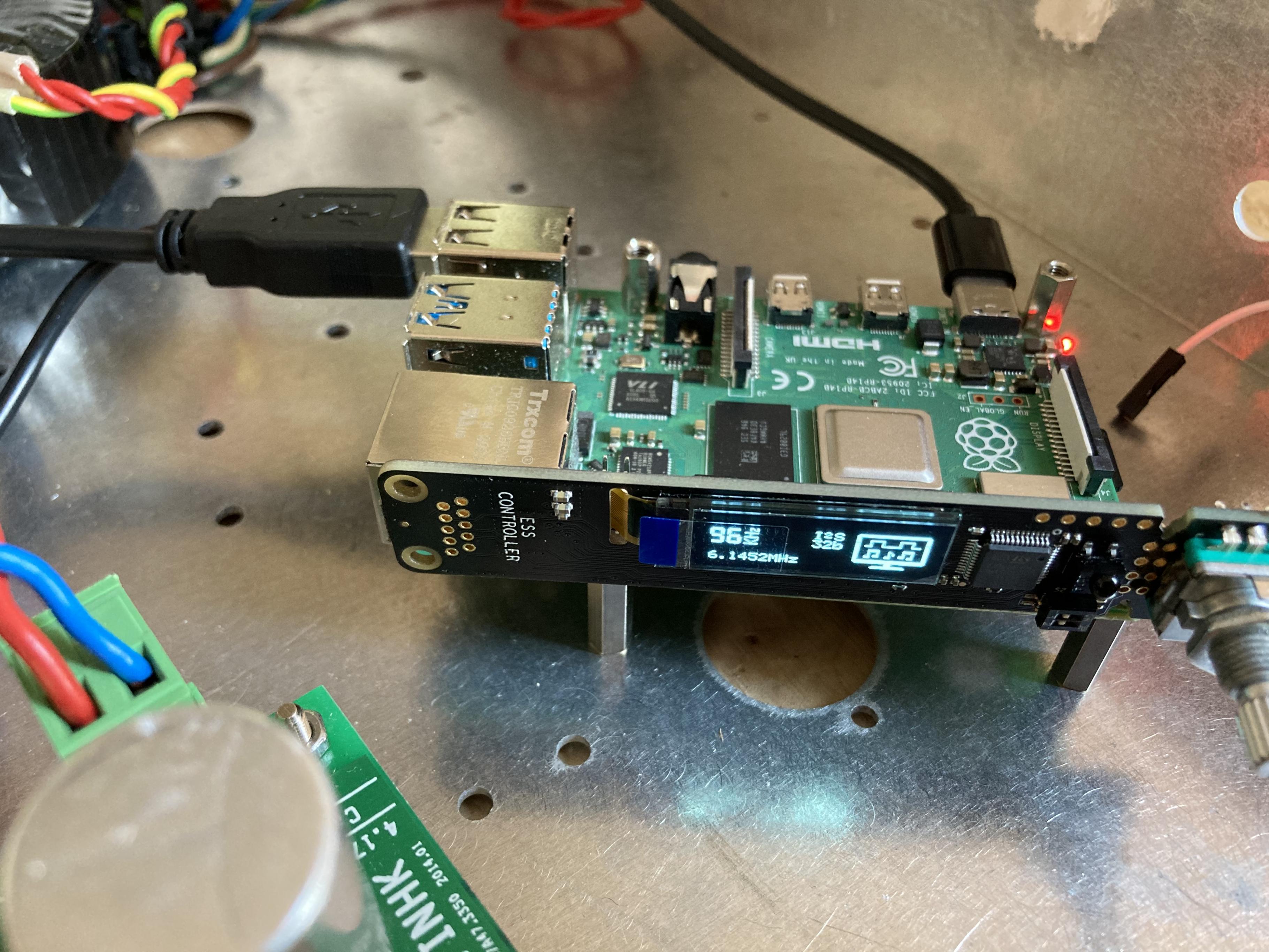

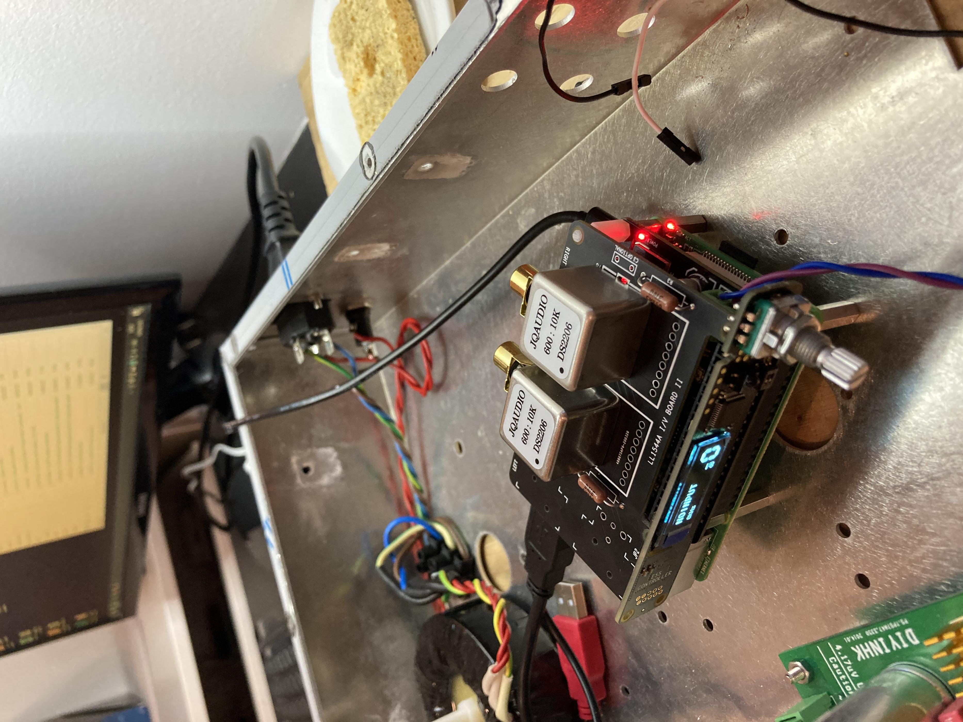

ESS controller NO INPUT
I have similar problem with my simple setup. No sound and NO INPUT on the controller. Volumio appears to behave properly and I can hear the sound over the phones on the RPI if I set it as the output. I tried reflashing, restarting, reassembling. I also reflashed RPI’s eeprom as suggested by Ian. No change. Anything else to do?
Success! Sort of. It appears it was the RPi. I replaced that and things started coming together.
Done. When the music stops NO INPUT on the display. The same with reassembled stack.
I saw 96KHz displayed when you were playing music, that 's correct.
"NO INPUT" for music stops is also correct.
So what's the issue?
