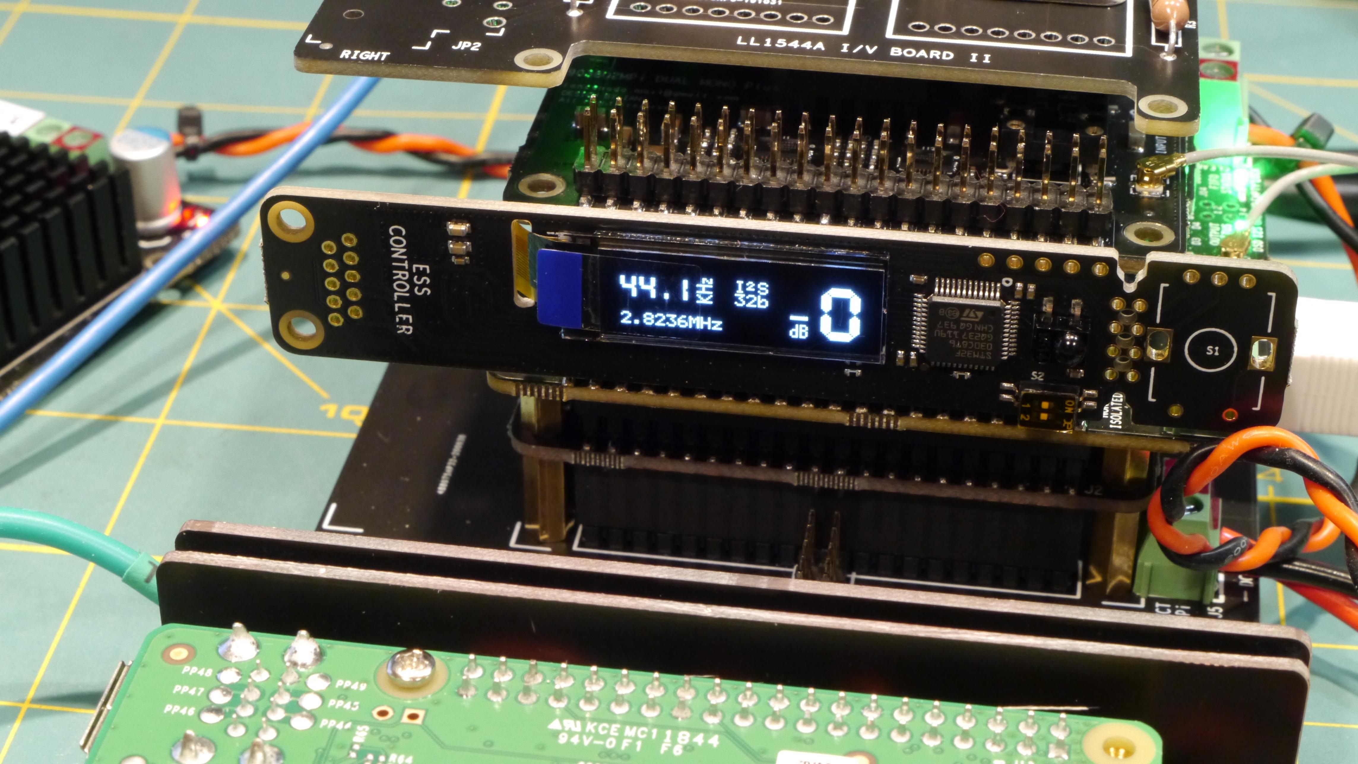

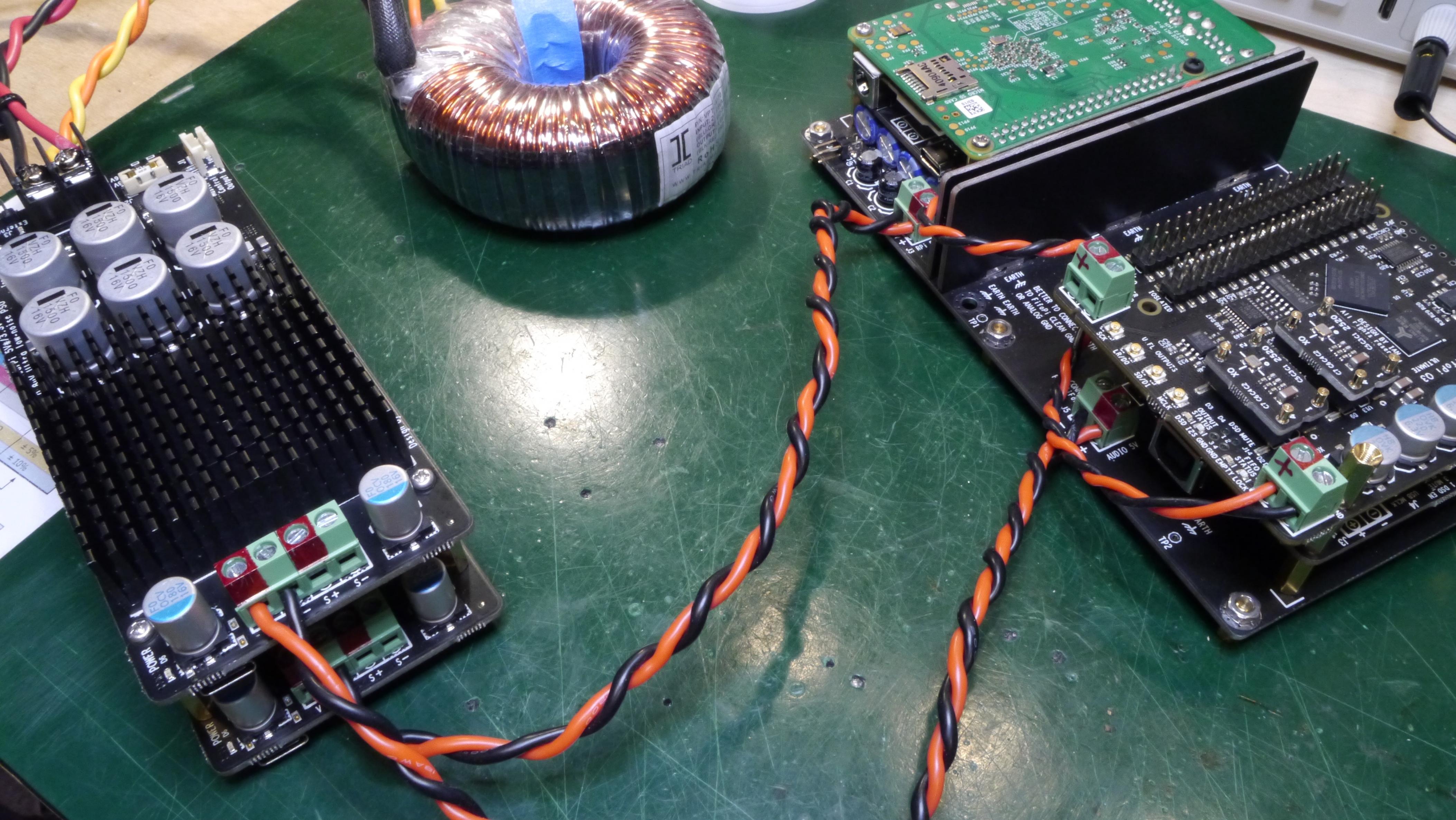

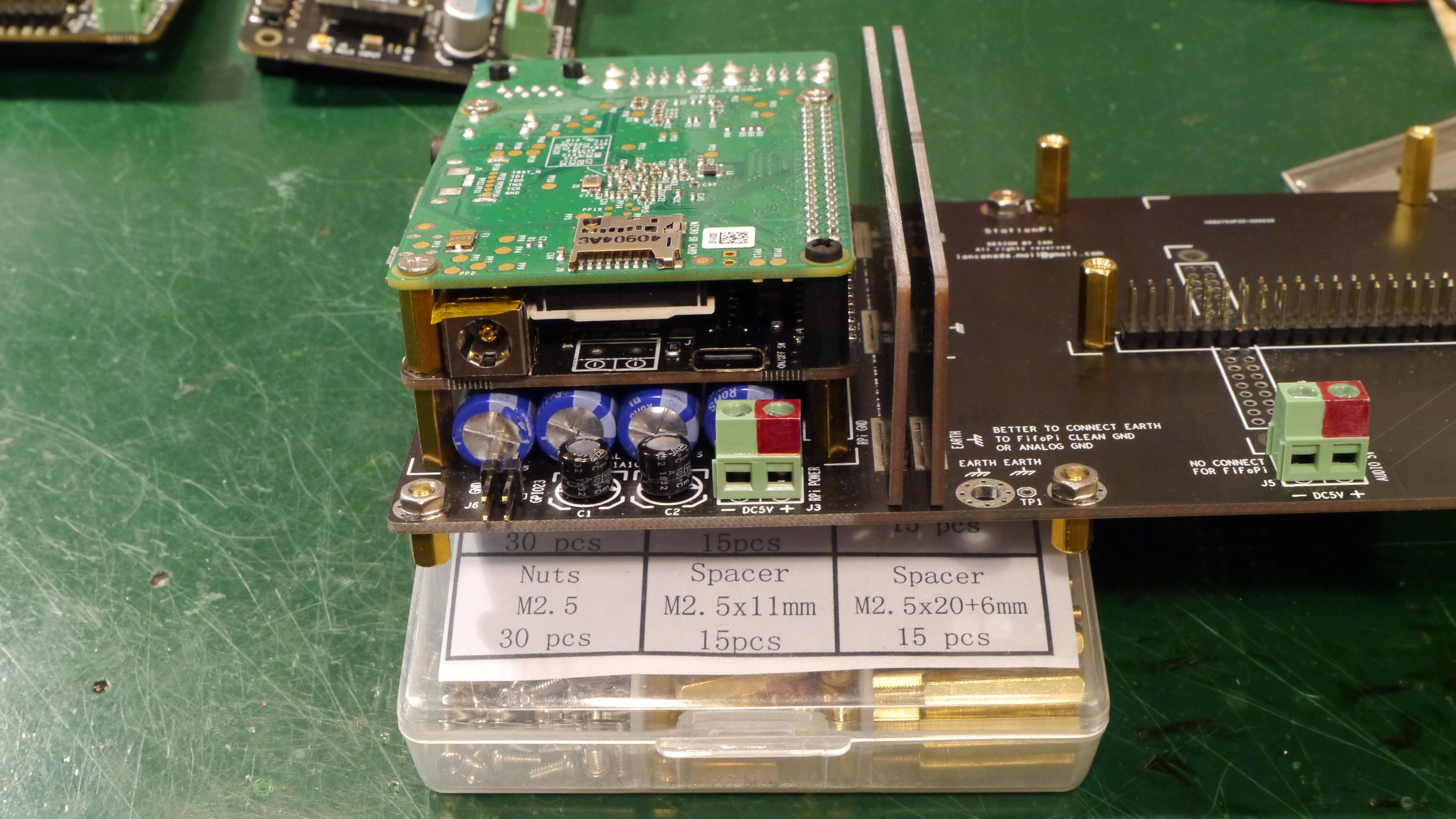

Hello all -
I'm in the testing mode of my 'Version 2' of Ian's DAC stack using a variety of new boards from Ian.

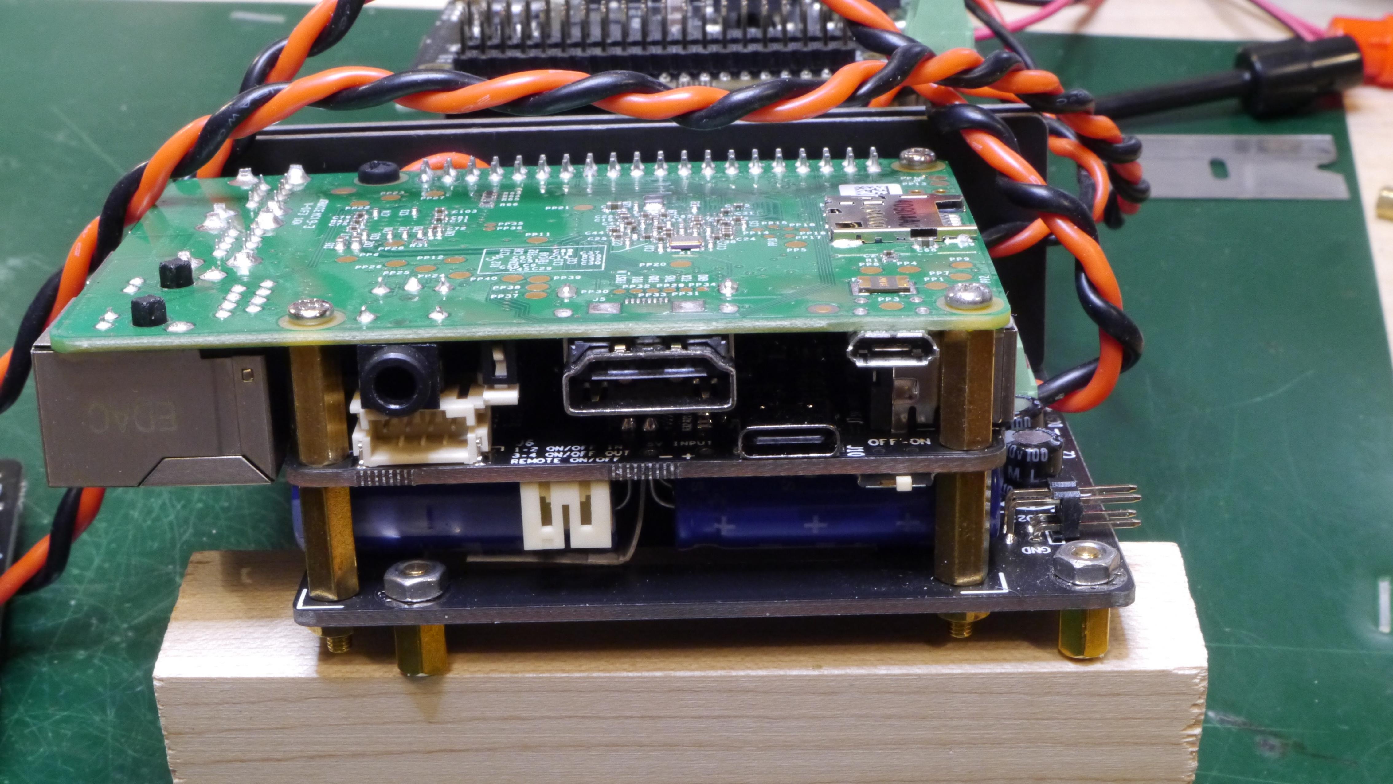

I thought I would base it around the new StationPi that makes hooking everything up a bit easier. As can be seen in the pictures, per Ian's recommendation I'm using the ConditionerPi under the RPi left side of the StationPi. This side is being powered by a singe 5v LinearPi PSU.
On the right side of the 'Station' I've fitted the BridgePi, the FiFoPi Q3, the dual ES DAC, and finally there will be some output stage(either xformer, or opamp). Haven't decided yet.
At the moment, I'm powering the FiFoPi from a single 3.3v regulator fitted on the ConditionerPi (cannot be seen in the pictures). I'm also using a single LinearPi 3.3v PSU for the 3 DAC voltages(this is just for testing). I've got a bench supply supplying the 5V audio connection. This powers the little controller and screen. I have not upgraded any clocks and using the setup in async mode for testing.
I'm running the latest release of Ropieee as my end-point that boots fine and can be seen in roon.

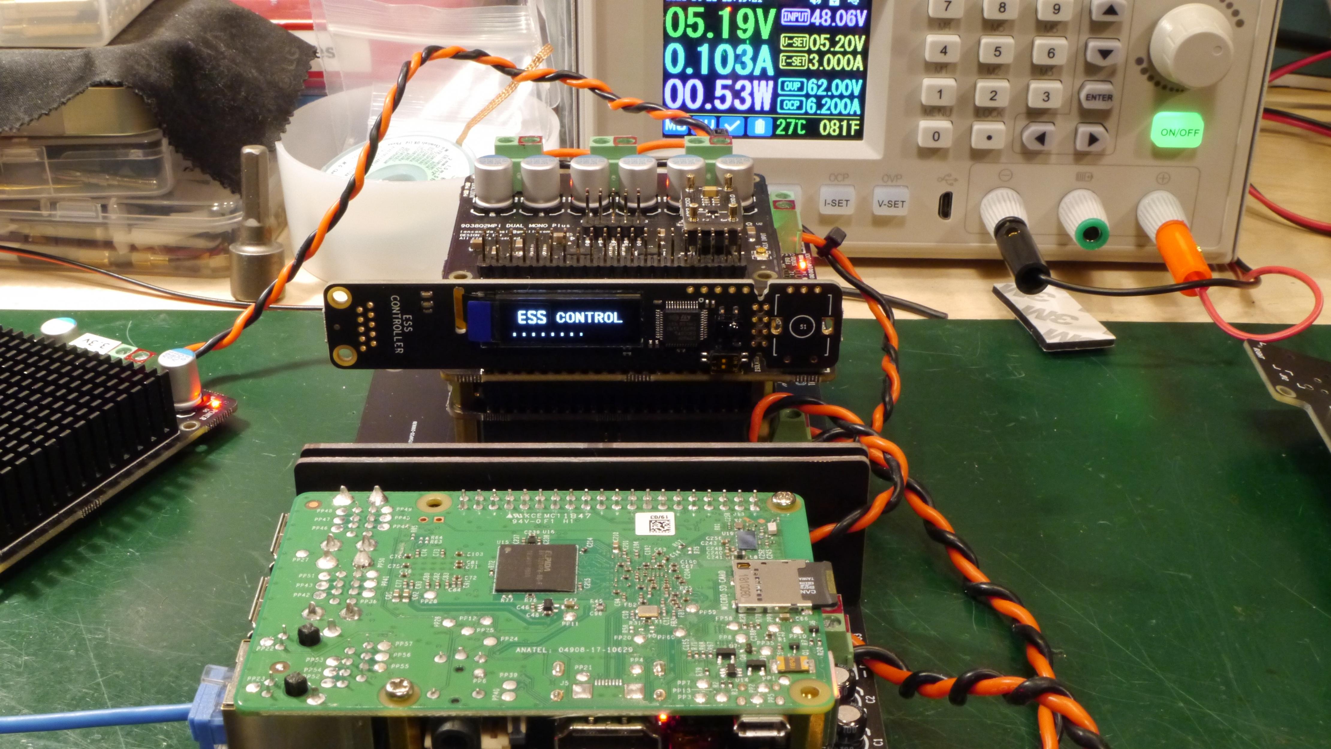

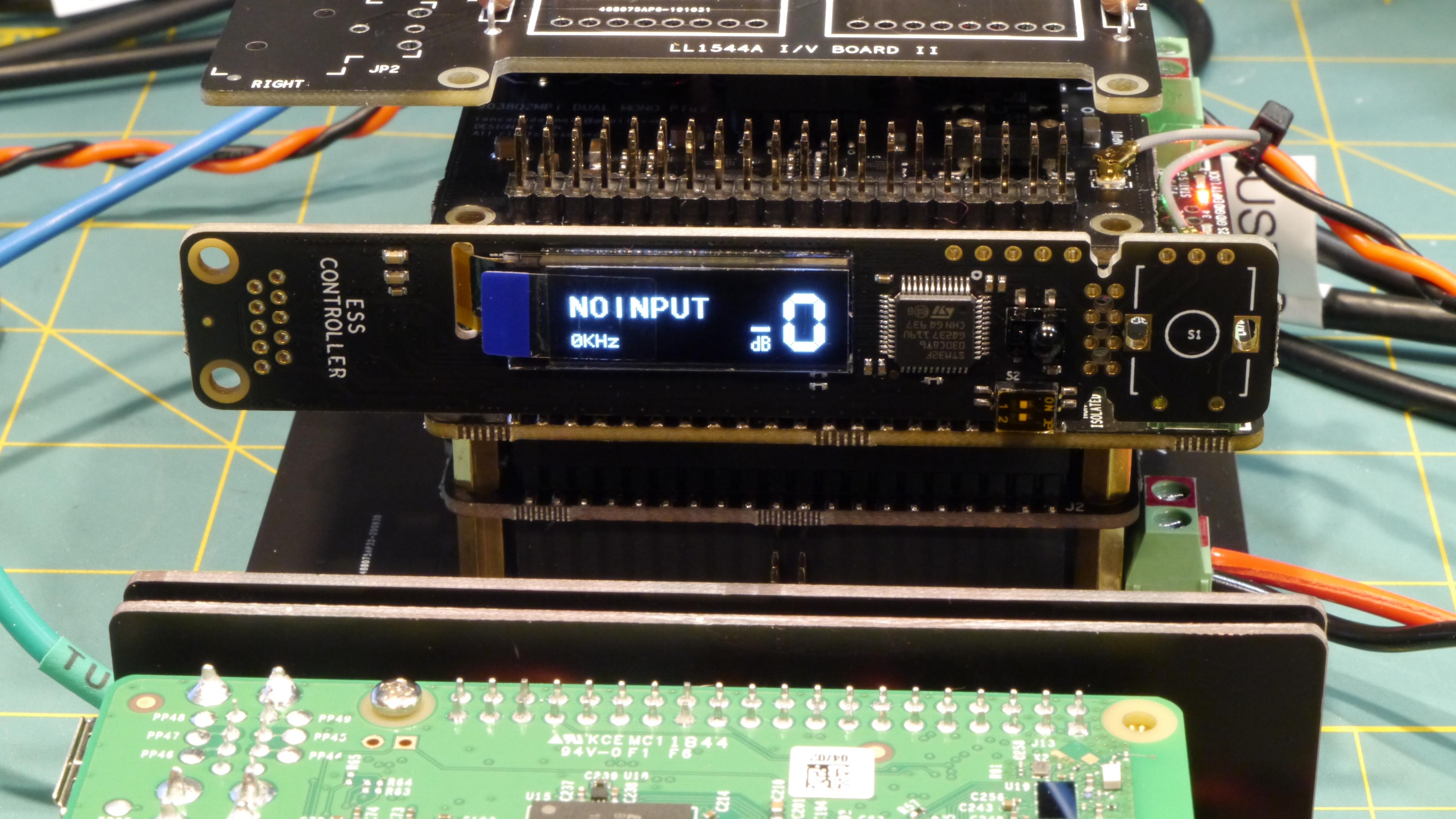

Here's my issue, which I've seen before. 🙁 I'm getting the dreaded ....ESS Controller.... message displayed instead of No Input as it should. I've checked all my voltages and everything appears secure. Checked all my GPIO connections and everything seems to be in order, all pins mating correctly - with nothing obvious standing out in error.
Before I start dismantling the stacking and adding everything one-by-one to try and troubleshoot it, I'd thought I would first touch base here for experienced input from the group and Ian.

@redjr
1. Make sure all of the three 3.3V power rails to the ES9038Q2M DAC are working correctly.
2. Make sure DAC XO is working, otherwise change to AYNC mode by connecting a u.fl cable to FifoPi MCLK.
3. Plug the ESS controller directly to the DAC GPIO to see if it can find the DAC.

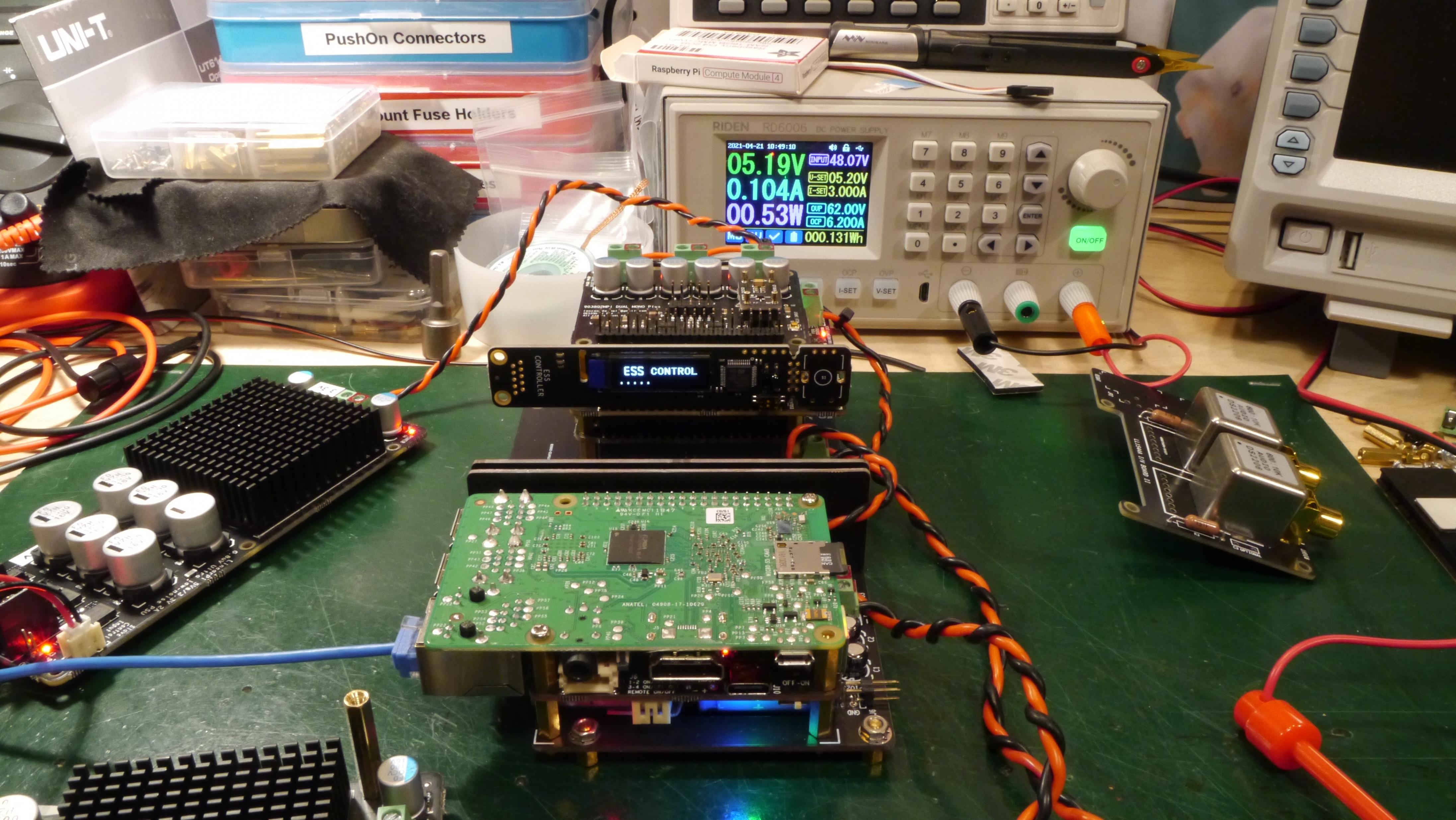

@Ian,
1. Make sure all of the three 3.3V power rails to the ES9038Q2M DAC are working correctly. Yes. All measure 3.3v. For now anyway, I'm using a single LinearPI strapped for 3.3V.
2. Make sure DAC XO is working, otherwise change to AYNC mode by connecting a u.fl cable to FifoPi MCLK. Whether SYNC mode or standard ASYNC mode, nothing.
3. Plug the ESS controller directly to the DAC GPIO to see if it can find the DAC. No, still nothing.
Question... How does the controller get powered? Through the non-isolated GPIO header? It appears to be able to be powered from the 5V Audio (J5) connector. Or, could it be powered directly from J3 on the FifoPI Q3? Which is preferred.
The FifoPi ppears to recognize signals from roon, as it locks on and different I2S and DSD LEDs light. But nothing on the DAC. I'm perplexed.

ESS controller takes power from the non-isolated GPIO.
The problem is that ESS controller did get I2C communication with DAC.
1. Check all pins of the GPIO of the controller
2. Check the soldering of all the power connecter on the DAC.
3. Use the DAC default XO mode, trying to make sure XO has 100MHz output.
Ian
Success! Sort of. 😉 It appears it was the RPi. I replaced that and things started coming together. I say started because, I only have it working with the BridgePi, not over the network yet.
I can't get anything to play or even get the FifoPi to 'lock on' when playing from the network. I've tried both Ropieee and roonBridge without success. When using Ropieee, what DAC overlay should I select? I even took the microSD card out of my main Ian stack (roonBridge), put into this new build and still the input on the controller doesn't change, or 'see' anything. And nothing plays. I read through the BridgePi docs and there doesn't appear to be any jumper that needs to be set when not using it. I believe the input is auto-switching? Ideas?
