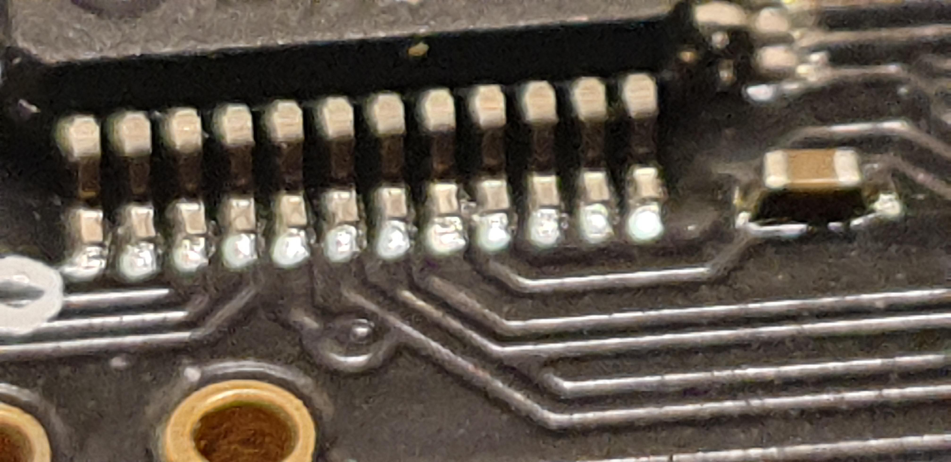

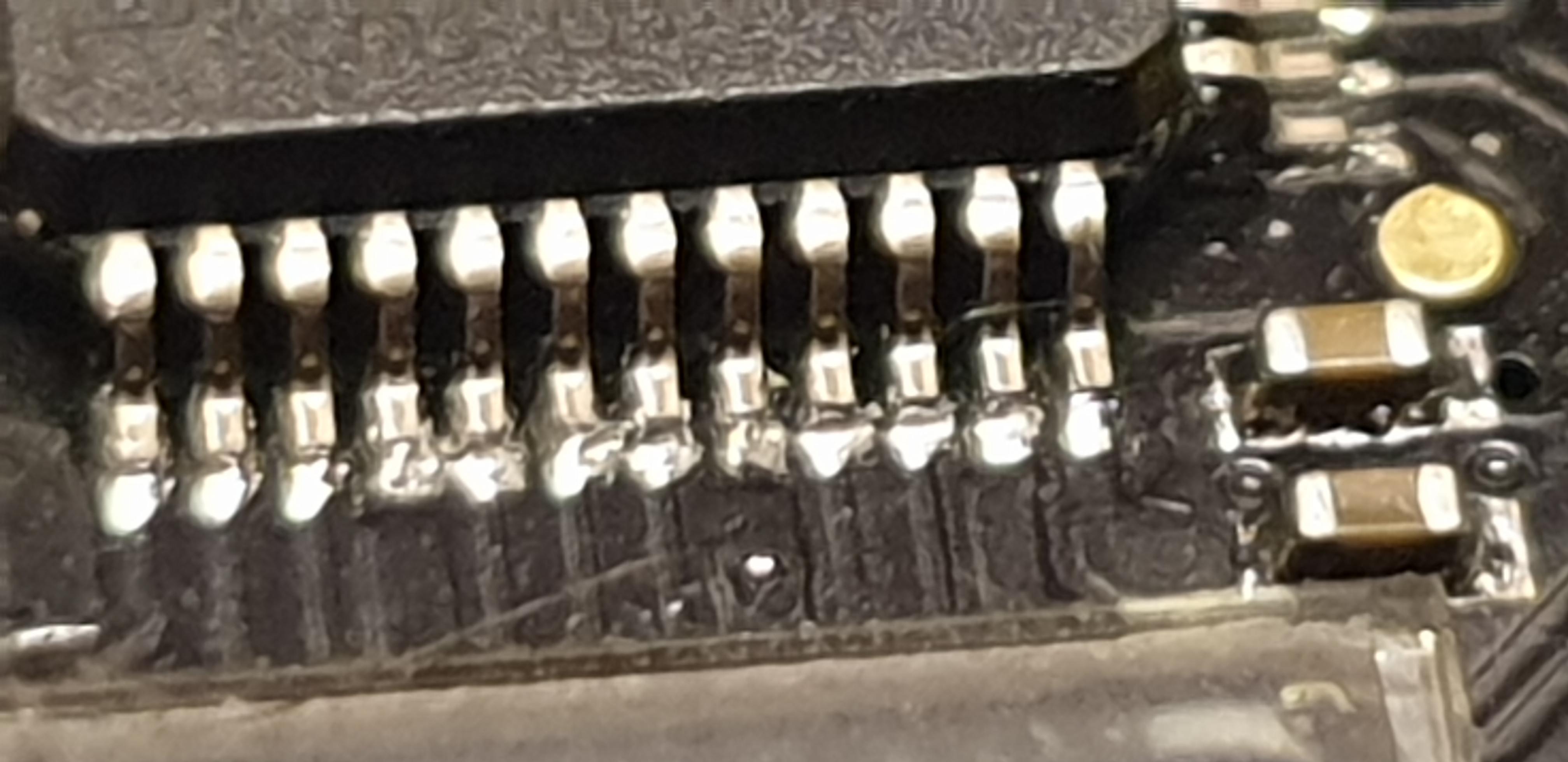

My controller issue seems to be down to the STM32 chip. It is getting really hot. I have tried to photograph the pins to see if any are bridged and one side does seem suspect. The soldering is much less clean than the other 3 sides. Way too small for me to re flow mind!
Photos shows one typical clean side and the one potential problem side.
Any thoughts?

To my eye, 2 pairs at least of these pins are bridged.
You no doubt know this, but FWIW, if you have some solder wick and some rosin it is easy to remove. Just put some rosin on the wick and on the pins.. lay the wick across the length of the pin strip... and slowly drag a hot iron across the wick. The solder will melt and wick up to the copper. You will leave behind well soldered pins without the excess on all the pins you touch with the hot wick.
I always struggle to heat the wick without using some solder. Will the rosin perform this 'heat bridging job.? And what temperature would you recommend.?
Thanks again.
Can do without toasting this thing! Its way smaller than the photos suggest naturally!
Sorry, I can't recommend a temp as I only have the cheepie plug in 25w kind of iron. For smaller items like this I'd use a smaller tip and if you can't melt solder through the wick within a few seconds, turn up the heat and try again. I would avoid leaving an insufficiently heated iron in place for a long time as that will heat things up on the board. You want sufficient heat to quickly heat the wick to solder melting temp and get it out. The rosin just helps the solder soak into the wick and ensure good flow around the pin/pcb junction. There are lots of YouTube videos explaining surface mount soldering using an iron. Some suggest installing a part like this with too much solder and then wick it away. You end up with a really nice joint that is just the two surfaces with a little solder between them as opposed to big heaps of solder on each pin.
