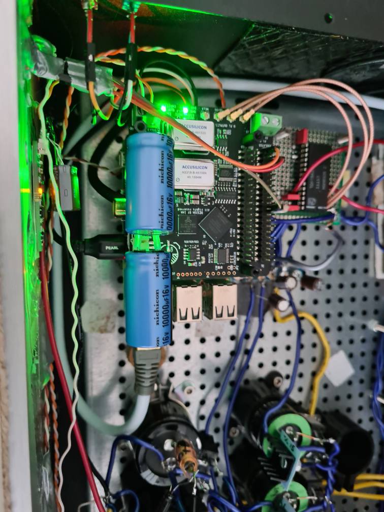

The idea came from post #1382 where Umacus took away all SMD caps and claimed it sounded much better.
I simply followed his bold modding and I was extremely pleased with the result.
I told my friend to do the same and he was surprised with the improvement.
I told my friend it would be even better to have a 10,000uF decoupling cap in place of SMD cap (Panasonic low esr type). He did and very happy with these two mods.
I now added the second cap there....
So much fun and surprise!

It's working great I must say. Nice & easy mod[emoji4] JPEG_20200907_183510_8003786364146374221.jpg

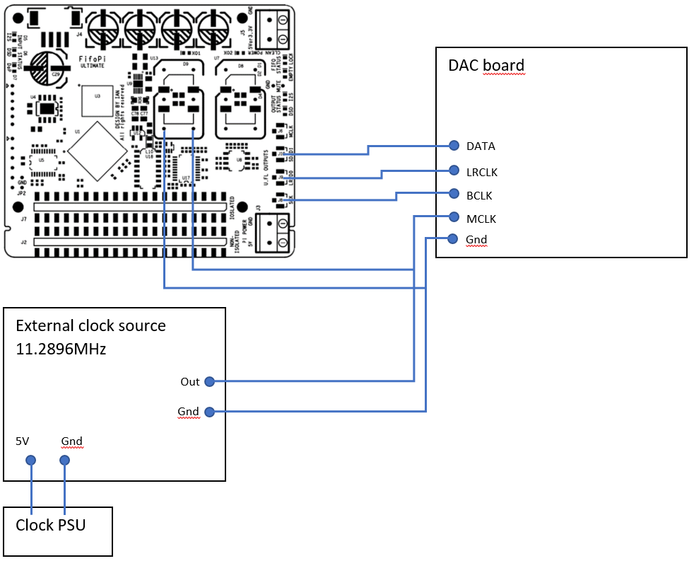

Hello Ian (or anyone who knows these things)
I attached a simple schematic that describes my intention of implementing an external clock source in place of the existing clock in Ian's FiFoPi board. The reason for this is that I have a DAC project using some older technology and only clock frequency of 11.2896MHz is supported and it will be used to play 16bit/44.1kHz material only.
The question is will this work with only one external clock source as shown in my schematic?
You can definitely run FIFOpi with one clock. That clock can be 11MHz.
I would think the preferred hookup would be to connect the clock to FIFOpi and run master clock from FIFOpi to your DAC. I suspect your way will also work, but I know that what I suggest works as that is how I run my system. In my case with 45MHz but same setup.
We know from all the jitter measurements from Ian and Andre that masterclock comes out of FIFOpi without any degradation, so there is no need to connect to both the DAC and FIFOpi.

Hi UMarcus,
I followed your mod of removing all 5 E-caps in your post #1382.
WOW! What a surprise!
The finest details resurface!
Realism emerges!
I did put a Panasonic low ESR cap Of 10,000uF in one of the empty cap spot and it won’t hurt.
I tried 1.5F supercap before but it rendered my RPI unbootable.
I supply Fifopi with LT3042 @ 3.3V using Ian’s pcb.
I also put in a Rubycon PMLCAP of 0.1uF for each clock.
I have both Accusilicon and NDK clocks for comparison.
After 100 hours of burn in time, I think I like Accusilicon a bit more.
Accusilicon is more in the front row while NDK is in the mid row.
I am very happy about this!
Thanks.
