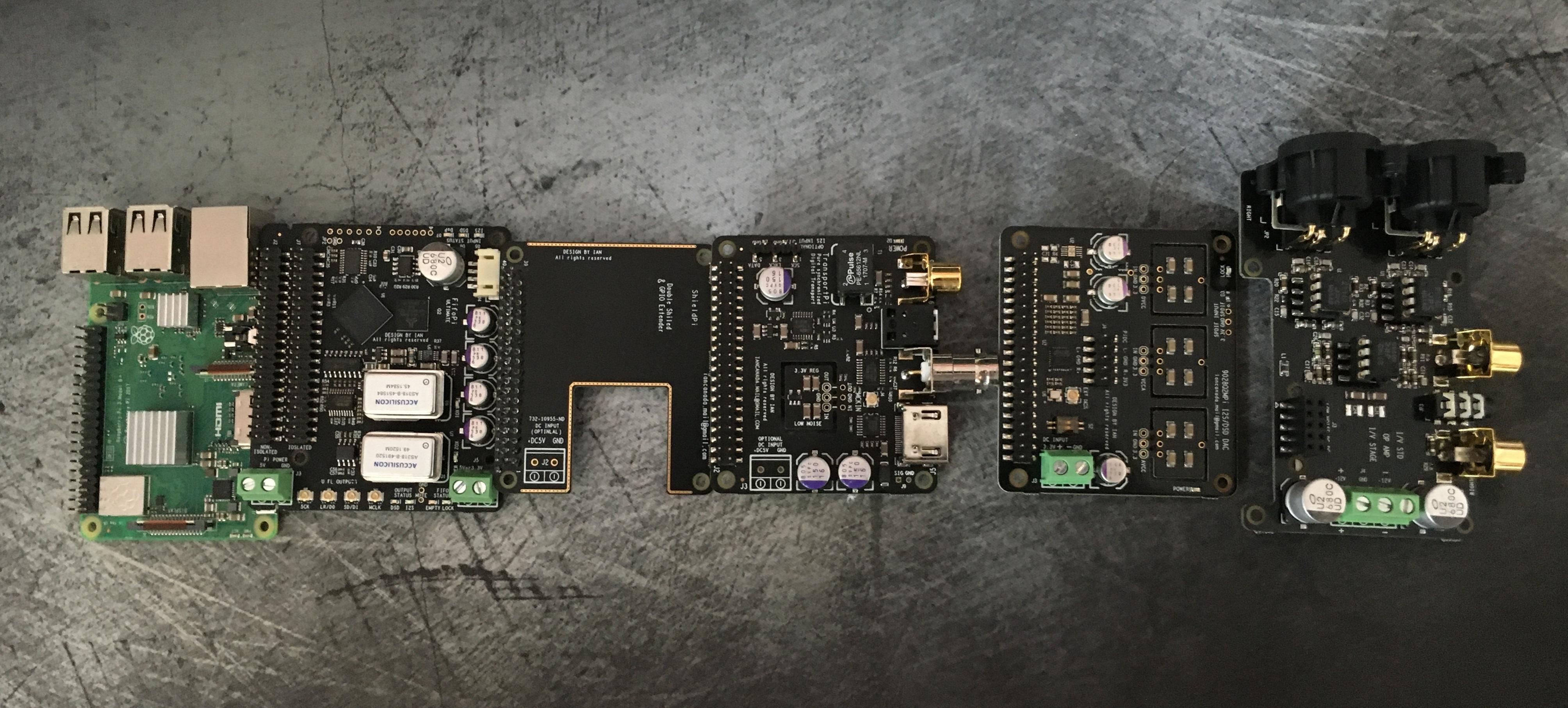

I have a couple of questions about this hardware and compatibility. I have the fifopi, the ess controller, ess9028 DAC, and the transformer output stage.
I have tried a couple different distributions for the Pi and I would like to use ropieee as I'm using Roon for my streaming. I setup ropieee and selected hifiberry dac+ in the list and I can get music out of the unit both with airplay and also with Roon. However I cannot adjust the volume with Roon, it appears to be fixed even though I said use device volume.
Can someone share with me their ropieee settings to allow the hardware volume control to be used through Roon?
I would also love to use the 7" touch screen, and I pulled the controller off the unisolated GPIO pins on the fifopi and plugged in the power and comm lines for the touch screen and I no longer get output from the DAC. Can a touch screen be used with the 9028 DAC board?
Can someone please share their ropieee setting to get the hardware volume control working? I'd appreciate it a lot.

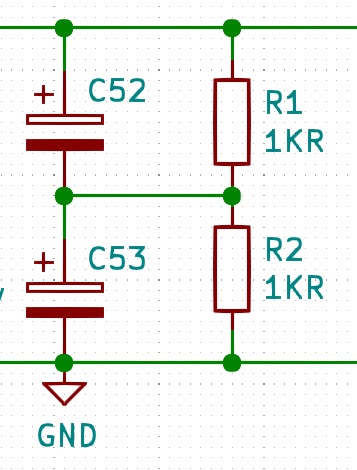

supercap: Maxcell BCAP0003 P270 S01
I put 2 in series with resistors.
Somehow with the supercap on FIFOPI, the RPI does not want to boot.
So finally I gave up.
Instead, I put a 10,000uF, 0.1uF and 0.01uF on FIFOPI.
Hope this helps.
