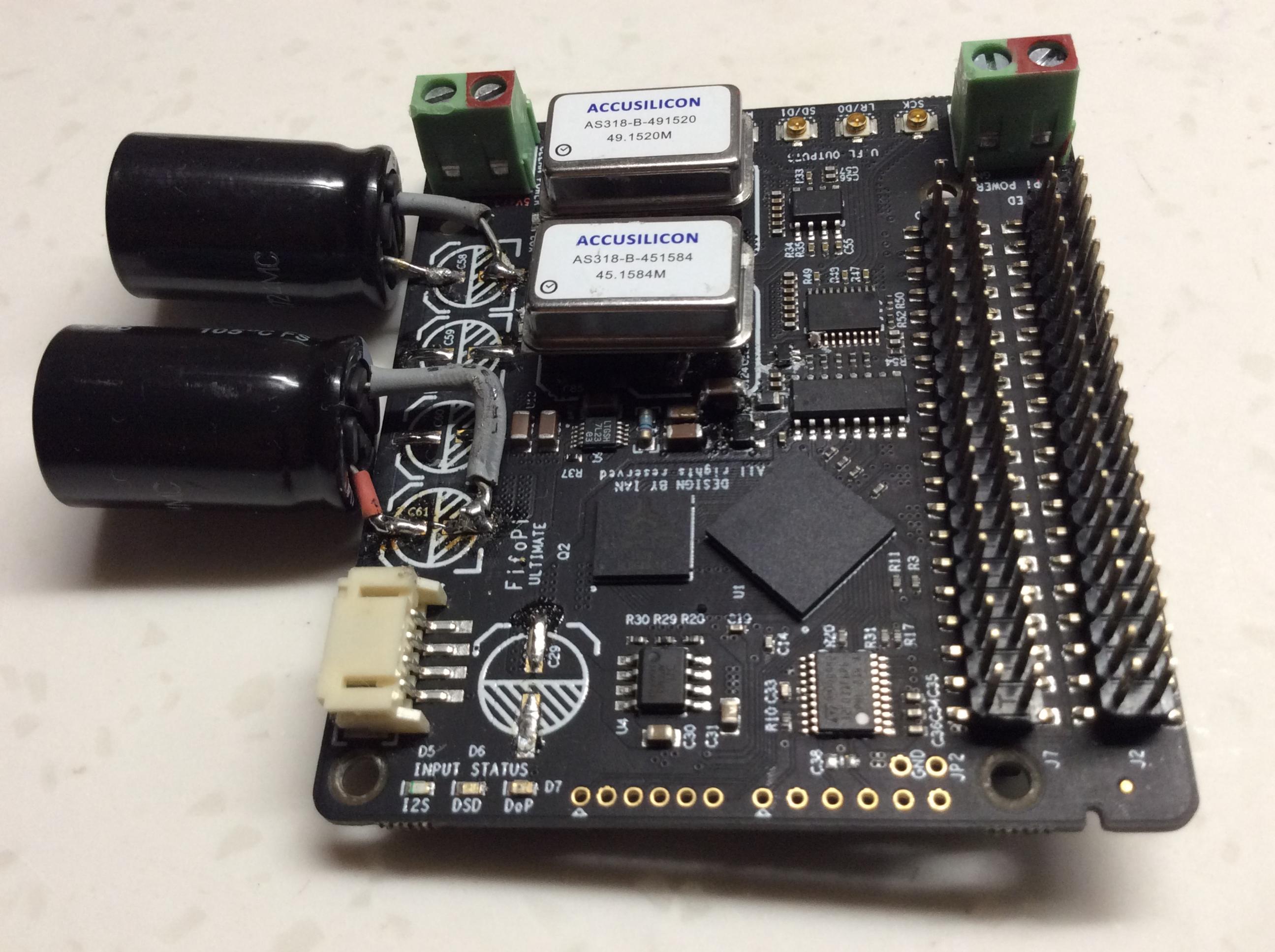

Which capacitors do you use?
Did you already tried this mod?
Thanks,
Ad.
Just 2pcs of 3F supercaps in series. Yes there was a big improvement.
However, It rendered my RPi Unbootable so I took them off.
Instead, I put a 10,000uF low ESR cap in; both my friend and I agree it Still makes a Very positive sonic improvement. ( and I have already taken away all SMD e-caps from Fifopi).
I will put a second 10K cap in later.
Thanks for the reply, do you have some pictures? [emoji4]
Why taking away the smd e-caps?
The idea came from post #1382 where Umacus took away all SMD caps and claimed it sounded much better.
I simply followed his bold modding and I was extremely pleased with the result.
I told my friend to do the same and he was surprised with the improvement.
I told my friend it would be even better to have a 10,000uF decoupling cap in place of SMD cap (Panasonic low esr type). He did and very happy with these two mods.
I now added the second cap there....
So much fun and surprise!
