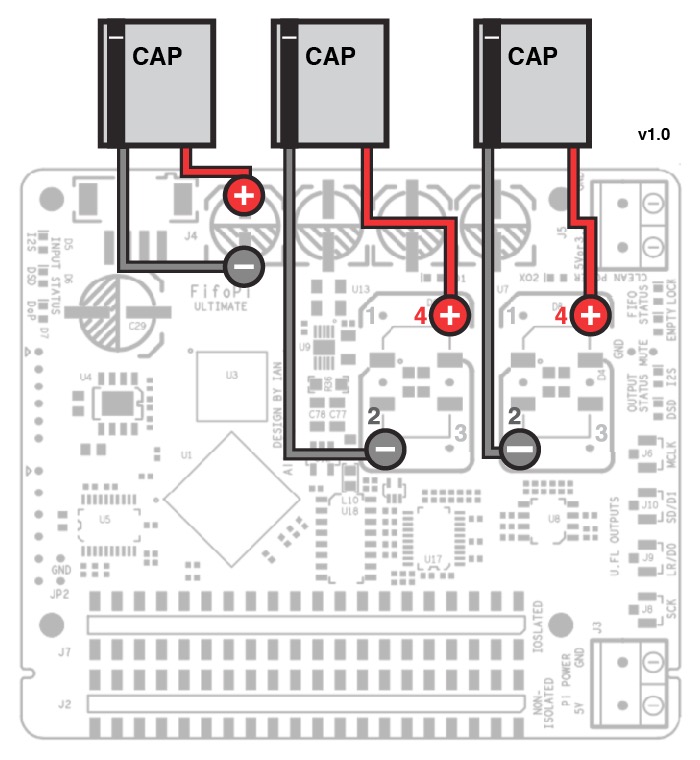

I will put some supercaps in.
Here is the diagram I like to confirm with you all.
Hope it is correct.

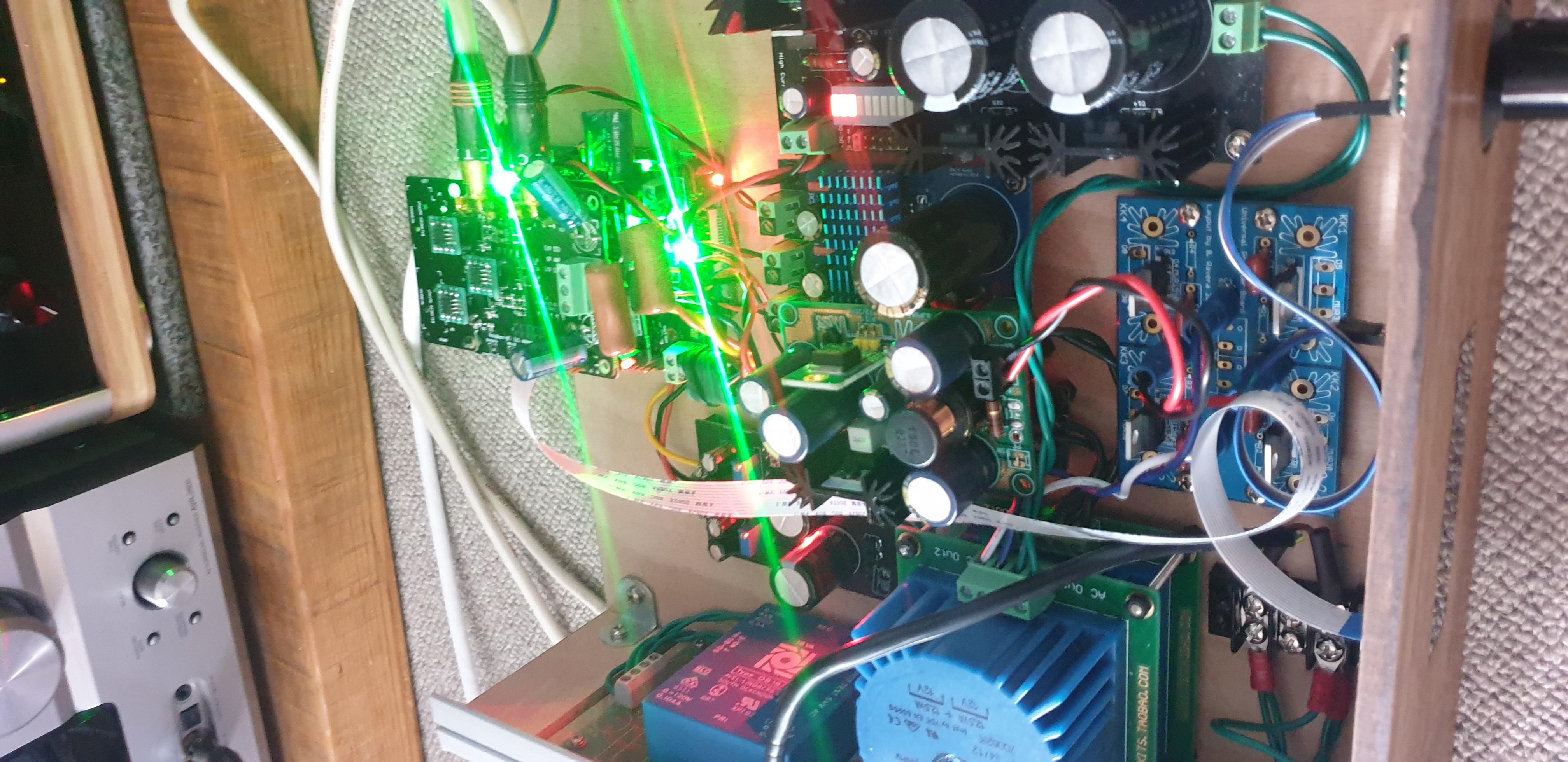

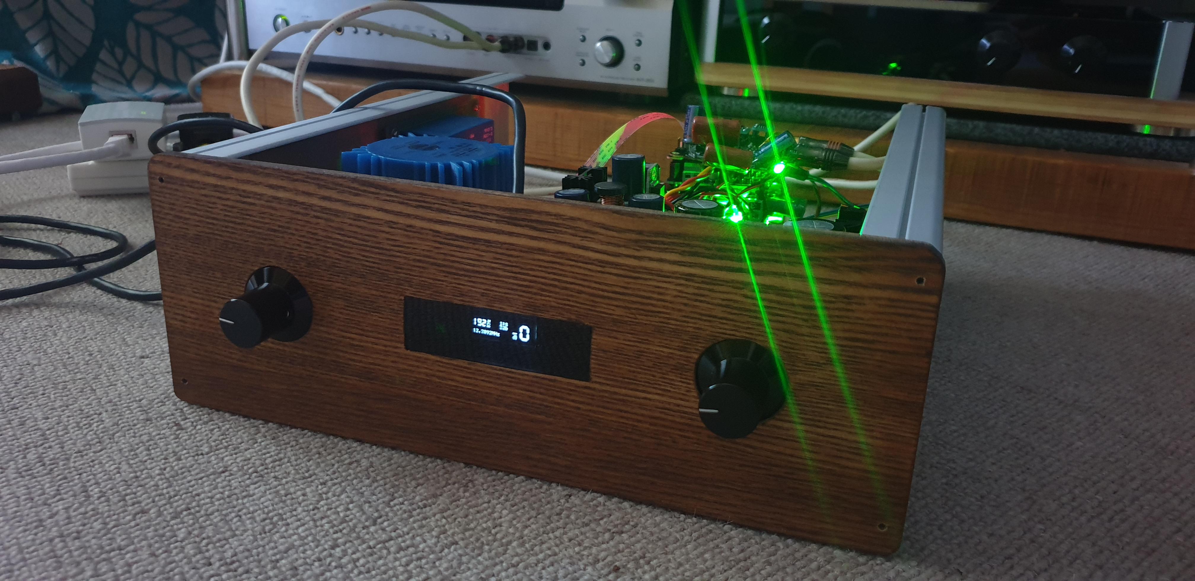

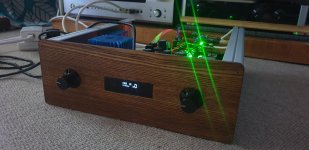

Thought I'd update with my build. Squeezing this all into a small chassis has been really testing.
Problem I will have is that I have bought some Maxwell UCs and also have a Salas Ubib for the IVSTD that I'd like to try but space is going to be a real issue. Dont really fancy another chassis as this has taken me forever, so we will see!

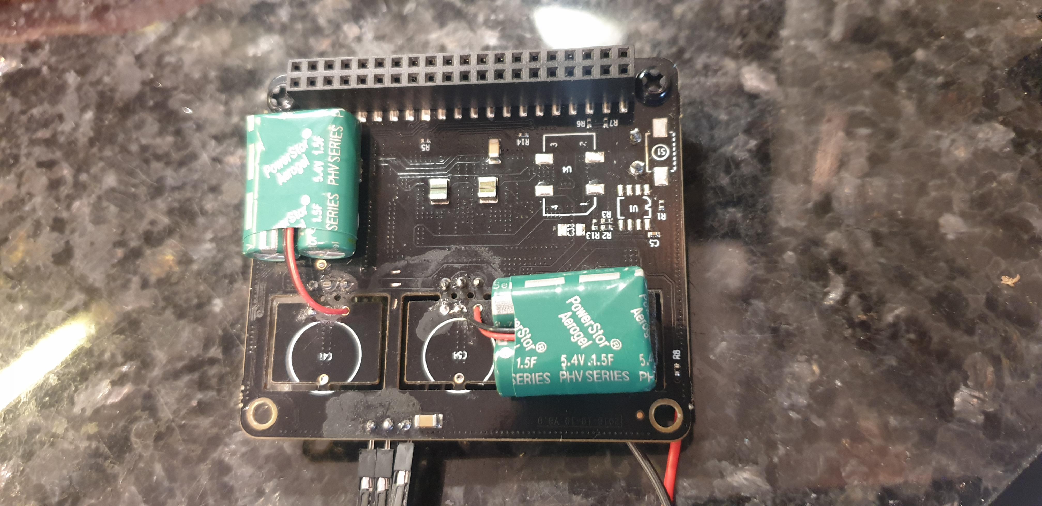

Working up, ReceiverPi is powered by it's own winding and rectification feeding one of XRKs CapMx CapMx boards at 5v.
Fifo ultimate has a 3v3 from Ebay LT1963 board. I added a 1.5F supercap across the 45Mhz Crystek.
5v from Salas L adapter on it's own 12v winding feeds through Fifo to power Rpi3b. 1.5F SC there too.
Dual mono dac has 3 separate rails. AVCC powered by a chinese psu with opamp based regulation...as Mikett reported on. This has it's own winding of 9v.
Rest of dac powered by the other LT1963 board. 1.5F caps on the DVCC and VCCA rails.
IV stage powered by it's own 18v trafo feeding the chinese opamp boards dual rail section.
I actually cut this board in 2 so the 3v3 AVCC section can remain whilst I try different psus on the IVSTD or indeed try a passive transformer output stage.
All the chassis is homemade from bits of repurposed wood/aluminium/acrylic.
Back panel yet to wire up but I got impatient last night and rigged up quickly directly to test if all was working. I just fed it into my AVR. Normally it will be into my Salas DCG3 and tpa3255. I managed to short the AVCC rail as seen by smoke from the 3v3 psu....sorted it out and all seems well...no damage.
Didnt get chance to listen properly. It has been out of the system being built for nearly 6 months now so I am looking forward to hearing it......only thing now I have to go through it all again to build my brother one!

I have just got myself a RPi3 and I am really impressed. I did a headless setup, flashing Raspbian and Volumio to a 32gb sD card and sticking it in the the Pi. I also plugged in a sD card reader with a 128gb of music and a Khadas Tone Card DAC. Everything just worked including airplay from my Mac Mini which I hadn’t even planned on! I have the Volumio app which is only as good as the web based control. My amp is a 3eAUDIO TPA3255 that I put together myself. I am getting an Analog to Digital converter with a coax out which I will use to connect my TV to the DAC. The DAC will switch to coax if it has a signal and I plan to rebuild my amp without a volume or an input selector switch. I will also be putting a 5vdc psu, RPi3, and the Analog to Digital Converter inside the amp The DAC is already inside the amp. I will also need to change the RCA sockets to female to female on the back of the amp for the TV input and make a new wooden face with just a power switch. I can’t believe how it all worked and I did not need plug in a keyboard or monitor to configure anything.
@jimk04 your amp looks great and I’m sorry you had a short. Is that oak? I have a Zebrano face on my amp at the moment but my new one will be oak.
Joined 2018

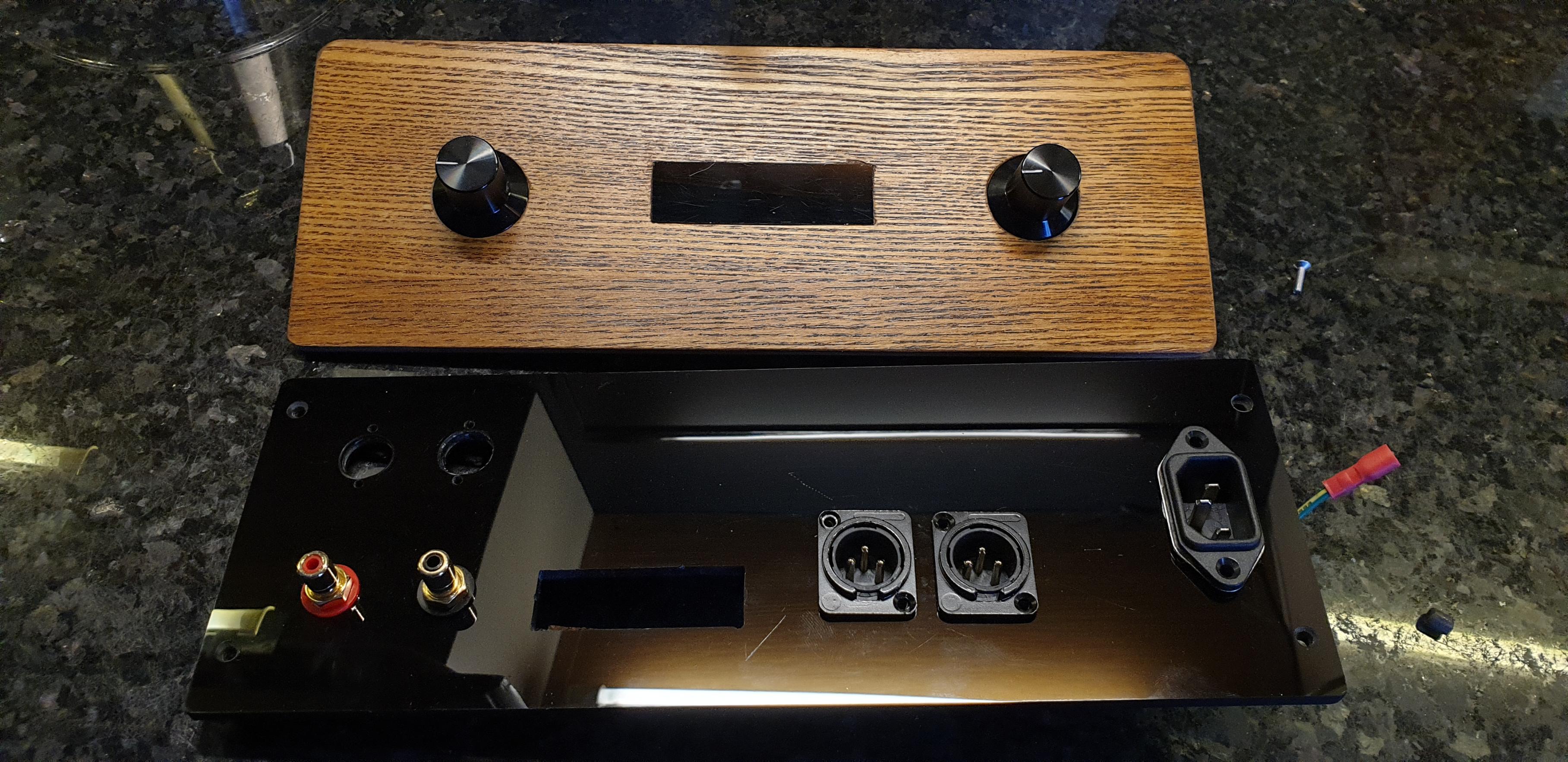

Yes it is oak...well oak veneers MDF. They're place mats from Poundstretcher.! 4 for £5.! Veneered on both sides. I cut one down lengthways. Originally bought as possible small speaker baffles.
I managed the short yet again. It is the AVCC connections shorting on the clocks. I had to space the dac up a bit and not allow it to sit right down onto the gpio socket. A bit of a nuisance.
Second time I did it the little 3v3 AVCC board got so hot the SMD transistor 'floated ' away....so it got pretty warm to melt the solder! I put it back into place and all is well.....tough little psu!

I have ordered these output transformers from Aliexpress. The pin outs and lead spacing are compatible with Ian's trafo output pcb according to my measurements. I have been interested to try a passive IV and it will save me space on a psu trafo and pcb....making way for Maxwells possibly!

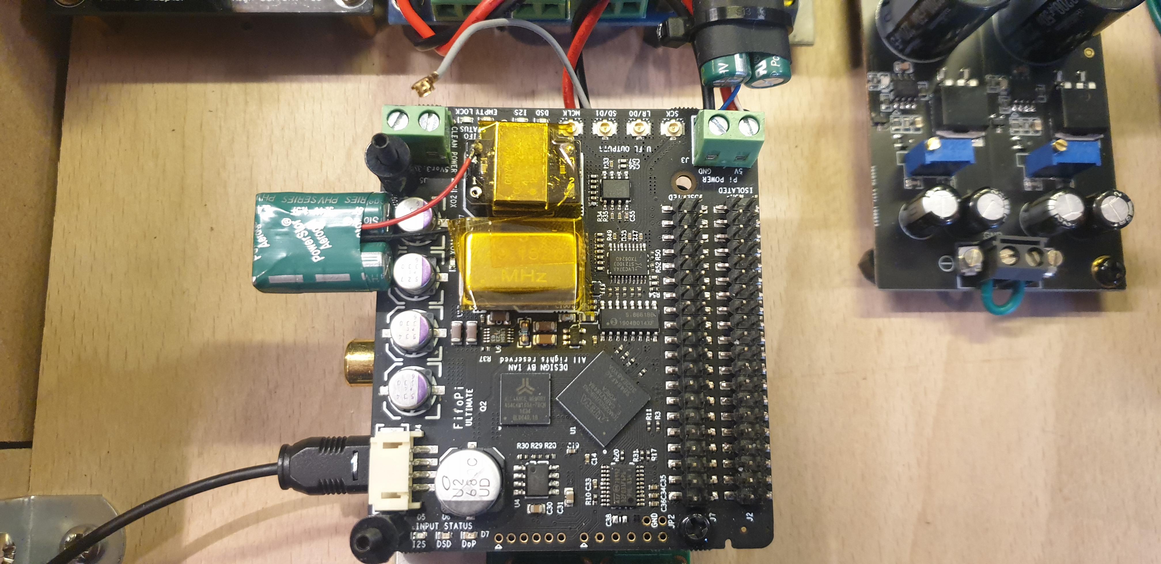

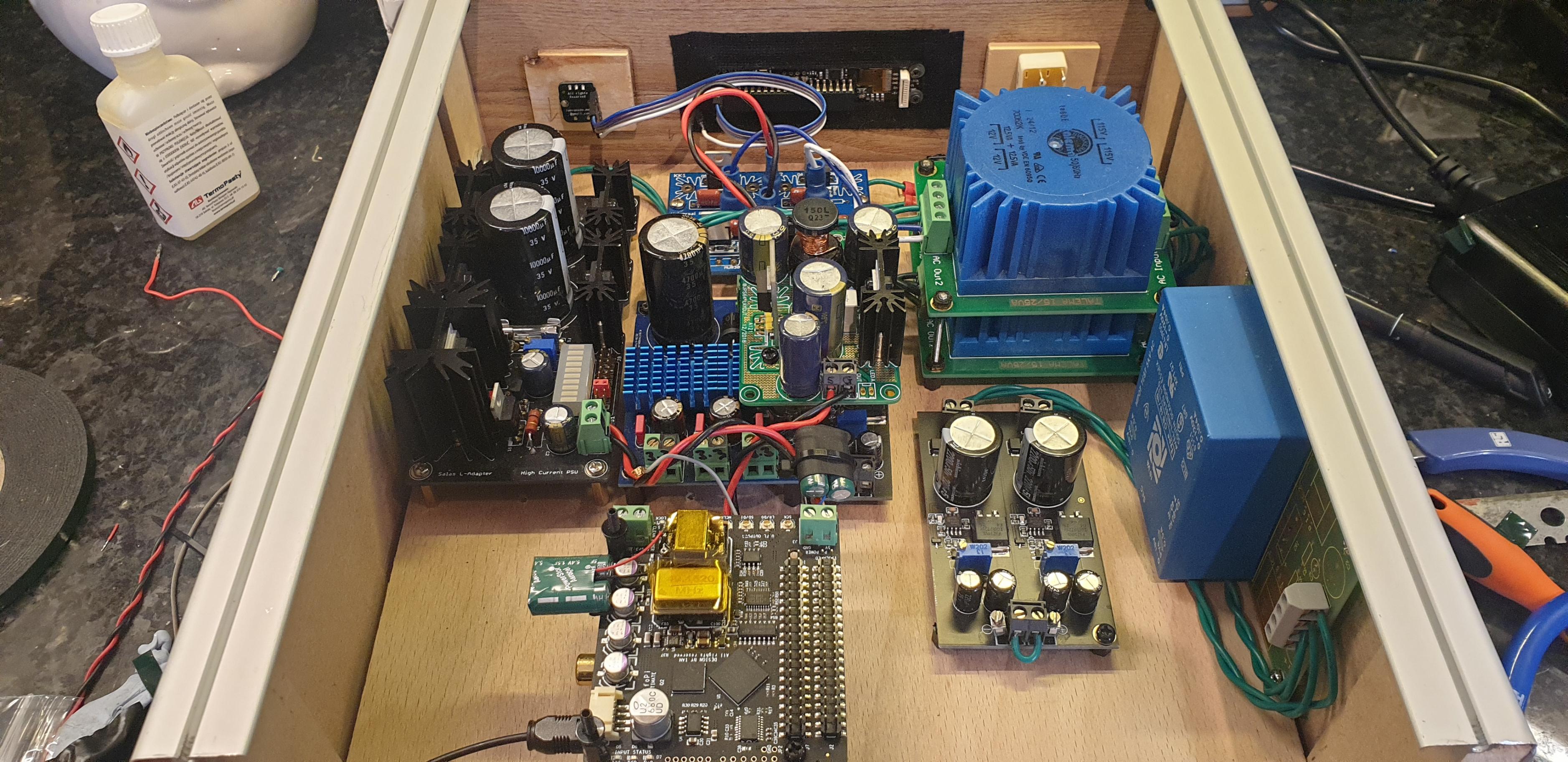

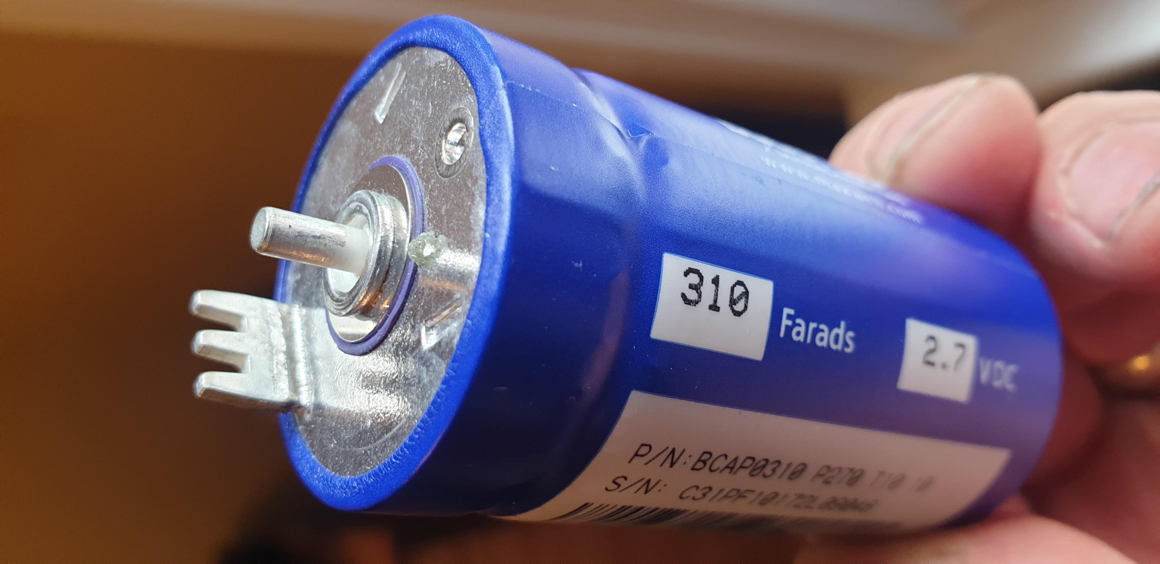

Interested to see if I can implement some supercaps to some rails. I wasn't going to 'go there's but as you know curiosity of what may be gets the better....and then I found some Maxwells at a good price....the rest is history.!
I bought 10 of these for 50gbp....see how big sparks I can make!
And see how the output stage trafos sound
