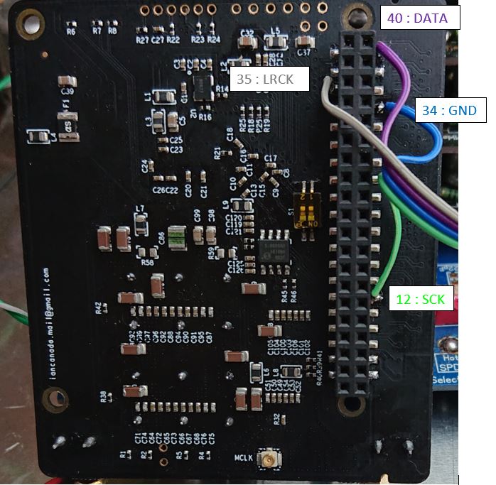

I've spent the weekend splitting the DAC from the FIFO with a view to fitting into a 2U case.
I wired it up for i2S as per this image plus the MCLK coax.
This did not work, but using a 40 pin ribbon cable did. There must be more connections required than just DATA, SCK, LRCK + GND. ??
I'm using an Allo USBridge Sig rather than a Pi though I suspect this makes no difference.
May be its need to connect the control interface SDA/SCL too, in the FifoPi Manual they also remarked in the 40pin Table at Pin 3&4.
Yes that does it, though do not connect to pin 4 this is 5.0V DC !!!.
There is an error in the manual it should be pins 3+5 for I2C.
Damn, hope you realized it before power up.

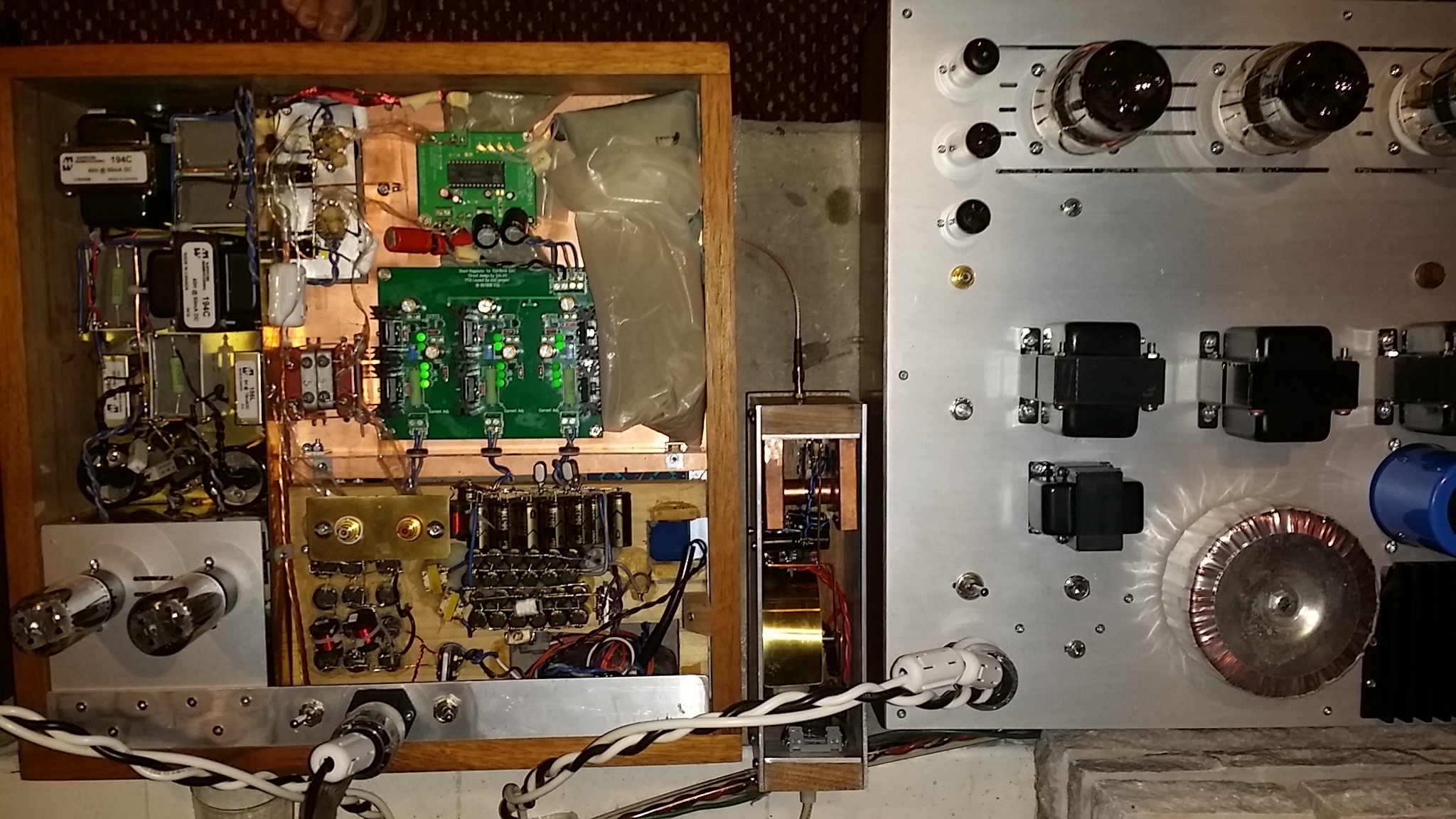

I know your frustration. Every case is unique. In my case I built streamer, AVC, and amps to work together. So streamer / DAC has RCA exiting mid box on top, so signal does not return to dirty power part of box. Then up to AVC box which sit on top of streamer. Signal then goes out the side to input of amp which fans out left and right towards speakers. So signal goes in the left side of right channel amp and speaker cable attaches on right side of amp to right speaker. Everything follows a path. Will only work in my system in my room but it works for me. Far from perfect but here is a pic with top off the DAC/streamer. Imagine a box with AVC linestage on top at the front of streamer. RCA signal goes in the back of that box then out to the amps on each side. Cables are 3" into the AVC and 12" out to each amp. Pretty compact. Keeping in 3D all the digital Rpi stuff is under the DAC separated by copper plate at front portion of streamer.
