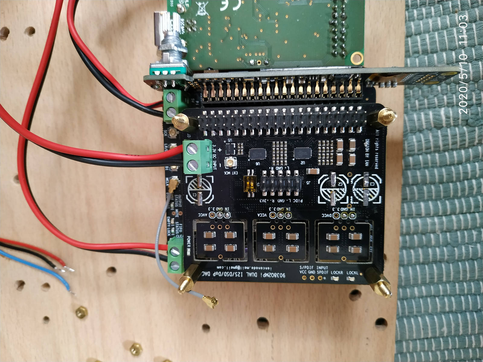

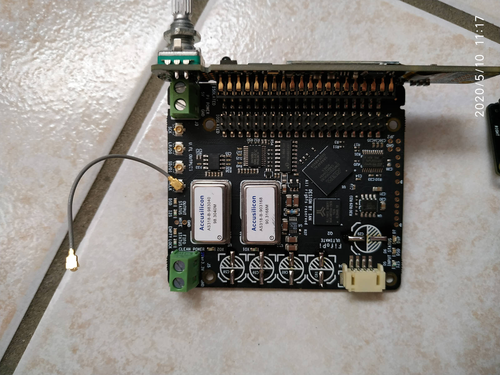

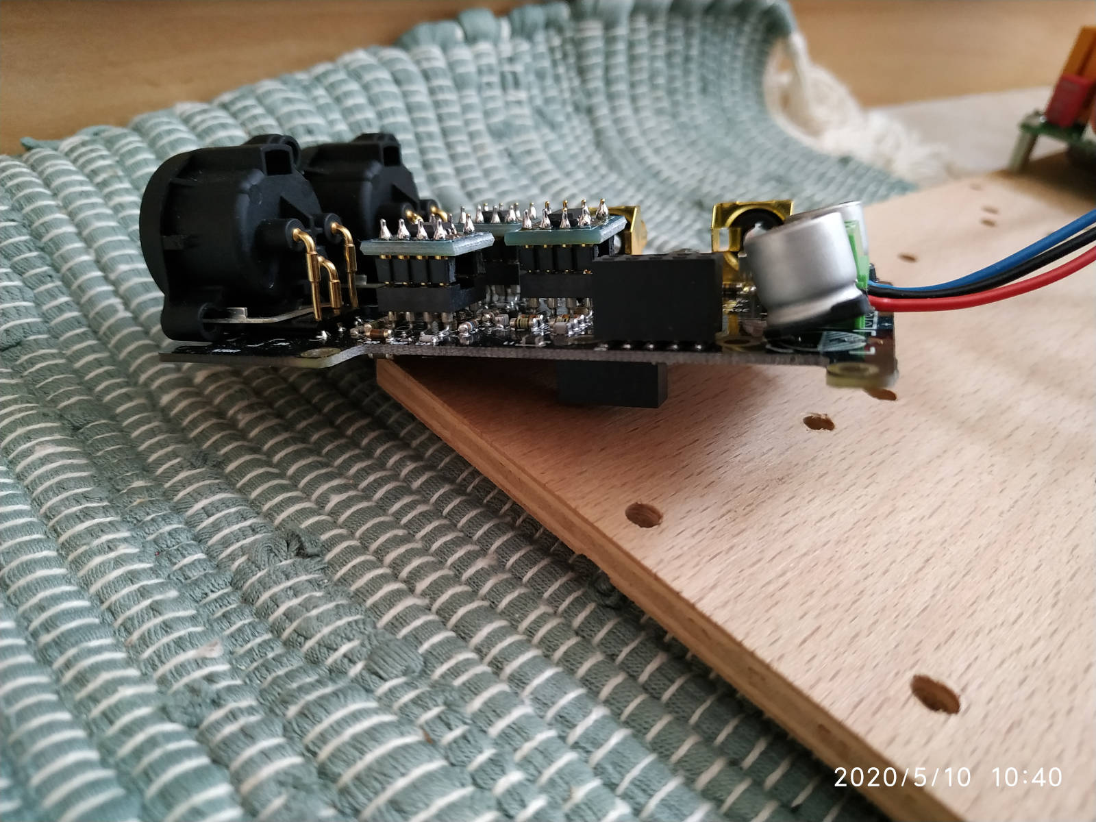

I tried some mods and I must realize that Ian did a great Job as nothing really improve, except usual stuff as Clock, OPAmps etc.
But one thing I would highly recommend is to remove all electrolyte capacitors. May this sounds a little bit strange, as it is somehow a 'good etiquette' to have this stabilization capacitors in well designed circuits. But this capacitors mellow down the sound and occupy your good power source 🙂
I really high recommend this, the music will be freed, sweet and more detailed !
May start with the caps on the I/V board as they are easy to remove or lift just on side of them.
Give it a try 🙂

So you haven't replaced them with anything?
I replaced the power rail caps on the IVSTD as I will be using a 15v supply for the opamps and I thought the 16v SMD caps maybe a little marginal. I will be fitting 1000uf 25V Panasonic and may bypass with a film cap
Thats a good one...I assume you use Ians battery supply ? I will follow your approach.

I'm using Regulators from DiyInHk, no battery, may with battery the Result of removing the Caps are different. I would suggest to start with the I/V Board to get an Idea. In case of transformer board I would start with the DAC Board, there are 3 Caps for each Rail. May be start with the Analog Part of the Dac Board so lift only one of these three caps.

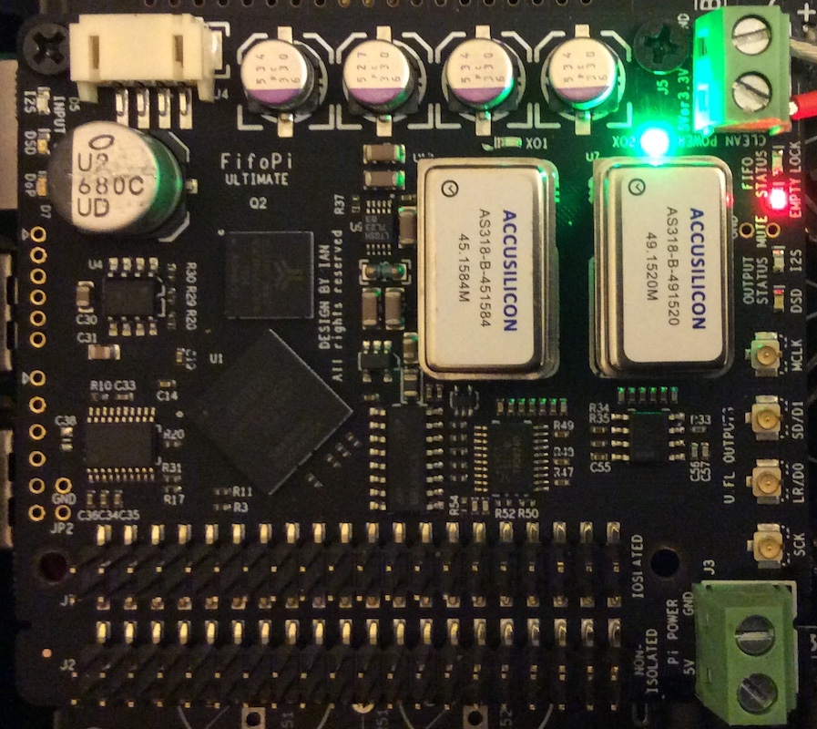

Hi everyone,
I got the Accusilicon clocks today.
I put them in and the X01 led flashes once then off. X02 led stays on. (see jpg)
Is it normal?
I then turned off the whole thing and put the original stock clocks back in; same thing: X01 LED flashes once then off and X02 LED stays on.
I remember the stock clocks had both leds on all the time.
It plays back music as usual.
Any idea?
How to tell it is using the new clocks correctly?

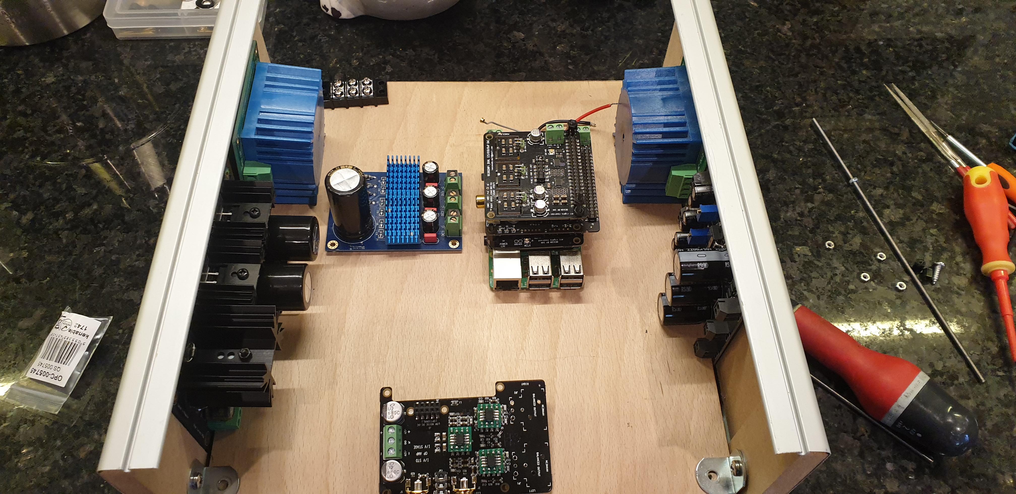

I've spent the weekend splitting the DAC from the FIFO with a view to fitting into a 2U case.
I wired it up for i2S as per this image plus the MCLK coax.
This did not work, but using a 40 pin ribbon cable did. There must be more connections required than just DATA, SCK, LRCK + GND. ??
I'm using an Allo USBridge Sig rather than a Pi though I suspect this makes no difference.
