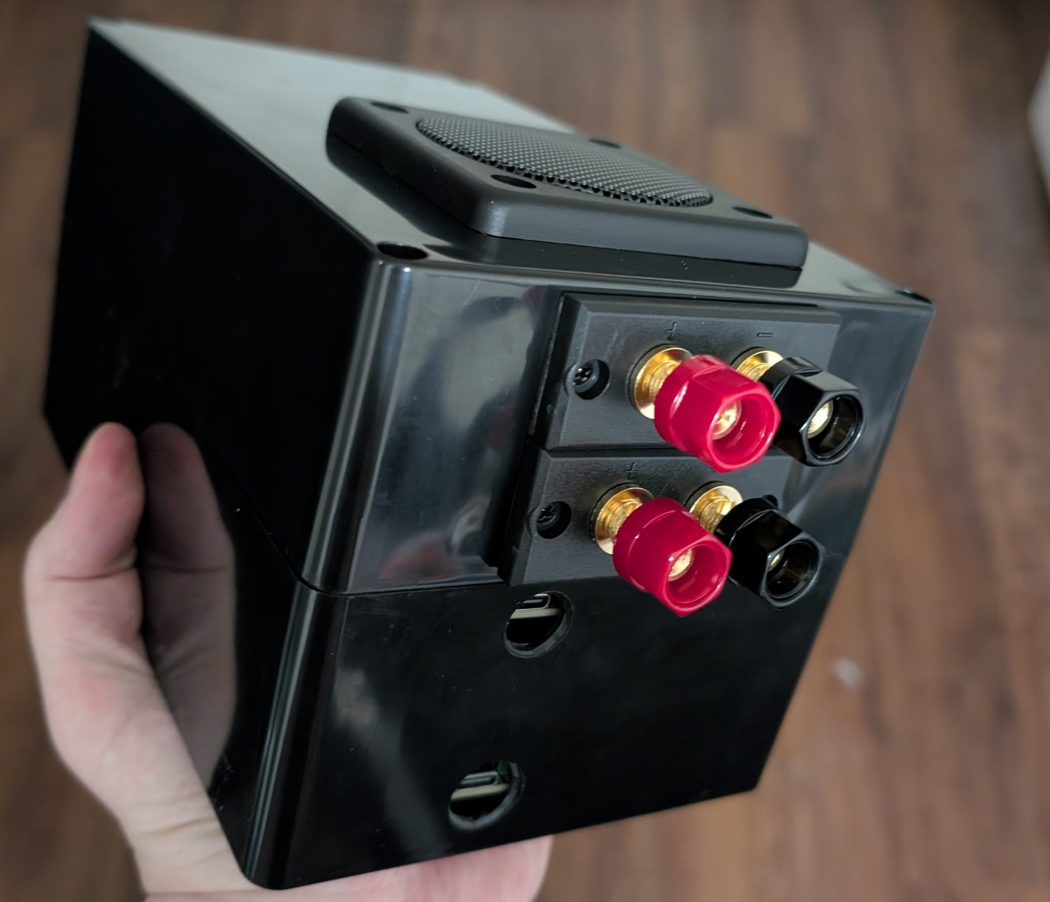

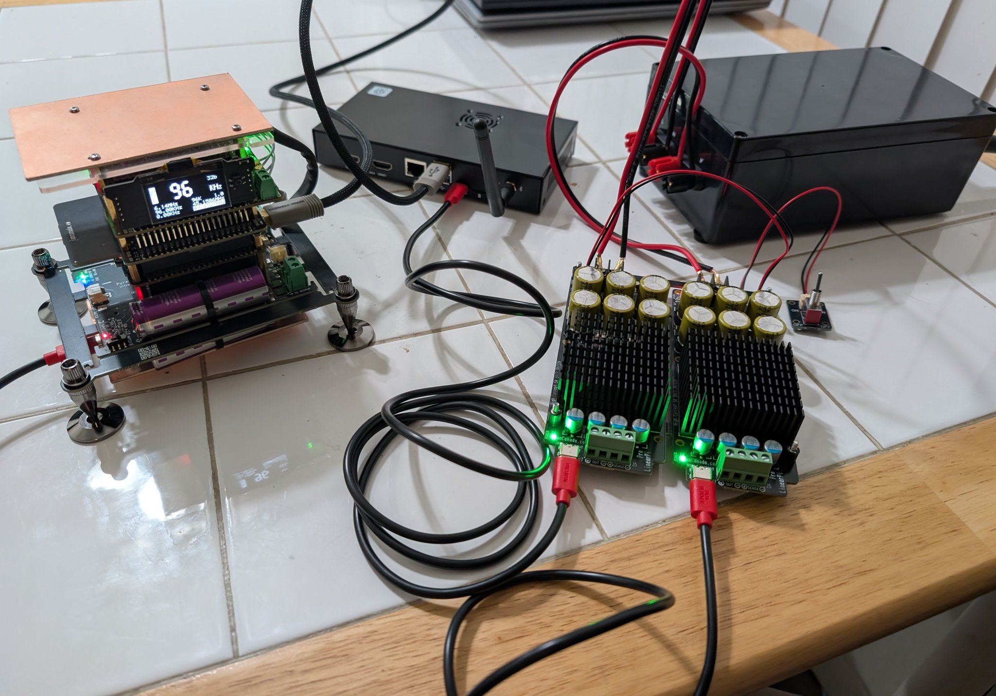

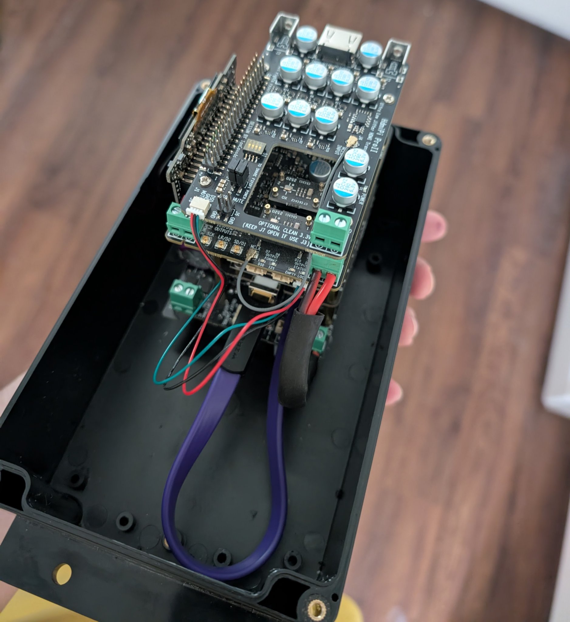

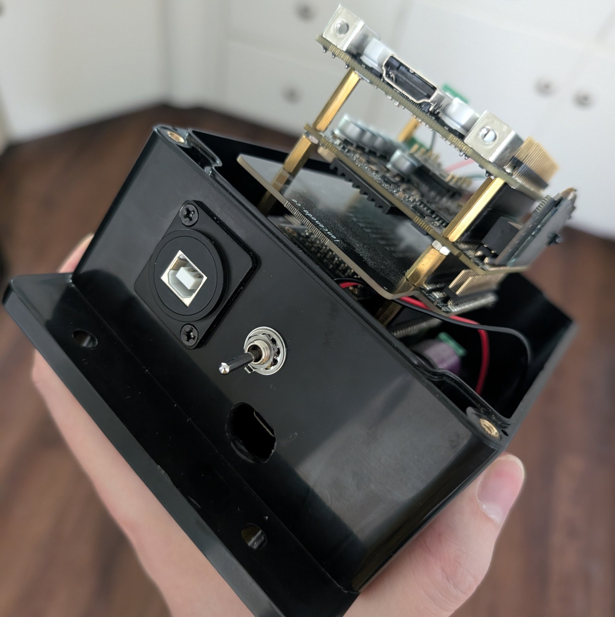

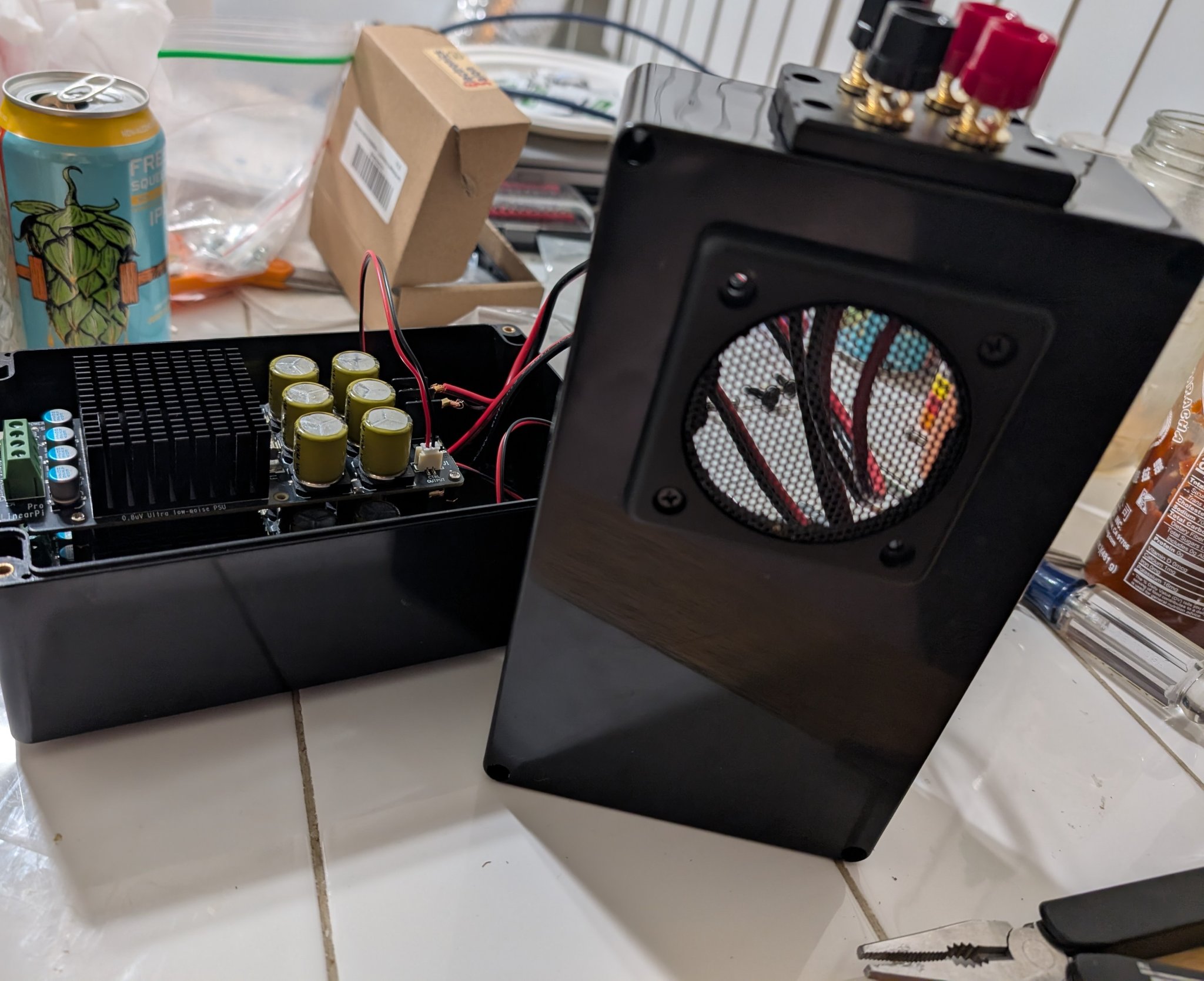

The complete system. The transformer in a box with the dual linear pi pro's have replaced an Allo Shanti power supply, and it seems like quite an improvement sonically so far. Using data blocker usb c cables (only 3 pins connected and no electronics) to the streamer and DDC.
which enclosure are you using?
The transformer is in an ABS plastic enclosure with a power inlet added on one side and speaker posts for the output on the other. Pretty cheap:
https://www.amazon.com/gp/aw/d/B07D23BF7Y
I bought the taller version of that enclosure (not pictured) for the linearPi pro's, which I will stack inside.
The raspberry pi compute module 5 is mounted on the official I/O board in the official case that goes with it.
How did you connect the ground?
I didn't 🙂
I've been thinking about adding a grounding post to the transformer enclosure and switching to a grounded inlet, but it honestly sounds about as good as I could've ever imagined right now, so maybe some day a long way in the future I'll try.
DC circuits are weird to me. I'm no electronics engineer so I do get confused by the way the term "ground" gets used. Rather than the safety ground sometimes it refers to something else.

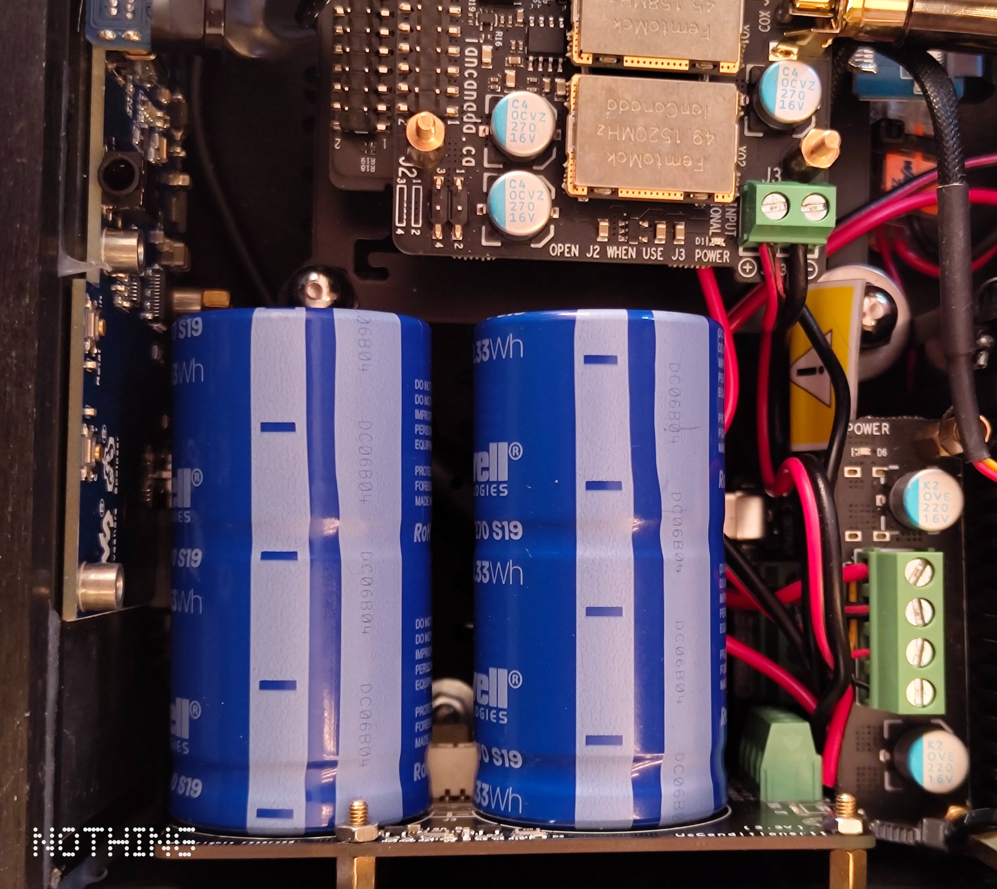

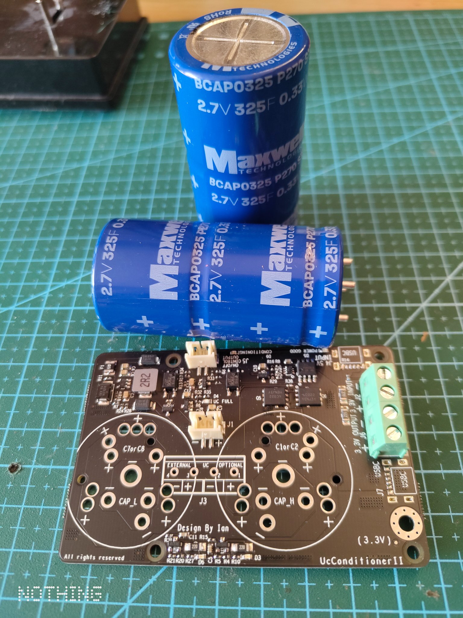

Friends, the super capacitors and 3.3V control board from IAN CANADA have arrived.
I have to honestly say that this is a real upgrade for the audio chain!
Powering the sound card and Isolator III.
https://www.audiophonics.fr/en/powe...-capacitor-conditioner-board-33v-p-17924.html
https://www.audiophonics.fr/en/ultracapacitors/maxwell-supercapacitor-27v-325f-p-14602.html

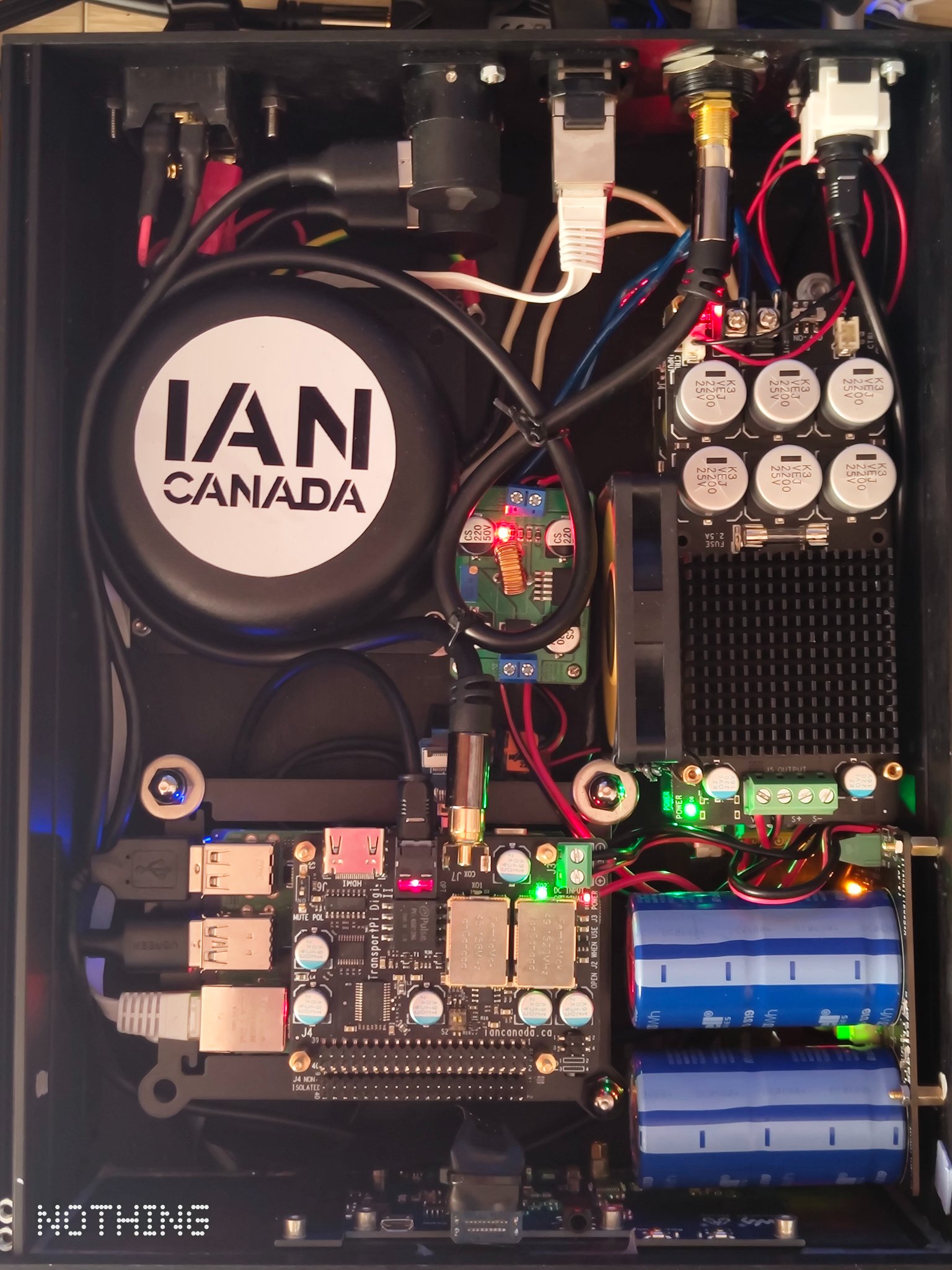

Is that IAN Canada 'logo' on your xformer cover, your creation, or something Ian has provided? I like it. 🙂

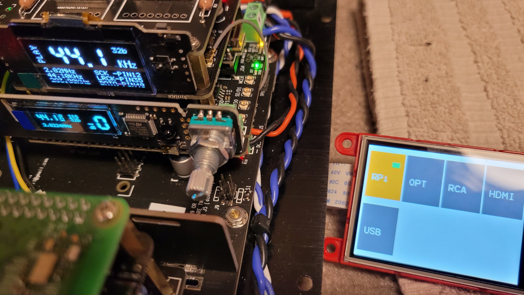

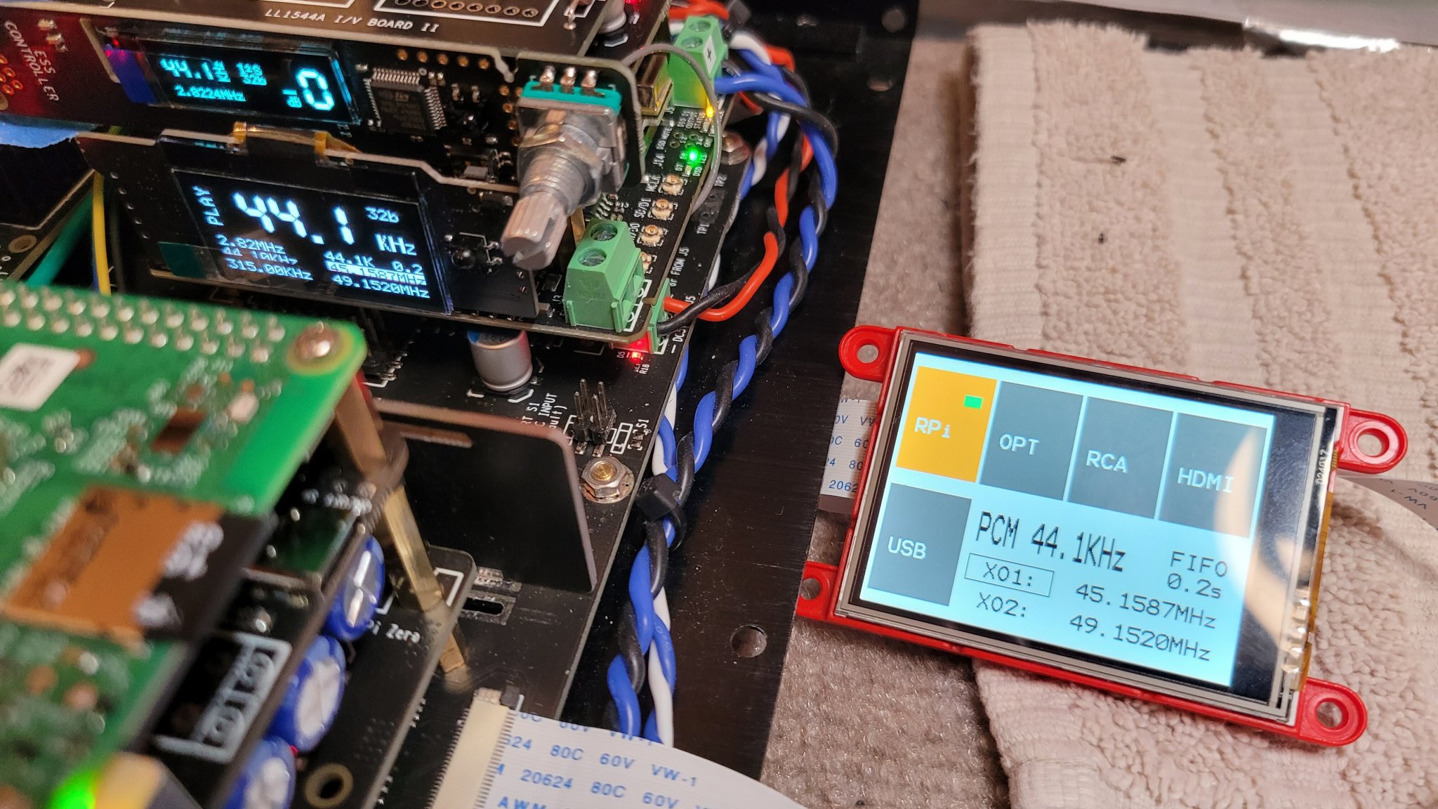

I'm finally getting some of my DAC projects ready to leave my bench but still have some lingering questions... My primary goal is to get all 3 displays working together properly. Those would be the ESS Controller, MonitorPi and the 4D Systems LCD panel. My core audio stack includes the following Ian RPi HATs;
StationPi Pro > FifoPi Q7 > Dual Mono DAC > Transformer Output to RCA, and ancillary displays as mentioned above.
I will admit upfront that some of the issues may be unwittingly user introduced. My apologizes if this information may have been covered elsewhere in the forum/thread.
With all of my testing and retesting, the only way to get music - with displays attached - is with configuration #2 as noted below;
The selection LCD is optional, and when attached as shown, it does display the FiFo data in the lower right-hand of the screen.
#1 config (no music)
o Original ESS controller attached to the non-isolated GPIO header on the Q7.
o MonitorPi attached to DAC isolated GPIO header.
o 2.4" LCD display attached to the StationPi Pro connector.
#2 config (music!)
If I swap the ESS controller display with the MPi all seems to be well;
o Original ESS controller attached to the isolated DAC GPIO header.
o MonitorPi attached to Q7 non-isolated GPIO header.
The only conclusion I can draw is that the ESS controller must be attached to the DAC isolated GPIO header for all 3 displays to work correctly and output music. In configuration #2 both seem to be controlling the DAC though. Not sure that's a problem. Is this the way it was intended?
It was my understanding, that the MonitorPi is (should be) capable of playing music without the ESS controller attached as well? But that doesn't seem to be the case. The MPi displays information as if it was playing a track, but I get no sound. The optional 4D LCD also displays the bitrate and the crystal frequency being used.
With both displays needing to be attached there is a lot of unnecessary redundancy in the information displayed. Maybe this interaction of the 2 displays will be improved upon with the next generation of hardware/software. In addition, I know of no way to turn off the ESS display to help with burn-out with long term usage.
Has anyone else - using similar setup with Ian's great products - have a better understanding of my findings and if 'that's just the way it works'. Or, is there something I've overlooked that would make my working configuration #2 less redundant. Otherwise, I love the modularity of Ian's products, and well... the music speaks itself!
One other thing... Is the Apple remote suppose to control the MonitorPi? I get nothing when used with it.
Config #1 - Music, but no LCD display.
Config #2 - Music and all displays work.
