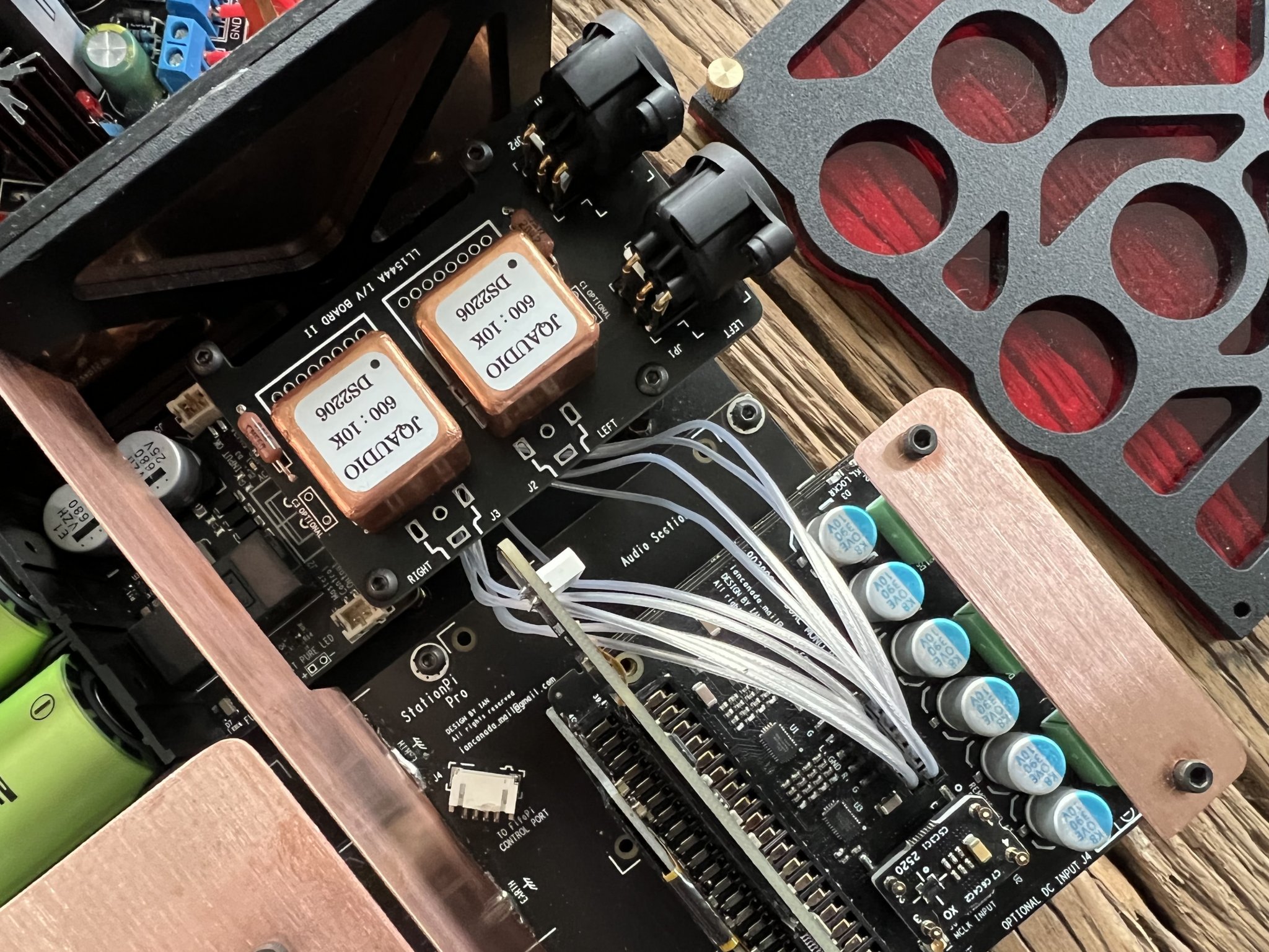

@iancanada Hi Ian; I have another question...I would like to connect the TRANSFORMER I/V PCB Kit V2 to the Dual Mono ES9038Q2M DAC HAT, with these cables I2S 2.54mm Silver Plated 15cm, can I also solder them on top of the board ?

At the moment I have simply bridged the pins with the cables, is that OK?
For the cinch outputs, do i have to solder 3x ground when i solder a cable without the socket?
@Aiello
You can solder the wires to the PCB without a problem. Please just make sure all wires will be soldered to the correct pads.
Bridge is also OK. More ground wires would be better. At least each transformer has independent GND.
Ian

I will not solder the bridge and leave it plugged in, that will be easier....that with the ground, does that refer to the cinch ?, so the 3 ground connection is better do you mean per channel?

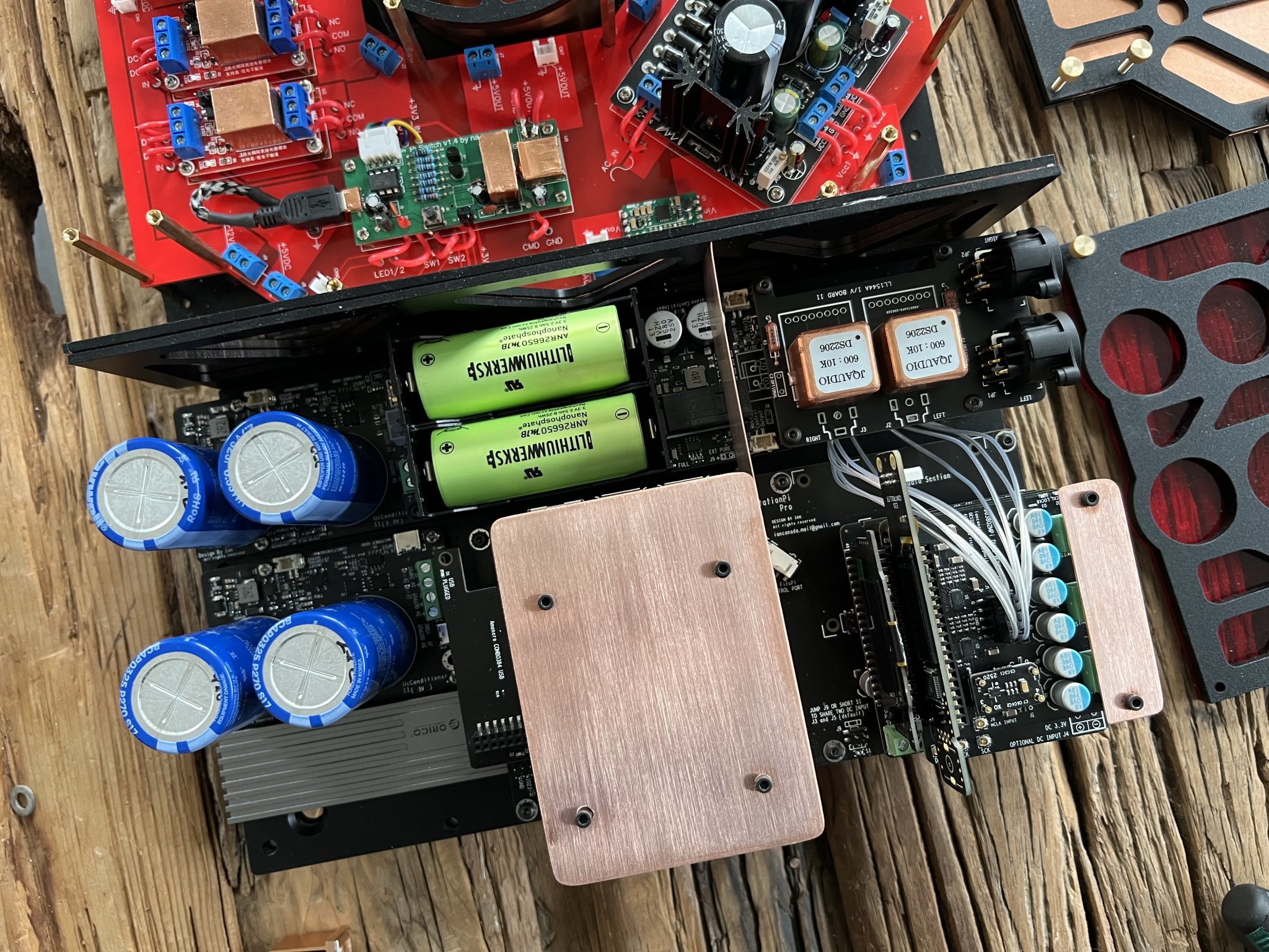

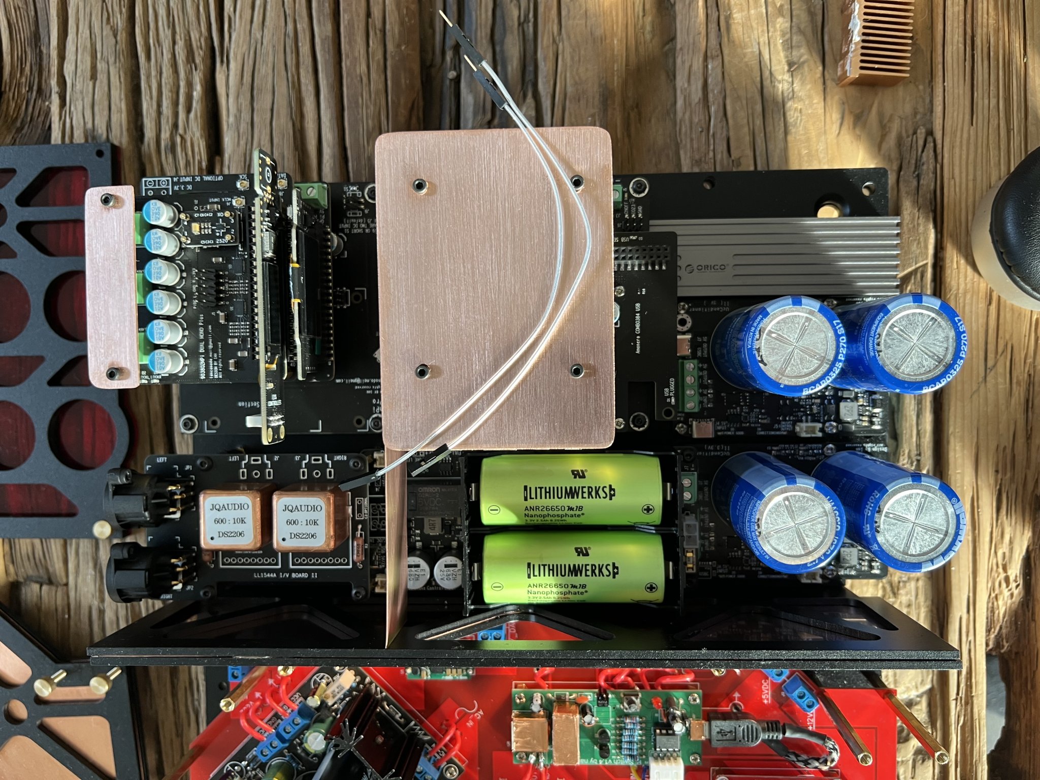

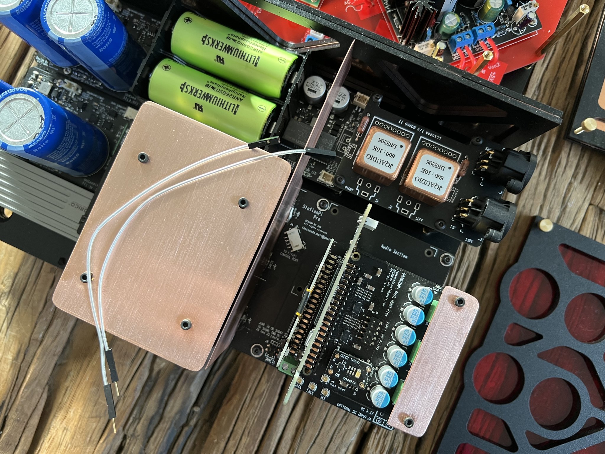

I’ve made some progress with my streamer project and have now finished the side panels with copper. There is also an air inlet and outlet grille on the side. The upper cover is made of acrylic glass, which I lacquered at the edge, and the inner life is engraved on the pane
The cable at the back is only a temporary solution until I have finished the back wall…
Have fun, and whoever likes it can leave a like or a subscription, I would be very happy
