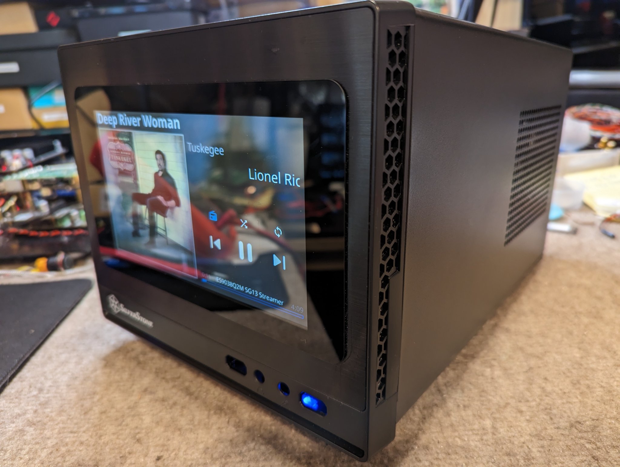

Here's a look at my latest DAC/Streamer project. Streamer meets mini-ITX computer case. I've been wanting to do something a little different - mostly because I want to stretch my creative side of design and implementation. Something a bit less mundane in the world of DIY audio gear. Including most of what I've built over the years too! Of course it had to sound great too. I'll try not to be too verbose but stick to the main subsystems.
BTW, I'll be putting a more detailed project writeup article with tons of images up on Hackaday soon. Once complete and ready for public consumption I'll post a link here.
To pull this project off, I had a mental idea of what I wanted to accomplish. I even had a plan that seem to continually change as I went along. The first was finding a suitable enclosure. If you like to build computers, there's never been a better time to find anything as unique as you want to build. Every formfactor is available. So, I went with this one, the Silverstone SG13 mini-ITX case. I needed a case with more height than a standard audio enclosure.

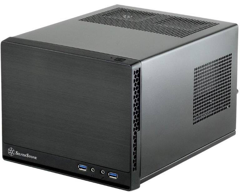

Here's a before and after.
After

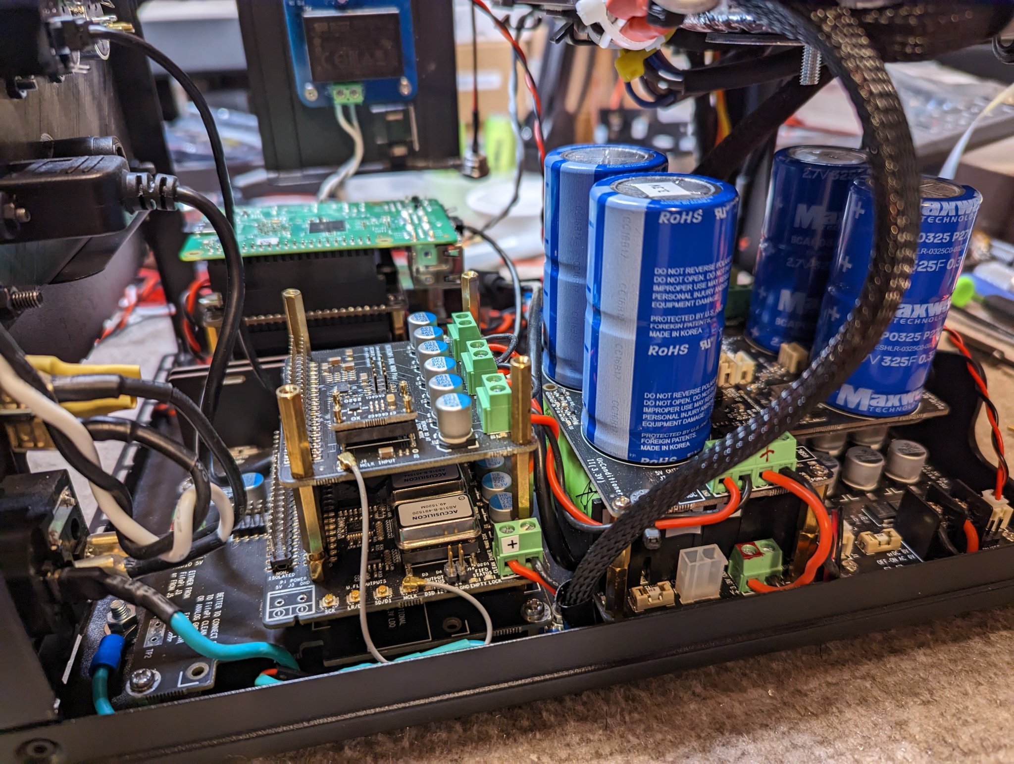

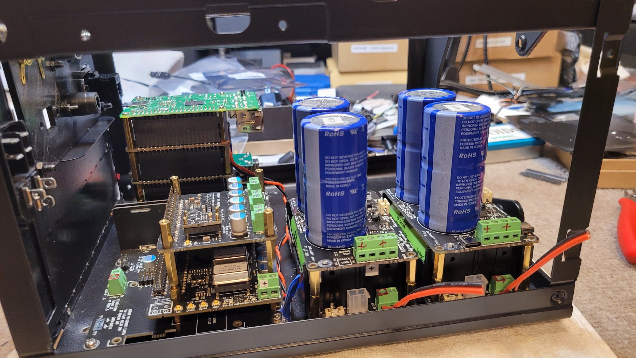

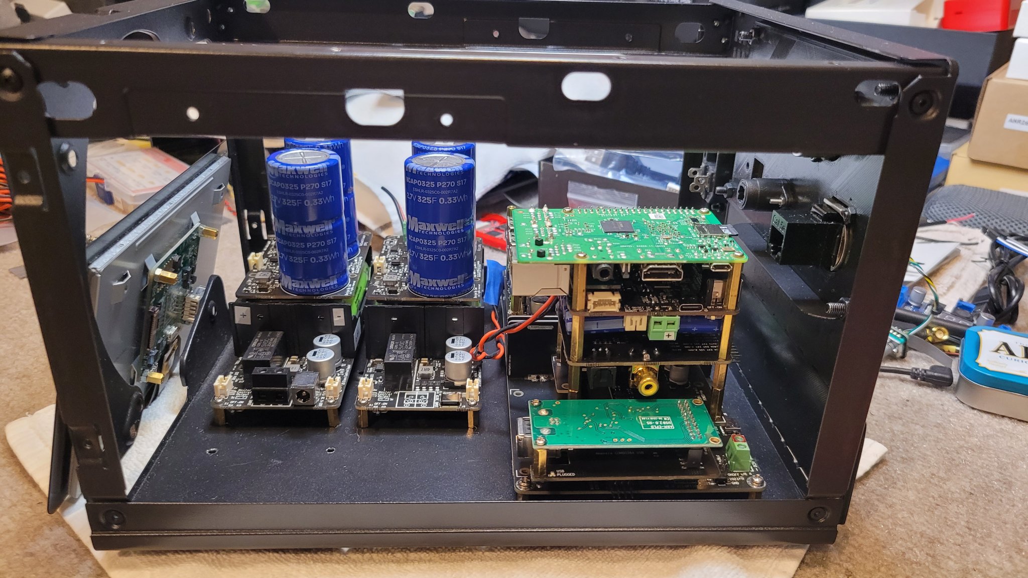

At first it was challenging to get all the pieces suitably arranged. Layout was critical in getting everything to fit and make it work with little physical interference. In the end, this is what I thought worked best - at least for me. The case needed to include enough space for all the electronics. I chose to go with the suite of DAC related boards from @iancanada. I have used his kit for other builds, and knew they'd sound great. He offers a wide array of sorted PCBs that do not disappoint. As far as I'm concerned, my digital library has never sounded better!

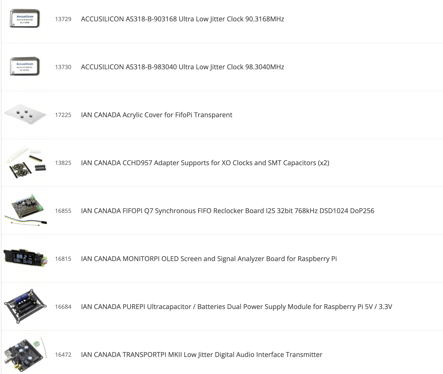

A complete list of available hardware Ian offers is on his Github and can be found here.

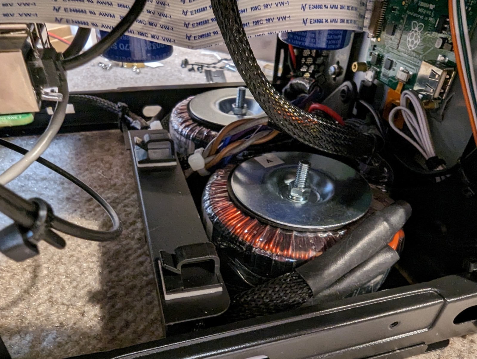

More images of internals placement. A 3rd LinearPi PSU was added in the space in the lower left.

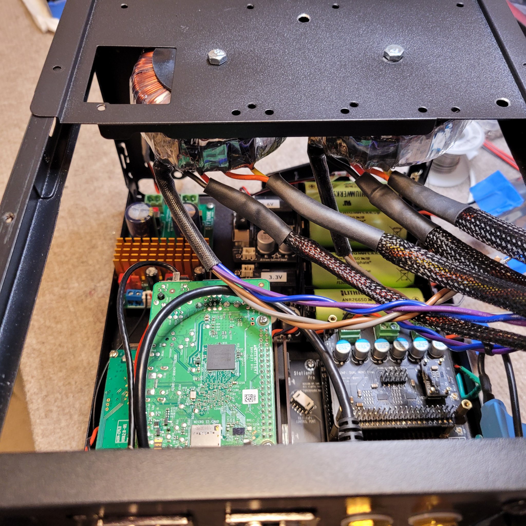

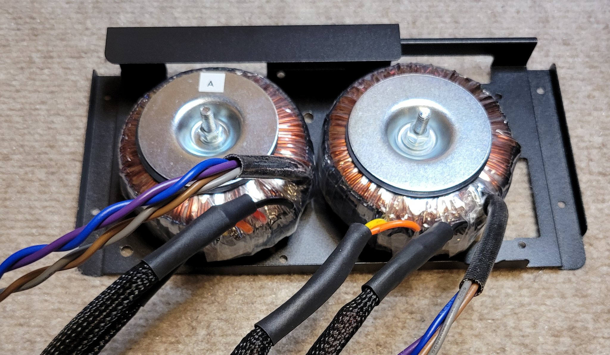

Fitting the transformers to HD bracket that came with the case.
Transformers mounted to top bracket. Shown upside down.
Was able to route most of the AC wiring in the frame rails of the case. It came out really well.

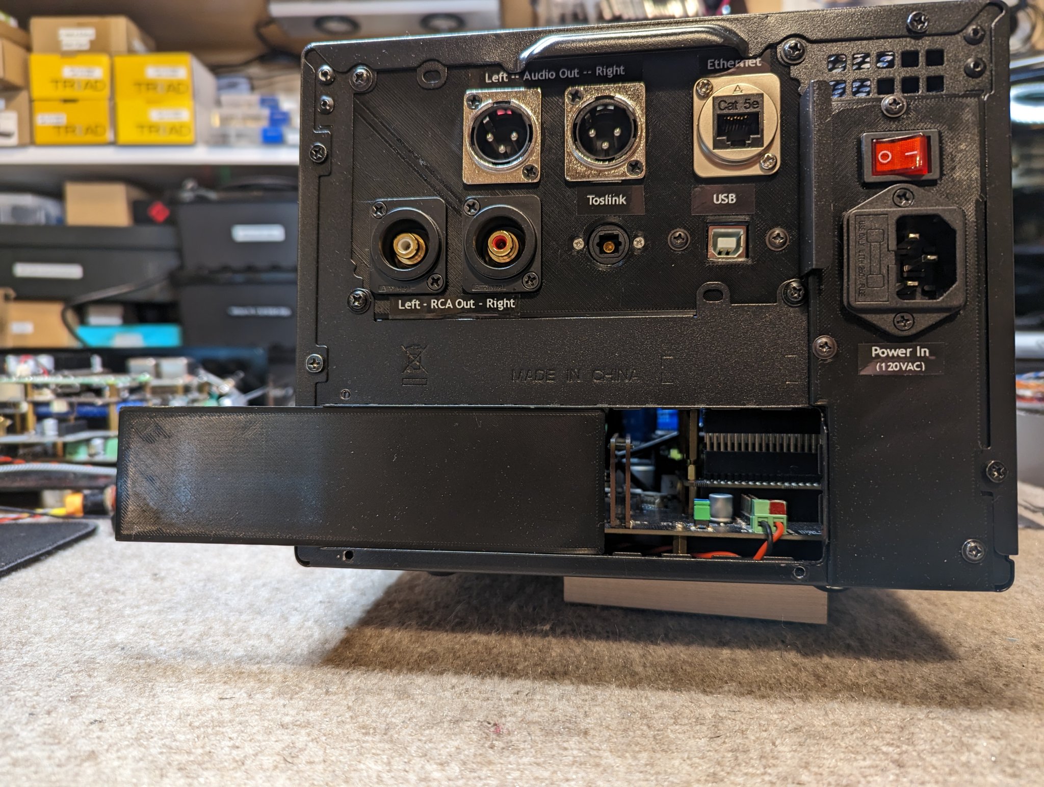

Modding the case and 3D printed back panels. This was the final layout all the I/O and IEC sockets. Sliding door where the I/O shield would normally be. For now anyway. Not sure how that will used - if at all.

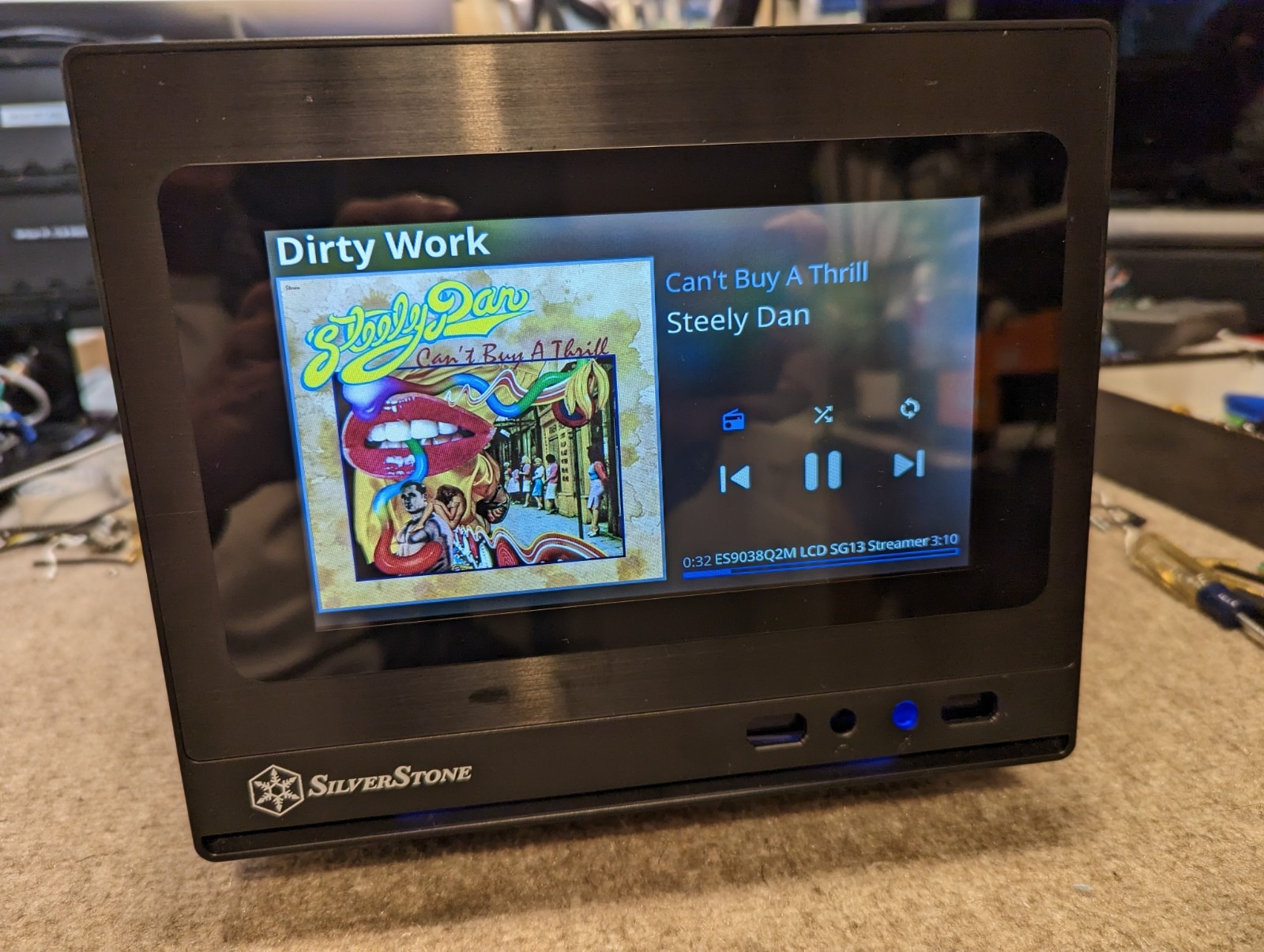

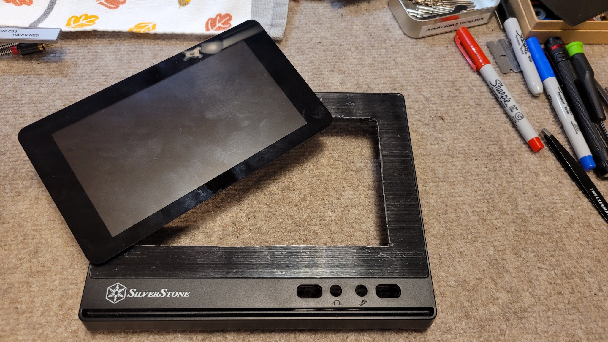

Cutting the front panel and fitting the 7" LCD screen. Patience. Used a portable dremel tool with this cutting wheel. Makes quick work of any plastic.
Some final wiring. Anyone spot the error in the next image?
Finished project showing this as a roon endpoint, using the 7" touch panel for transport controls.

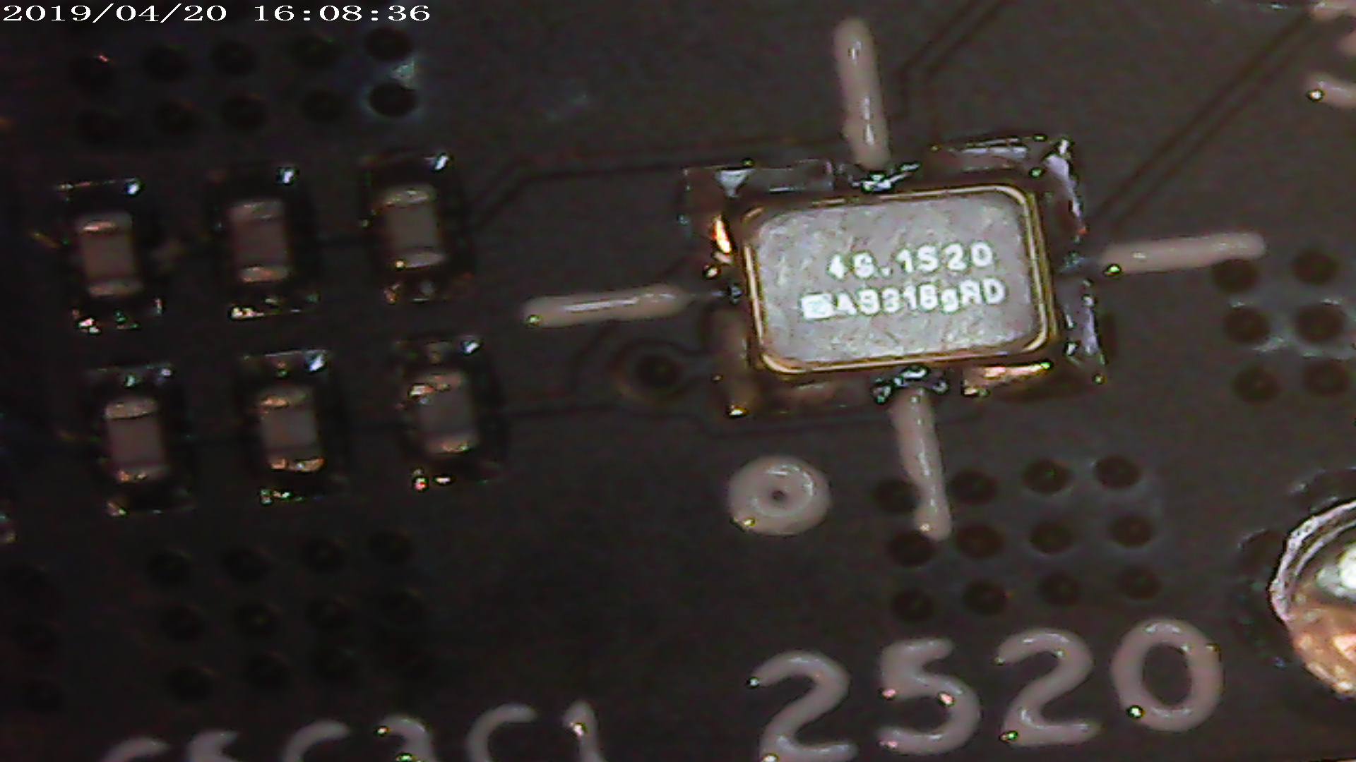

Will have external Dac with SPDIF input. Planning to use the output of TrasportPi MkII for that@NeoTheOne I do not see any dac module

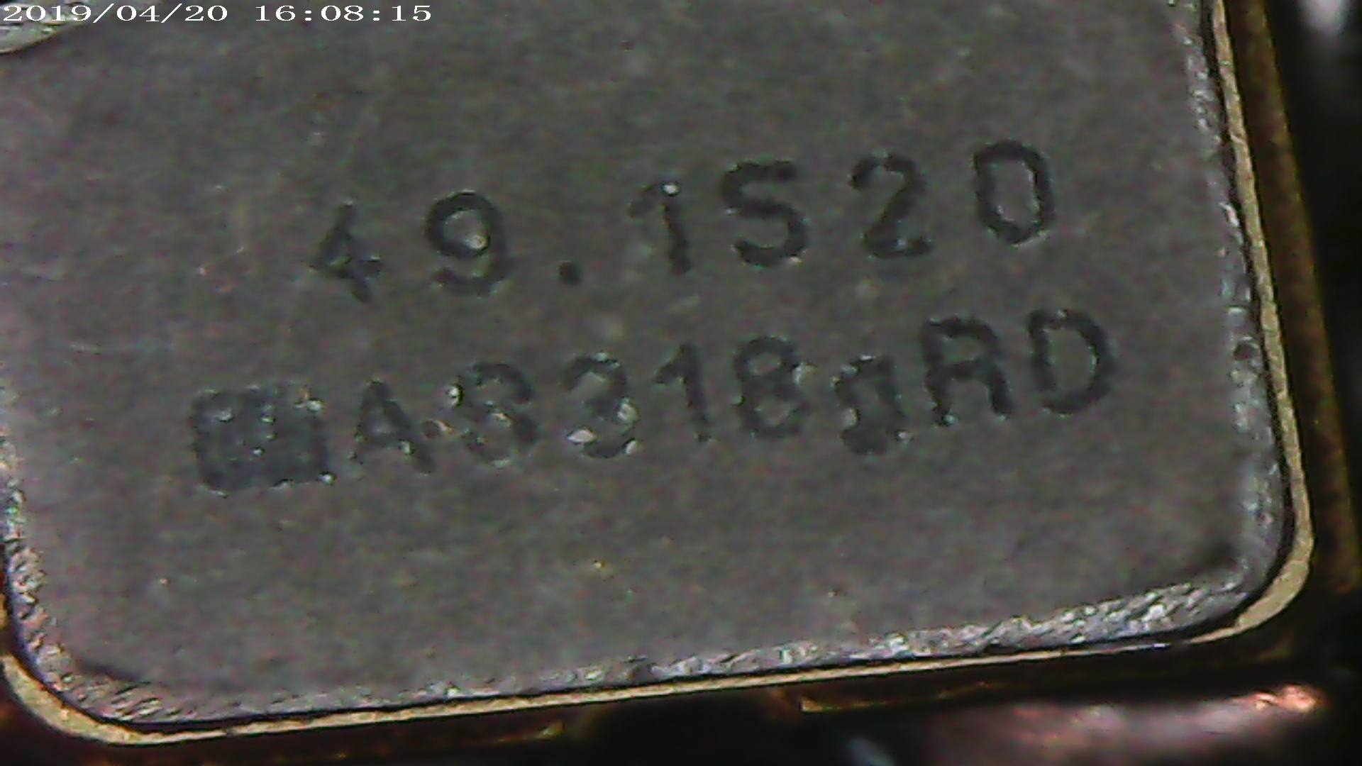

I took some photos today from clocks that was originally in my TransportPiDigi-board. There is label AS318, it looks like same clock that is inside in those Accusilicon metal boxes? Is there any benefic to upgrade to those clocks?
In this post is photo from inside of Accusilicon shielded box:

Wow what a nice build I was wondering if you are using a isolation transformer (1 on 1) in your build, I am wondering this in general since I have not seen a lot of isolation transformers between the mains and the trannies in this forum. Does it make sense to use one if using the linear pi's with UcConditioners? What would be the pro's/con's when using one.
Cheers
FWIW I experimented with isolation transformers with the thought of reducing noise on the AC, aka a power conditioner. Two conclusions. It made a very small change in sound. Can I really hear a difference? I concluded I could hear a slight change and it was for the worse so I took it out. I tried both an EI type transformer and a very large toroidal. IMHO, if you do not have one on hand, then save your money. I use them in my workshop for safety when testing my builds.
