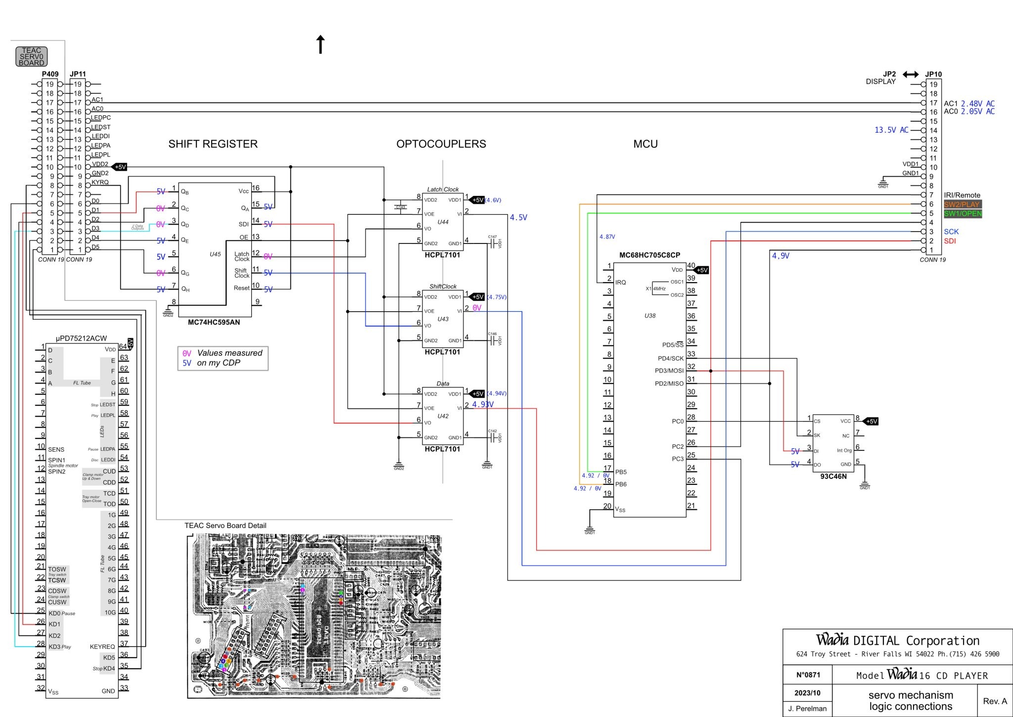

Hi, I ordered 2 MC74HC595 today, to see if its replacement can help. My thought is that the values measured - with the scope - on 3 outputs of this shift register do not look like they should, see schematics. The optocouplers seem to be working correctly, both inputs and outputs, as far as I can judge after trials.

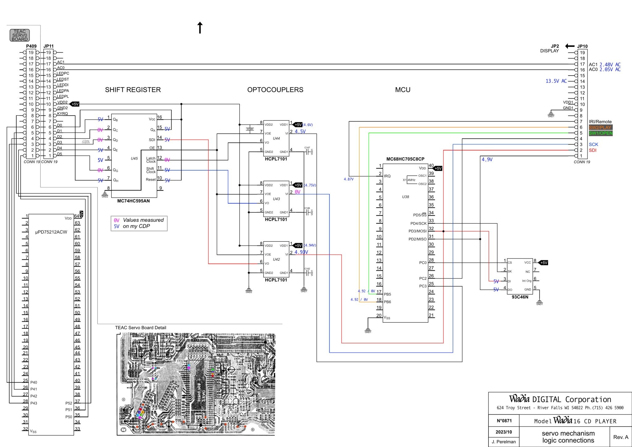

Here is the latest version of it.

Hello everyone, I just replaced the shift register 74HC595 with no better result...
A few things remain unclear to me:
- when I measure voltage on pin 1 and 2 (shift register), either I've got 0V or 5V depending on what I'm doing with the remote, BUT the voltage remains the same as long as I don't press again a button on the remote. As if it keeps memory of it as long I didn't press the button another time. I don't see clearly why. Something related with the latch clock behavior? I didn't test all outputs, I'll do it more seriously this afternoon.
- I don't see any decoupling capacitor on that IC, against usual practice. Then I tried to put temporarily a 10nF ceramic on ground and Vcc to see if something would change, but no. Maybe I should try a 0.1µF. Or is it not recommended? I can't think that Wadia has forgotten to put one here's there are decoupling SMD caps everywhere...
- I'm waiting for 3 optocouplers (and a real Texas Instruments 74HC595 too) from Mouser next Monday. Maybe I should prepare DIP-8 supports in advance.

I've replaced the 3 optocouplers (U42, U43, U44 on the schematics) and it works. I didn't soldered them, I chose to plug them on DIP-8 good quality sockets. As I did for the shift register.

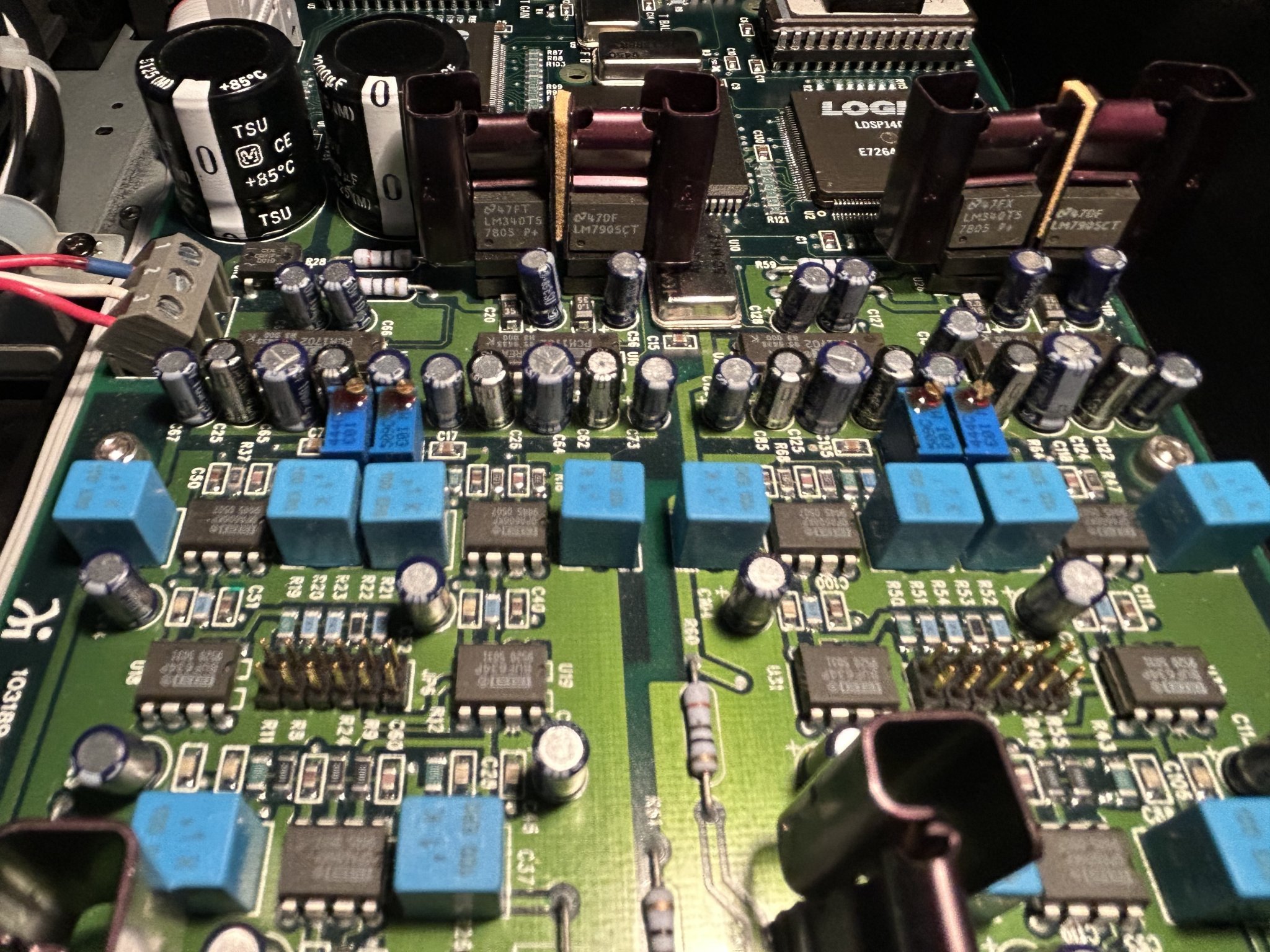

I replaced the 1Ω 2W resistor near the 5V supply first, not that it was bad, but to put it away from the board as it runs quite hot.
I bought the caps to replace them but didn't do it yet. I measured ESR of the three "big ones" and it was good so it's not an emergency I think. I wanted to replace all the small caps (47, 100µF) near to the 4 PCM1702. I've seen on pictures of the 861 that these caps were organic polymer caps (vs EL aluminium standard caps on the W16) and I think it's a better choice. I'll probably buy a bunch of them and do that work later.

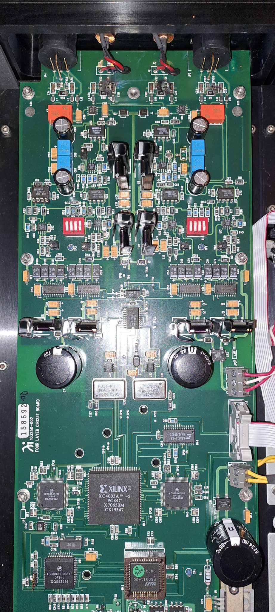

My Wadia 16 looks nothing like it.
I have not opened the other one, but I am sure the other one - judging from old pictures I have looks exactly the same but different to yours.

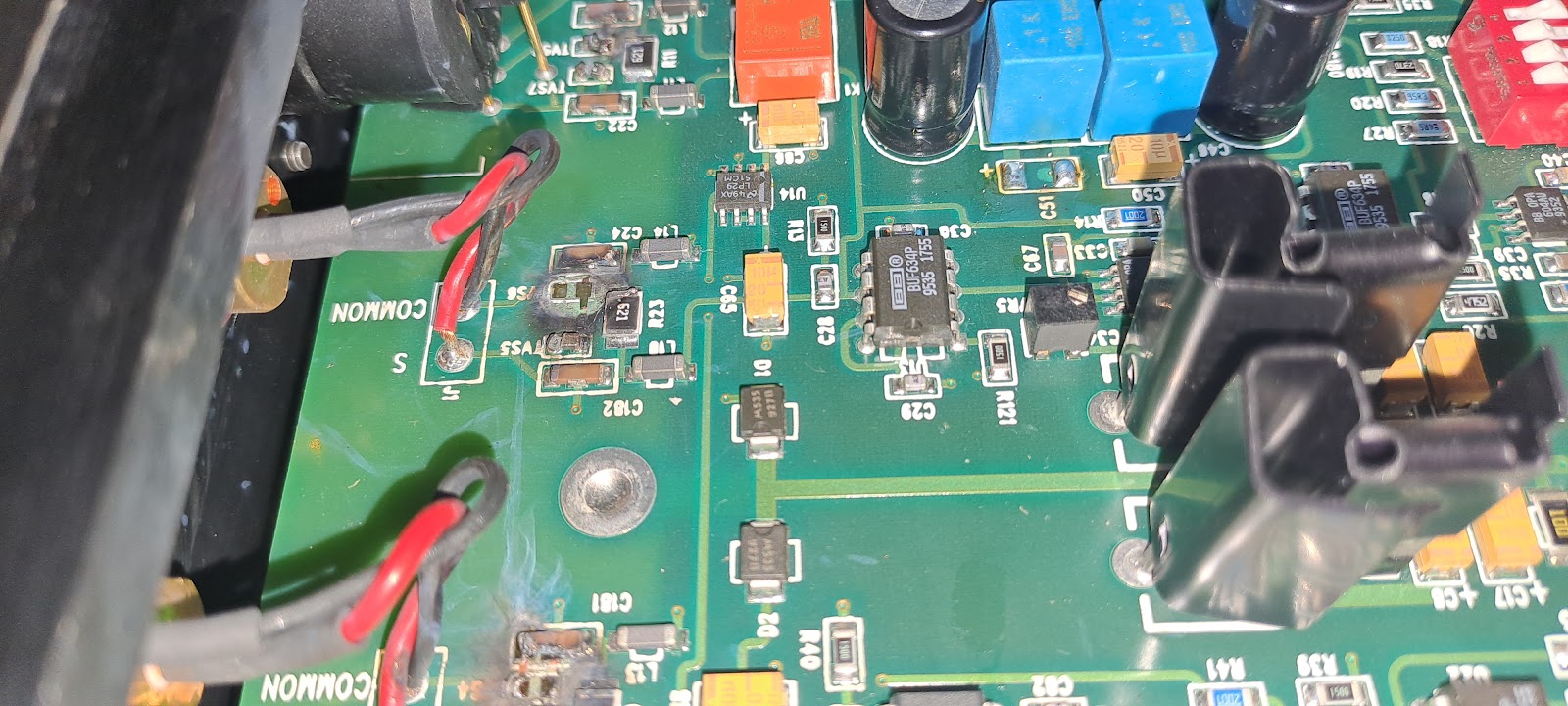

Hi. Thank you very much, I read it. This is a diode with the marking; MMBZ15VOL T1
The only problem is that I can't find it with this marking.
In my opinion it is a 15V zener diode. I found a similar one but with three leads.
These diodes connect to the housing.
