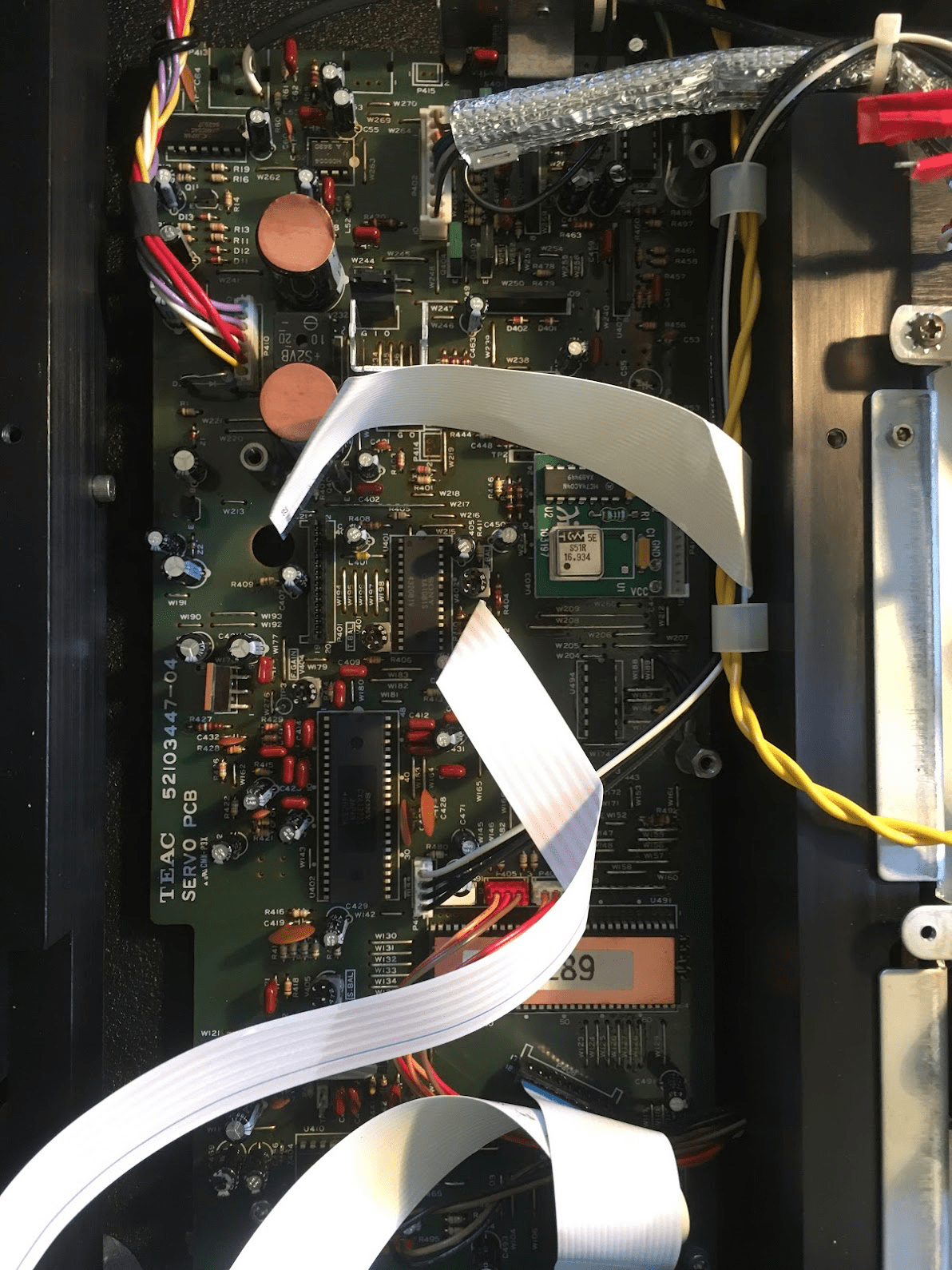

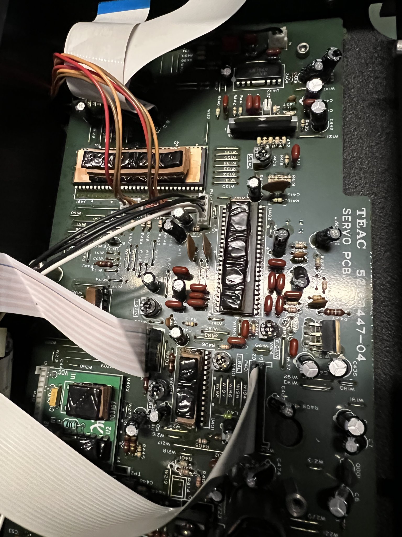

I could add that the W16 servo board is nearly the same than the TEC VRDS 10. Same number : TEACServo PCB 52103447
It differs as far as I know only with the Wadia little PCB (middle right) which I don't know the use...
Here is a picture of mine :

that little sandwich above U491 is funny 😉Mine is also the same number/version.View attachment 1053250
That little board is a new/better clock for the servo.I could add that the W16 servo board is nearly the same than the TEC VRDS 10. Same number : TEACServo PCB 52103447
I think the Wadia 16 as around 5/6 crystals oscillator for control the jitter in every place.

Yes you must be right about the jitter rectifier Wadia PCB on the servo board, it looks like that. I've got a few things to fix before I put my W16 on the table again... (a friend's Harman-Kardon ST-7 turntable, another friend's TD184 Thorens and a Grundig FineArts Tuner), a painting to finish and so on...). I hope I can be back again on the W16 soon 😉. Fortunately, I've got other CD players and drives to play in between.

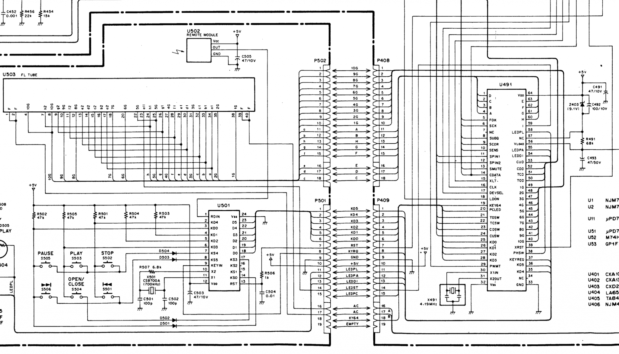

I think the first thing I'll have to do after having dismantled the W16 is to check VDD on U491 (5V). See partial schematics below.
I haven't done that yet and when I see the schematics it appears to me that I should have done that. I checked C491 but I hadn't seen that there must be a zener (Z403) and a capacitor (C492) somewhere (I didn't see or search them before), and that these components must be working to feed U491 (µPD75212ACW chip). Correct me if I'm wrong.

Hello friends. Has anyone found a solution for the cd loading unloading and command control problems like play/pause/open/close?
As everyone has said, I think it's caused by bad capacitors.
Could you please share with us if someone solved the problem.
What problem is that?Hello friends. Has anyone found a solution for the cd loading unloading and command control problems like play/pause/open/close?
You remote controller does not work or the front panel buttons?
Hello rockeater, it doesn't work none of them. if I load a cd manually it is work fine. As I understand, the majority mentioned the capacitors, but no one mentioned that the problem was solved via changing capacitors.What problem is that?
CD loading and unloading is a dirty limit switch problem.
If your remote controller does not work, check if it emits the light. Point it at your mobile phone camera and see if the Infra Red diode emits light.
There is no problems with capacitors in Wadia 16, and whoever says there are, has never seen one and is purely speculating.
Limit Sw and remote control OK. But no loading and unloading via remote or front panel buttons. Remote work fine vol + vol - and all other buttons work fine except related mechanic control buttons play, pause, stop, eject.CD loading and unloading is a dirty limit switch problem.
You say that if you open the drawer and close by hand and power on the wadia it plays?Limit Sw and remote control OK. But no loading and unloading via remote or front panel buttons. Remote work fine vol + vol - and all other buttons work fine except related mechanic control buttons play, pause, stop, eject.
I don’t know, but maybe the problem is coming more from the servo board.
