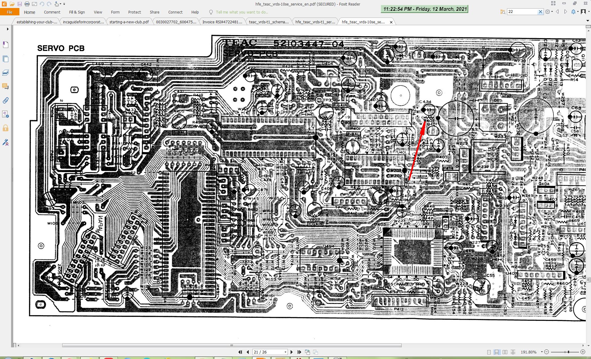

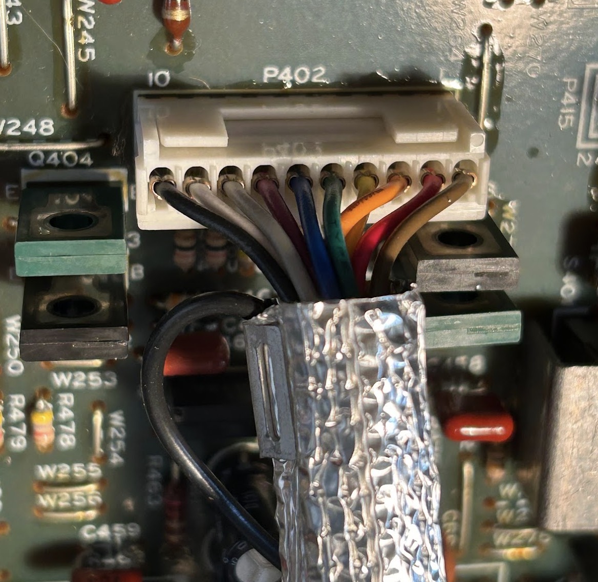

There are 10 cables coming from the servo board to the spindle motor (all colours). Page 23/26 of your Teac 10 document shows the P402 connector, picture below. This is the connector to the spindle motor. It should say something when you press the Play button (faceplate). As you're obliged to take the above PCB, you won't probably get any response from the remote (see my different posts about the problem I encountered myself), so use the faceplate button to see if something changes around the P402 connector?
What I can say is that on mine, motor was functioning as soon as I put the player ON. Read the disc, play it and so. My problem was, as you've probably read above, with the optocouplers. Your remote works so it's somewhere else... I don't know what's the working voltage of this motor (between 5 and 9V I guess?) but either it works, and the problem is "no signal" or it doesn't work.
Trace voltages from this connector, and see if some voltage value is modified by action "play"?
Experts (I'm not) who read this can provide valuable thoughts and ideas, I'm sure.
So it happens, that I now have the same problem with my Wadia 16. The motor will not turn.
But it is not a motor problem and when it does not spin, there are no voltages on the 10 wires going to it.

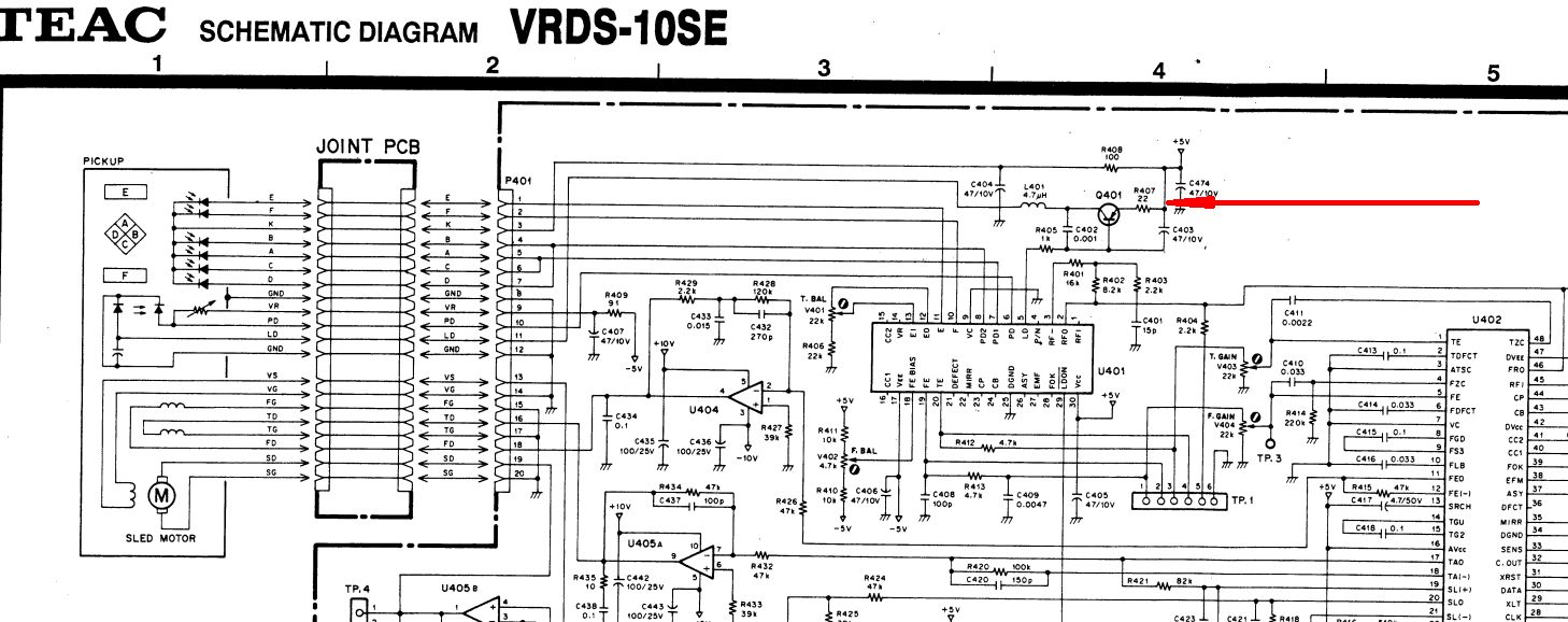

But I suspect, that your problem @tolas123, is that the player's laser does not get focus and hence it does not turn the motor.
The fact that you have a working (in another player) laser, does not mean it will work in yours.
If your laser hunts for focus and there is a visible red light being emitted, then the next step is to measure the output.
If you don't have laser power meter, you could ask a workshop to check it for you in your player. You could also try to make one from old laser mouse, but you still have to have a working one for calibration, so this is of little help.
The only thing I would recommend you to try, is to measure the voltage drop on the 22Ω resistor that the current to the laser is going through, to see if the value is similar to the one stamped on the laser. This would indicated that the emissions are adequate. This is done by dividing current in miliVolts by 22 and comparing with what is stamped on KSS-151A.
Details are in Esoteric P-700 Service Manual.
I also show how it is done on my uTube channel: youtube.com/@hear-net-au
Search in Esoteric P-700 / P500 and Sony ES series players. I covered this many times.
VRDS-10 board - R407 22 Ohm resistor CCT Diagram.jpg VRDS-10 board - R407 22 Ohm resistor Layout.jpg
