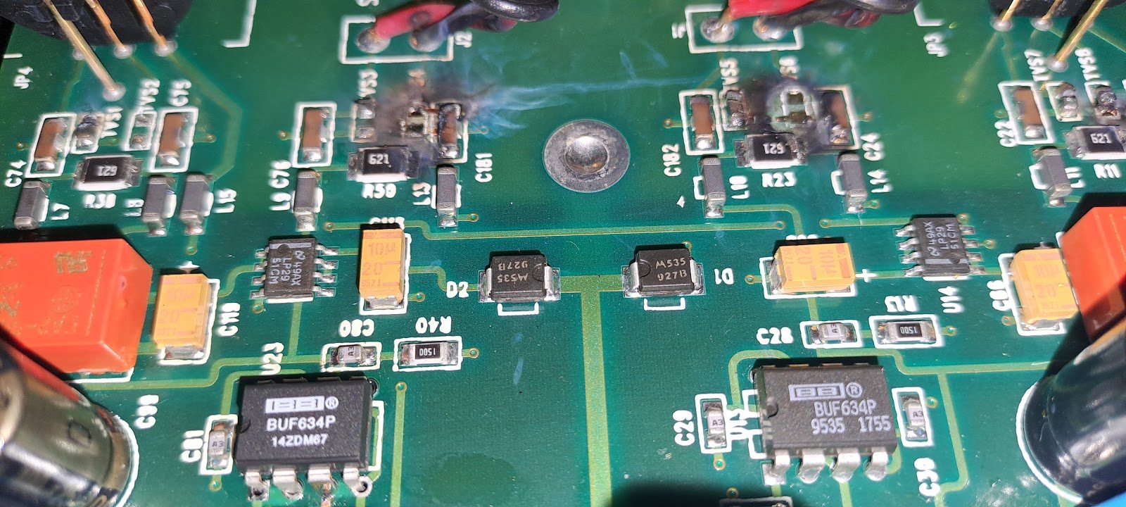

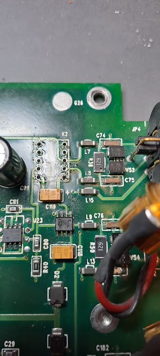

Good day. Sorry I haven't been here for a long time but I was collecting parts for Wadi 16. And I almost got it working. There are two problems, there is a short circuit at the output, the relays are shorted to ground and Mute lights up on the panel, after desoldering and checking the coils are good. And the second problem is that the engine doesn't turn, the laser lights up. I kindly ask for advice. Thank you.
There is a fair chance that this is not a fault.there is a short circuit at the output, the relays are shorted to ground and Mute lights up on the panel,
Wadia 16 is designed to work straight into a power amplifier and when turned on, it mutes the output. Use volume control on the remote to increase the level and that mute diode should disappear and in turn a column of level indicating diodes will light up.

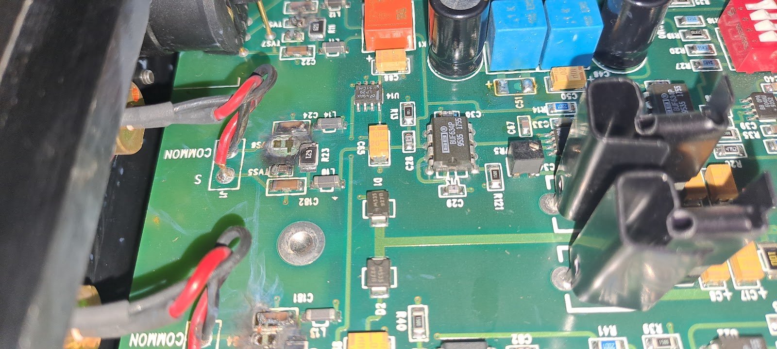

Dziękuję za odpowiedzi. Jutro to złożę i spróbuję uruchomić i nagrać filmik z działającym laserem. Wymieniłem 4 x pcm1702 6 x OPA604 6 x BUF634 2 x MIC2951 4 x NJM7812 i 7912 4 x 7805 i 7905 4 rezystory 620 ohm 8x dioda TVS 8x kondensator przelotowy. Prąd płynął przez XLR i RCA z KRELL KSA-300S. Pan powiedział, że wszystkie jego tranzystory się przepaliły.
Of course the board will be cleaned, the original capacitors and resistors will be installed, the ones with 10 ohm stabilizers. The board was tested without relays, and the offset is regulated by setting 0 mA. After soldering the relays I will let you know if it disconnects from the remote control. Thank you
If the repair guy said that the current source for this catastrophic failure came from Krell KSA-300S, then there surely must be some kind of incompatibility between the two. Either grounding on either one was non standard, or the XLR balanced cables were in some way non-standard. Say negative was connected ground or cold or maybe some kind of XLR to RCA adaptor was used.Prąd płynął przez XLR i RCA z KRELL KSA-300S. Pan powiedział, że wszystkie jego tranzystory się przepaliły.
I did connect my Wadia 16 straight to the Electrocompaniet AW-100DMB and it worked fine. Because Wadia recommends it as a preferred way of connecting the 16 to the system, I had to do it as a test to see if it was indeed beneficial not to use pre-amplifier. In my opinion it was not, and an EC-4 pre-amp is now used, but certainly there was no fire in either component with the direct Wadia 16 to power amp connection.
Thanks for the replies. Tomorrow I'll put it together and try to start it up and record a video of the laser working. I replaced 4 x pcm1702 6 x OPA604 6 x BUF634 2 x MIC2951 4 x NJM7812 and 7912 4 x 7805 and 7905 4 x 620 ohm resistors 8x TVS diode 8x pass-through capacitor. Current flowed through XLR and RCA from KRELL KSA-300S. The gentleman said that all his transistors burned out.

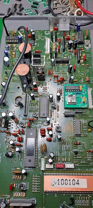

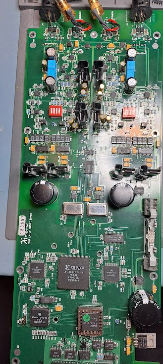

Hello the dac board is working thank you for your reply. Wadia mutes itself on remote control three buttons PLAY AND LEVEL did not work after making remote everything works relays unlocked. Still does not work motor I bought a Denon Cd with working laser I swapped and still nothing switches checked. Please help.
Hi @tolas123 , I find it difficult to read sentences without any punctuation... sorry for that. As English is not my mother tongue, it's more difficult to understand what you really mean unless you're clearer at describing precisely what problem you encounter when you do this or that.
Can you tells if the remote works, if the machine works and what it doesn't do. At present I understand that the only problem is coming from the motor not turning. Is it correct?
The first thing I'd do (I don't recall if you did, sorry if I'm repeating myself), would be to test voltage on the motor connexions?
By the way, does the laser moves? 1) on its rail, back and forth when you light the W16 on and off ; 2) up&down around 3 times when you light the reader on and no disc in.
And by the way once more, does the player read the TOC?
