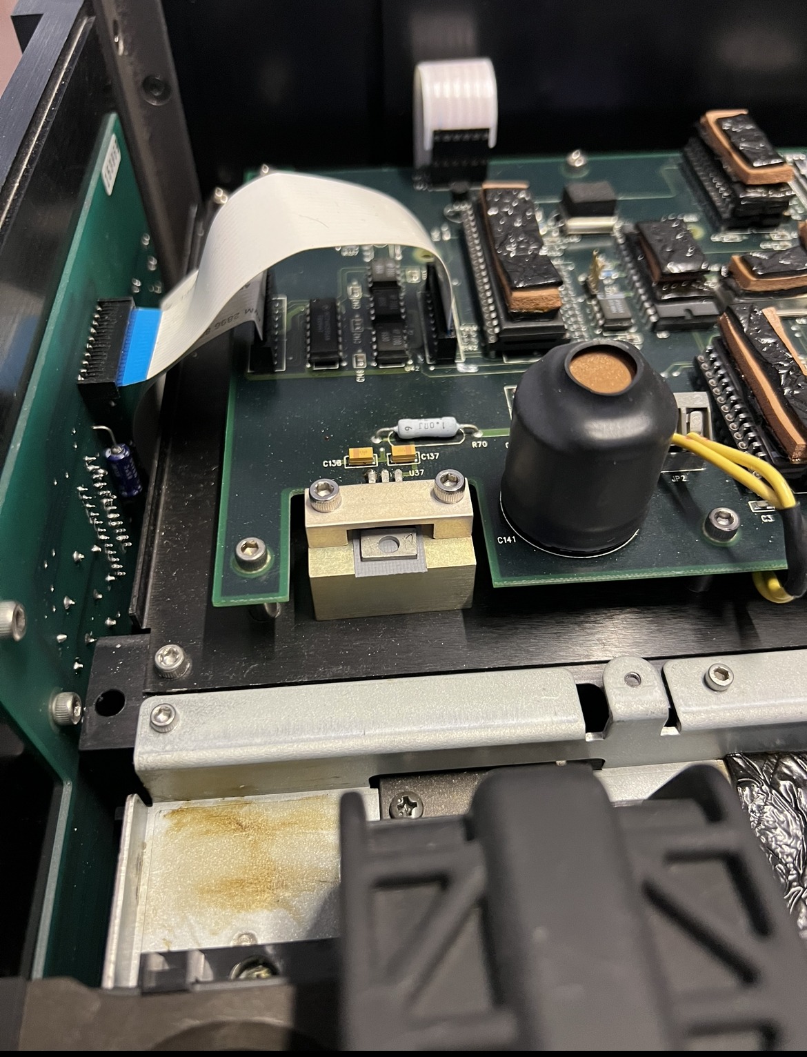

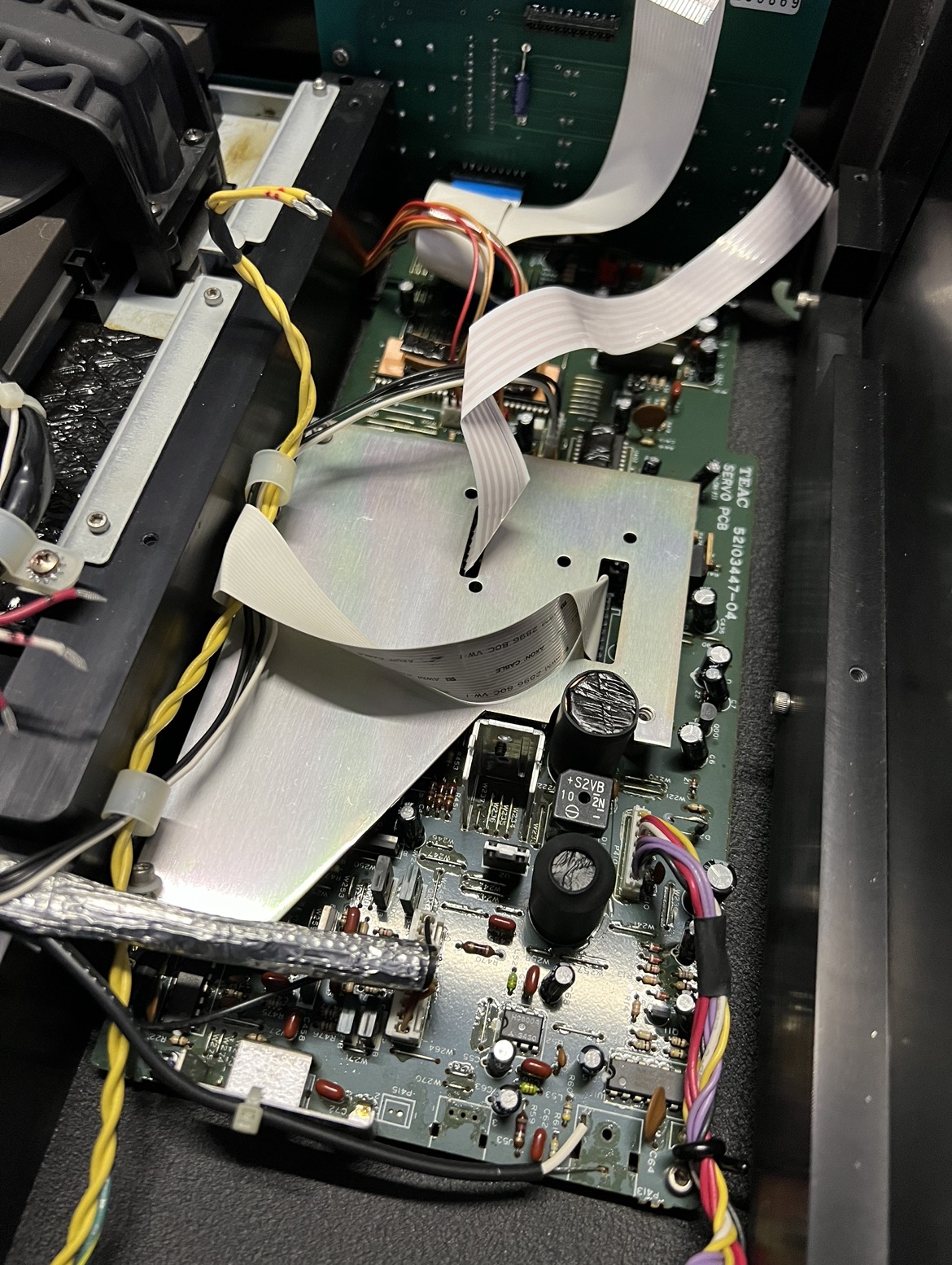

I would think then, that there could be communication (or a simple ribbon cable connection) problem somewhere.
On my 16, when I got it, it was not responsive because previous workshop reversed the ribbon from servo board to the DAC board (from where it goes to the display board).
If your players just failed one day, it would not be applicable, because ribbon cables do not jump out to reverse themselves, but on mine it was a man made fault.
What was funny, is that they marked the ribbon and the board with a number of lines in order not to reverse them, but they reversed them on the servo board end which they failed to mark...
The Wadia smarts should be OK, if the player still plays.

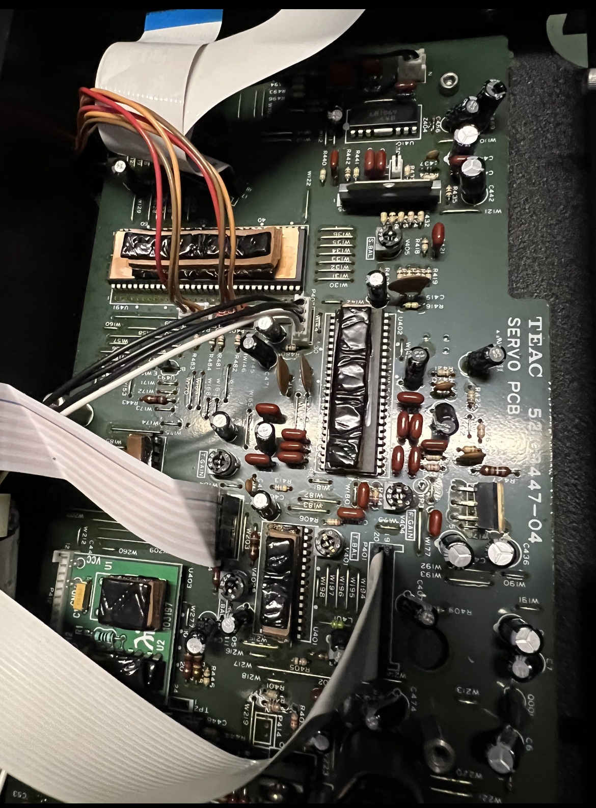

I would then check driver and receiver chips each side of the servo -> DAC - > display board.Considering the way it stopped working (after 15 days of holidays during which I hadn't -unfortunately -unplugged it), working perfectly before, commands not working after... I was thinking of a surge or so, which could have damaged a diode (would be lucky) or a chip (less lucky...).
And maybe Erdimeter has something to add about the exact circumstances of the fail? I'm unsure to understand if he can open/close the tray or not (either faceplate or remote). Nice day to all 😉Yes I remember you mentioning that. As you say, it can't apply to my player. Unfortunately.previous workshop reversed the ribbon from servo board to the DAC board
This is what I have to do I guess. Chips and diodes/caps around the chips. I'll tell you when I'm here!check driver and receiver chips each side of the servo -> DAC - > display board

Rockeater thank you for your attention.I would think then, that there could be communication (or a simple ribbon cable connection) problem somewhere.
Was your 16 same problem with mine(work fine but no servo commands from remote or front panel)
What was the problem exactly of your 16 before reverse the flexible ribbon cable?
The previous owner tampered with it and wrote something on the ribbons. I think it's the same fault with your own 16.
Now, I'm worried that if I reverse the strip from the servo card to the dac card, there will be damage to the device. Also, if the ribbon cable is inserted upside down, Isn't it interesting that the device is still working?
How can I find the correct connection positions for flexible ribbon cables.
Can someone help me ?
Thank you very much in advance for your attention.
Hi erdimeter, which ribbon cable are you talking about? there are two at the front (near the faceplate), one connecting the servo to the DAC board, one connecting the DAC to the display (faceplate). There is one on the left side (facing the device), connecting servo and DAC PCBs, and one on the right side of the DAC PCB connecting to the PSU. As far as I can remember. Which is the one you would suspect to be wrong-sided?
But as you say, if the player plays the disc, it seems unlikely that a ribbon cable would be reverse positioned.

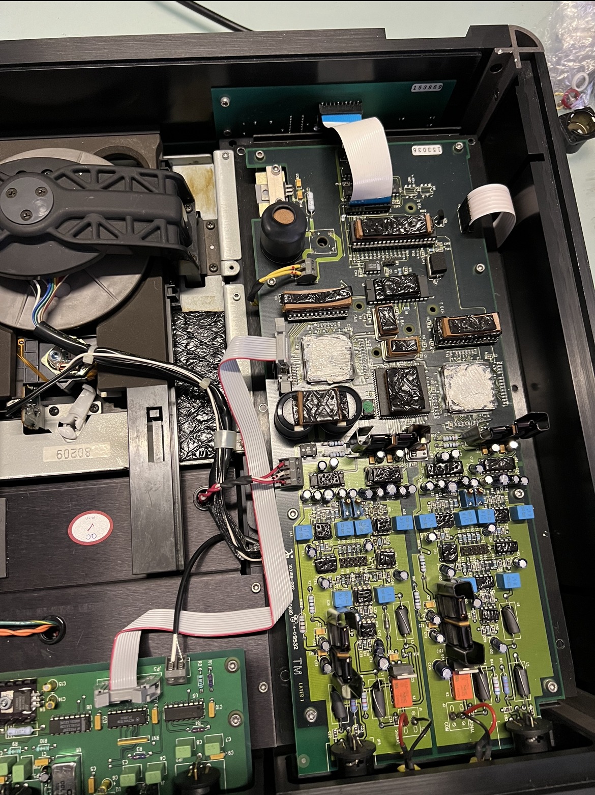

Wadia 16 CD commands don't work...
English translation below
Bonjour Pierre,
je suis en train d'essayer de comprendre la nature du problème de mon Wadia 16 que je résume ci-dessous :
Pendant des années, tout fonctionne bien (très bien même), jusqu'à un jour où les commandes "disque" ont arrêté de fonctionner.
Symptômes :
S'il y a un disque dans la machine, et que j'allume la machine, alors la lecture démarre, et va jusqu'à la fin du disque, sans aucun problème.
Mais :
Aucune commande du plateau ne fonctionne (Stop/Play/Skip/Search/Index/Pause/Open/Close etc...), que ce soit via la télécommande ou directement en façade (2 boutons Play/Open).
Les autres fonctions de la télécommande fonctionnent (volume, source, display on-off, input, mute, insert. La led Pause s'allume mais il n'est pas en pause), donc j'élimine un problème sur la télécommande ou sur le récepteur IR.
Au démontage (presque complet), je n'observe aucun signe de surchauffe ou d'oxydation, ni sur le circuit de conversion DAC Wadia (celui du dessus, visible dès l'ouverture du capot supérieur), ni sur le Servo PCB Teac (celui du dessous, qui nécessite pour être accessible de démonter le PCB du dessus). Le Key PCB (tel que décrit sur le pdf du schéma Teac), c'est à dire le PCB de l'afficheur - entre autres) présentait quelques traces d'oxydation sur les connecteurs JP1 et JP2, pas sûr que les contacts étaient parfaits, donc nettoyage. Pour le démontage de cette carte, ce n'est pas seulement retirer 3 vis... il faut sortir toute la façade avant. ça se fait mais il faut prévoir une petite heure quand même.
Donc je reprends. Au début je pensais naïvement que le CI responsable pouvait (pouvait) être le MAX7219 (qui est comme le dit le datasheet, un 8-Digit LED Display Driver) qui se trouve être le CI présent sur le Key PCB. Sur la notice Teac (du VRDS T1 ou du VRDS 10 ou du VRDS 25), ce CI est censé être un µPD7566. Peut-être est-ce le cas sur les TEAC mais pas sur le Wadia, qui doit bénéficier de sa propre carte d'affichage... Mais si ce MAX7219 est un Led Display driver (et il l'est), peu de chances pour que ce soit en lien avec les commandes du CD.
Donc, je reviens sur les schematics disponibles chez TEAC (10 et 25 qui correspondent le mieux au Wadia 16, mécanique Teac CMK 3,2 / laser Sony KSS151A). Ce module d'affichage est relié par des nappes à la carte DAC et à la carte Servo.
En remontant le tout, je m'aperçois que l'un des fils qui relie la carte Servo à la mécanique (fil orange qui relie le connecteur P405 de la carte Servo à la mécanique Teac) est comme "écrasé". Ou comme s'il avait pris un coup de chaud et que sa gaine ait "fondu". Pas facile de tester la continuité mais elle ne tient qu'à un fil. Dans le doute je coupe, soude et gaine. L'endroit de ce défaut sur le fil se situe environ au niveau du condensateur C491 sur le PCB Servo. Aurait-il chauffé et fondu partiellement la gaine ? je ne le saurai pas tout de suite, puisque je pense à cet instant avoir compris l'origine de la panne. Funeste erreur, après remontage complet, sur lequel je fais très attention à ne rien brusquer, surtout les nappes souples de câbles... rien n'a changé. Toujours pareil. Zut.
Je reviens donc sur ce que j'identifie comme l'endroit où se gèrent les commandes du plateau et du moteur, le dénommé U491 qui doit être si on en croit la légende, un CI µPD75212ACW (NEC 4-BIT single-chip microcomputer DIP 64 pins). A priori si c'est lui le coupable (pourquoi ? surtension ? vieillissement ? condensateur de découplage HS ?), pas de problème pour le changer. On en trouve sur eBay à des prix variables, a priori estampillés NEC.
Mais sur la notice d'assemblage officielle Wadia, qui indique comment monter le PCB Servo TEAC et la mécanique associée CMK 3,2, il est très clairement écrit : the Teac mechanism must match the servo board. Et en effet, le n° porté sur la mécanique de mon W16 est exactement le même que celui porté sur le CI µPD75212ACW. Ce CI est-il programmé en fonction de la mécanique associée ? Un échange standard du CI ne serait donc pas fonctionnel ? sur toutes les fonctions ou seulement sur une partie ? Comment savoir ?
Je crois que je vais essayer, après avoir démonté le PCB servo-board (donc quasiment démonté toute la partie gauche du Wadia 16 et le fond...), de dessouder le CI NEC. De souder un adaptateur de bonne qualité DIP 64 pins. Et d'essayer ensuite d'y mettre le fameux µPD75212ACW que j'aurais acheté sur eBay (pas trouvé ailleurs cette référence). On verra bien. J'aurais quand même pensé en même temps à vérifier les condensateurs autour, voire l'oscillateur. On verra bien.
Je vous tiens au courant. Et j'ajouterai quelques photos, c'est plus parlant.

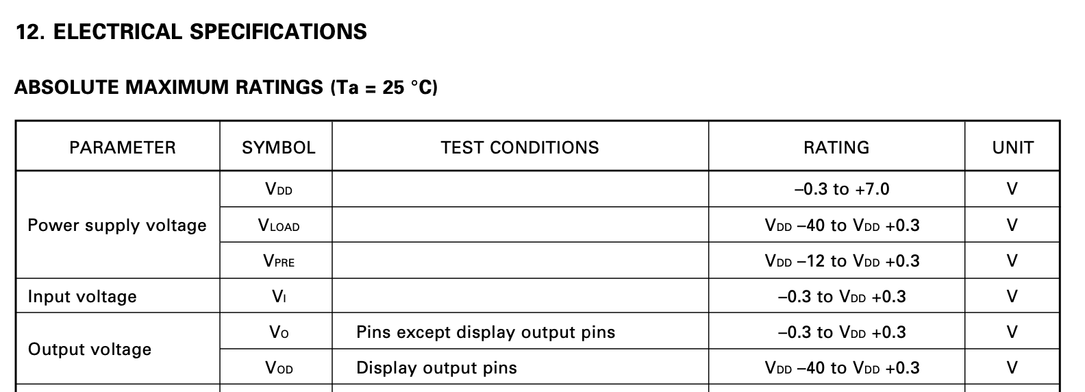

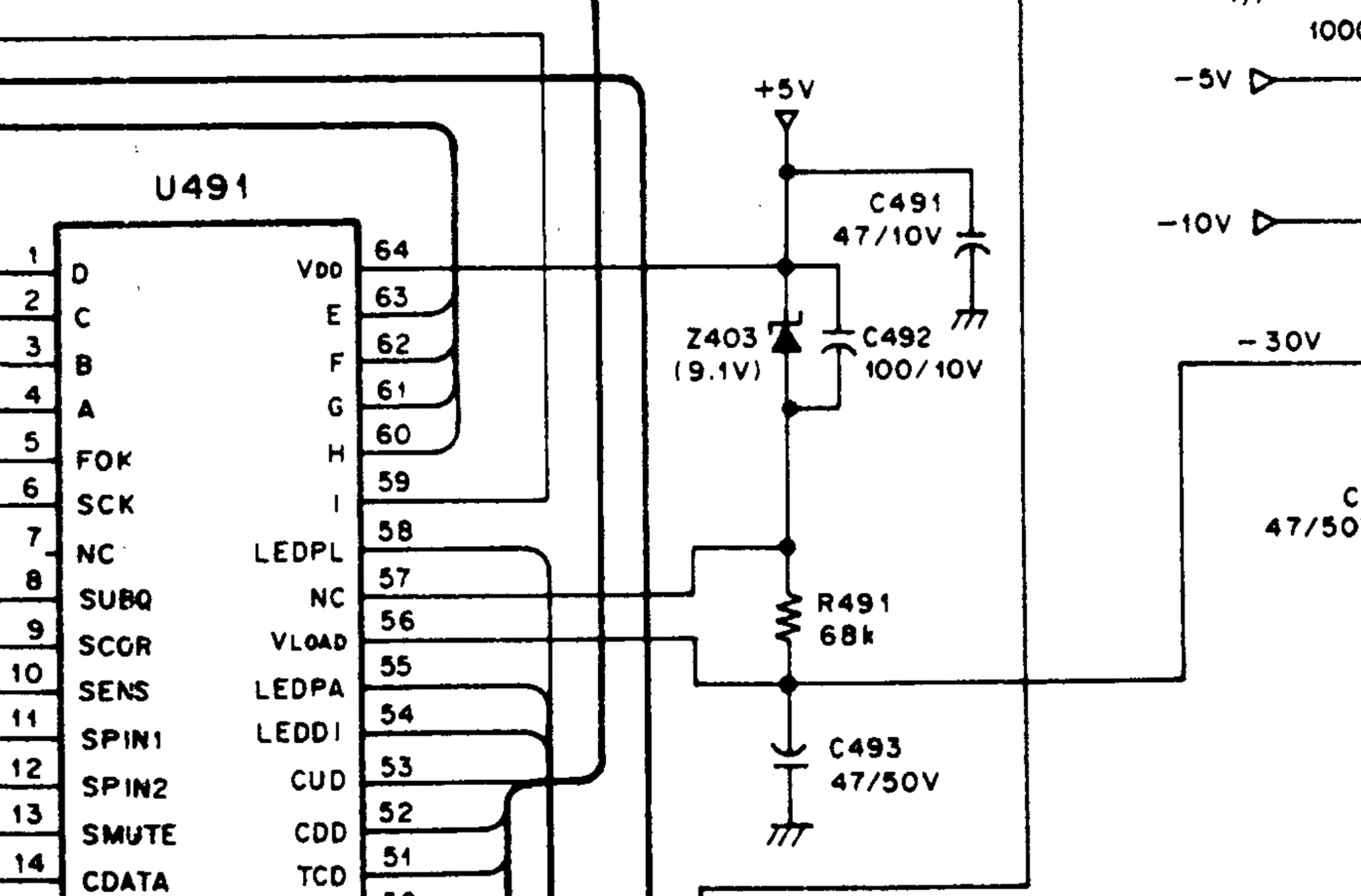

@erdimeter, you mean that U491 is fed normally? You mean VDD on pin 64 is at around 5V? What about the voltage at the cathode of Z403?
I just checked C491 on mine, which was OK. I forget C492, but I'd be surprised if it was defective.

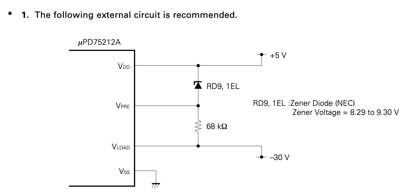

Here is a detail of the recommended schematics you can find on the µPD75212ACW datasheet:
Chips rarely fail on their own. If the µPD75212ACW is defective, something has got into it (first thing I think of is a surge). I would be surprised that all of a sudden, both on your W16 and mine, it stops working. That is why I would suspect another component first. Then, I concede it's mainly because if it's the chip, it would certainly have to be reprogrammed to original specs. And this is far beyond my poor skills!

If I understand the datasheet, I see that VDD should be no more than 7V. Am I right?
If you measure tension on pin 64 at 8,2V, it might be too much... What are other tensions on pins, and do they change if you press the servo commands on your remote (play/pause/open/close etc)
Sorry I can't measure this right now, can't put the W16 on the bench right now... too messy at present.
Maybe we need some external advice to clear that point? (let's be patient 😉
