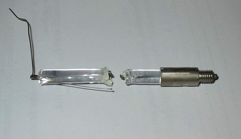

Ywh: here is a picture of my broken lamp. I removed it from the reflector. Lamp was broken into pieces (exploded), so I can't measure arc lenght. From these pieces of glass I can tell, the the outer bulb diameter was about 1cm, but this is not sure.
Both electrodes look identical, so I think it is an AC lamp. UHP 150W.
Do you have such lamps?
Regards

How to determine what type of replacement lamp your projector needs:
There are many things need to look at. First of all, check the manufacturers replacement chart. Although it is not 100% accurate, it is the first resource.
1. arc length.
You need to check the spec sheet of the original lamp. Lamps with distance between two electrodes shorter than 2mm need JYd lamps; longer than 2mm need JYs lamps.
2. size of electrodes.
AC lamps have two electrodes in same size; DC lamps have one electrode larger than the other one.
3. lamp model.
JYd lamps replace UHP, SHP, HS, HSCR, MS, UHE, UMPRD(DC); JYs lamps replace VIPR,MHL,MSCR,SMDR. Others need to do some more investigation.
4. vacuum seal
whether this is a vacuum seal on the bulb. the vacuum seal is the bump thing on the ball part. If there is no seal, JYs lamps are needed.
